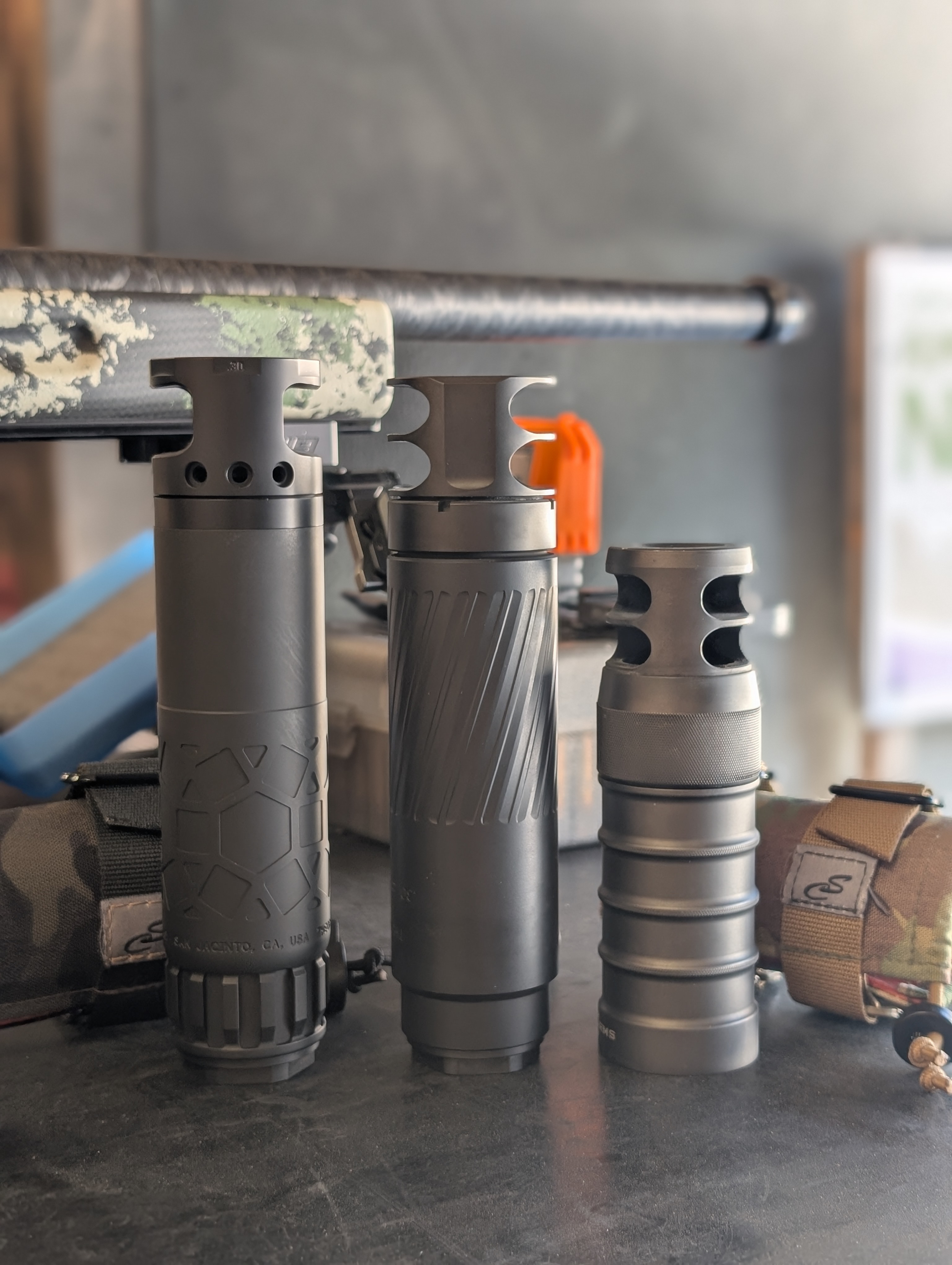

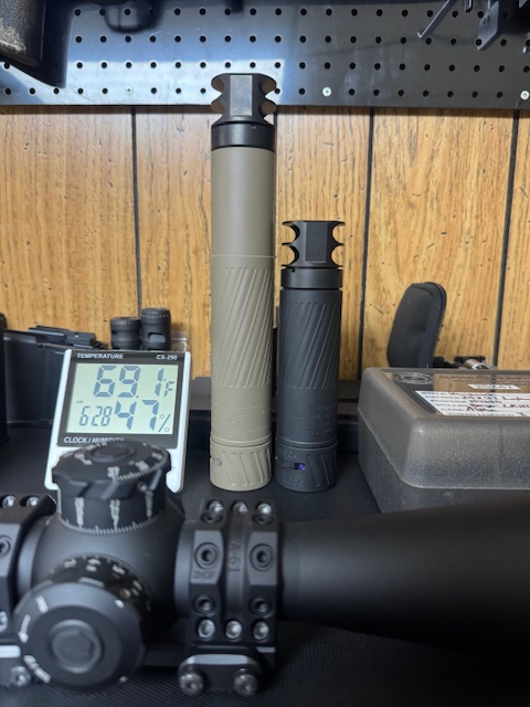

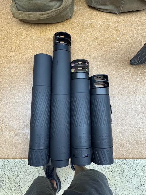

Ok, I finally got to go shoot these things side by side more thoroughly.
Let me preface that all these cans are bought with my money. I have no connection to either 3 companies. I'm a can whore and I like to collect them all.
First: They are all great cans! You honestly would be hard pressed to go wrong purchasing any of these products. Obviously the Abel is newer and the Maverick is older. I anticipate as many more shooters shoot braked suppressors, the industry will respond with better performing products in the years to come. I am looking forward to it.
I have ran the Maverick for many PRS seasons (4-5?) and consider it a gold standard for braked support performance in the current LR shooting sports. No, it does not make things quiet. But it does make things manageable and pleasant to the shooter. Getting blasted by a brake for 2 days sucks.
I enjoy the Magnus. However, I find it way more effective on larger caliber (aka magnum) rounds than 6 mm, 25, 6.5, etc... It just does not do it for me in terms of reading a target after the shot. Is it impossible? No. Is it shooter error? Maybe. I am pretty comfortable behind a rifle. With that said, I'm sure there are BETTER shooters out there that are evaluating the very same thing.
Last, the Abel. I honestly wasn't going into it thinking I was going to be impressed. In my head, I thought "oh, another TBAC-like can." I was wrong. The Theorem S-braked is stellar! Like, it works...
I shot a 13 lbs rifle in 6.5 (my PRS Sportsman setup) and the braked performance AND suppression were quite pleasant. I wanted to shoot a lighter rifle as I know shooting my standard Open configuration (22 lbs) wouldn't really show the performance/weakness to me. Having shot the Maverick for so long, the braked Theorem S really surprised me. I will continue to use this through the remainder of the matches this season and, potentially, into the PRS Finale.
All shots were either in modified prone or off a standing barricade with no rear support (tripod).
Take it for what it's worth, this was just an in-my-pants-feeling review. ;-)

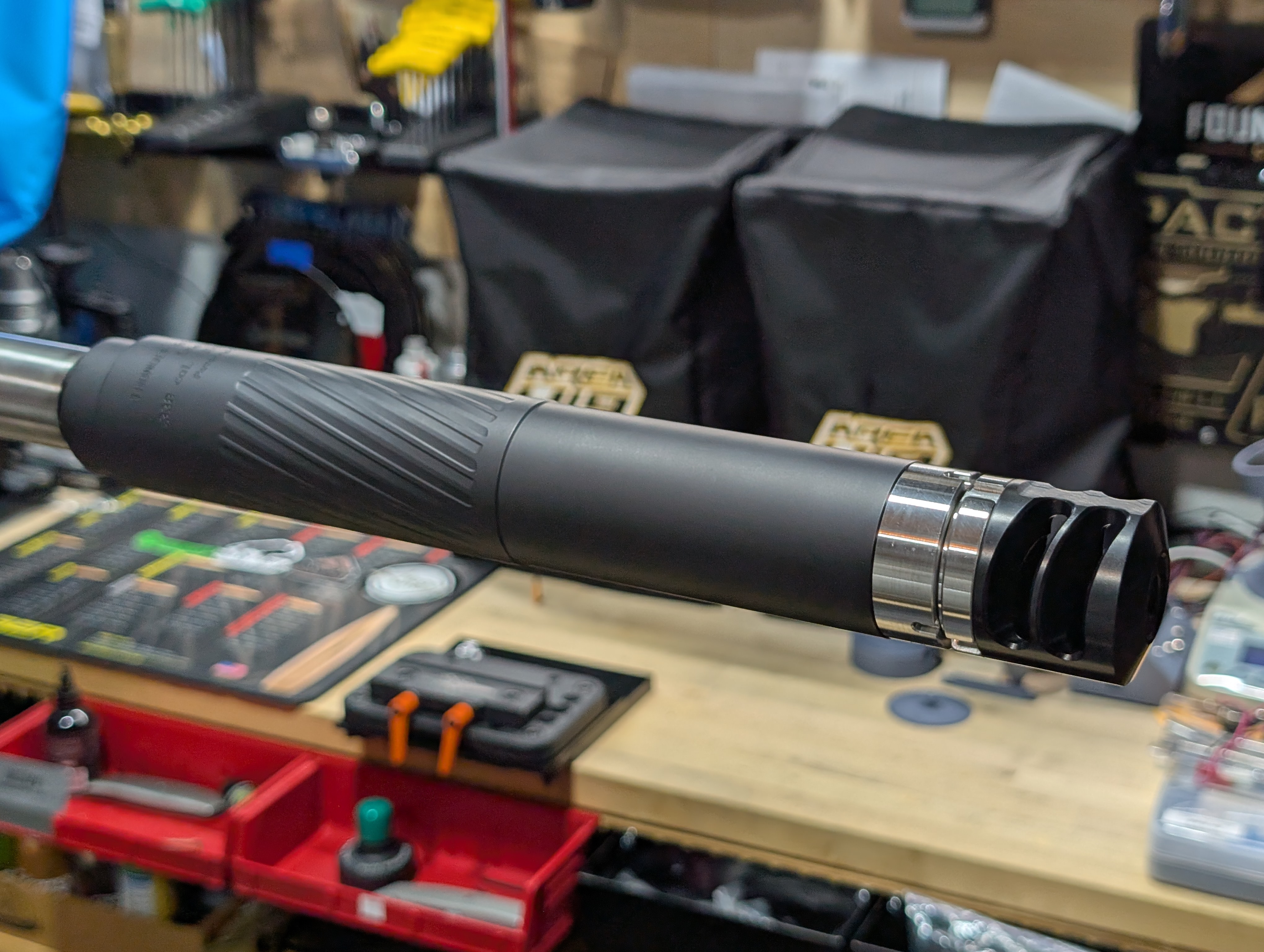

So Abel is coming out with a 6mm specific brake, I mainly shoot 6, though thats limiting if I choose to shoot 25 or 6.5 at some point. any reason to not just go with the 30 cal brake? I have the middle child Theorem.
I would be curious to see the % of difference between shooting them both. I shoot .22 cal through .264 and .308 brakes and honestly couldn't tell you i feel any difference. I'm sure its something but probably not a discernible difference.
So which Theorem size is more effective with the brake? My guess would be the short because the gas moves through it faster?
I have both the Thoerem and the Theorem-S, both with Abel brakes. I don’t think there’s a big difference but do think the S has slightly less recoil. Abel said the same thing. I’ve shot the Theorem (prefer the quietness) way more but decided to shoot the S today. I was leaning towards leaving the Theorem on my rifle for PRS matches but not sure now. I like the few less decibels of the Theorem but the slightly less recoil of the S but not sure I really prefer one over the other.

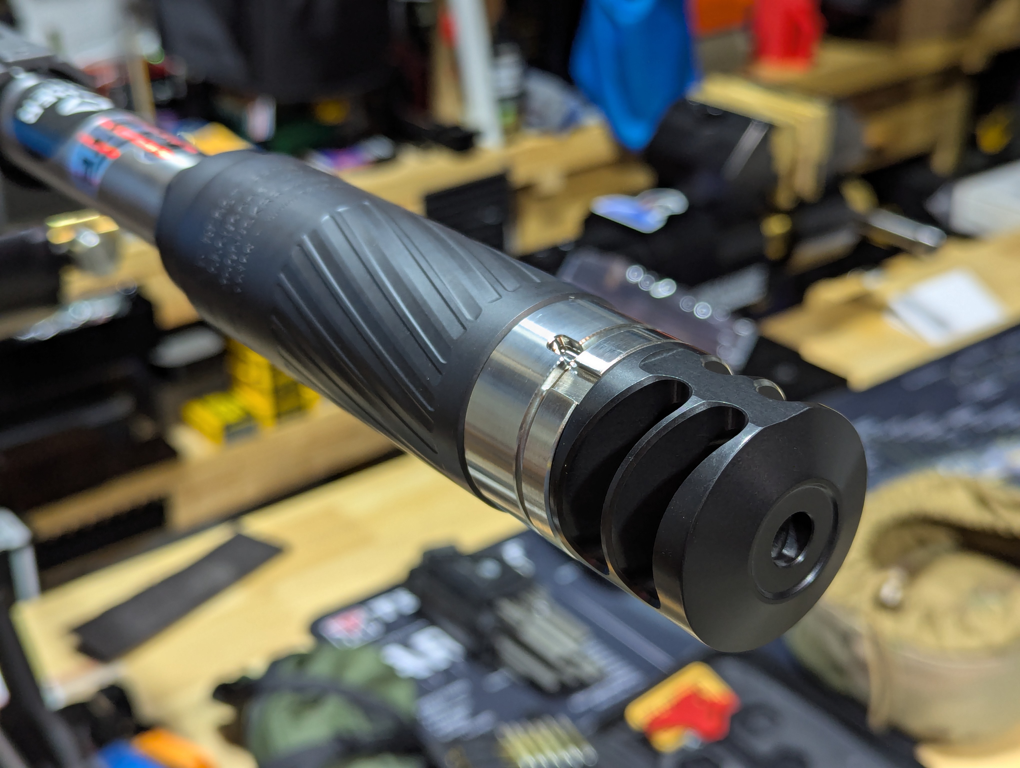

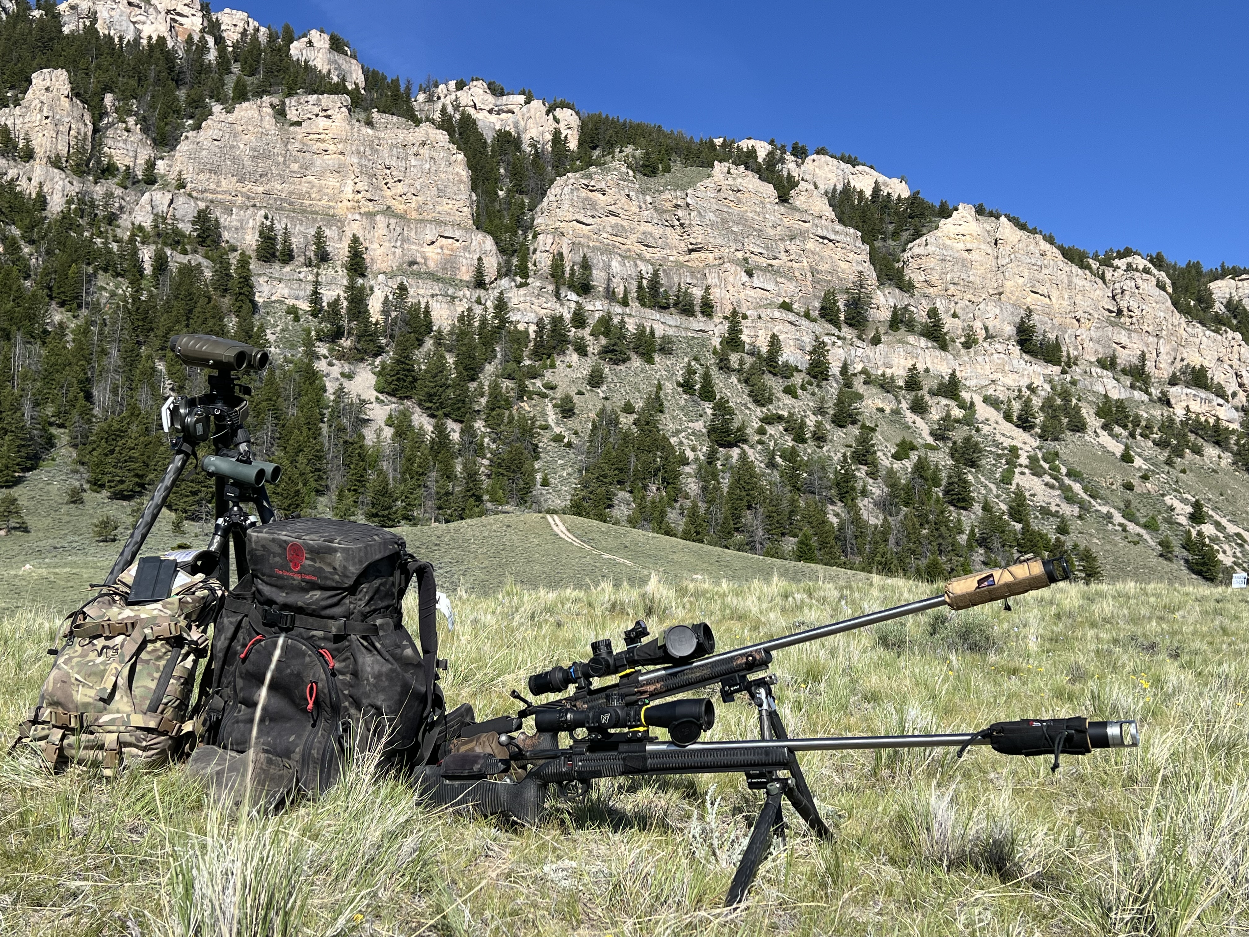

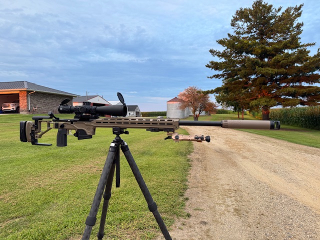

The Abel “L” is definitely nice..I love TBAC but I honestly think the Abel is better as far as recoil control. The Magnus S-RR is comparable in size, and I think it is quieter than the Abel. Really happy with it. Printed some of my best groups ever with it too…

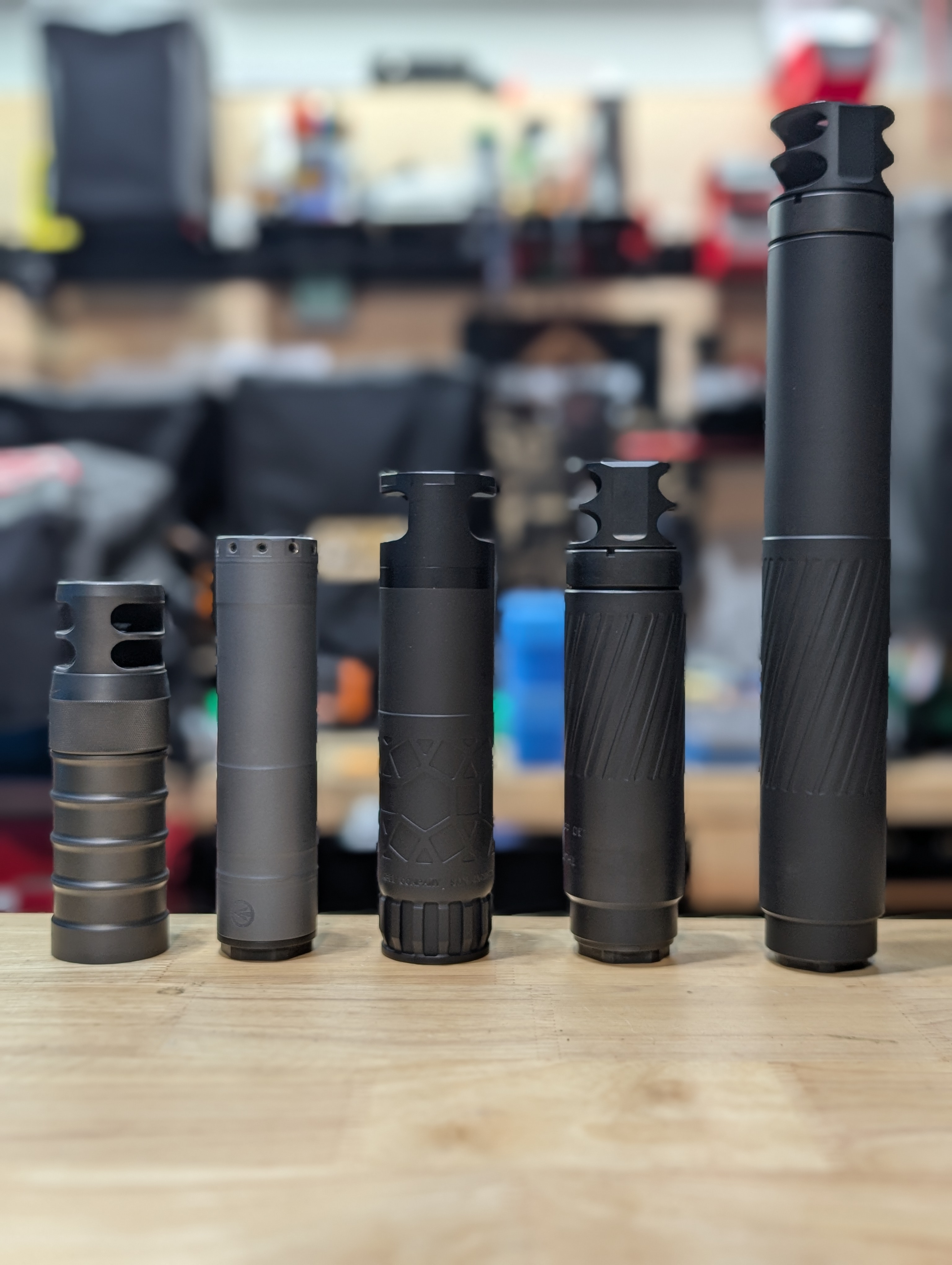

@NiteQwill what's your opinion on the Abel now that its been a little bit? I have since gotten a 6.5 cal maverick and i do like it a lot, shot 2 matches with it, got about 500 rds with both cans on seperate rigs/same caliber chambering, but shooting back to back with the Abel "L" with the brake im almost gravitating towards the Abel. I was thinking about ordering another Abel, the Short or the Standard.
I like both. The short config of the Maverick works well with 6mm. The Abel, I've shot several matches with 6.5.
I have since added the Recoil X to my Magnus cans and it's like voodoo magic. Beats everything. 😮

Less recoil and less noise? I shot my abel and RR side by side the other day and I have to say the felt recoil and "target jump" was less with the Abel. I have always owned TBAC's, but the Abel can is really nice.
Yes, for the Magnus RR + RecoilX. It's better than the Abel. But the Abel is no slouch either. I honestly would shoot either. The weight advantage goes to the Abel 💯
Reactions: shields shtr
I fired 20 rounds of dasher through my full size Magnus RR, then swapped to the recoil x brake. I noticed almost zero difference. I figured it’s because it’s such a large can and such little powder that changing the brake on the end isn’t gonna do much…
Now I did the same thing with 6CM on a Magnus S RR, and noticed a difference. However it was definitely a little louder, but the recoil x brake is much better. Interesting you found it quieter? Or were you saying the Magnus was quieter than the Abel, if so then I 1000% agree there.
However with a standard RR brake on the end of my Magnus, the Abel with a brake does indeed have less muzzle jump. I am not sure the reduction but I would say the Abel can easily be kept under 2 mil of jump.
Reactions: NiteQwill
Yea my reply was prompt. But I certainly think the smaller calibers are a wash on the Abel and Magnus. The larger you go, in my case 6.5, makes it perform better (RecoilX).
