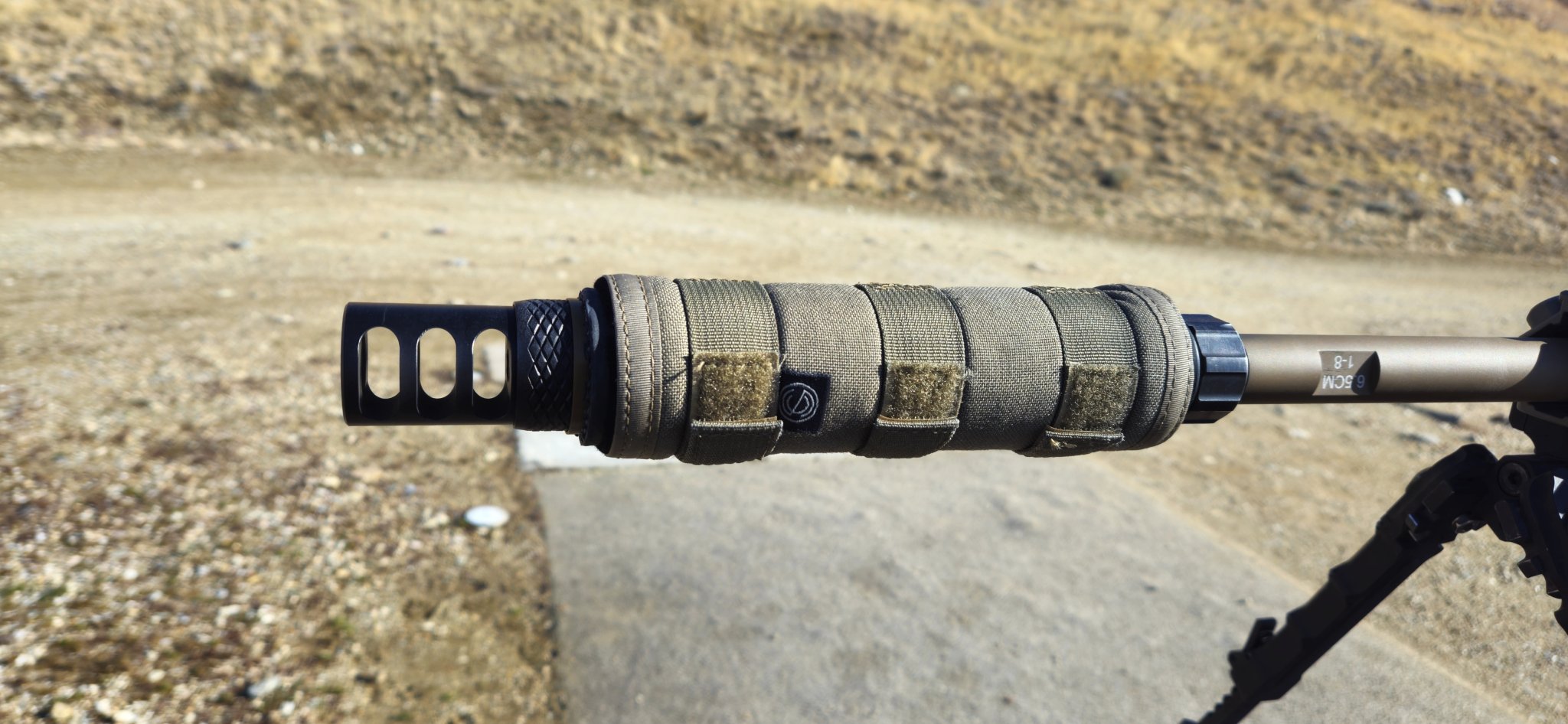

Been testing this puppy from @RecoilXBrakes ... Been pretty pleased so far.

Is it the Chairman K size ?
It'll be a few months before I'm even able to acquire a suppressor in my state, however i just got ahold of a Chad Break. Well i actually ordered 3. It is by far the best one I've ever used. I used it on 6.5, 6cm and 25x47. Recoil was way easier to manage, and it felt like it had a much more straight back push which i really like about it.
It is loud. I did not measure it, but definitely loud. Seems to have lot of blast to the side too, which is fine with me.
