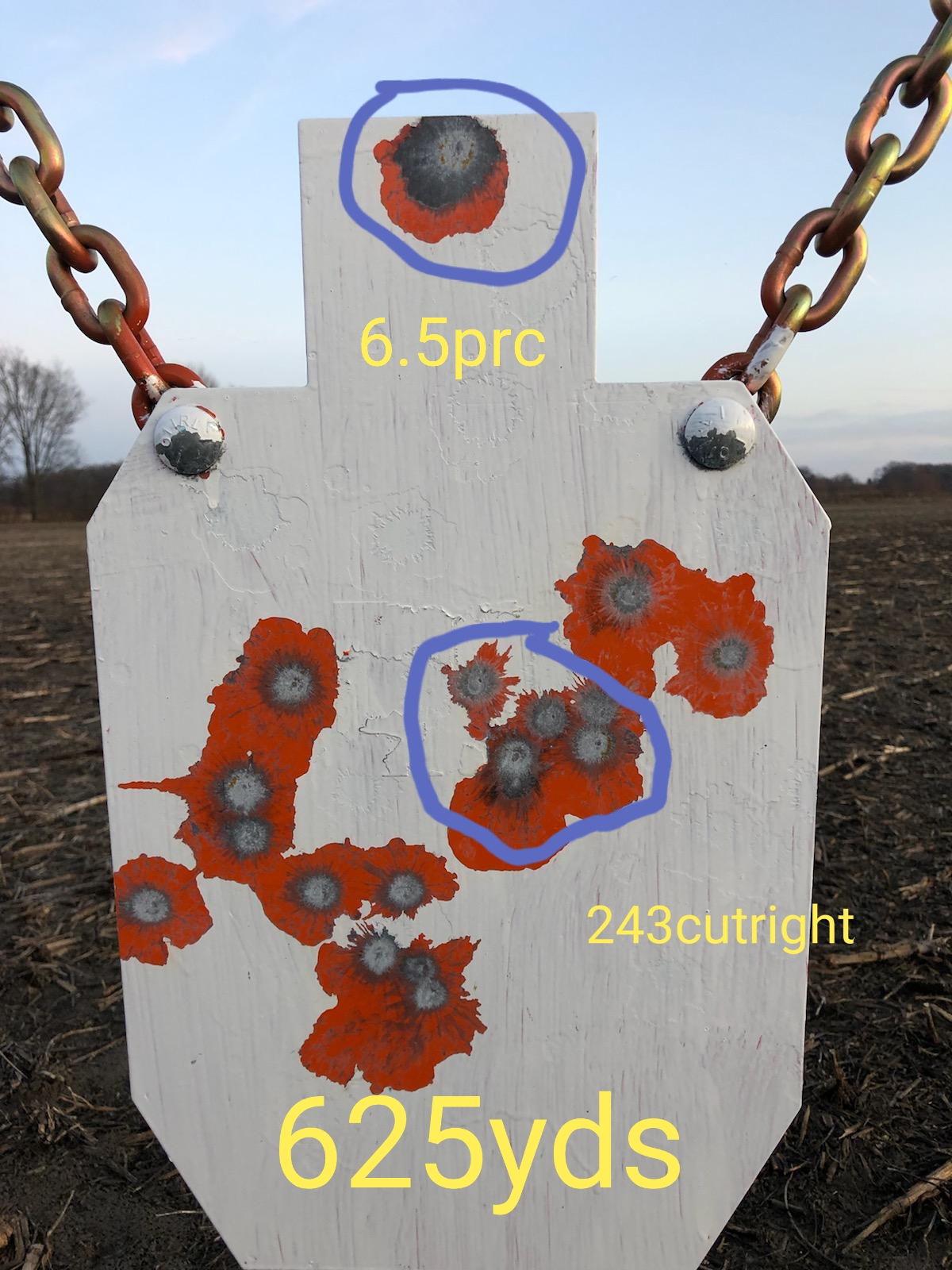

Prc does make the wind its bitch, or at least makes it easy. Target from a nasty switchback gusts. Friends were getting ate up by wind with 6.5 creed's, my 243cutright and prc did fine. I only shot one rd with prc, cold clean bore and called a headshot before I sent it

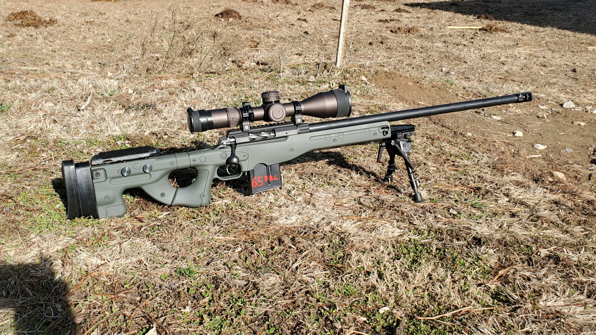

I dont mind it at all, but I'm used to 60°. I'd rank it below my well used ae's and my melonited badger 2013, but better than the at I had. If I remember correctly it partially cocks on opening and fully cocks on close. I had an axiom, it felt nice, but I had some issues with it including one bolt lug that didnt even make contact when in battery. I would steer clear of those. I actually traded that axiom barreled action (had a 18" cheap 6.5creed barrel on it) for a new deadline action, 308&prc bolt heads, action wrench, deadline barrel nut & nut wrench. I'd gladly make that trade again today.
I should add, the deadline is no impact, ive got one. So if you are looking for buttery smooth cycling then I'd pass on a deadline. The deadline does have several things going for it, but also a few small hurdles. The bolt is very similar design as an ai ae. Oversized bolt body that rides in action, and no lug raceway. Bolt stop doesnt impact on a lapped lug(good thing), but because of that big bolt body, the rear action screw is a little shorter and mag will need to sit lower. Meaning, on a chassis, the rear screw will need shortened and probably the mag latch will need shortened. I had my deadline in a manners mini chassis gen2, krg w3, and aics(bedded tang).
