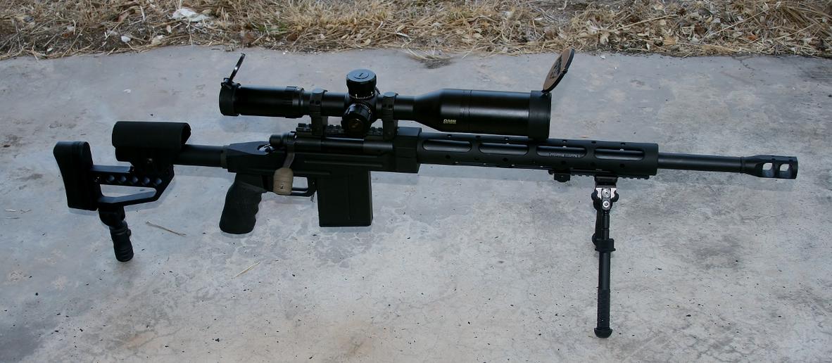

There would not be much difference in action to stock fit between a chassis and a bedding block stock(hs&bc). They both have a rounded bedding surface that mimics a "standard m700 action", if ur action is warped then the stock will not compensate for that like a proper devcon bed job. An AI stock with the v bedding would be good or a Mcree. I tried a xlr on a custom tikka the machine work and attention to detail, combined with light wt was great. I could never get comfortable and consistent behind the rifle, it now wears a krg w3.

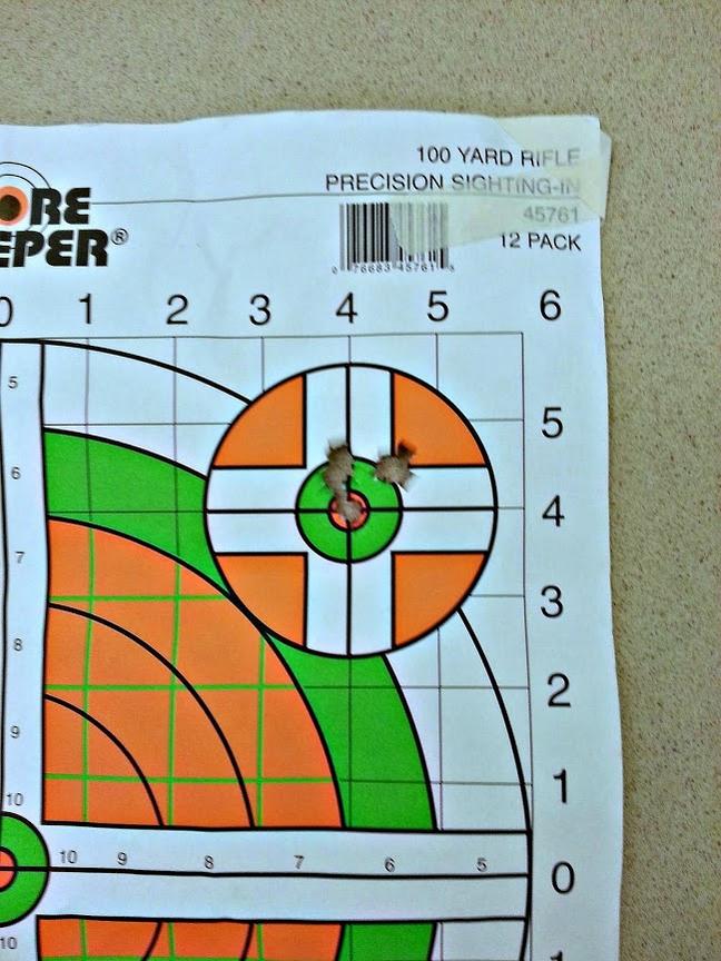

this is my 100 yard sight in 5 rounds I need a one more rear sand bag to get a studier hold
