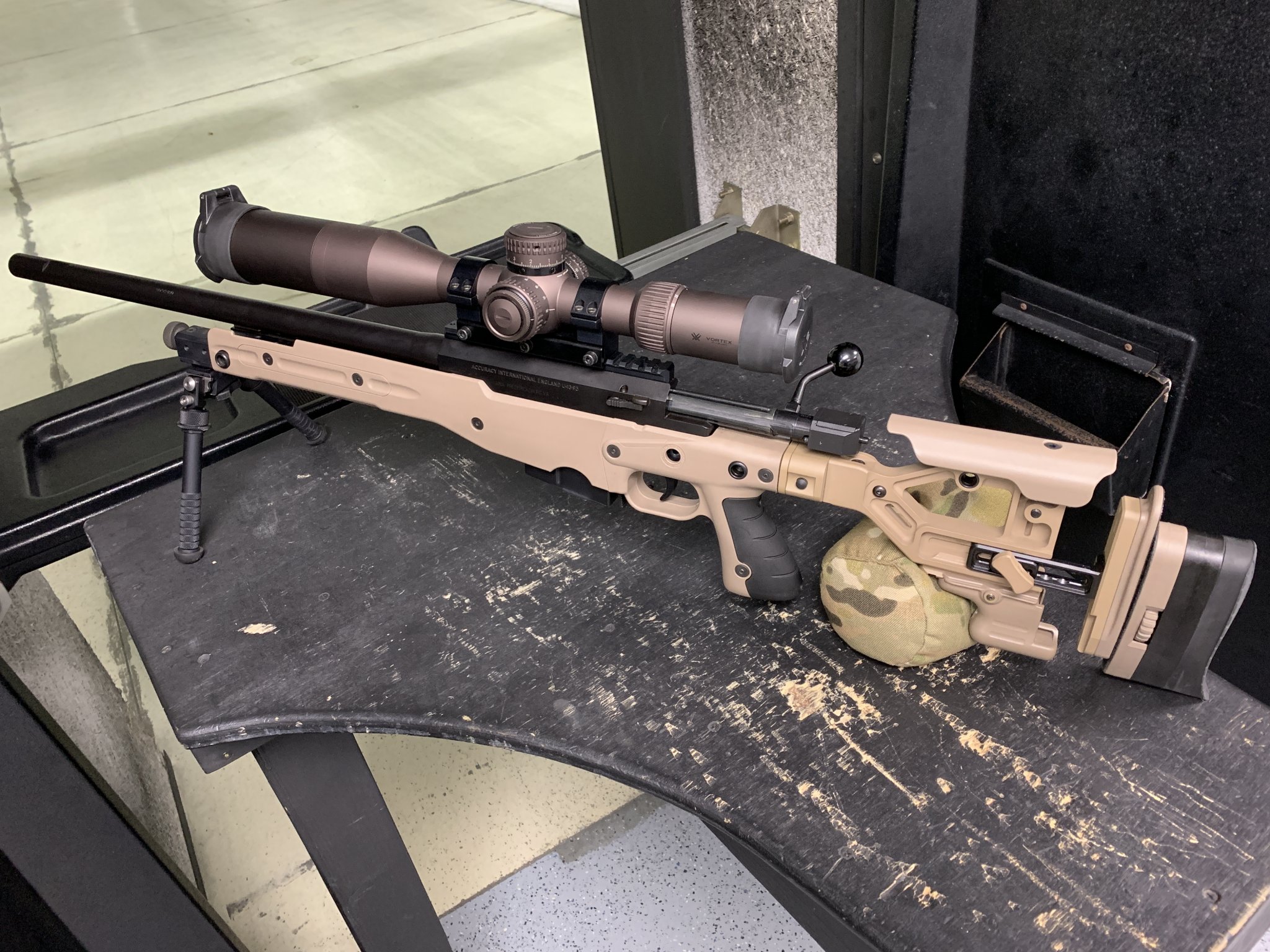

Is this just a bolt on task or do you need to send this to a smith?

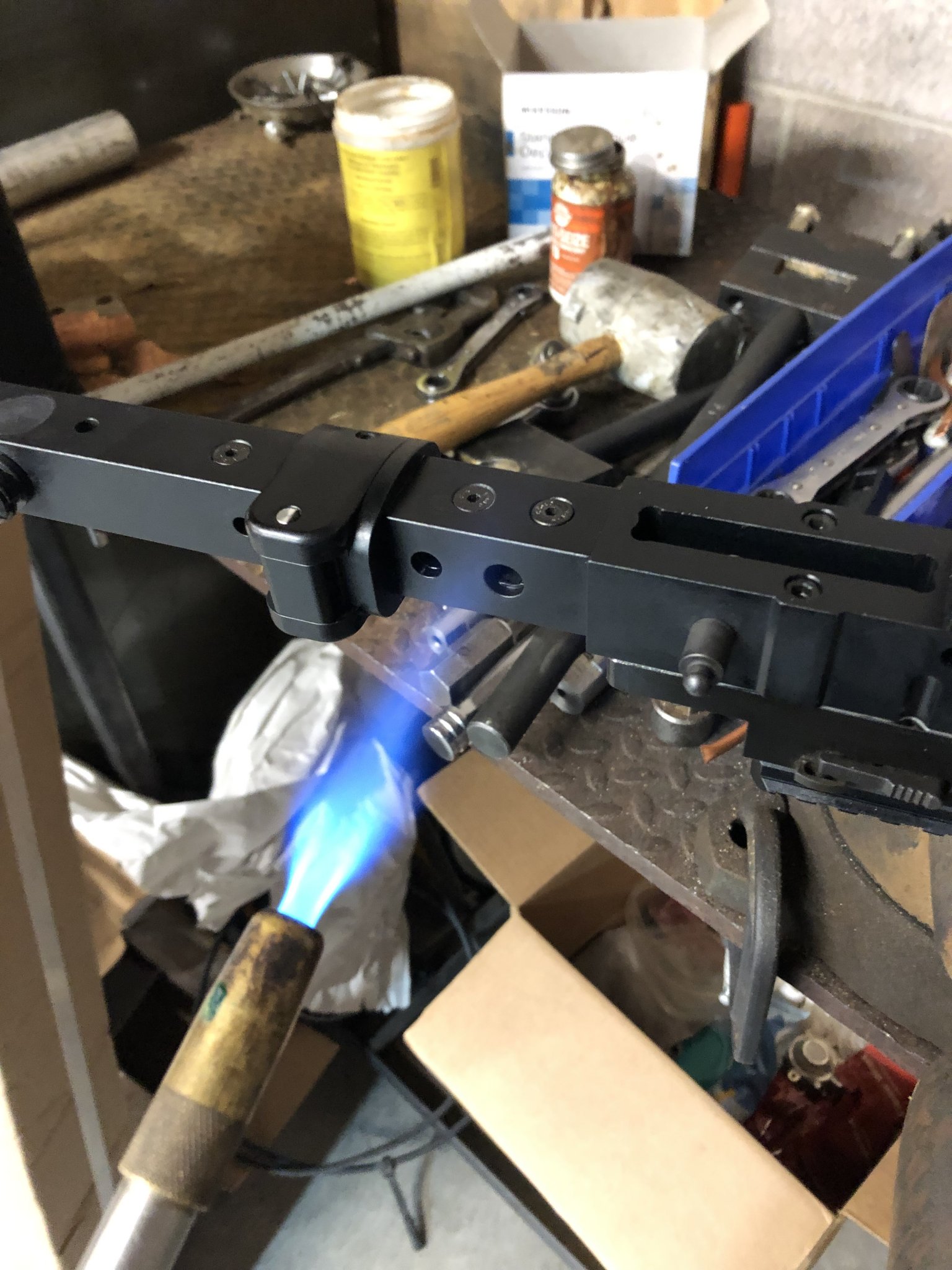

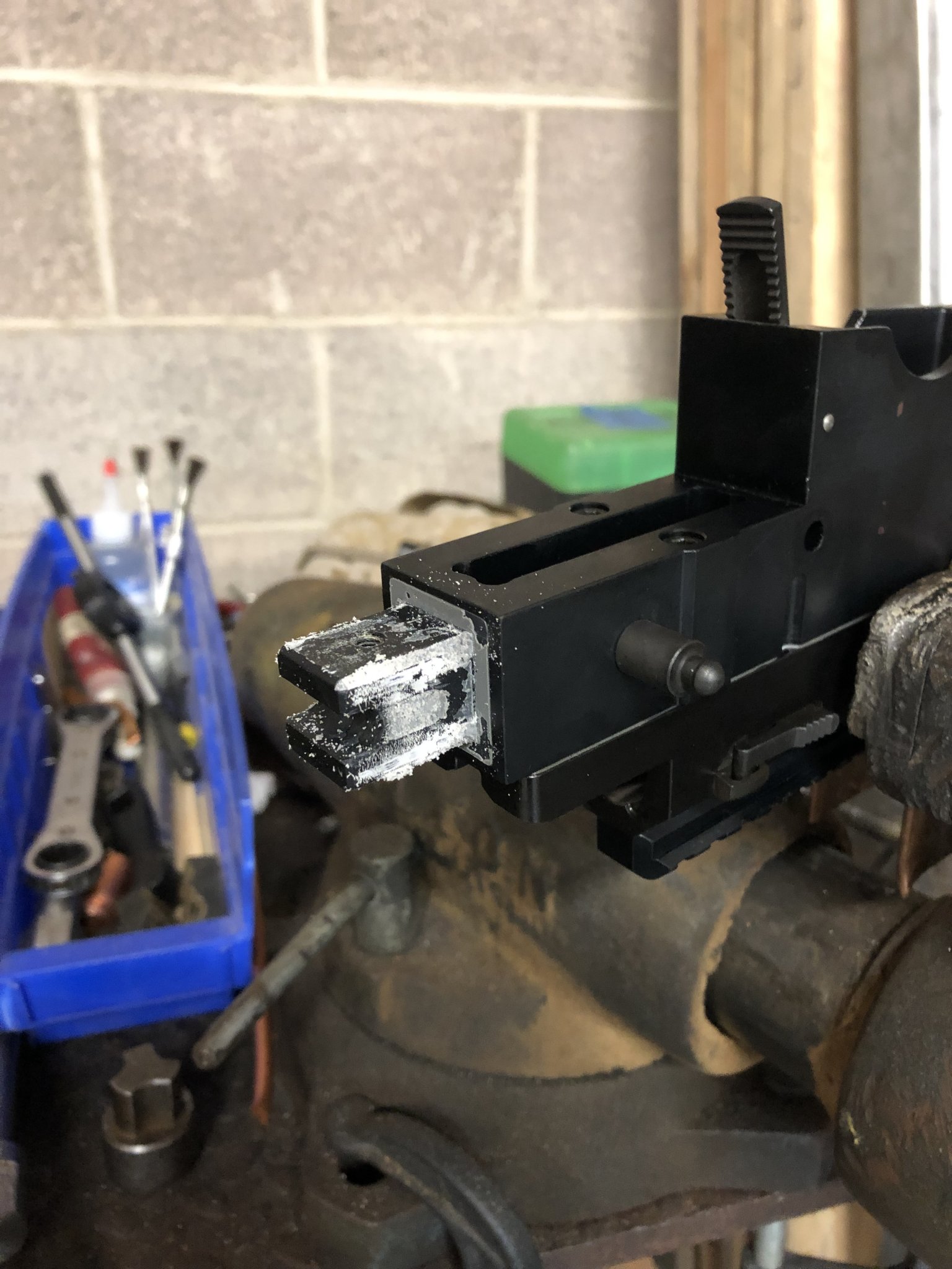

The stock is bolted and epoxied to the chassis. If you feel comfortable heating the chassis and tapping on the stock to get it off you can certainly do the conversion yourself. I did mine.
Thanks, do you have to re-epoxy upon install?

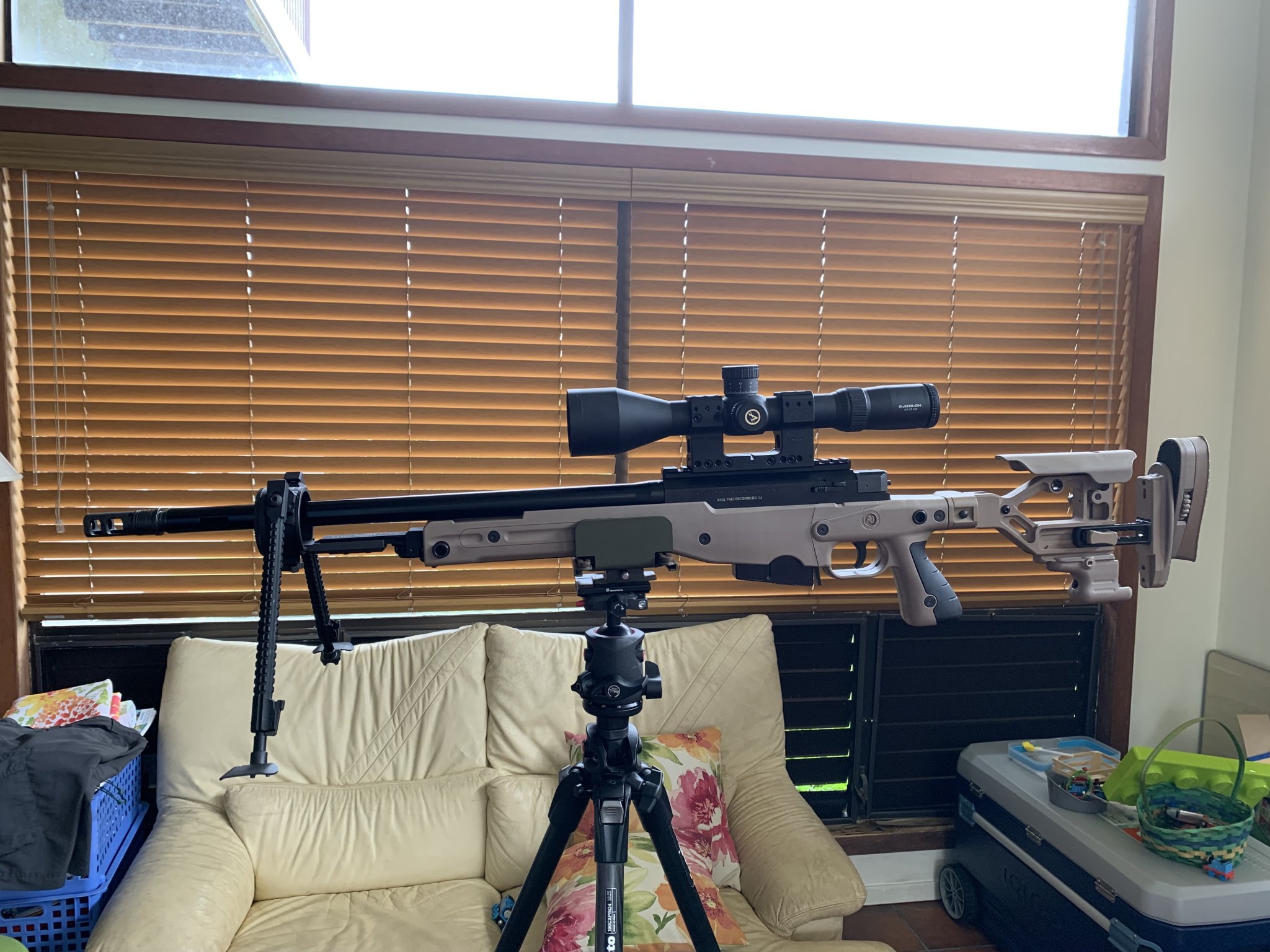

Here’s a pic of mine pretty easy to do.

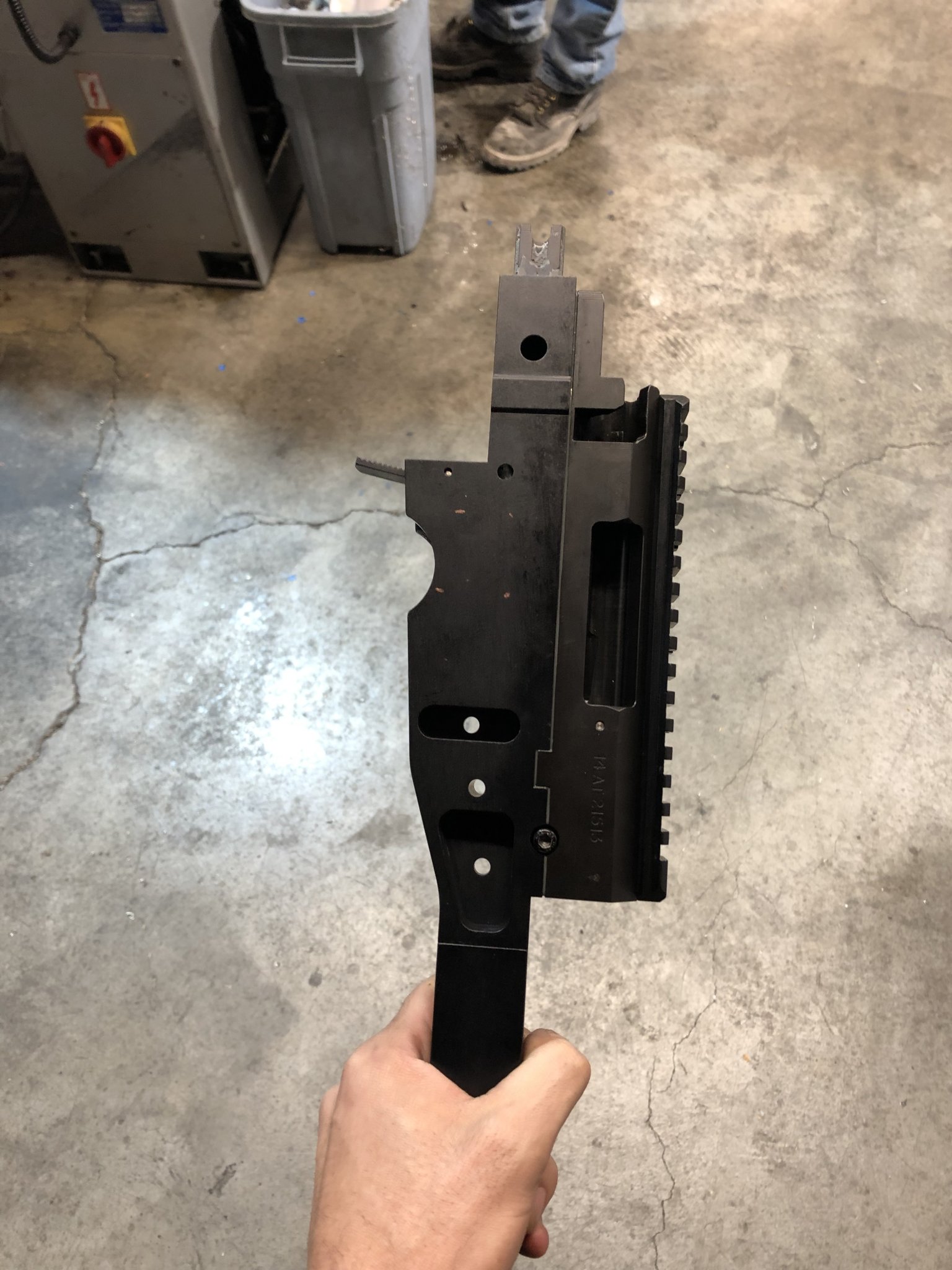

So with a folding AT, are we just heating the portion where the folder is to change it out or the entire action?

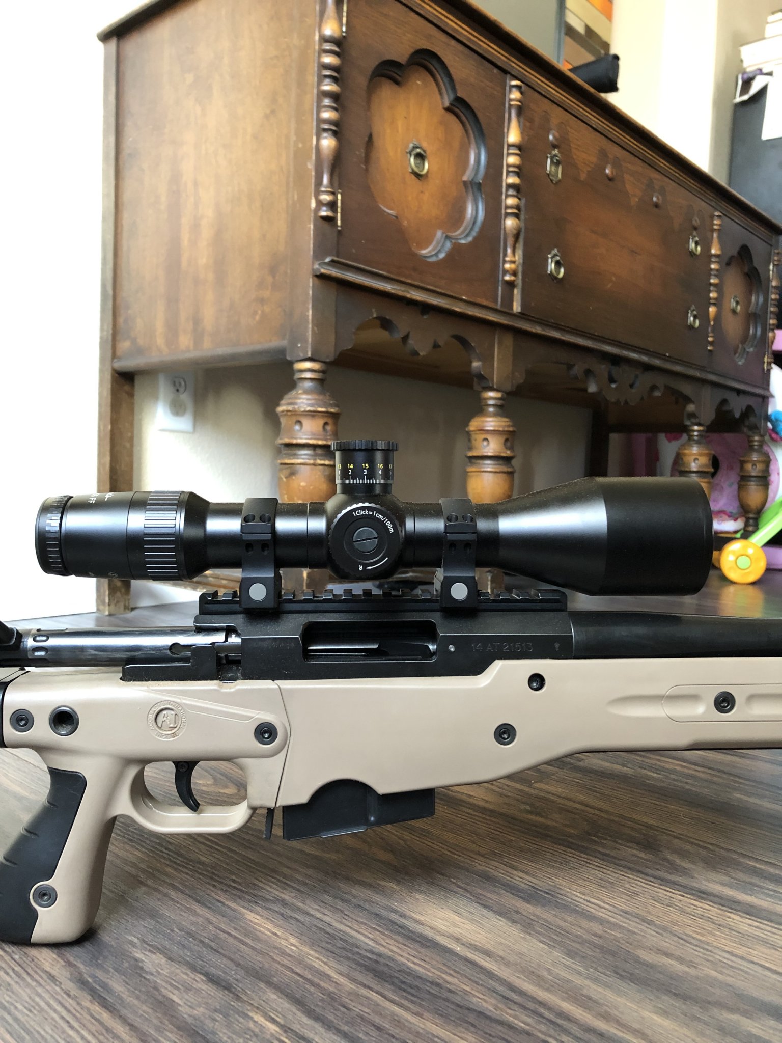

My guess is you’re going to be close. My stock is bottomed out. I have the short rail and run the short AI 0 MOA Picatinny Mount

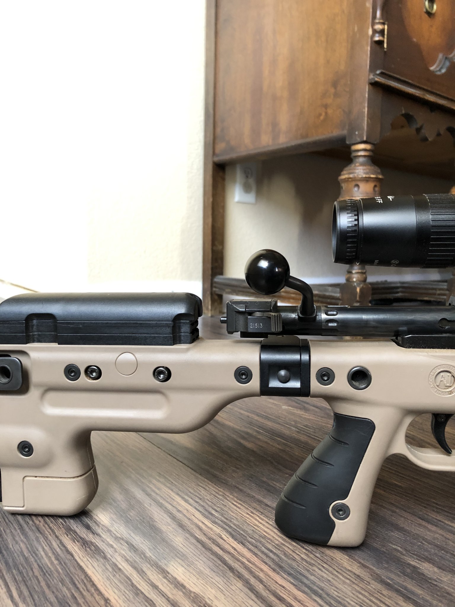

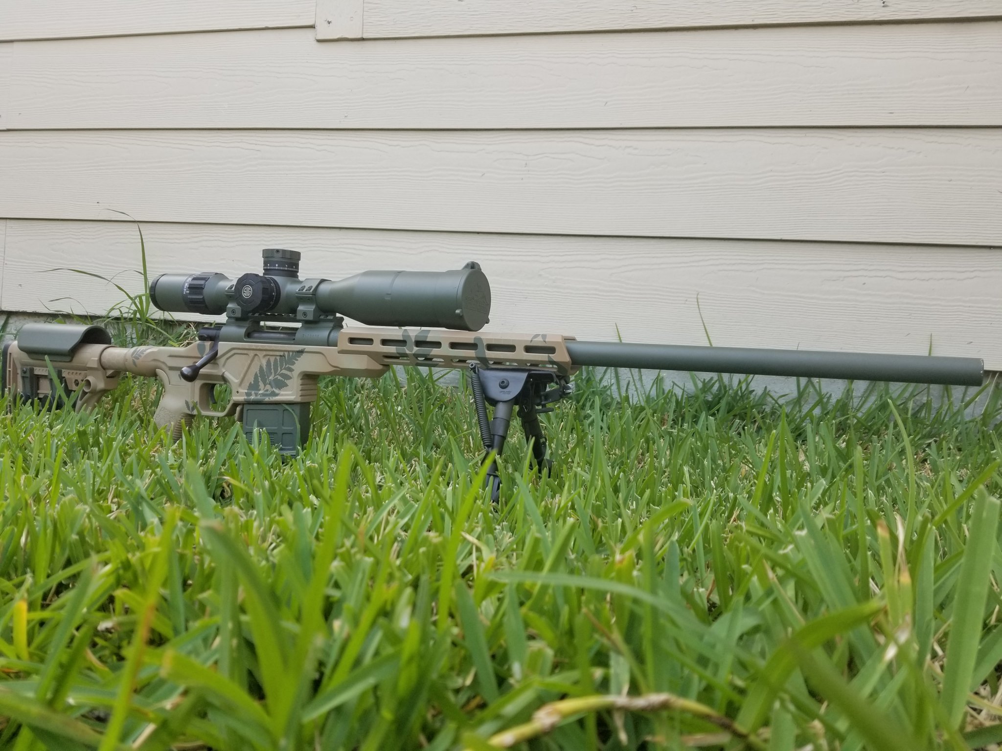

I’m finalizing the design of a replacement cheekpiece for the AX that will go about 3/8” lower than the factory one. It’s a direct bolt-on accessory. Should help all you guys (myself included) that need a slightly lower cheekpiece when the AX buttstock is on the AT.
Fingers crossed, hopefully I’ll get a tracking # Monday.
Reactions: Luvman

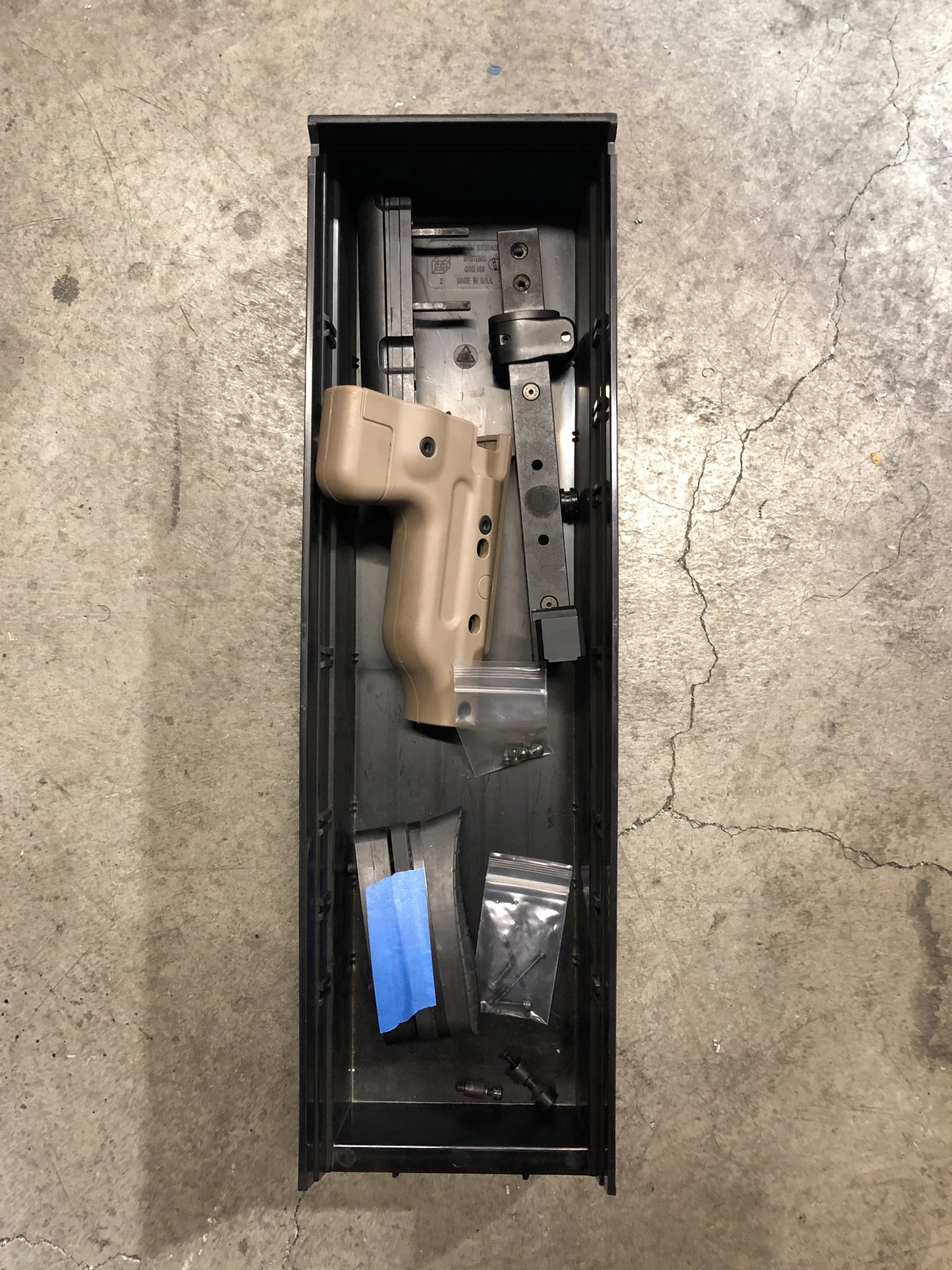

Conversion kit is set to be delivered Monday. ?
Absolutely. I have my fingers crossed the adj. comb will be low enough for the rings I have the scope mounted in.
I think you’ll be ok. Your cheek piece appears to be higher than I had mine set. The AX stock has a flat instead of a radius like your current stock.
The storms are interfering with my rifle project! Delivery now set for Tuesday.
