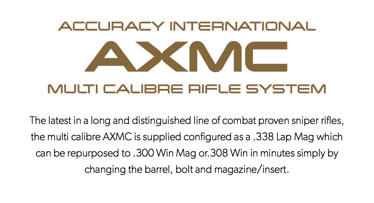

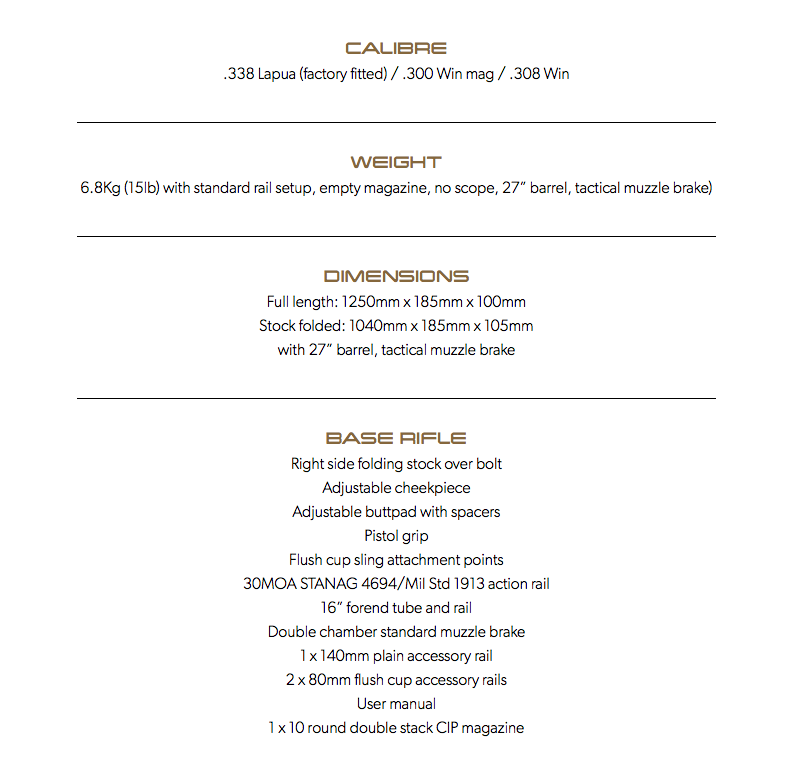

    look at the AI Website, nothing about other calibers
    The fact they make a barrel is a function of capitalism, it's not really a factory offering only that people request it, but the AI Proper site says nothing about it is my clue, it's a case of, if company X Y and Z are making them we should too.
    as noted the limitations have been spelled out. I have said over and over, my 97 AW 1.5 has been a 260 since 2007 and never pierced a primer goes against when and why they switched, cause guys making aftermarket barrels were piercing them and the pressures increased on the 6.5s but mine has never pierced a primer. The 97 AW was never advertised as a 260 and they did not make barrels. WIN Tactical Makes the barrels mainly because others do too so why not keep it in-house. Doesn't mean it's a 100% every time, it will work is a by production not an advertised feature by AI
    QuietShootr
    Feb 5, 2003
    448
    84
    I mean, you’re way smarter than I am, Frank, but it would seem to me that if they sell 6.5 barrels without even a disclaimer that they might not work, a customer might reasonably expect that they should work.
    Whatever. It’s a disappointment, but the dealer took care of me, so no harm, no foul, I guess.
