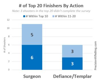

This is from the PRS 2013. I believe most of these guys can afford to shoot what they want, but on the flip side probably sell the stuff they shoot.... I find it kinda funny there was as many savages used in 2012 as AI in 2013, but then savage dropped off in '13...
