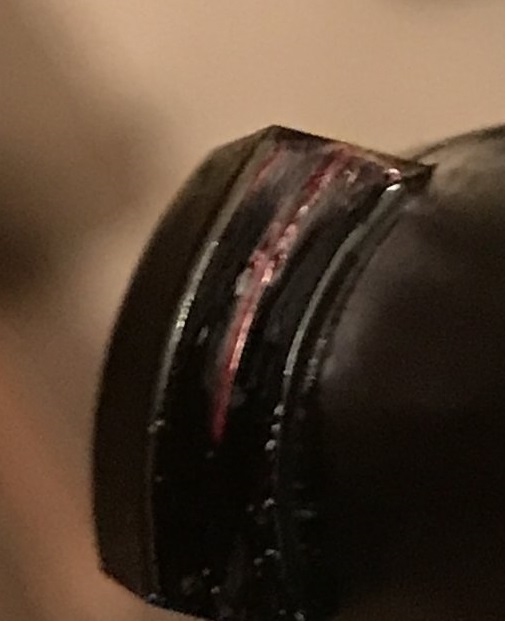

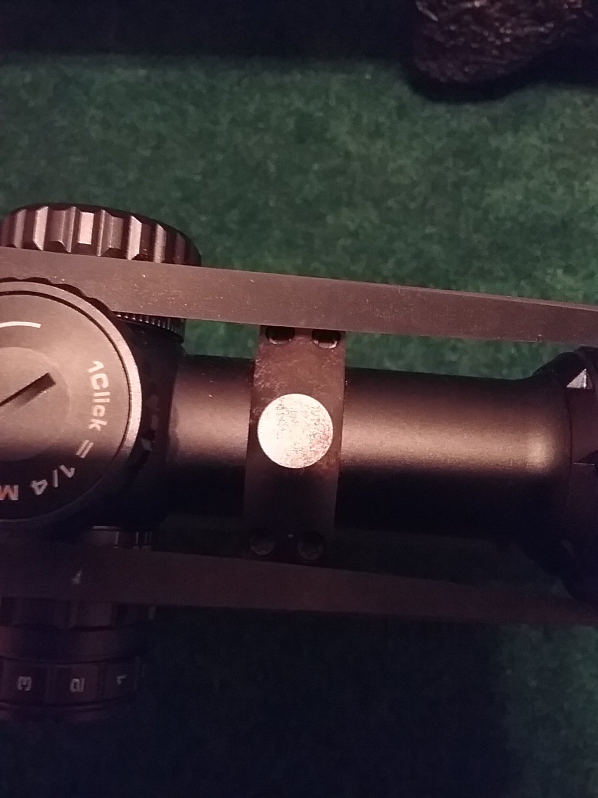

There was another issue I had with my rifle that I found not long ago.
When I bought my scope I purchased a pair of MDT elite scope ring/ bases which, I think are excellent value for the money.
During load development, I'd notice these stringing shots that always seemed to move up & left or up & right. This didn't happen every time I shot but I have quite a few targets with this same shot stringing.
Anyhow, long story short, instead of the usual square pic rail cross pins, they have round double scalloped pins which must be orientated in one direction only. Since I need reading glasses, I didn't see this & have been mounting the scope on the pic rail with the cross pins the wrong way about or worse, one correct & the other upside down. Initially I did notice that the cross pins were round & thought that was unusual because all my other pic rail mounts have square cross pins. Not wearing my glasses though, I couldn't see any detail so just thought they were round & I suppose both pins must have been 180 deg out so both looked the same. I simply assumed the pins were round.
Since mounting the scope properly, no more stringing & the shots seem more evenly dispersed.
Thought it worthwhile mentioning. Might be something else to check while you're going.

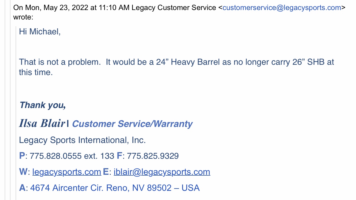

Update: For anyone interested, HS Precision responded today to my inquiry about the suitability of the PSS139 for HOWA 1500 rifles with a No. 4. contour barrel. I have posted their response below. My takeaway is that the stock wasn't really designed for the No. 4 barrel contour and if you have a HOWA 1500 HS precision with a No. 4 barrel contour and are getting groups larger than you expected, you might want to check the barrel channel for rub marks. If you have rub marks, it seems they are recommending you sand/inlet the stock to you heart's content.
"The PSS139 stock you have was actually designed initially for the Howa #2 contour, but we also have seen that stock install on the larger sporter barrels as well. Even though it free-floats initially, with the wear marks you are seeing, it is making contact when the round is fired. The PSV140 is designed for the #6 Howa contour and would work for your barrel, but you would have a rather large gap (free-float) around the barrel.
What I would do....I would take some 120 grit sandpaper and wrap it around a dowel or hard tubing (that is about the size of your barrel) and sand out (inlet) the barrel channel wherever there are rub marks. You will not change the structural integrity of the stock and you will not contact the aluminum block in the forend. Once you have removed the amount you want, re-install the barreled action and shoot it several times. Remove the stock and see if there are any more rub marks showing. If so, remove more material until no rub marks appear.
Hopefully that will tighten up those groups.
Thank you and have a good day!"

Update: I told Legacy Sports about the issue. They apologized and admitted they had made a mistake. I asked them if they could give me a HOWA Oryx in an MDT chassis instead of the HOWA HS Precision they sent because the HOWA Oryx comes with a heavy barrel (the HS Precision models no longer come in anything but a standard barrel). They agreed to do it if I paid the price difference between the two models (about $200). That was fair in my book due to the price difference (though not ideal), and I agreed to do it. I would have been much happier if they didn't nickel and dime me here (especially since it took them 5 months to even test the gun and to add insult to injury they sent something completely different from what they told me they were sending). As long as they actually send me the correct model this time that should be the end of this saga.
P.S. The woman handling sending me the new gun seemed like a nice enough person (I spoke to her on the phone) but she said she was new to the company and firearms generally. I can't say that comes as a shock given that she thought a 22" standard profile barrel is effectively the same thing as a 24" heavy profile barrel. I had noticed that their 2022 catalog didn't have the model she was talking about but I figured it must either be an older or newer model because one would assume the sole distributor of this product line in the Country would actually know what they were talking about...Apparently not...Anyway, that's my way of saying that hopefully this is an isolated incident and other people's customer service experience won't be the same.

Update: Even the new HOWA had problems. There was a deep gash in one of the bolt lugs (there must have been a burr or something on the lug recess) and minimal contact between that bolt lug and the recess. I sent it back to Legacy Sports. They wanted to replace the barreled action but they wouldn't get a replacement in until March. I ended up asking for my money back and Legacy Sports gave me a refund.
