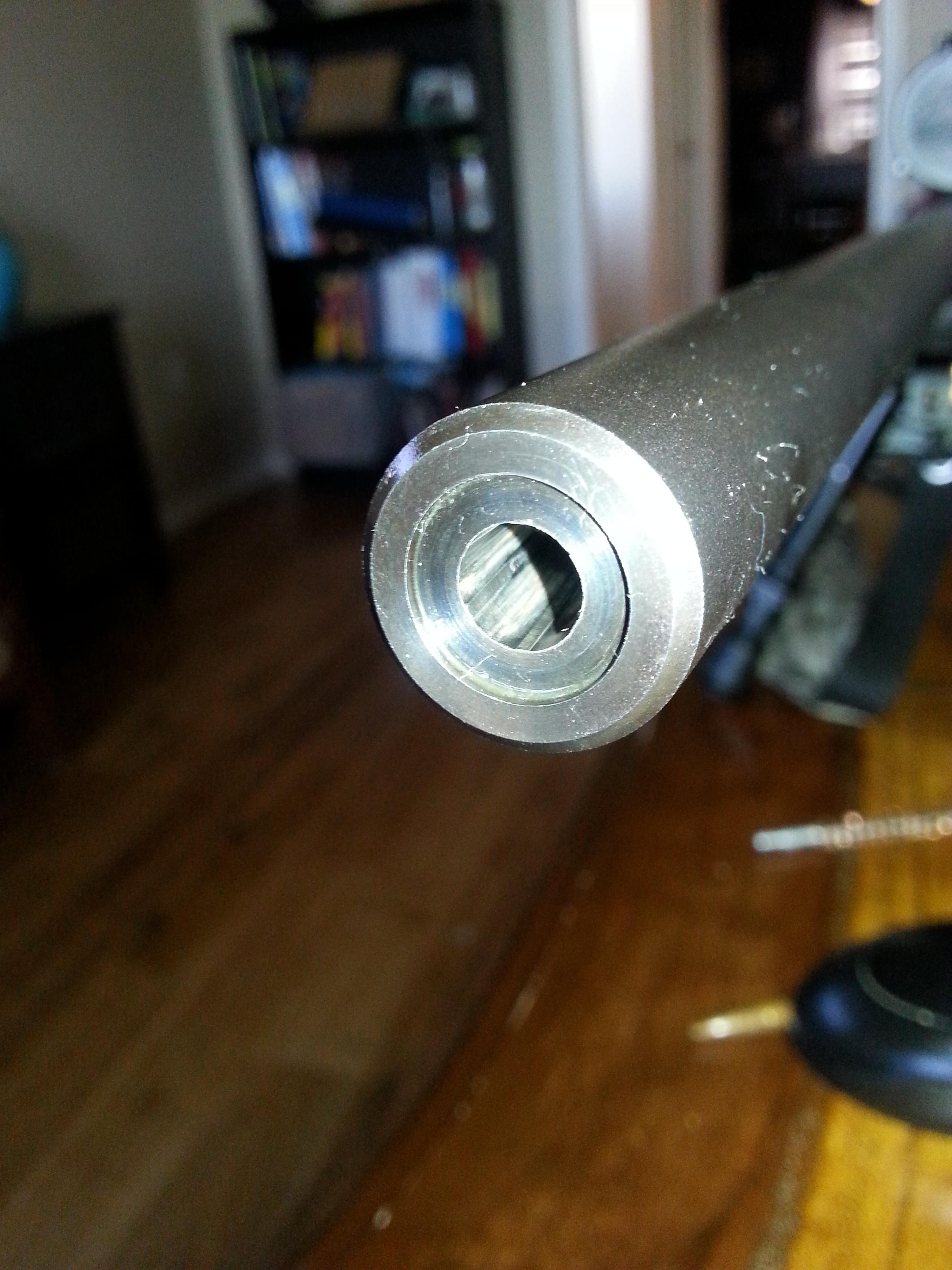

I have a bore brush and i have ran it threw several time im not doing it 100 times. I have soaked it with sweets but i clean it out then put oil on my brush and run it through about 20 times. Everyone has there own ways to clean there guns heavy cleaning or light cleaning i have seen people get results from both. I cleaned most of the copper out with a few specks remaining the white streaks that i see i have no idea. No matter what i do those white streaks remain, you cant see them unless you put a led right up to the barrel but what worries me is the fact the one side has these streaks to the muzzle but the other looks has none and looks bran new as you can see in the pics that i posted above which makes me think there may be an imperfection in the barrel and this is the real reason that posted this.

I have cleaned most of the copper out with a few specks of it here and there, but those white streaks do not seem to come out after cleaning and i do not know what they are. What was concerning me is the fact that one side has these streaks all the way to the muzzle and the other goes 1/7'' back and looks like a bullet never touched it. I was wondering if there may have been a defect. (see picture Above) Or if anyone else has this and is something to be worried about. I was trying to make a check list of things.

That rifle should shoot. It could have a bad barrel or it hates the ammo you have tried. The plastic stocks suck and will not shoot well from a properly loaded bipod. Sounds like a process of elimination. Start with good ammo then eliminate other sources, bipod, base rings, scope etc. I did not notice what kind of rings or base you use. I have done battle with crap bases and rings until I have almost pulled my hair out trying to figure wtf was wrong with a rifle. I would not obsess with the streaks in the barrel until you eliminate other much more common issues. Clean it, shoot it, report back.
