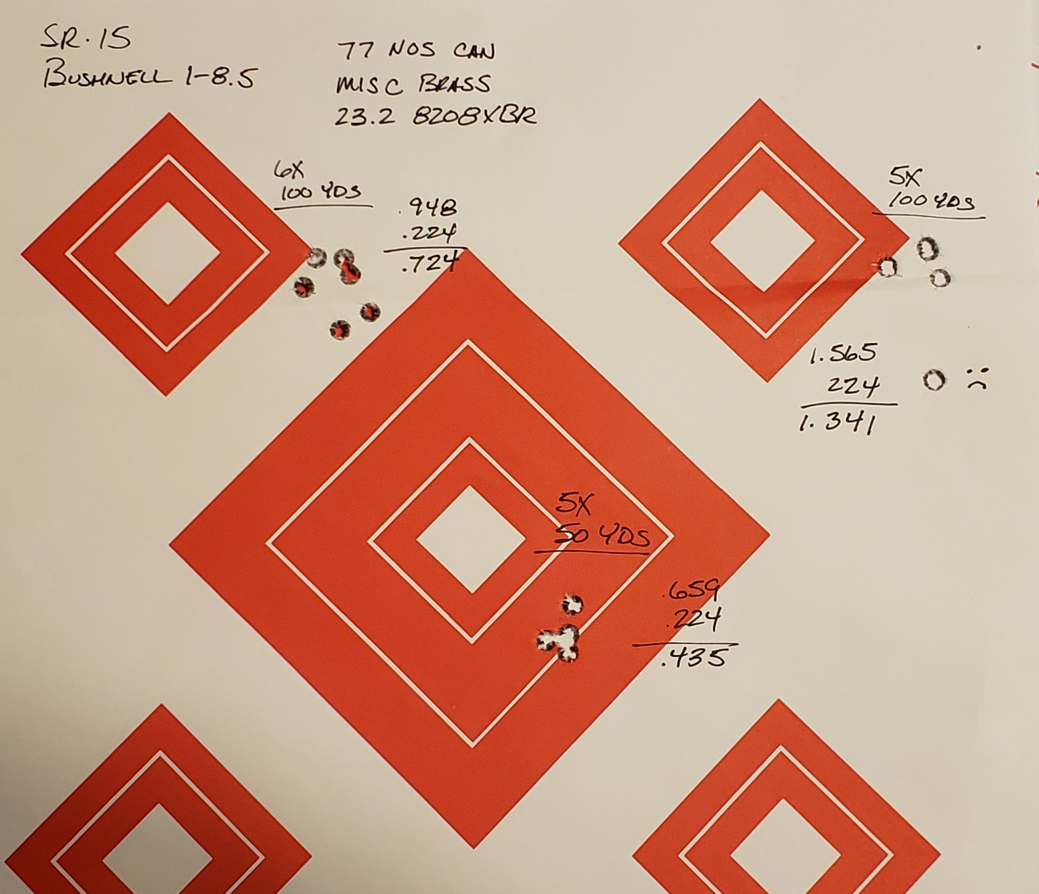

When I sighted in my KAC, 77 Noslers
5X@50
6X @ 100
5X @ 100, with one I dropped
