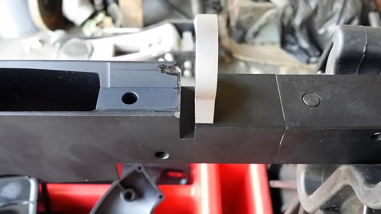

so I have an ACIS 2.0 stock and the action and barrel i have to put in it has a 3.0 recoil lug. The stock itself is set up for a standard recoil lug and i am just trying to confirm that it is OK to open up the lug recess area for the thicker lug. It sure looks like there is plenty of meat there but just want to know if there is anyone with first hand experience. Here is a picture of the area with the lug sitting on it.
I have opened several up with no problems. Be sure to remove the material from the front of the lug recess so that the lug still sits squarely against the back of the recess.
Another thing. If the lug is too long shorten it instead of cutting the chassis lug area deeper.
I was thinking about that but I did some measurements and it is just a bit short so I don't have to do anything.
Thanks again everyone for the info.
