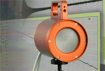

Ye sir, you got it right. Moreover, super experienced shooters like David Tubb (plus many others) are measuring MV even when competing, that alone says a ton about the right way to assess MV.
Plus, applying some common sense, how come that BC and Drag are measured with Doppler, accoustic or systems like Oehler 88 and 89? How come the industry and the military is not doing POI-based MV truing? Are they idiots or what?
Wouldn't be exceedingly more simple and cheap to use POI and call AB and Kestrel to do their magic MV truing?
Well...the answer is NO. Even AB has a Doppler radar not for tracking velocity downrange...but to measure MV!
7081759
7081760
Just check the above picture, where we can see AB measuring MV with TWO radars, not just one...but some rednecks out there still eat whatever they feed them. :ROFLMAO:
