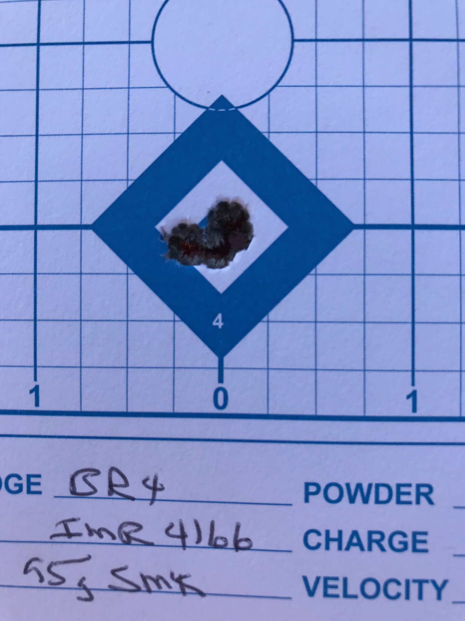

Jake, since you reload, the 6br is also a good next choice. Very little recoil, easy to load
and will be very accurate to 600yds. Has a little more drop than the 6.5's and 6 creed.
It's my new project. Wanted a "shorter" range rifle, for the 600 yd. club match's
I have the 6 creed for 1000 yds.
Best group to date. 170 rounds on this barrel so far, 6br 95g. smk's 4 shots @100yds.
Reactions: Jakeonthekob
Thank you for the input! I was seriously considering something in 6 BR but since I also want to hit out to 1000 with some more authority, I feel that 6.5x47 Lapua will be my best bet. But that's some fantastic shooting!
