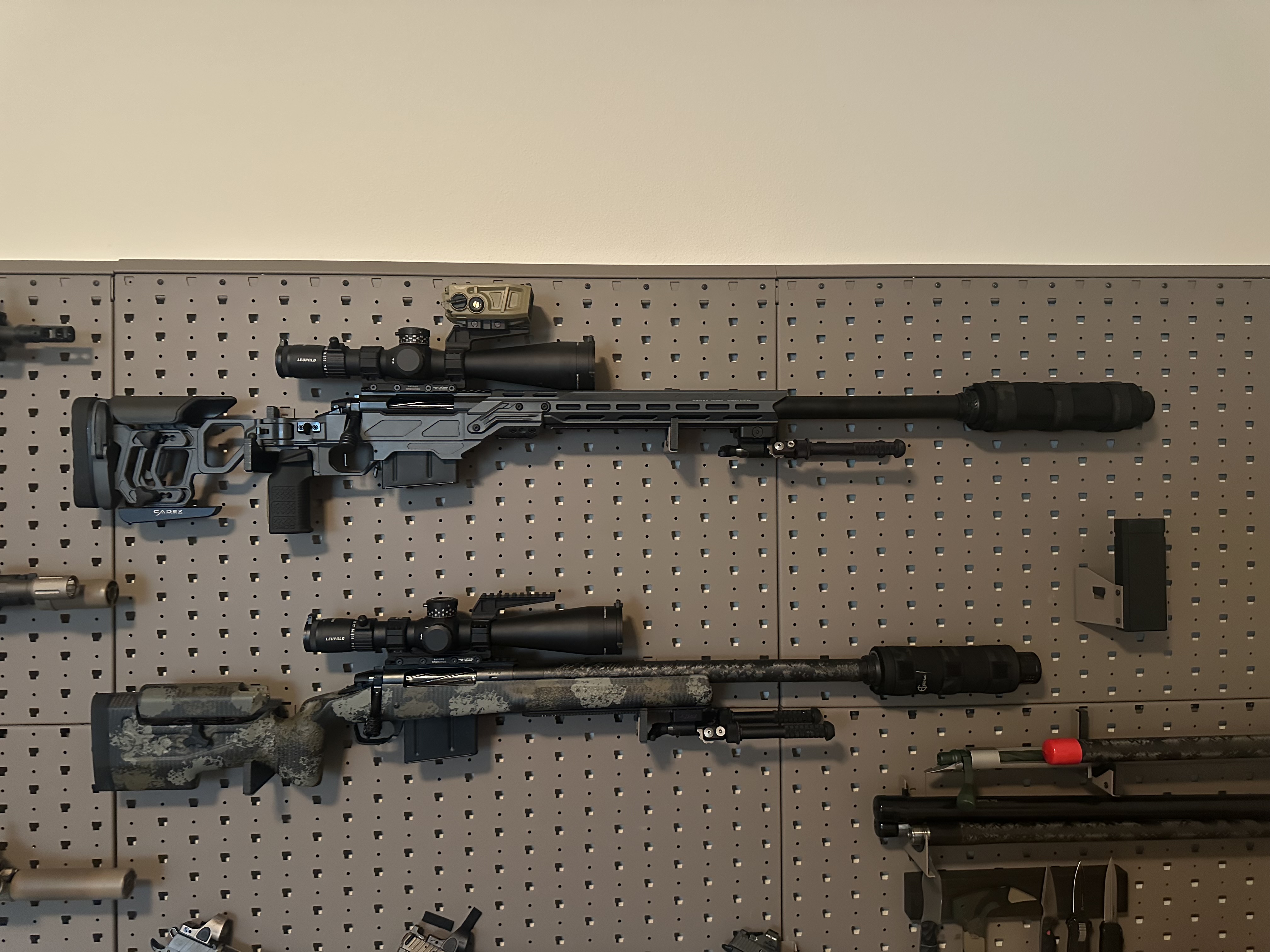

I have 16.5” in 223, 308, and 6.5 creed.
All are loads of fun.
For 600 and in I guess it would depend on if you shoot more consistent wind or wind that changes every .3 seconds for days on end.
We are more the latter, so 6 BR and up gets used more at distance.
.223 can be hard in the super switchy winds. And an absolute hoot in a pretty consistent wind.
One day with an 8 mph wind at 4 oclock, I put an entire mag in 8” at 600.
This last Sat afternoon even the 6.5 140s at 2850 were getting blown around at 600 by 12-25 variable wind.

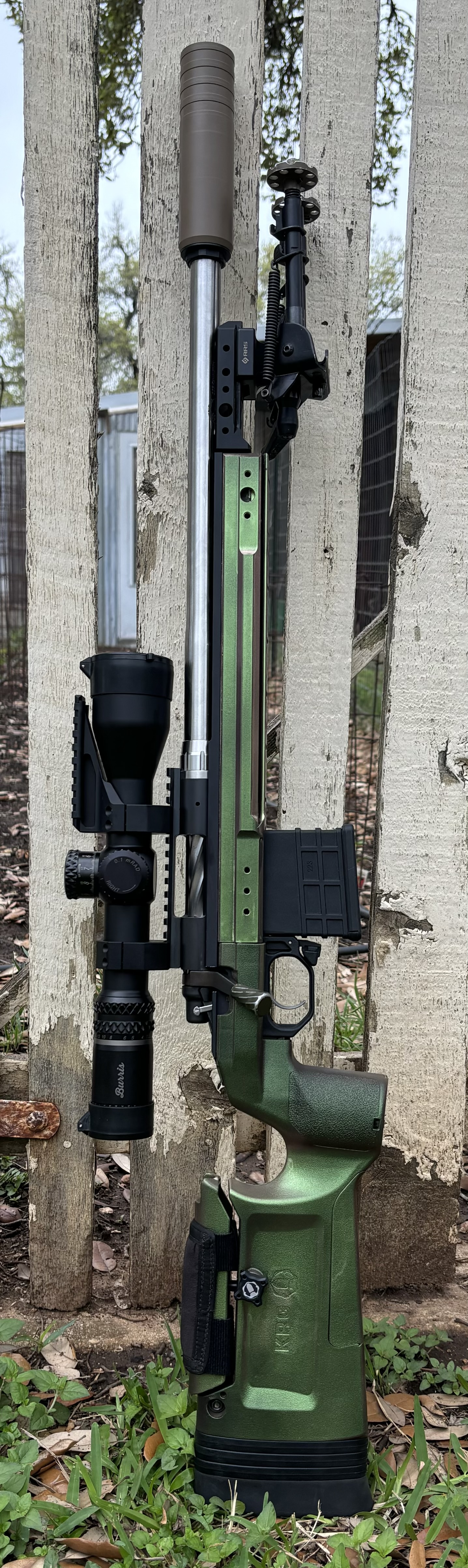

2725-2750 with 130 Bergers puts me in a very nice place with my shorty. The wind never stops here and this rig is easier to push than my old 24" 308 slinging 185 Juggernauts at max pressure at 2700.
