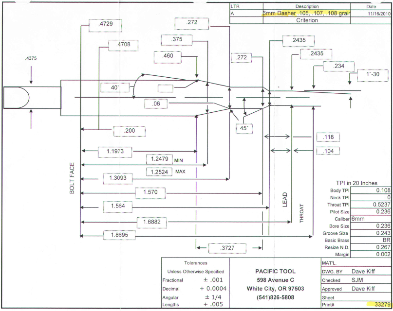

    Bit of a rabbit trail on specs, but I'd ask about base diameter of the reamer at the .200 line as well. If the spec is smaller (like .4708) then it's harder to find a sizing die small enough. If the spec is larger (like .4715) then you've got more options for sizing dies.

    My loaded dashers using ff lapua brass has a neck diameter of .267" which means either the .272 or .273 necks would be fine. My criterion barrel has a .272 neck which gives me .005 which is more than adequate but not what I would call excessive for hassle free operation. Too tight and fouling and grime has no where to go creating a mechanical interference.
    Some have said their ff lapua brass has a neck of .269" and again either the .272 or .273 would be fine. Personally I like the larger option.
    Beware of reamers for brass with turned necks, stay above .272 and youll be gravy. Typically people want .003 of difference between their rounds loaded neck diameter and the chamber diameter so that the brass has ample room to let go.
    Id pay headed to Sheldons remarks on base diameters. Here is my chamber print.

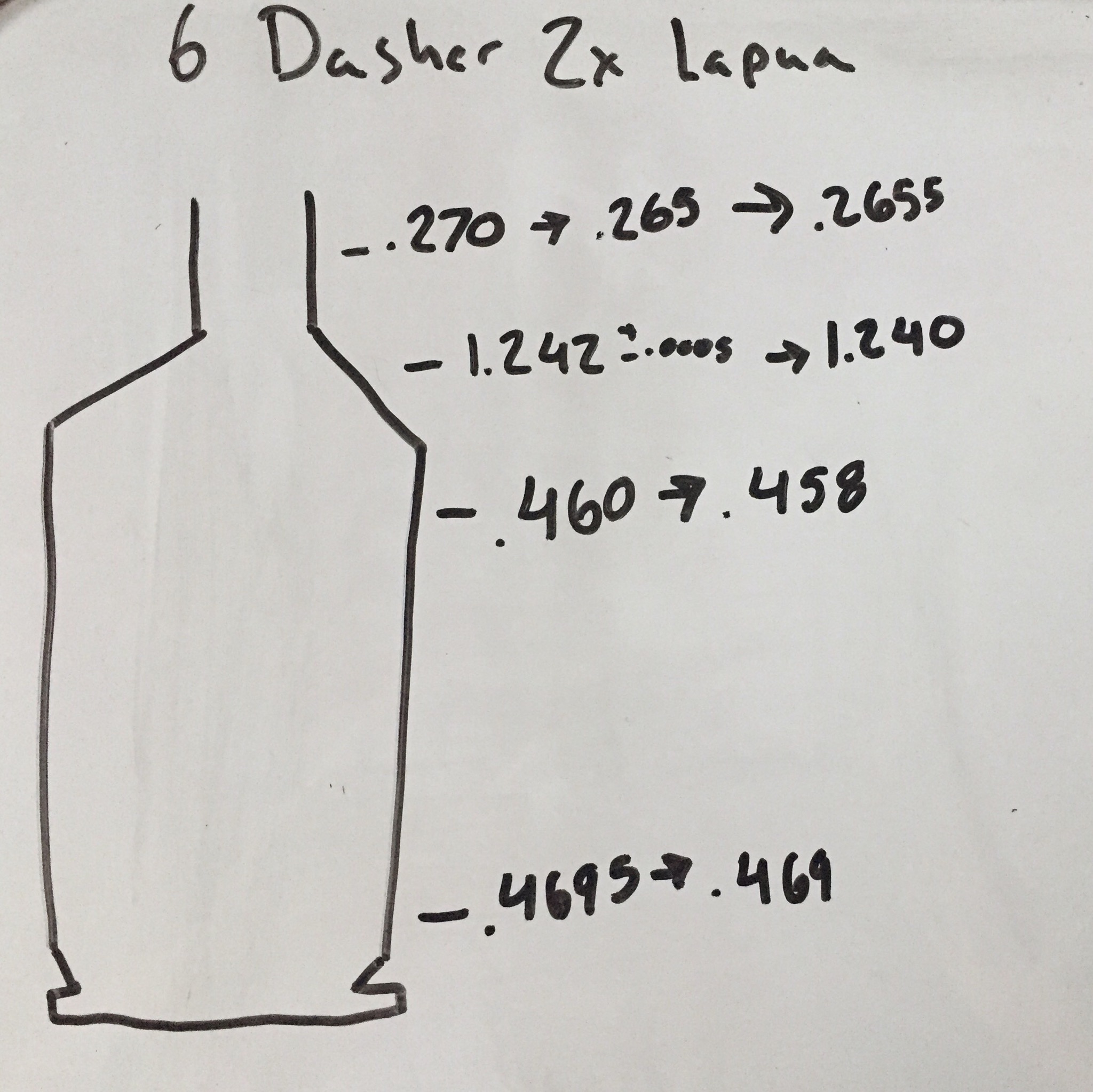

    Here is what my fired bras measures. Notice that my .4708 base barely gets changed and that half thou difference I noted was more of an exaggeration. It changed but not consistently enough for each one to change with my mitutoyo calipers that read in .0005 increments. I was too lazy to get out the micrometer. Hasnt caused me issues yet but it was the one thing I noticed on sizing and said "Shit, Ill need to watch this in future loads."
