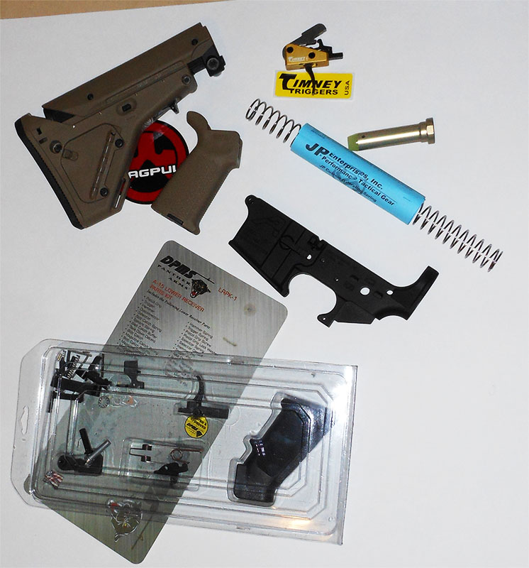

I just purchased a 5.56 Recce rifle upper for medium range shooting. Plan to shoot heavier 69gr, 75gr and 77gr match grade ammo out of it. It shoots .5" @ 100yds with Horndady 75gr BTHP and head shots were easy at 600.
Here's the sepcs
SI Tier 1 Recce Upper
AeroPrecision made upper receiver
WOA 16" Recce 1:7 5.56 precision match barrel
Troy Alpha Handguard FDE
Young NiB bolt
BCM Charging Handle
TSD Kompressor
SI Tier 1 Recce Lower Kit
Aero Lower
DPMS Parts Kit
Magpul MOE Grip FDE
Magpul UBR FDE
JP Buffer Spring and Carbine Buffer
Timney 3# Match Trigger
I just ordered the BADASS ambi safety selector, ERGO Fde grip, and the Magpul enhanced trigger guard for this rifle.
SITier1Recce_2_zps76c86b8a.jpgSITier1Recce_zpsdd0fcce7.jpgSITier1RecceLowerKit_zps722e370e.jpg

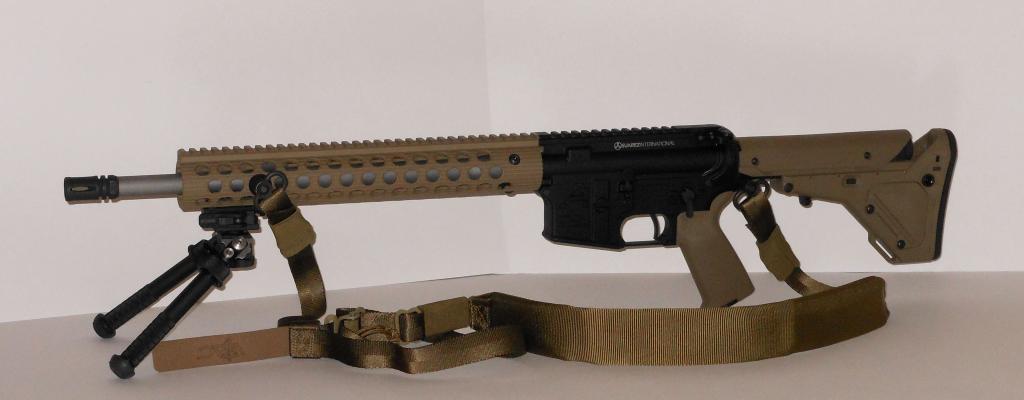

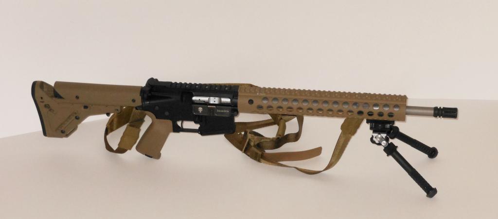

Here's my SPR Build.

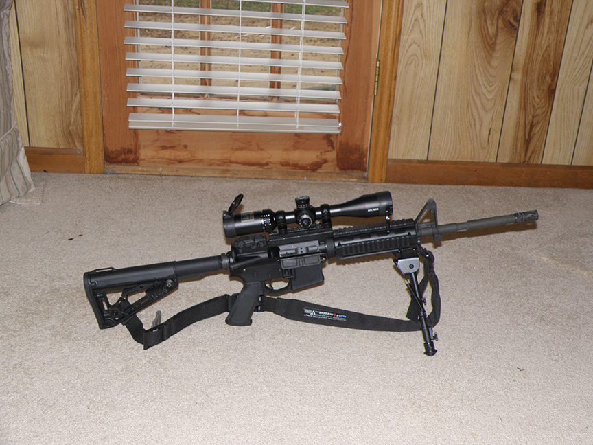

My M4 Colt has a Geissele SSA-E trigger and I looked at a lot of scopes and had a 3-9x40mm that I didn't like. I ended up getting a Bushnell AR/223 which is 4.5-18x40mm and I really like it. It cut my groups in half at 100 yds. because I can see the bullet holes in the target and hold very accurately at 18 power. The glass is crystal clear also.

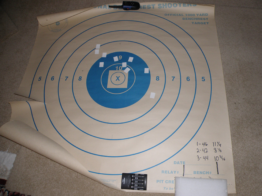

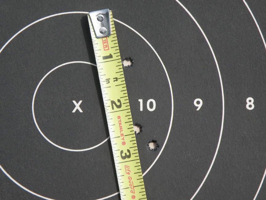

Two targets that I have pictures of. The three shot group is at 400 yds. ( both targets were shot with my bolt gun )
