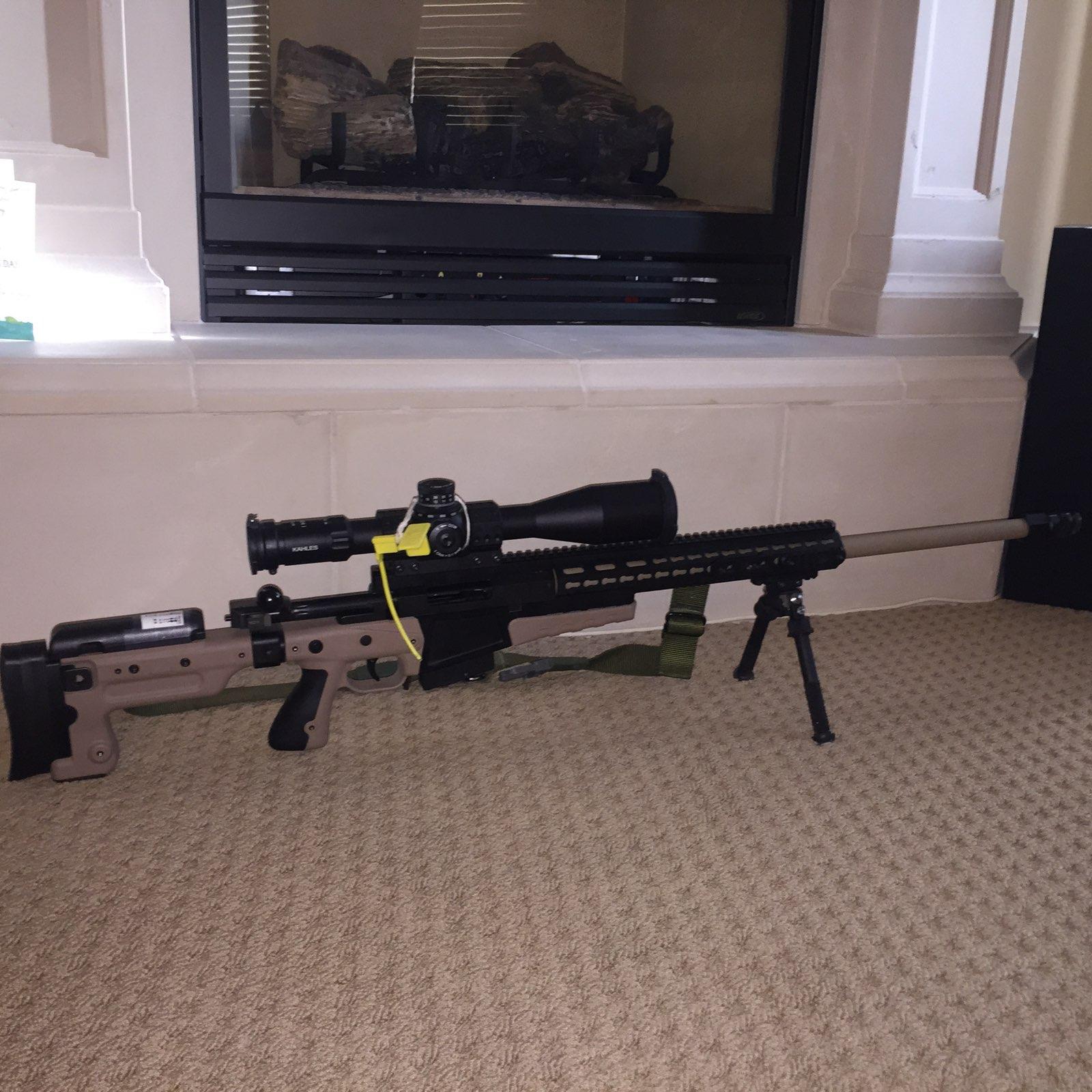

    I have the budget and desire to finally get an AI.
    For those way more in the know than I am, would love some input on the the tradeoffs between the two under consideration below. I've read the Hyde discussion between differences of AT and old AX overall...but I'm putting more specifics into the convo.

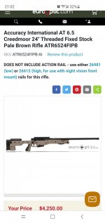

    Options 1: Fixed AT, 6.5cm, threaded, 24in, Lothar barrel from Eurooptic. Reason being the caliber is familiar to me and I dont have the time or patience to reload (myriad of factory ammo options). Will need to add a $120 rail. Cost $4,250 + $120 rail = $4,850 OTD w/Tax & FFL transfer
    Down the road I will consider the AX folder upgrade, but as I dont travel and am not space constrained I see no need to pay up front the ~$530 difference.
    Options 2: A range acquaintance offered to sell a Gen 1 (pre 2014) AX, 260rem, 26in Bartlein barrel w/brake. 120 rounds. Bought from Mile High. Including 100 rounds 260 ammo.
    Cost: $5,000 OTD no tax and no FFL fees.
    A negligible $150 (~3%) difference.
    1) Gut response...what would other Hyde-ers pick for a first AI?
    2) Is AI barrel change a DIY process like with my Bighorn Origin? What challenges does the "bonded" action present?
    3) The AX has a longer 26in barrel from Bartlein, how does that stack vs. the 24in from Lothar...if any?
    4) Do I care about the quick lock barrel change...or is that marketing jargon for a feature few ever use?
    5) Will I pigeonhole myself going with one caliber or the other or one rifle or the other?

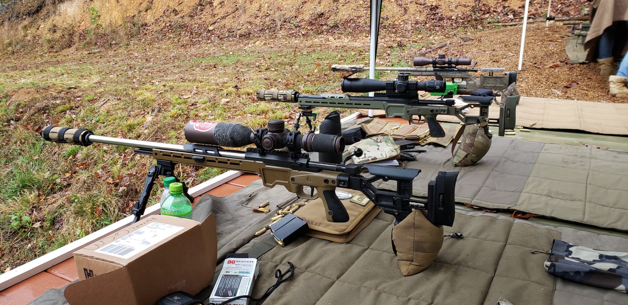

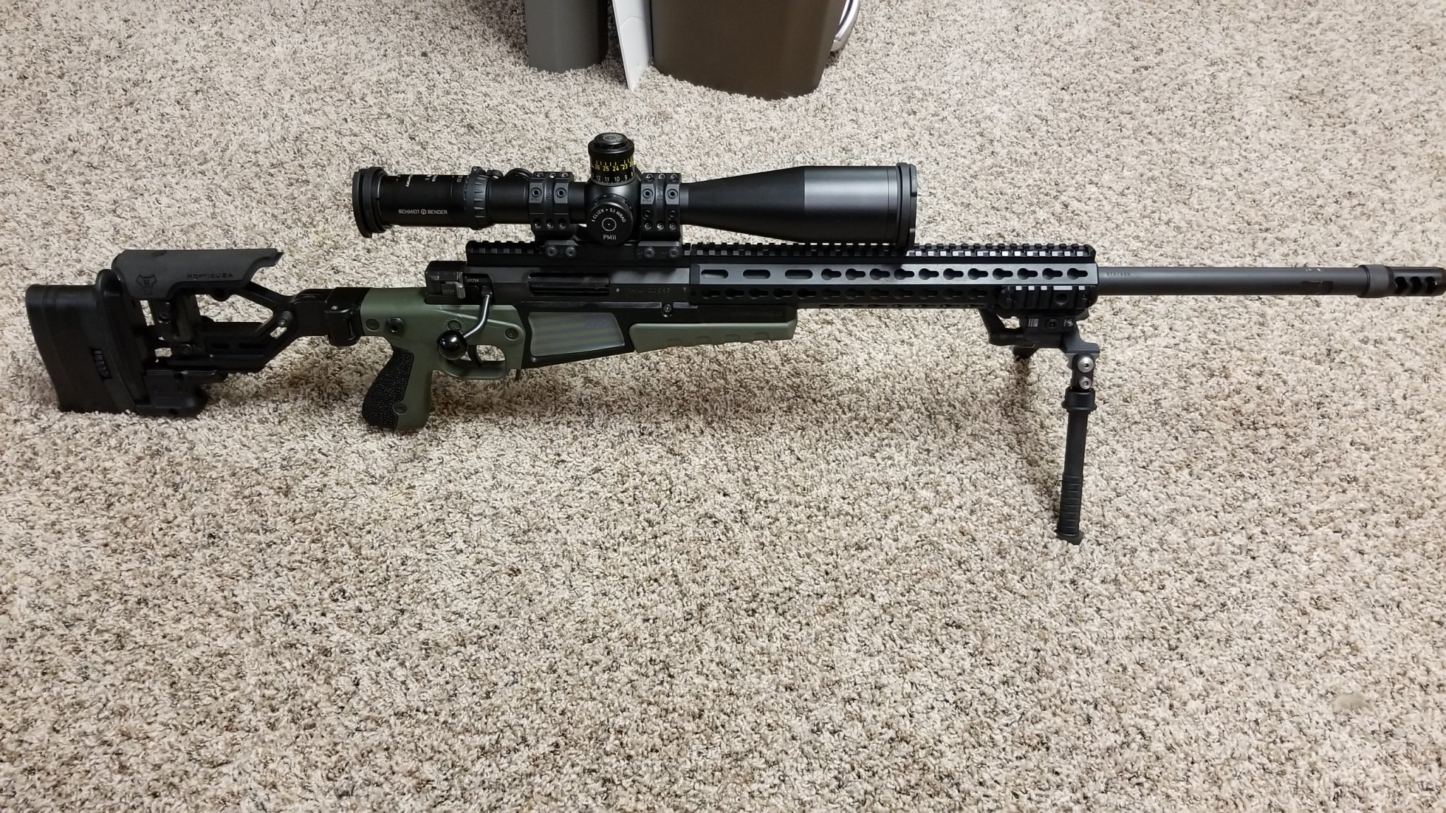

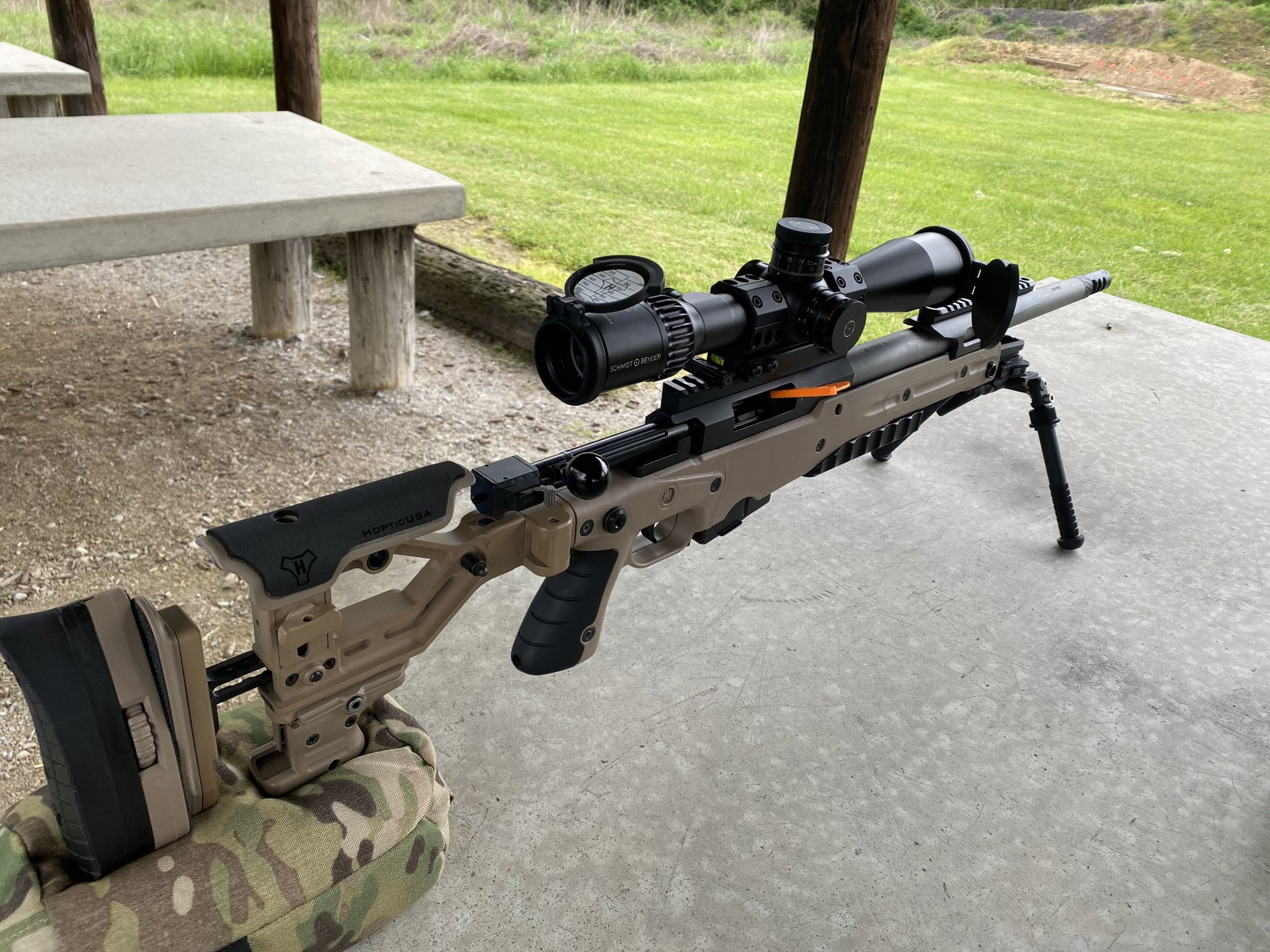

    This is my 2014 AT I picked up here in the px for just over 3k. I run a 20” 308 barrel for deer. Has the large firing pin which works well with 308. Came with the folding thumb hole stock, original stock, thumb rest and spigot. Also has the quick loc. Hell of a lot of rifle for $3k and my favorite to date
    Just picked up a 2013 AXMC that I’m currently setting up to run 300 PRC. The model has the folding AX stock, mag well cutout, quick lok etc.

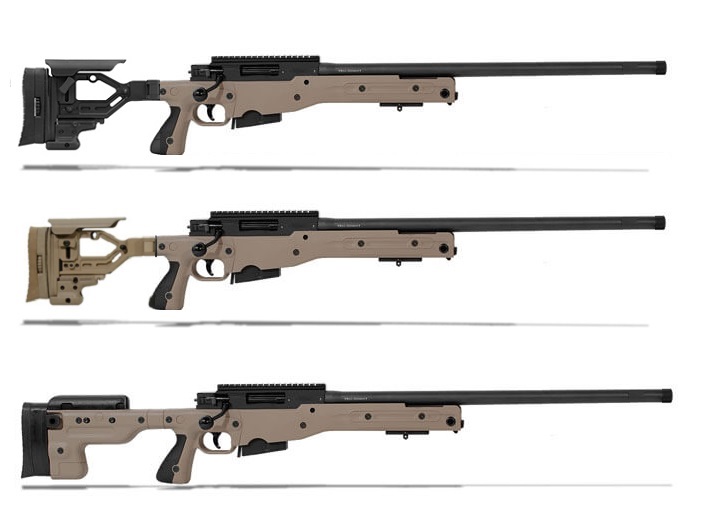

    I'd get a folder. (I realize the AX is, if I bought the AT, I'd spring for the folder).
    The non folding AT’s can be converted to AT-LE spec with the AX buttstock kit. When I bought mine I went with a new folder and passed up a smokin deal on a used non folder thinking it could never be a folder.
    My advice is find the best deal you can on a non folding AT. If you decide you want a folder pick up the AX stock and make yourself an AT-LE. IF you can get a factory AT-LE I would go that route.
    I have seen dealers with AT-LE’s for sale with the AO spigot for about $5.2K in the past.

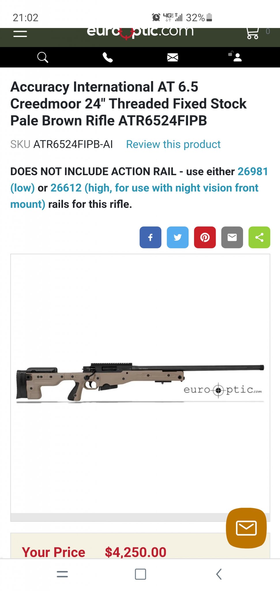

    UPDATE: I went ahead and placed an order for a fixed AT from Eurooptic. They only had one left and it was in Pale Brown.
    Thanks for all the feedback to help me make the jump. I was already leaning towards the AT simply based on price , but many of the reasons mentioned above are what really pushed me over. I am pretty sure I will still think "dang, shoulda, coulda, woulda" every time I see an AX at the range - luckily that isn't hardly ever.
