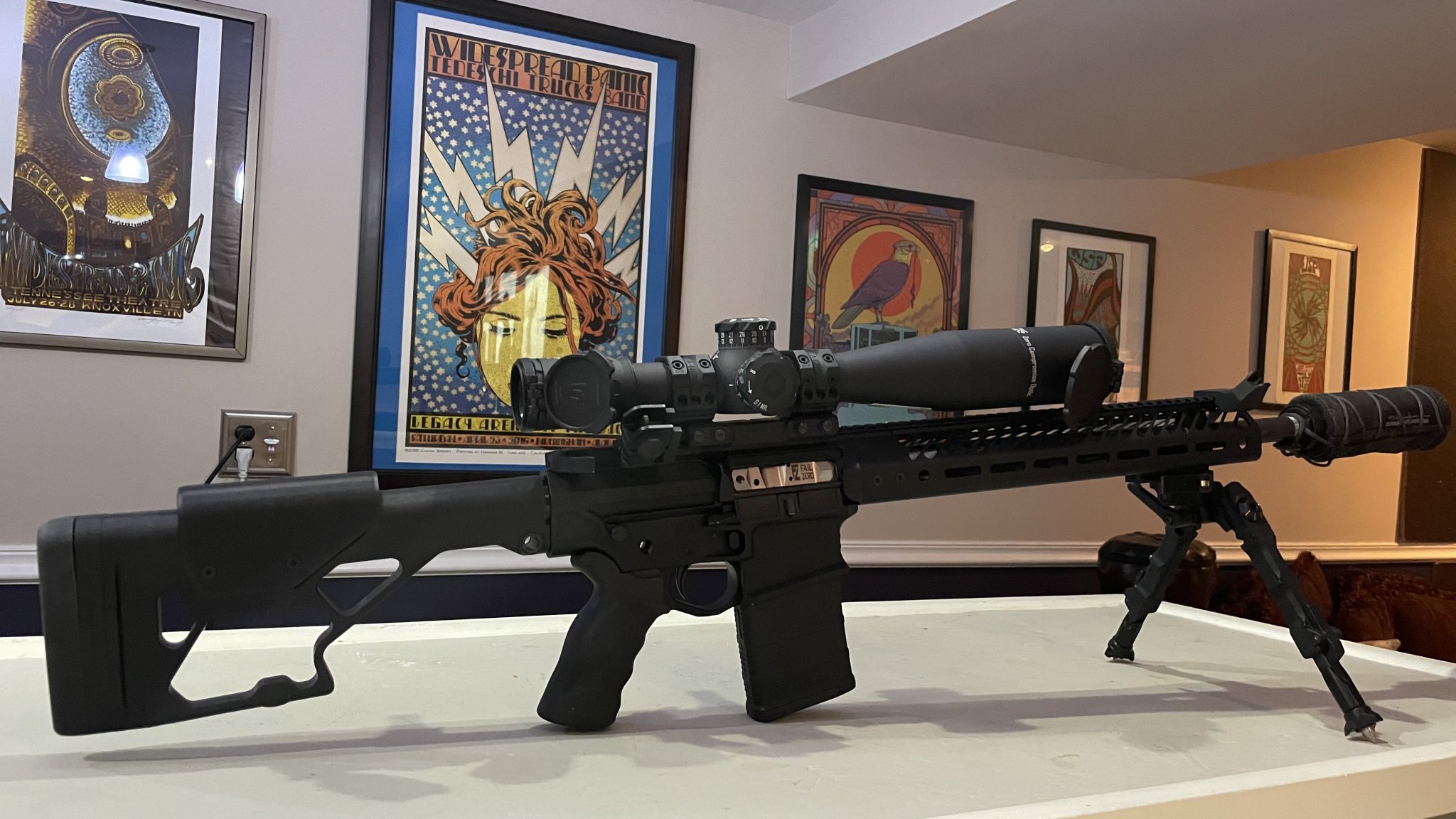

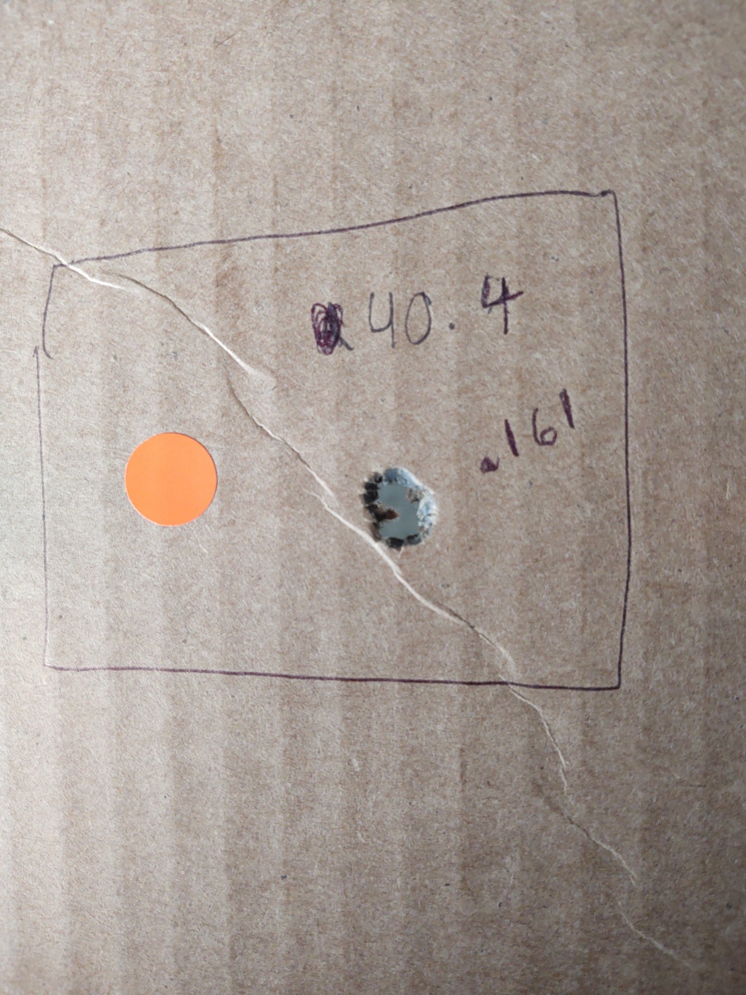

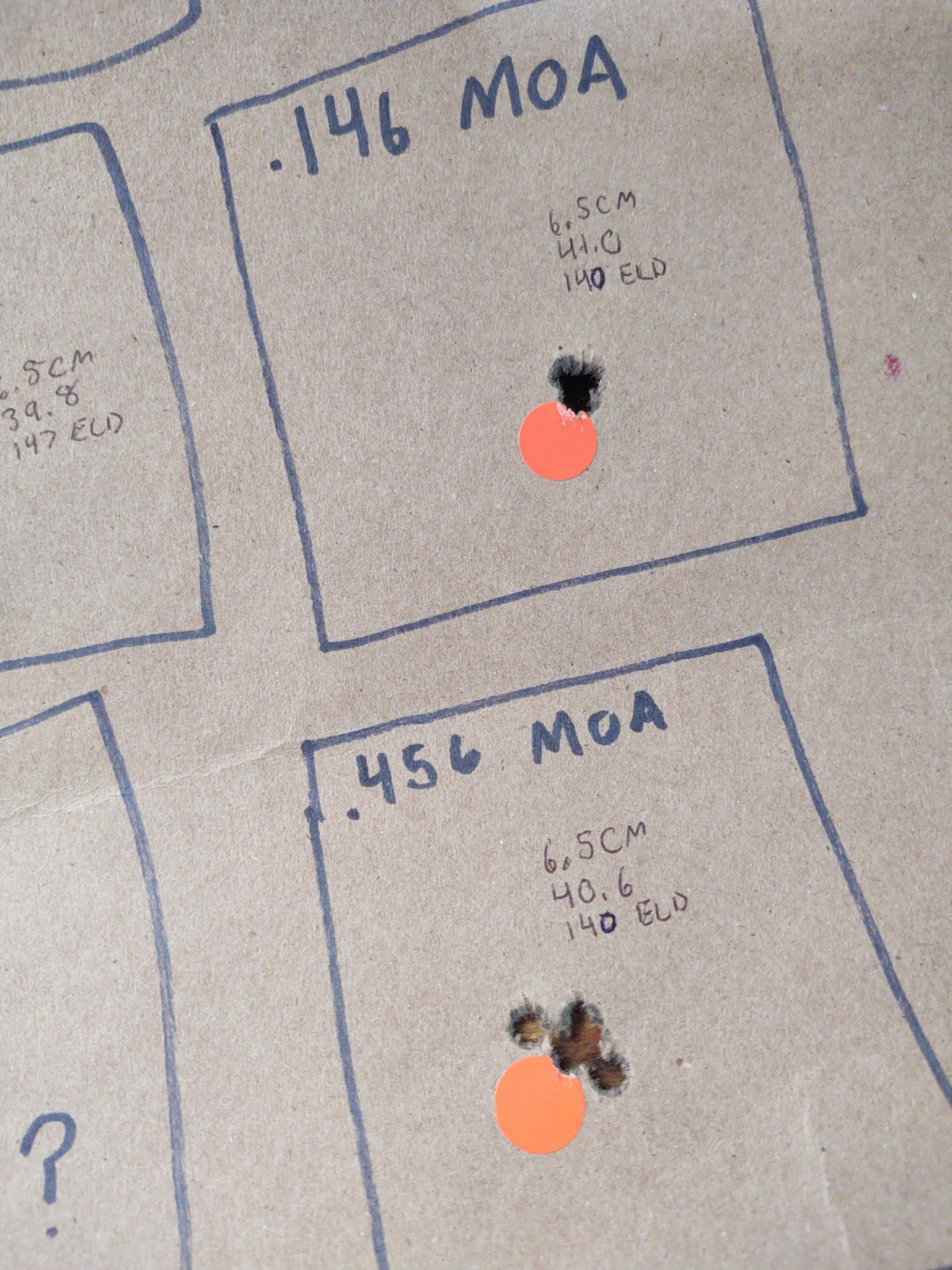

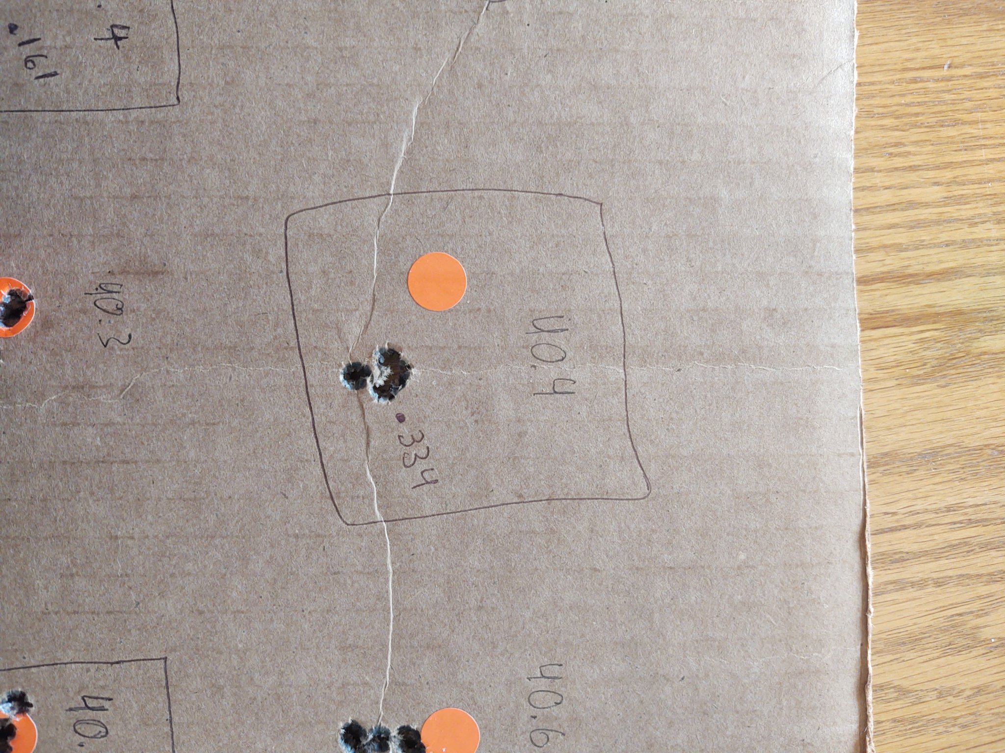

I have built several and went back and forth with a bunch of research between seekins and a LMT.
Ultimately I picked up a SP10 in 6.5CM. it consistently shoots 3/4 MOA with a pretty wide variety of hand loads using 140 ELDM. In the winter in New Hampshire, I'm getting about 2730 FPS. I second what other people say here that large frame guns take a lot more work. You definitely have to do your part to get your body positioned well to manage recoil versus a bolt gun. If you get a one MOA gun consistently, that's a win for a gas gun in my opinion.
If you call Euro optic directly, they'll usually give you a deal and a discount when you ask them about a cash purchase price.

Something is missing on that rifle in that picture

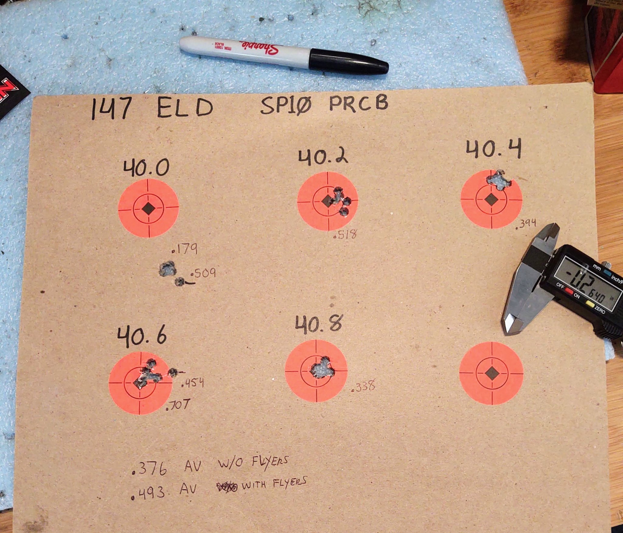

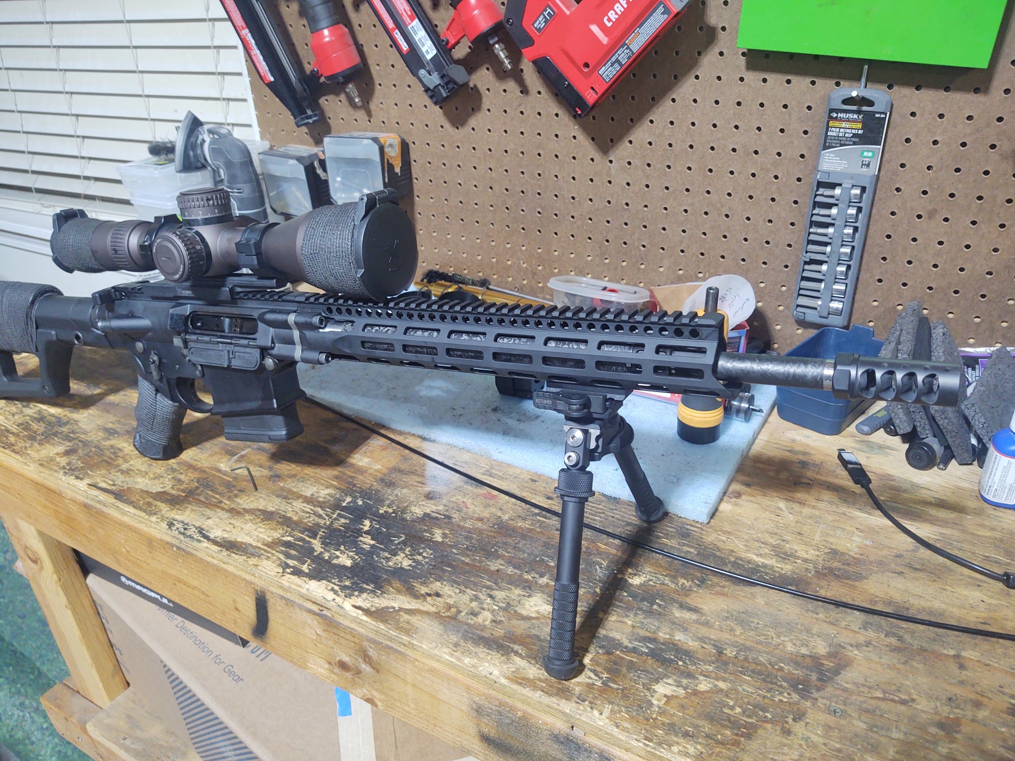

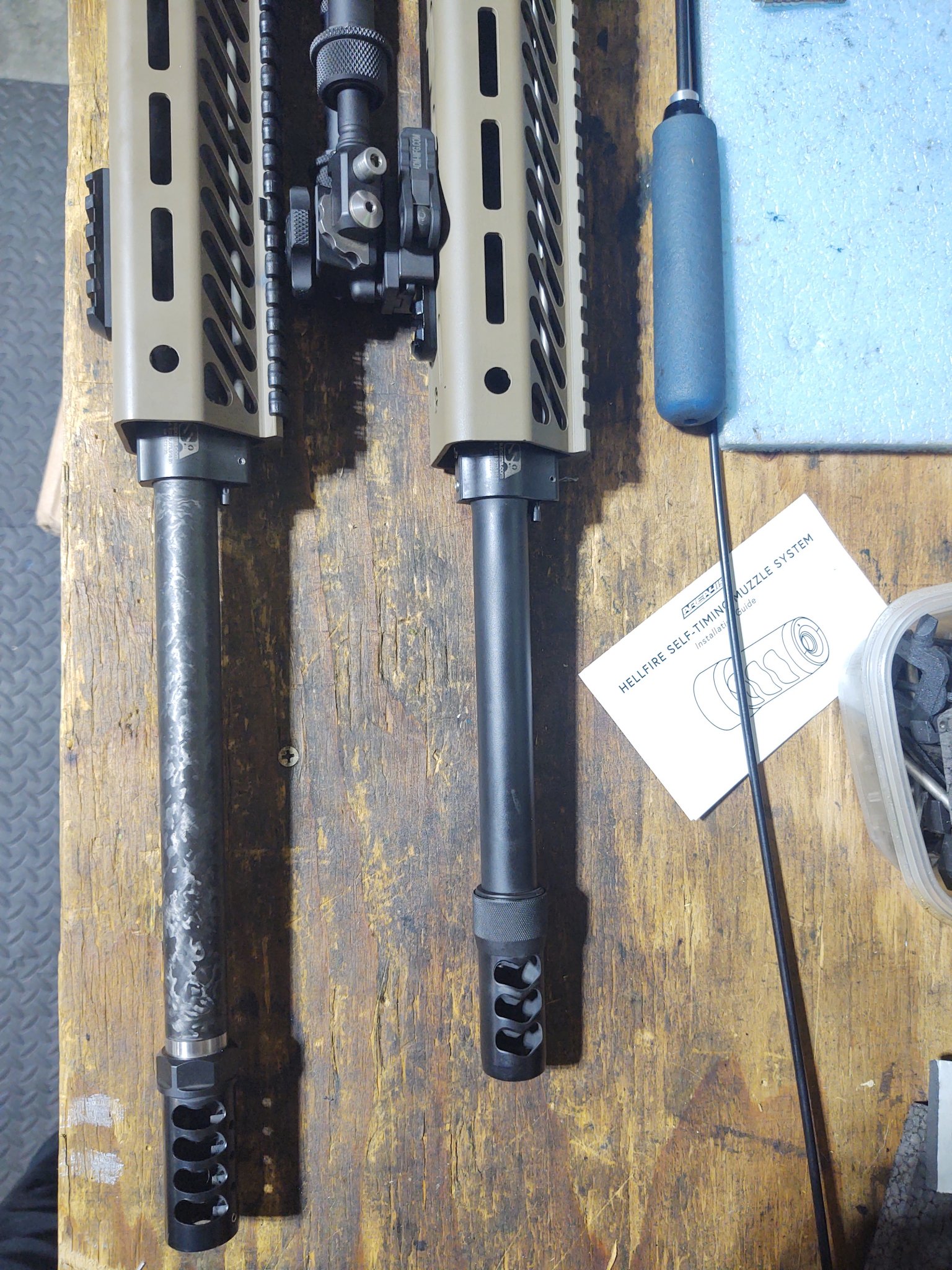

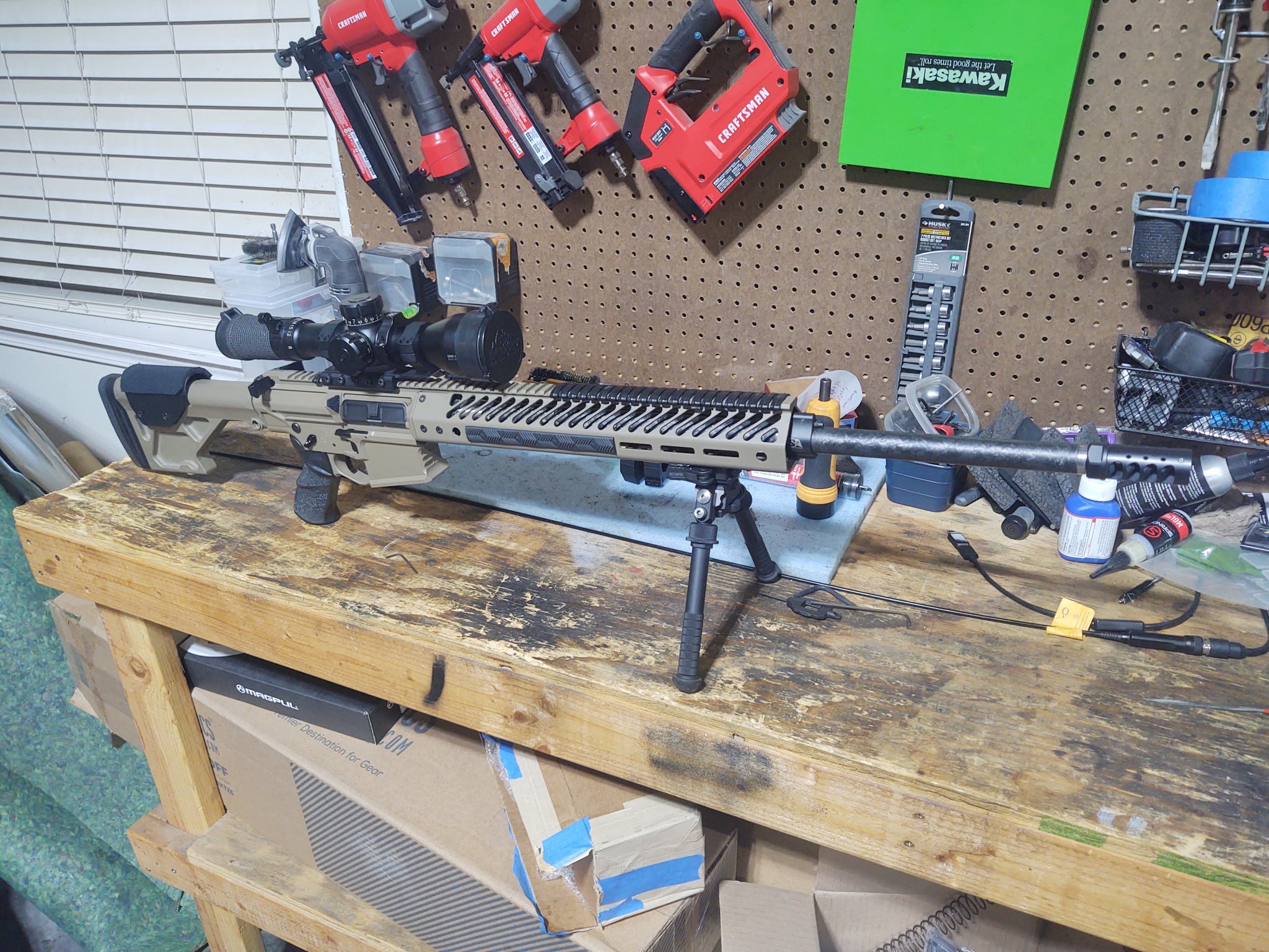

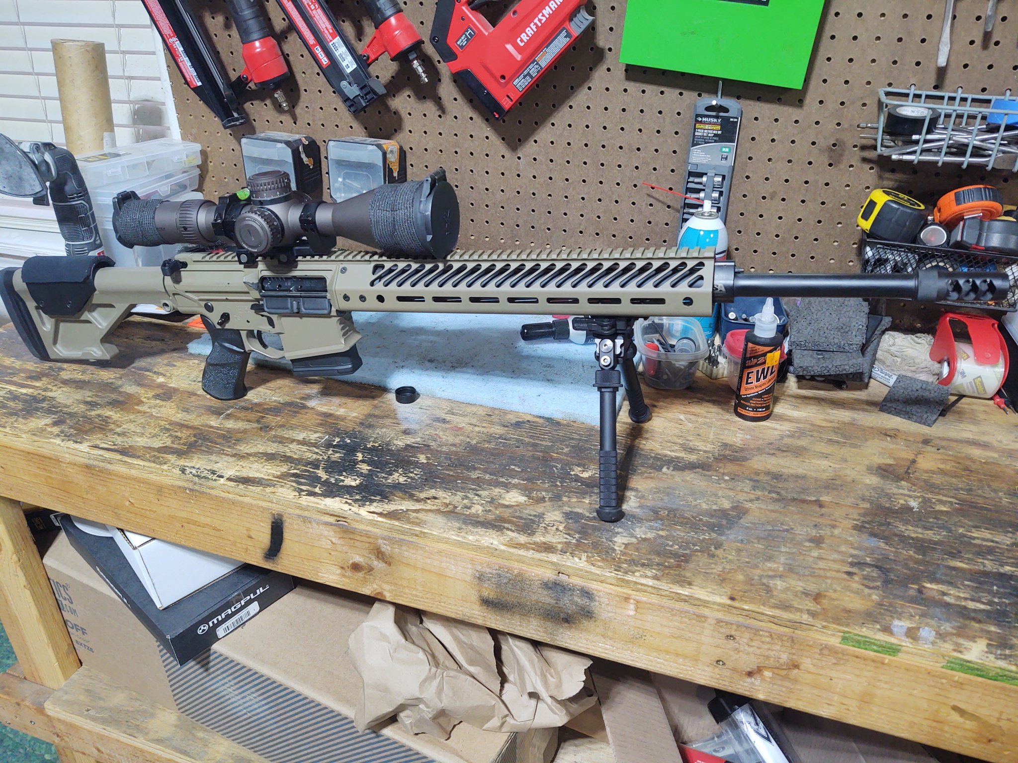

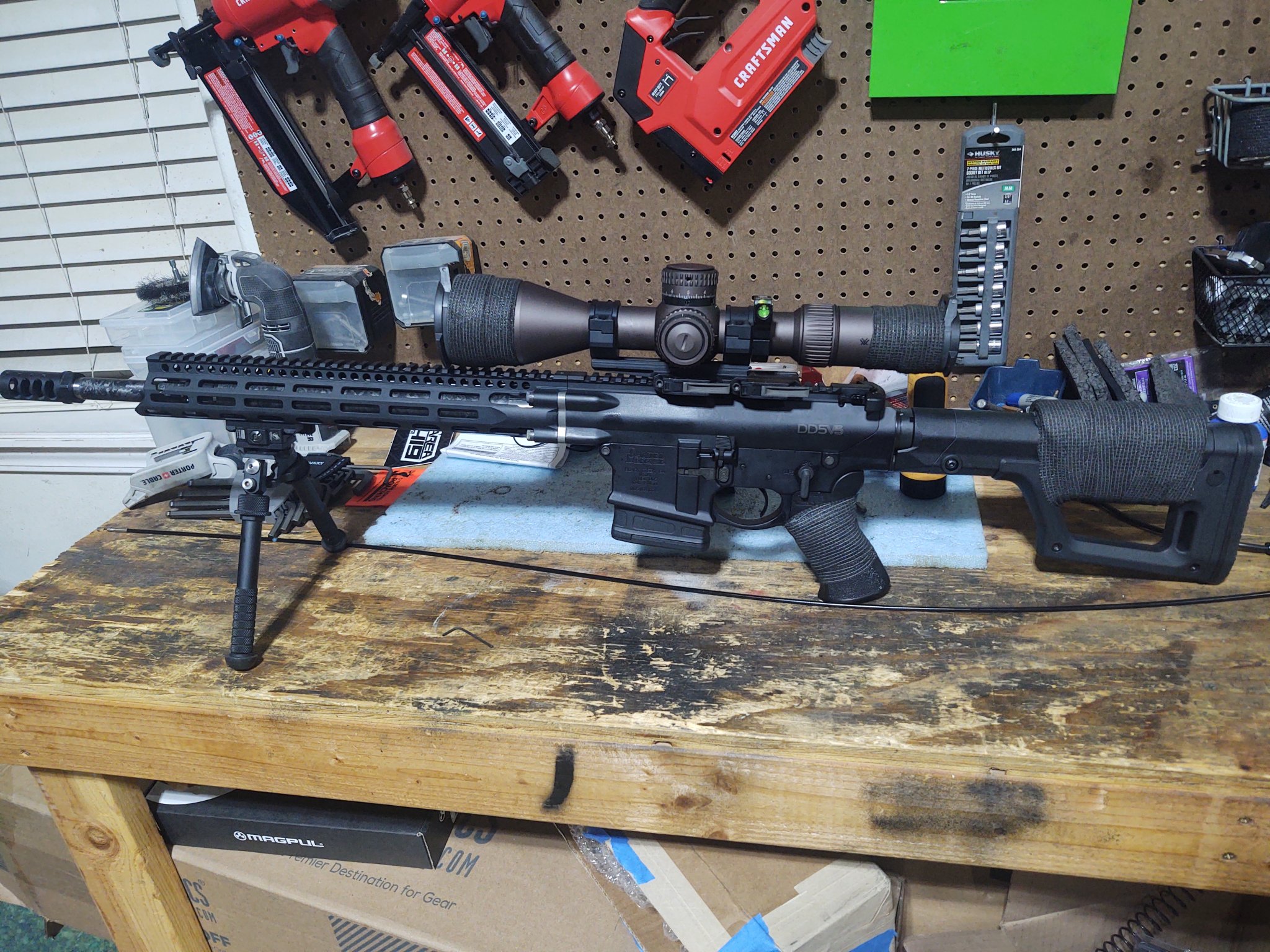

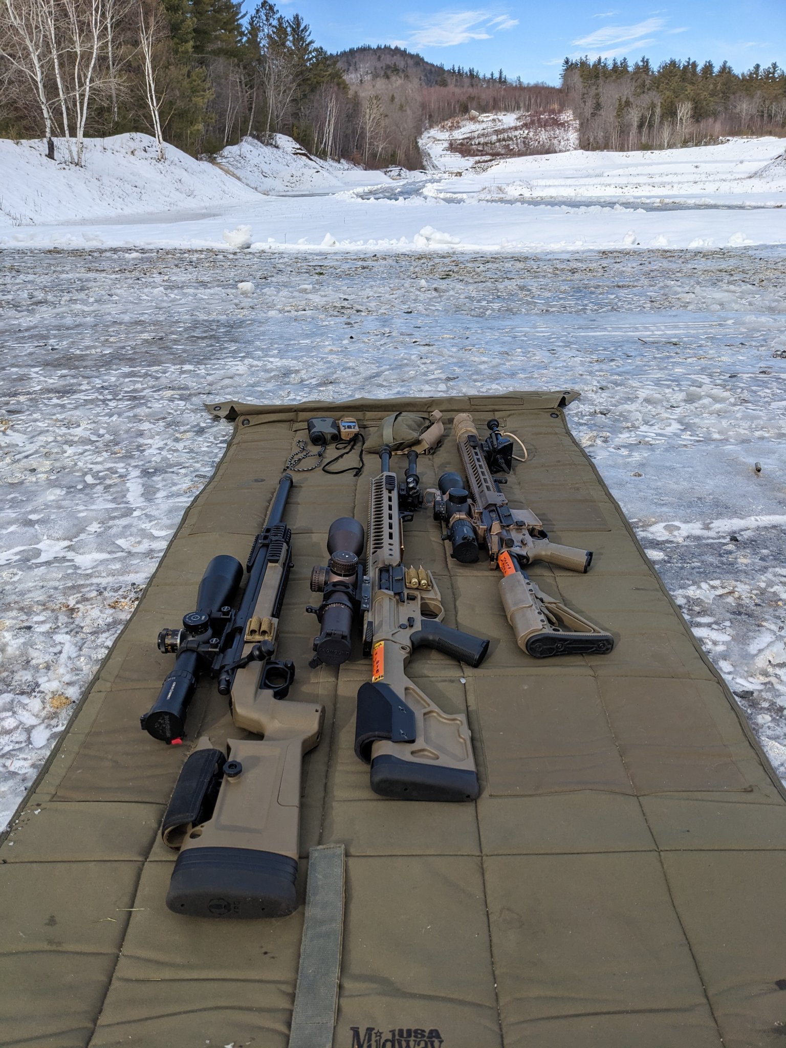

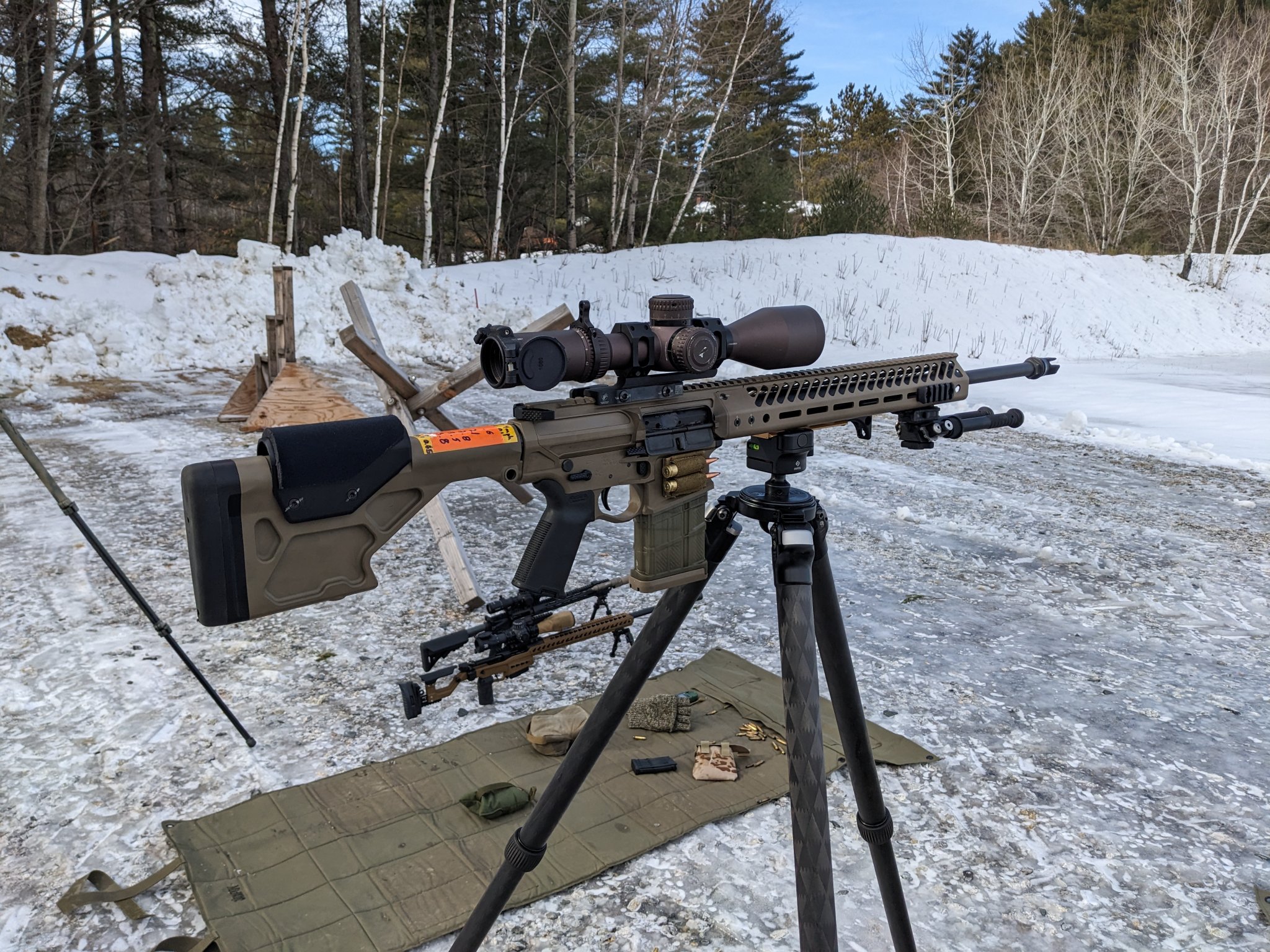

I've got two SP10's, one with a 24" 6.5CM PR Carbon Barrel and a 22" 6.5CM Bartlein from CLE and they are both consistent Sub 1/2 MOA rifles.
I also have a DD5, the OEM barrel wasn't that impressive about MOA on a good day but the Proof Research Carbon Fiber barrel is quite impressive and keeps the weight at 8lbs.
I haven't had time to start load development for the DD5 yet because I'm finishing up a review I'm doing on a Custom OBR with a 18" 6.5CM Bartlein from CLE .
I think noting that the SP 10 has incredible support is very valid. When I got mine magazines were dropping free under recoil. I called siegans and they sent me a replacement magazine catch which fixed the issue and I got it within several days.
I haven't had time to start load development for the DD5 yet because I'm finishing up review I'm doing on a Custom OBR with a 18" 6.5CM Bartlein from CLE that.

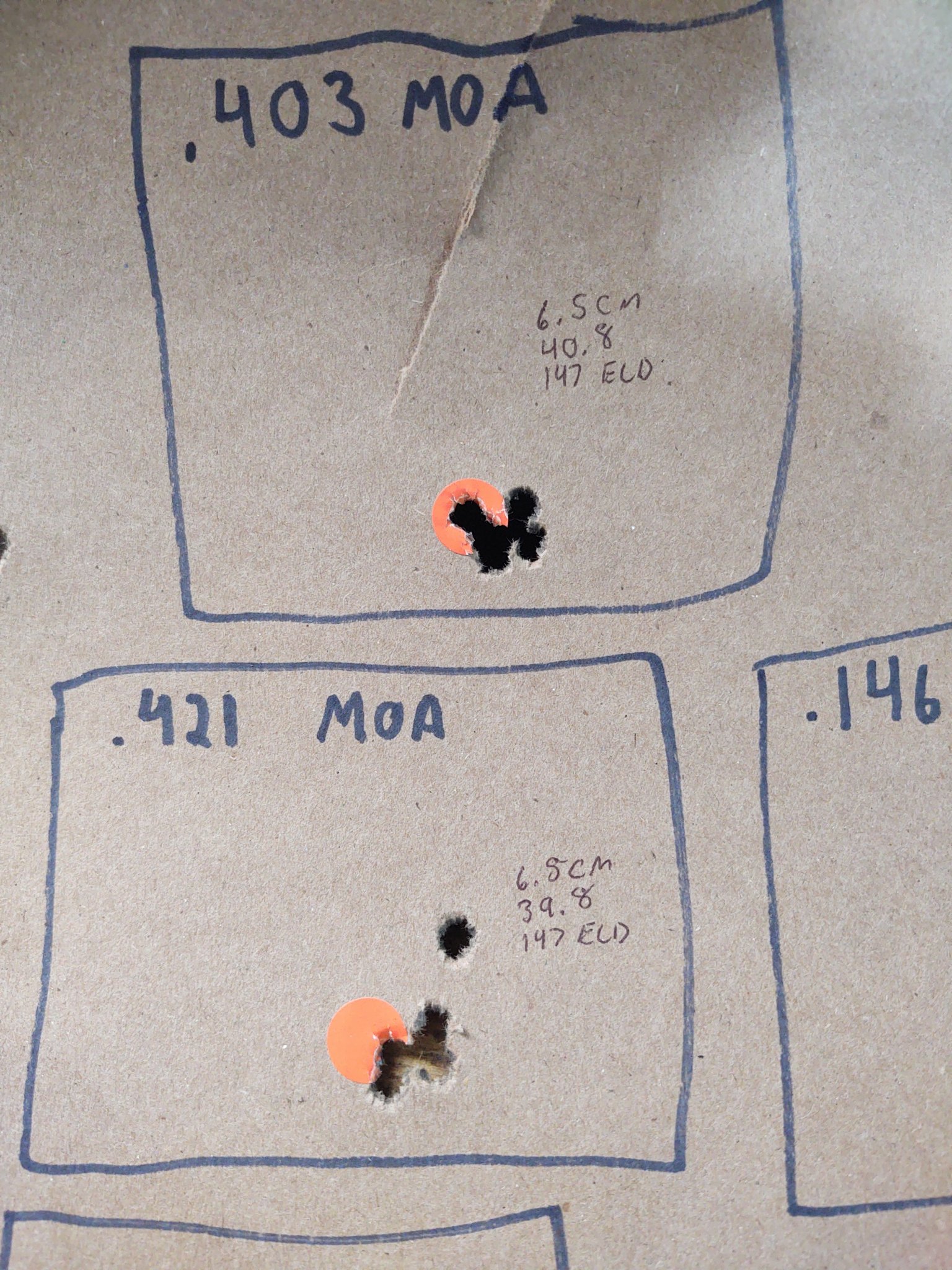

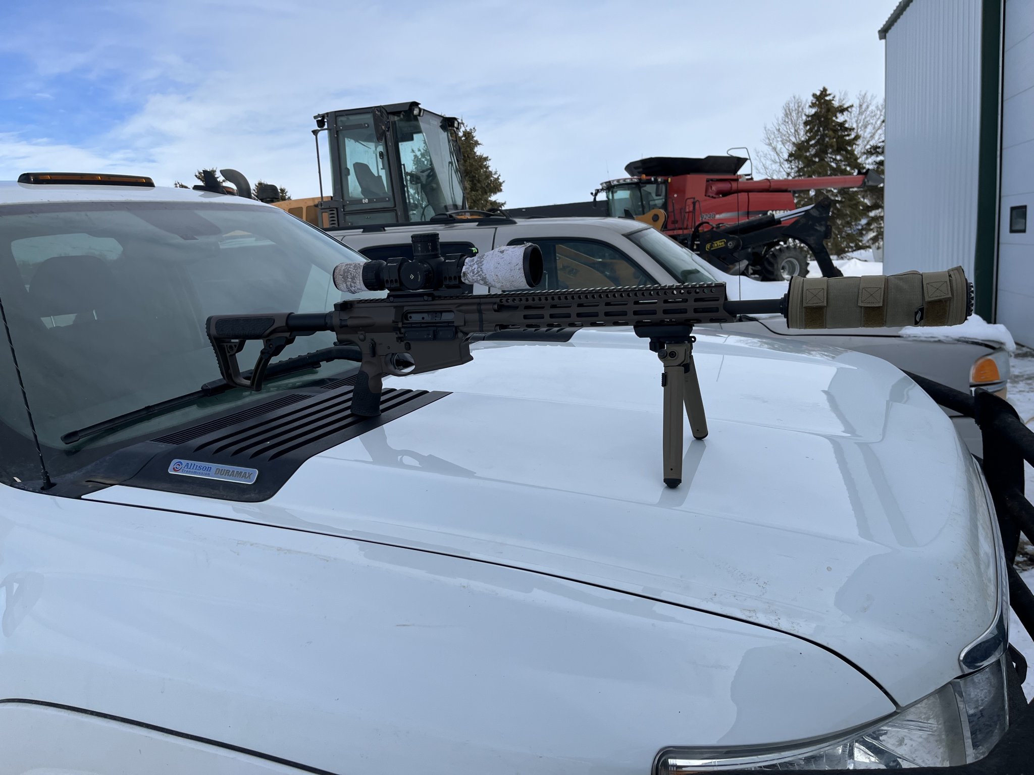

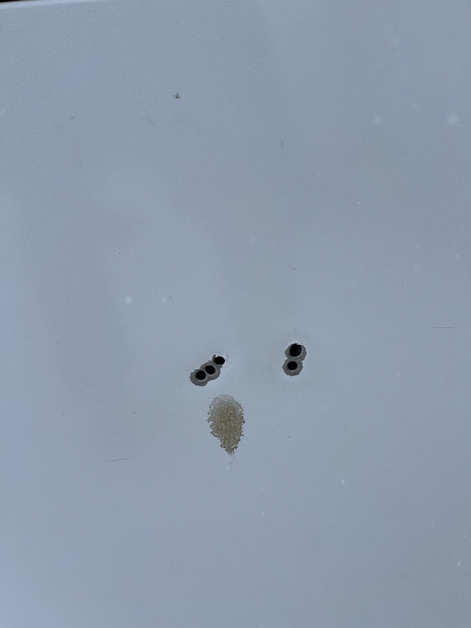

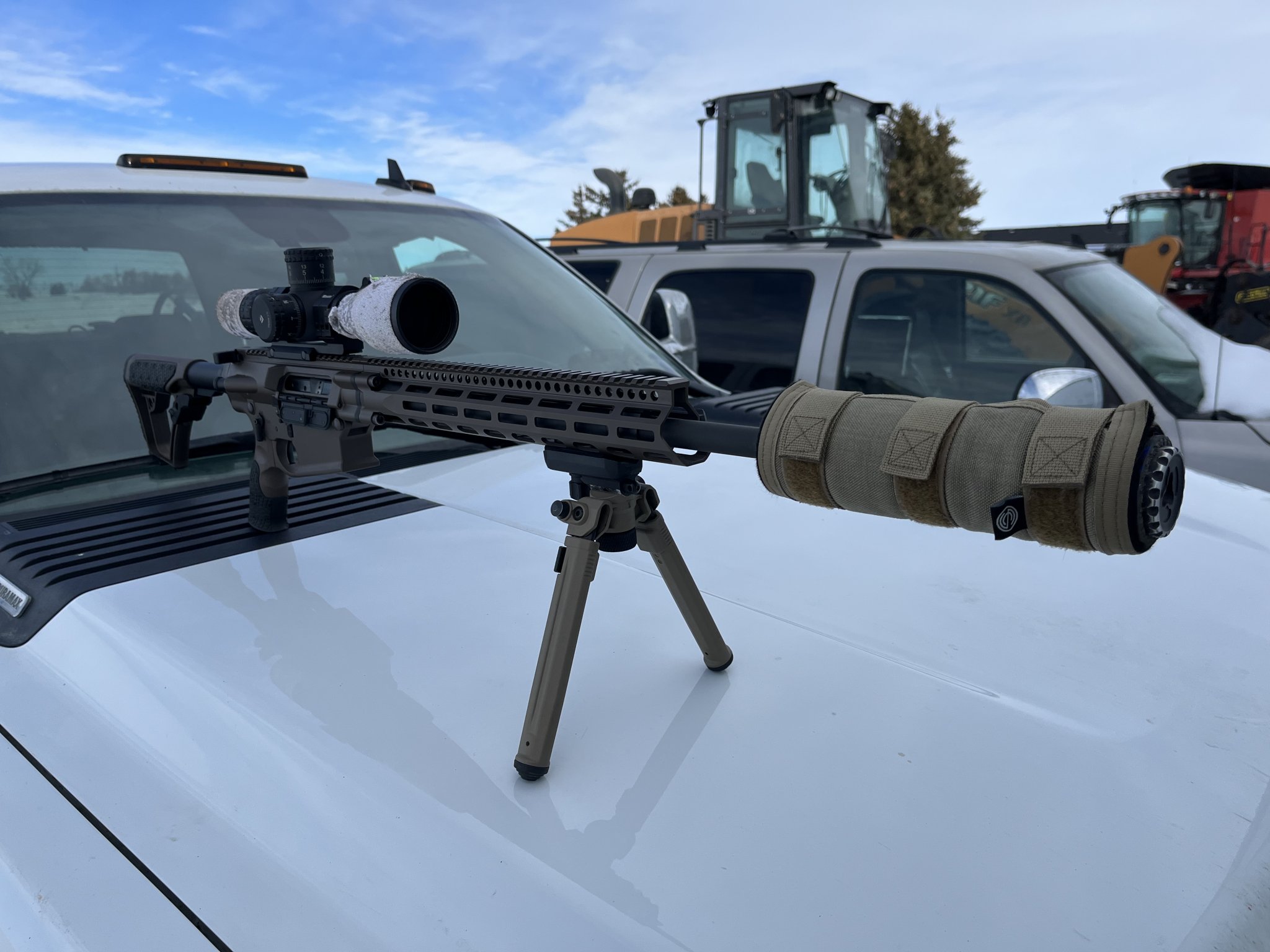

Well I handled both rifles in person and both were great. I ended up deciding to go with the DD5 v4,i liked that the dd had an adjustable stock and forward assist. I threw together a load of 41.5 grains of h4350 in starline brass and 140 Eldm bullets. these are the first two 3 round groups at 100 yards.
