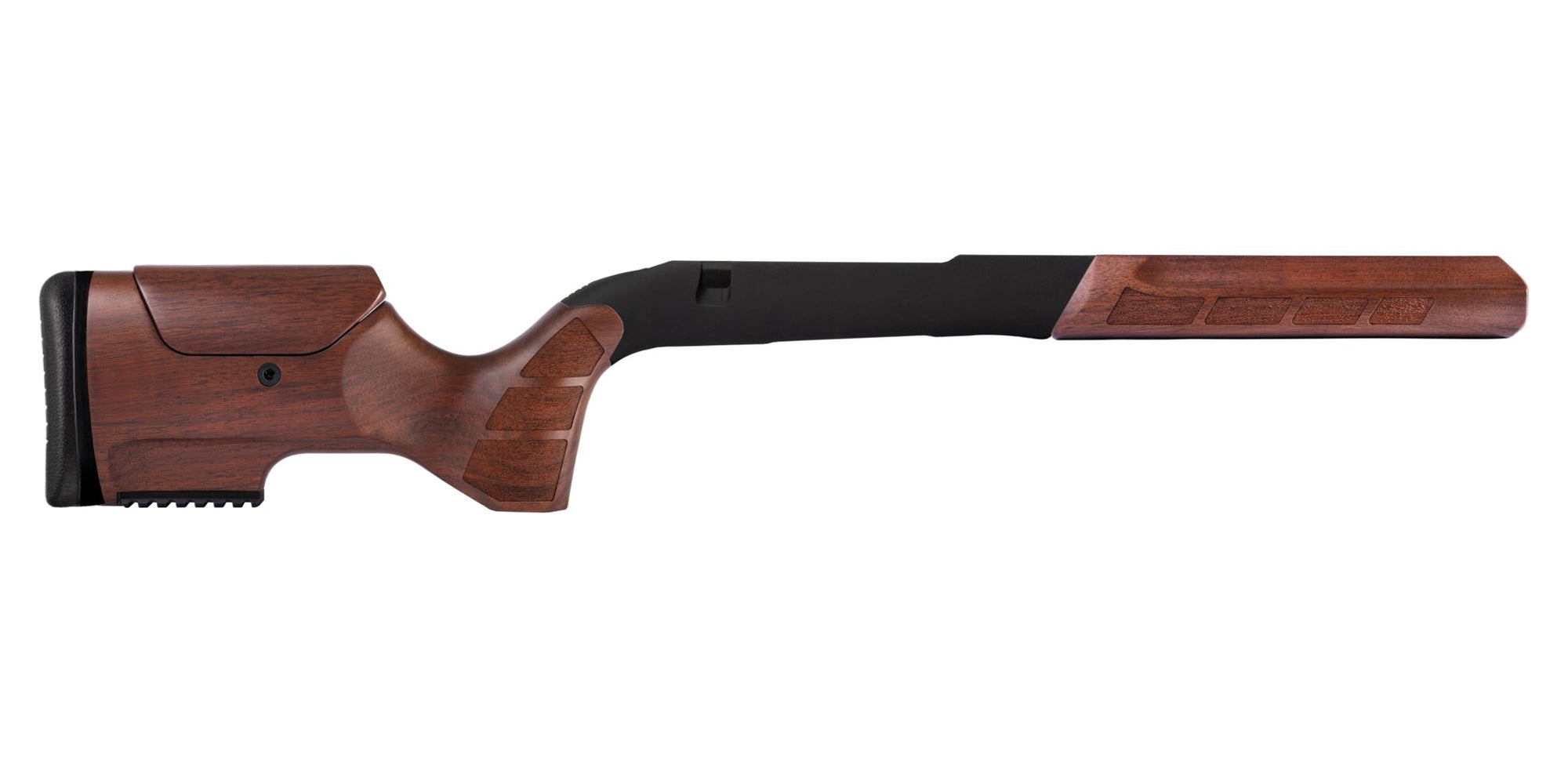

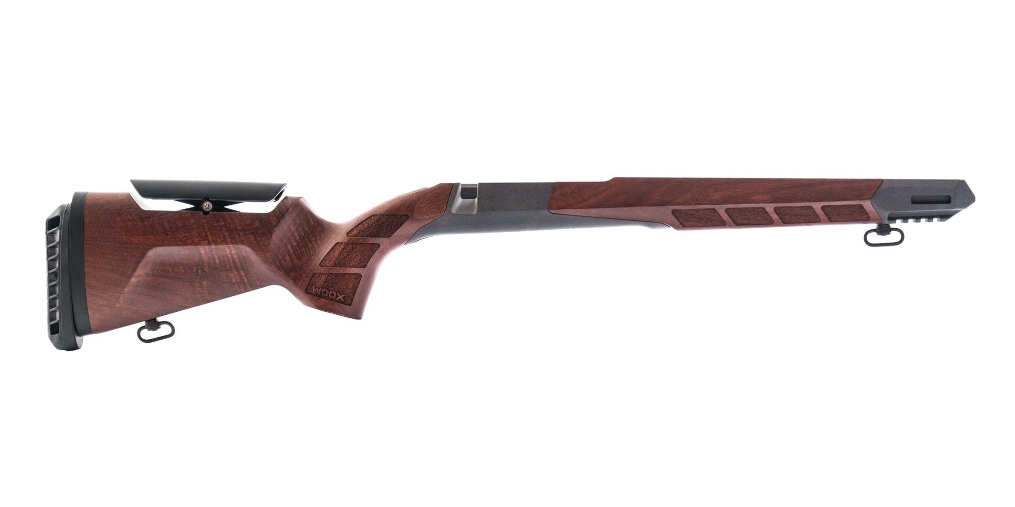

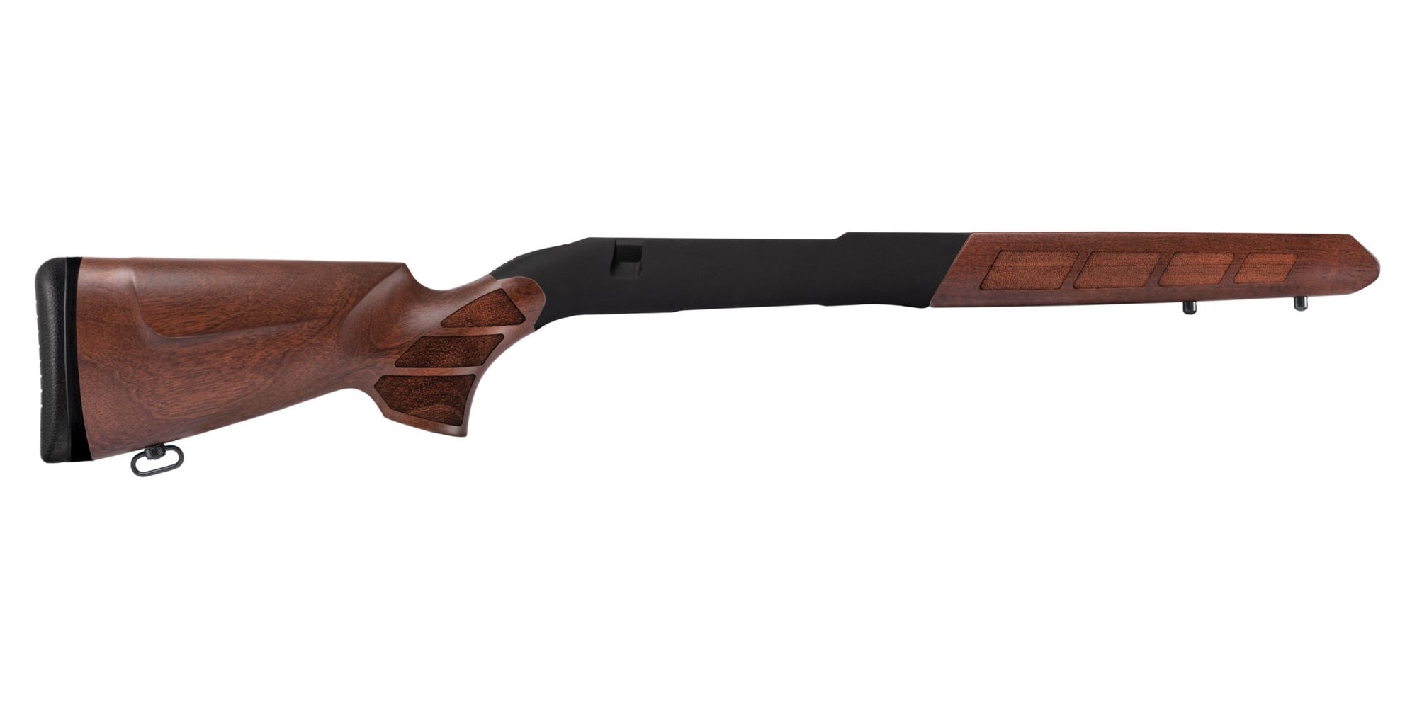

For a blend of modern and classic, the Woox product line has a few good lookers. Depending on the hunting style though, the wood could be a drawback.
Woox Superleggera
Woox Wild Man
Woox Exactus
Woox Superleggera
Woox Wild Man
Woox Exactus
I've always liked accurate rifles, now I've outgrown the PRS game wanted to see a bit more wood. I'm kinda liking what Woox is doing with the combo wood and chassis. I've seen at least one major Co. is doing something similar . I like it a lot, even though Woox wood is very pleasant, it wood be even better for Woox to get some classier wood.
