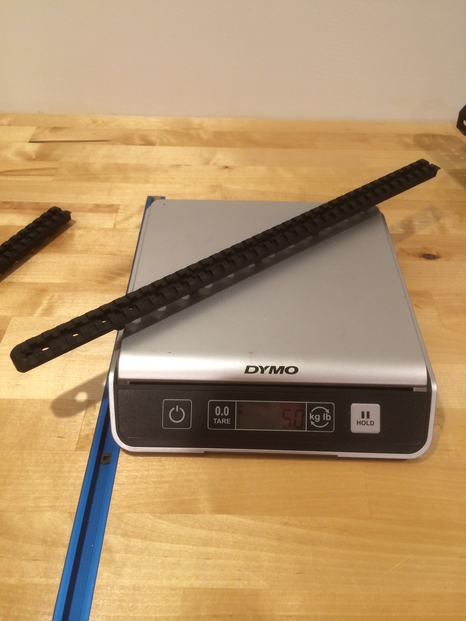

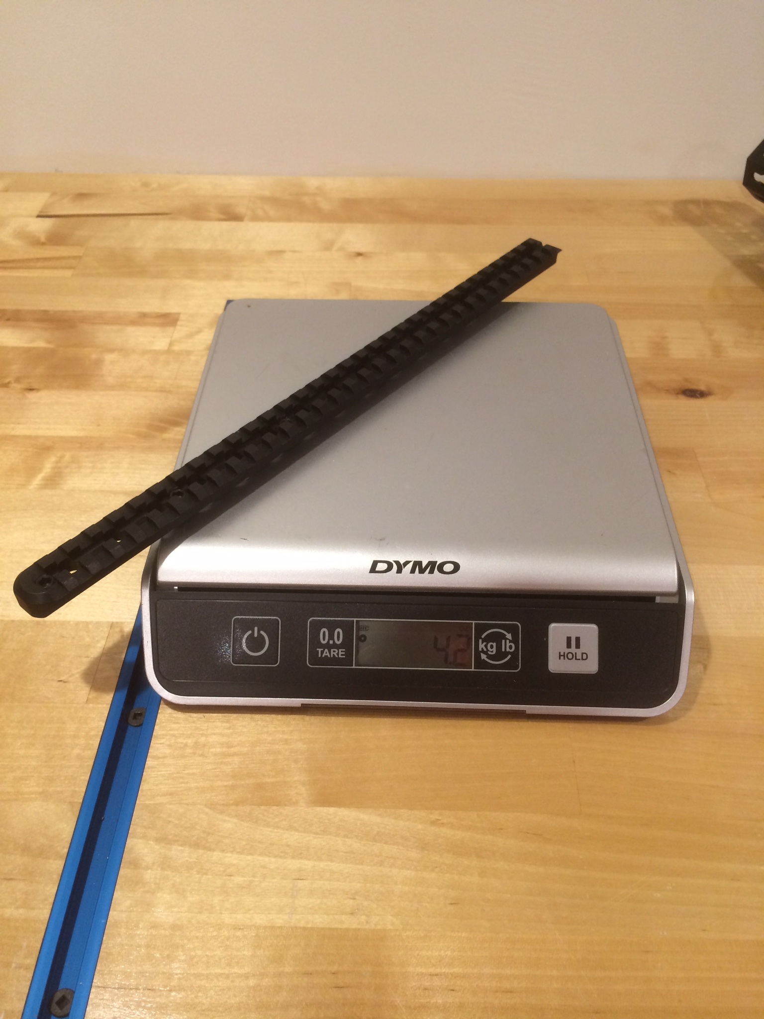

When you say rail, you mean just the picatinny rail and not the entire handguard?

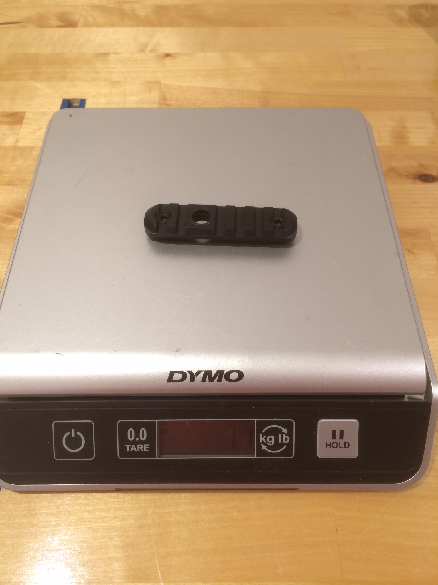

13" picatinny keymod rail: 4.2oz
16" picatinny keymod rail: 5.0oz

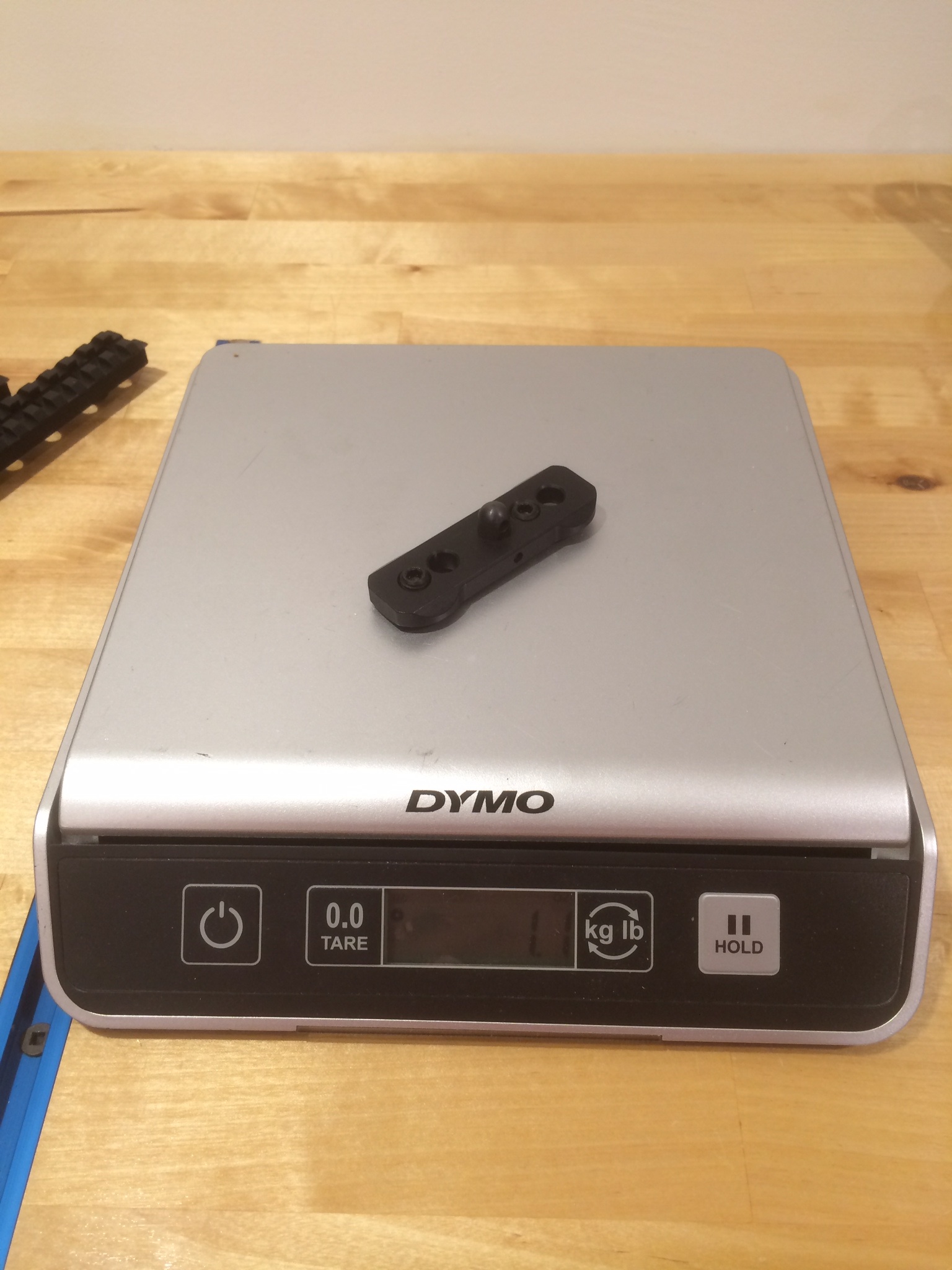

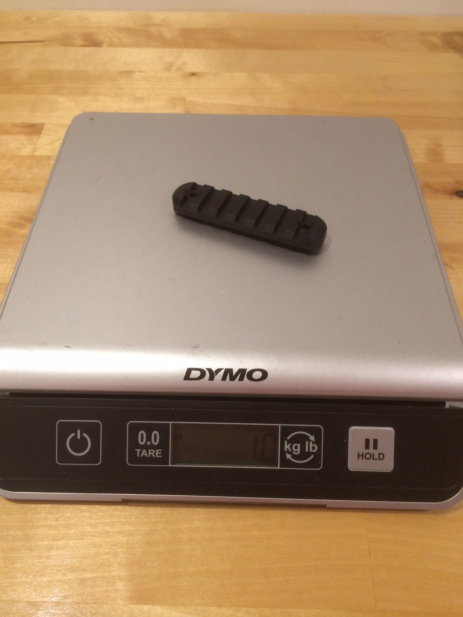

Short little picatinny section: 1.0oz
Short little picatinny section with flush cup: 1.1oz
Short little section with harris bipod adapter: 1.1oz

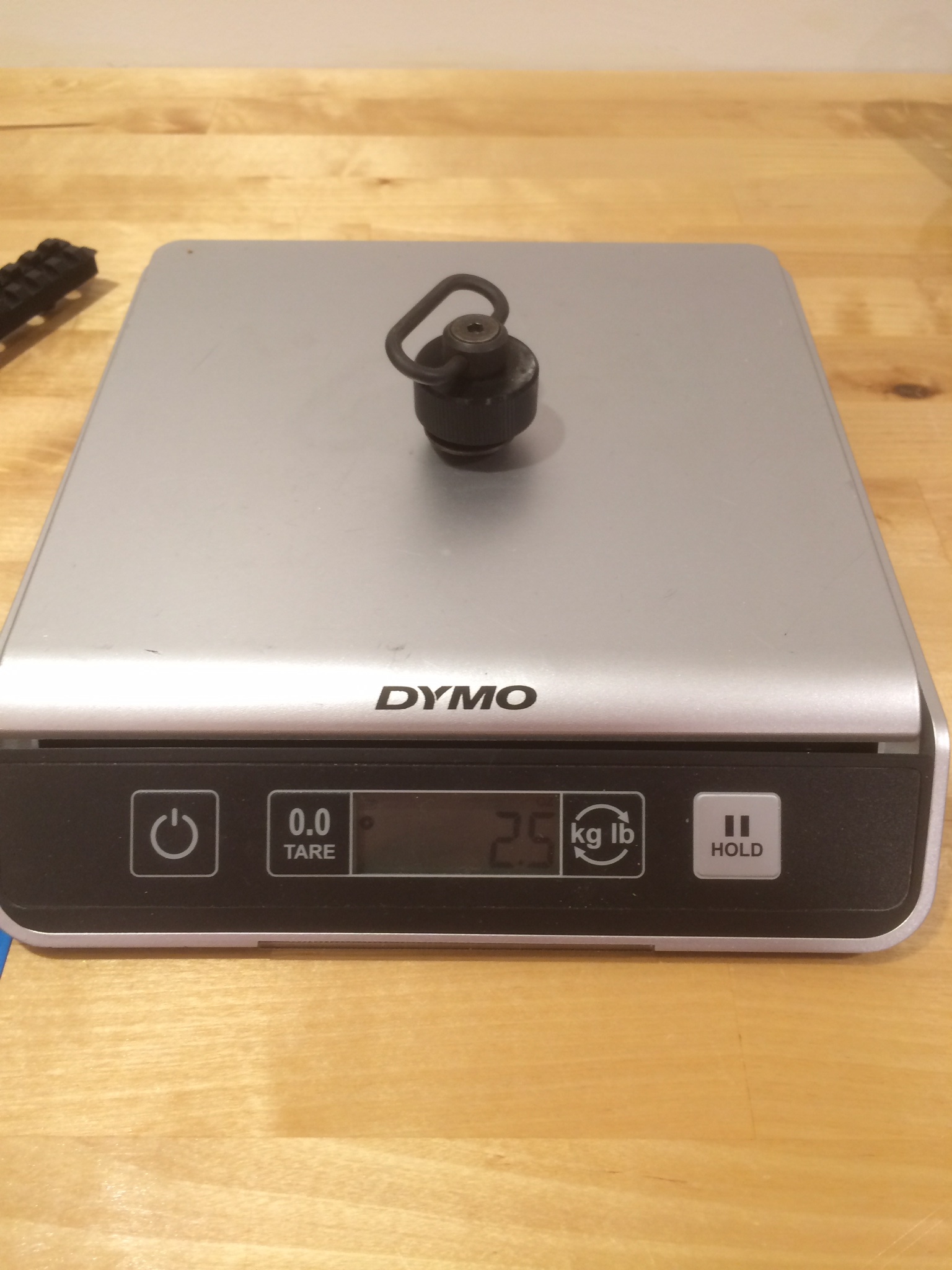

AI handstop: 2.5oz

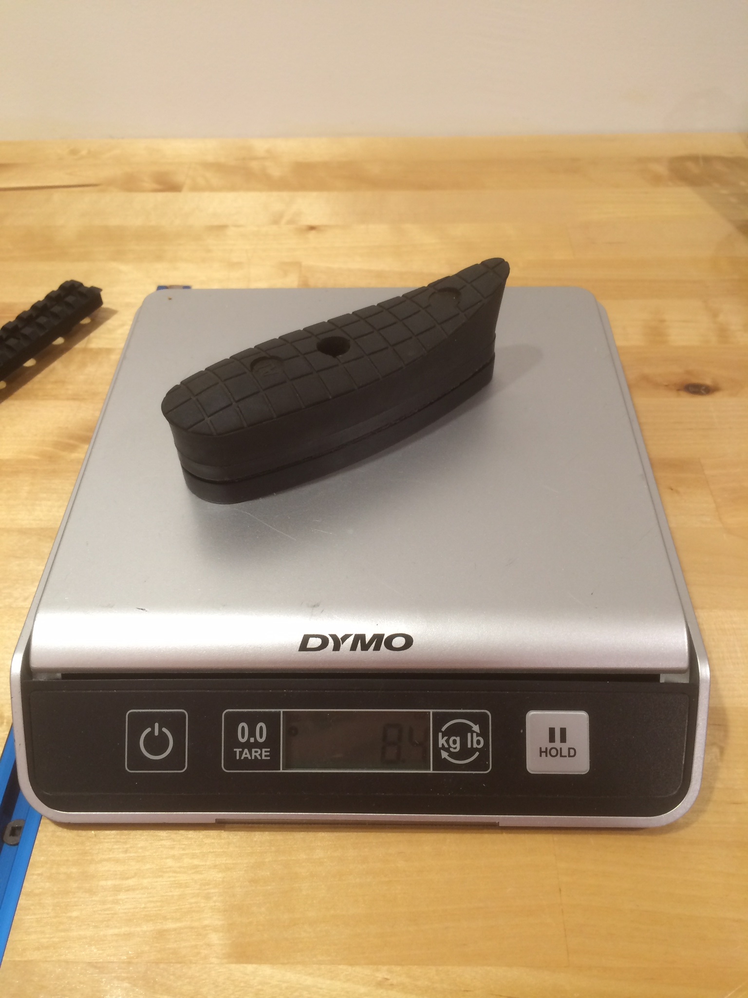

AI Target Butt: 8.4oz

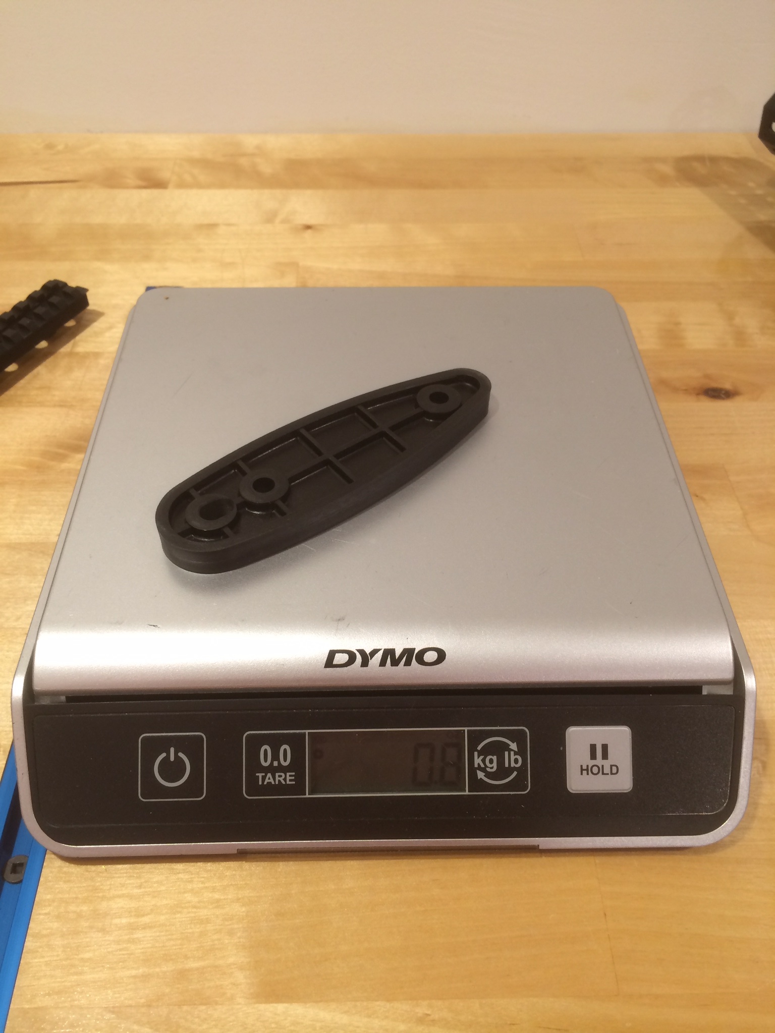

AI Short Butt-Spacer: .8oz

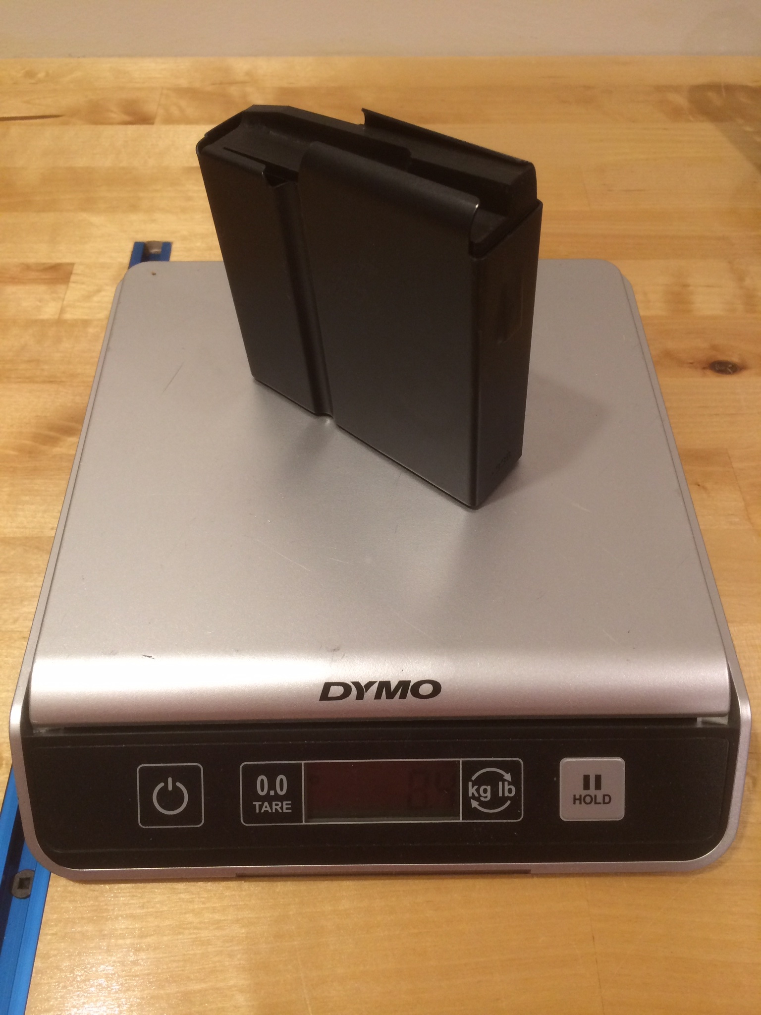

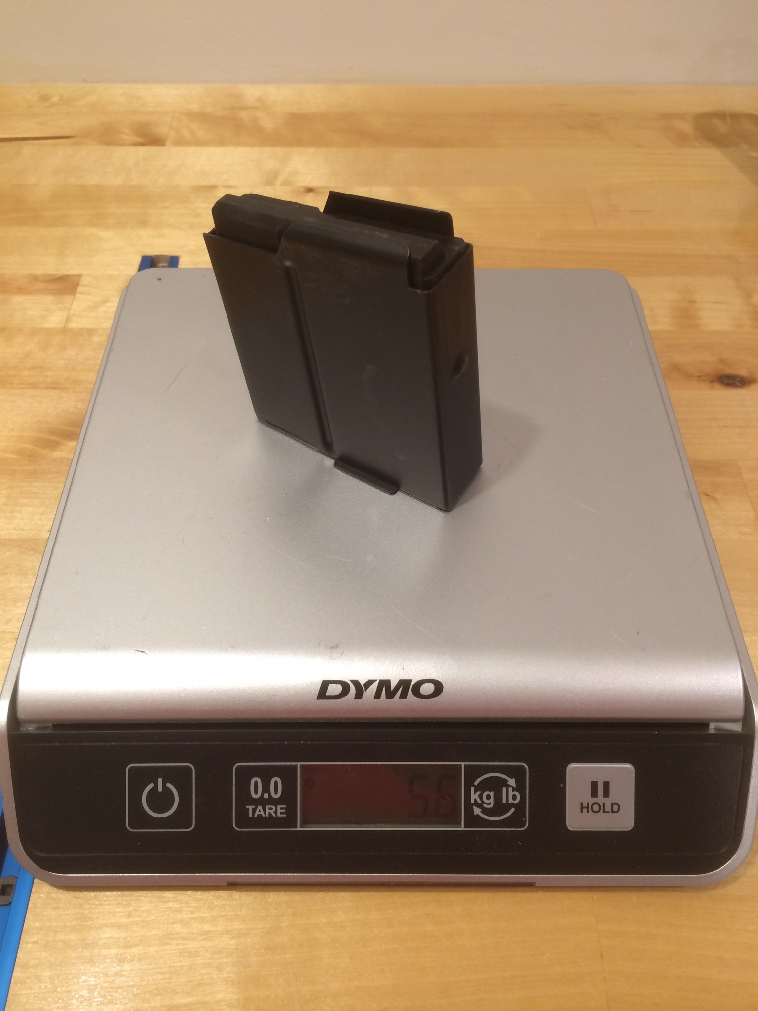

AX .308 mag: 5.6oz
AX .338 mag: 8.4oz
5 more weights (see above post)

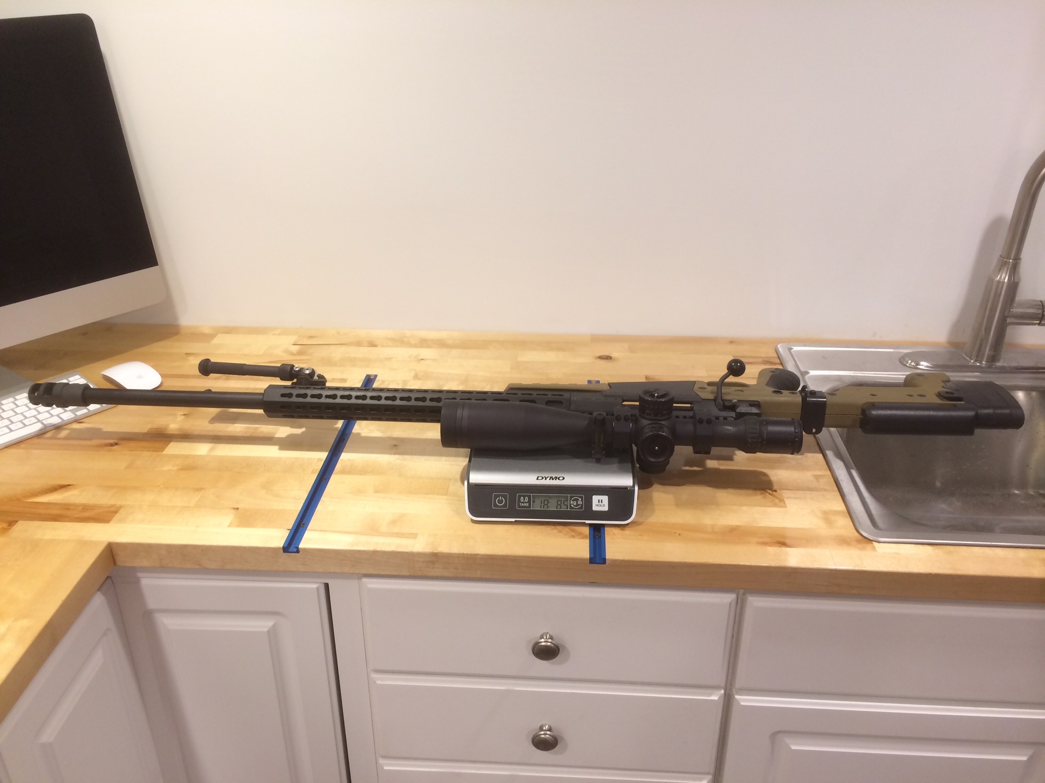

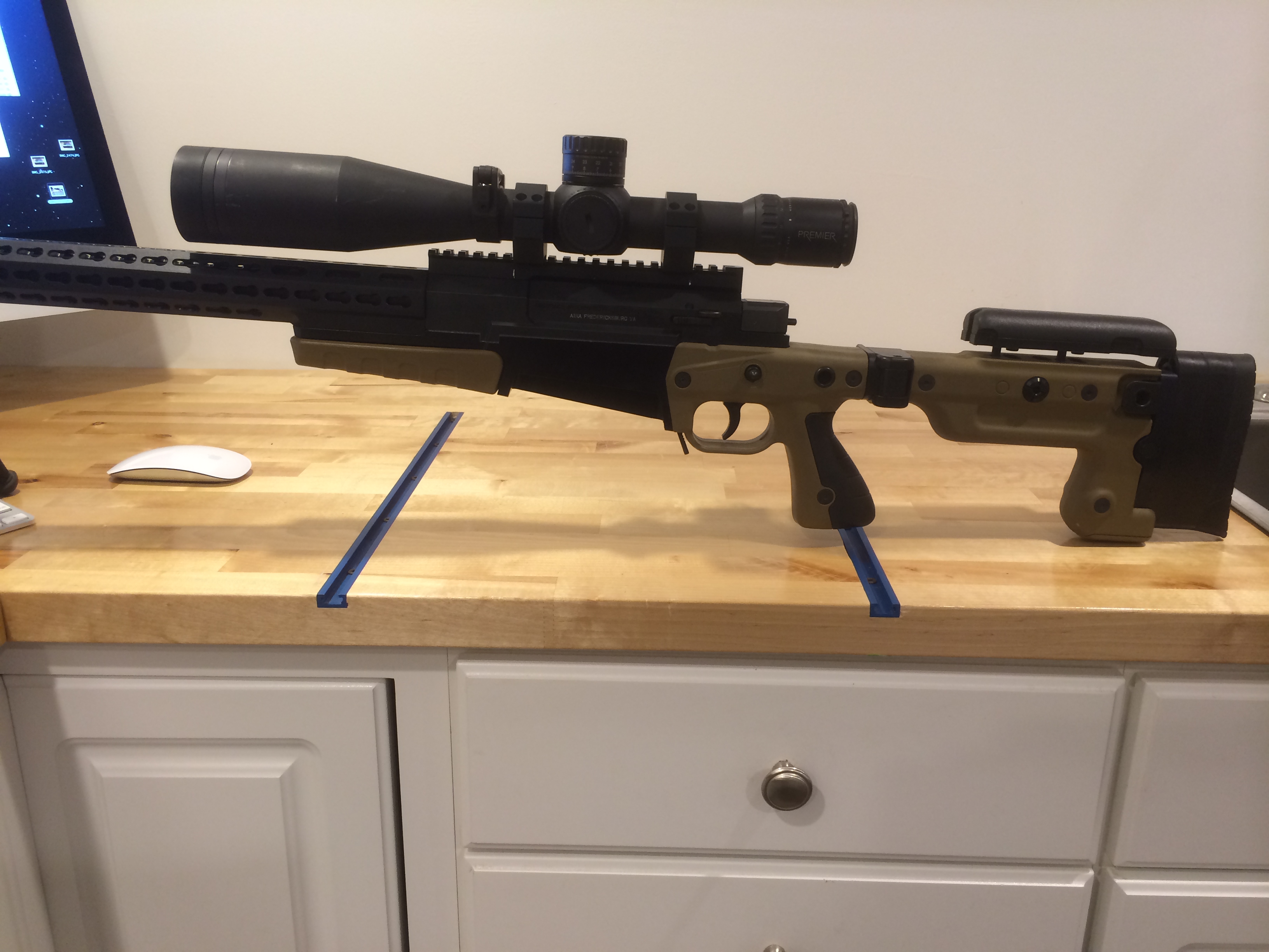

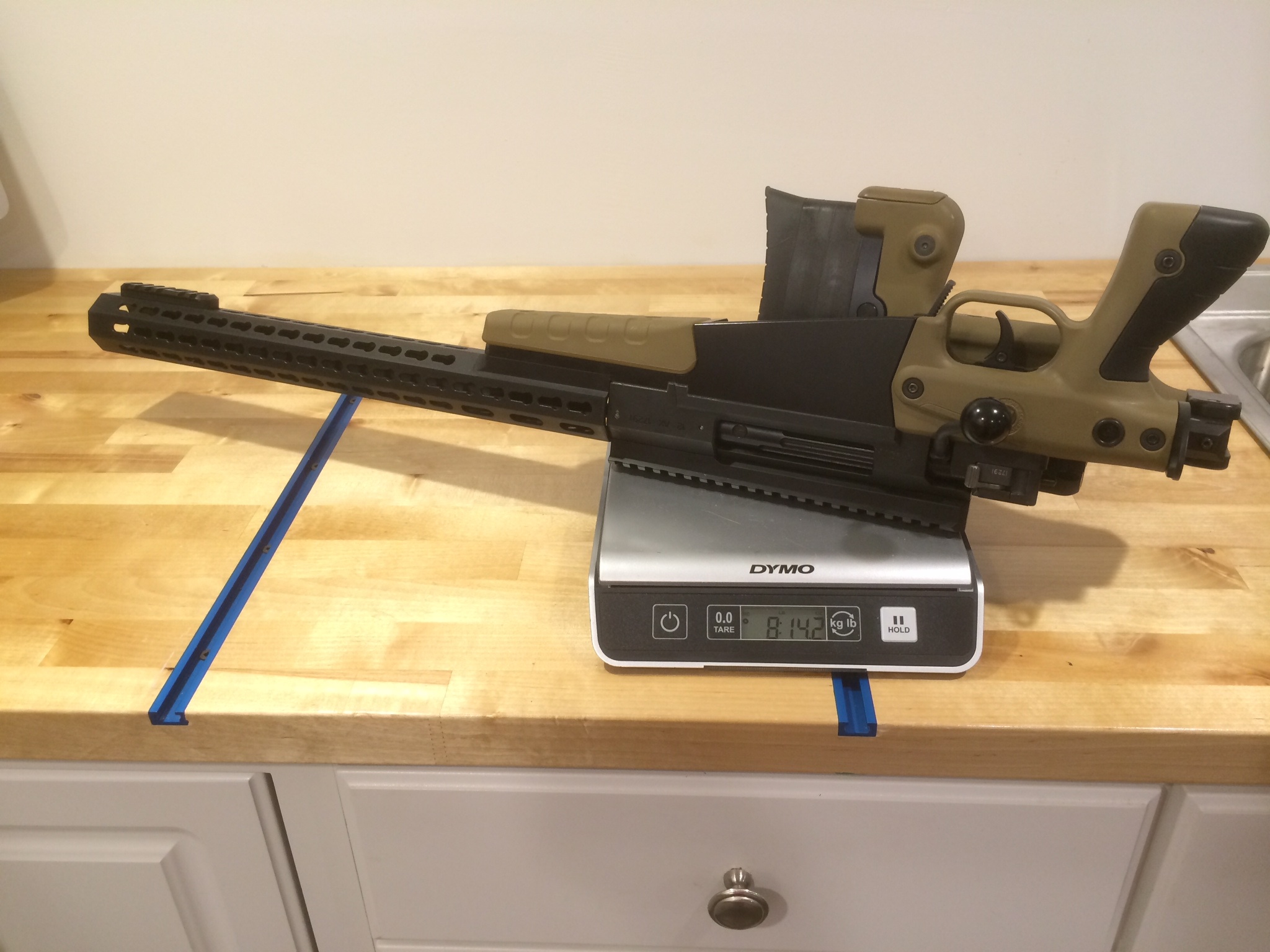

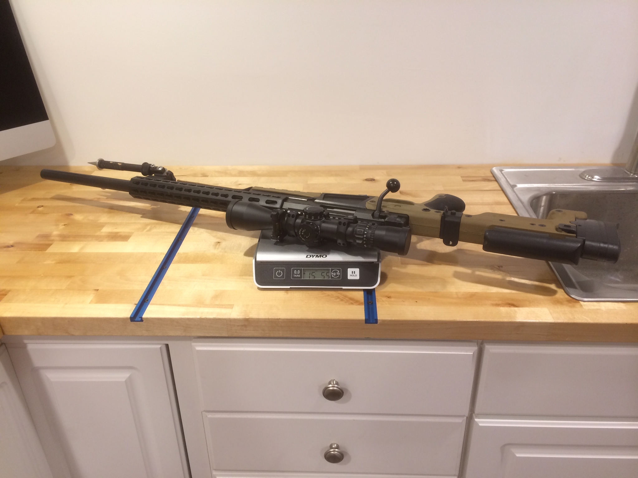

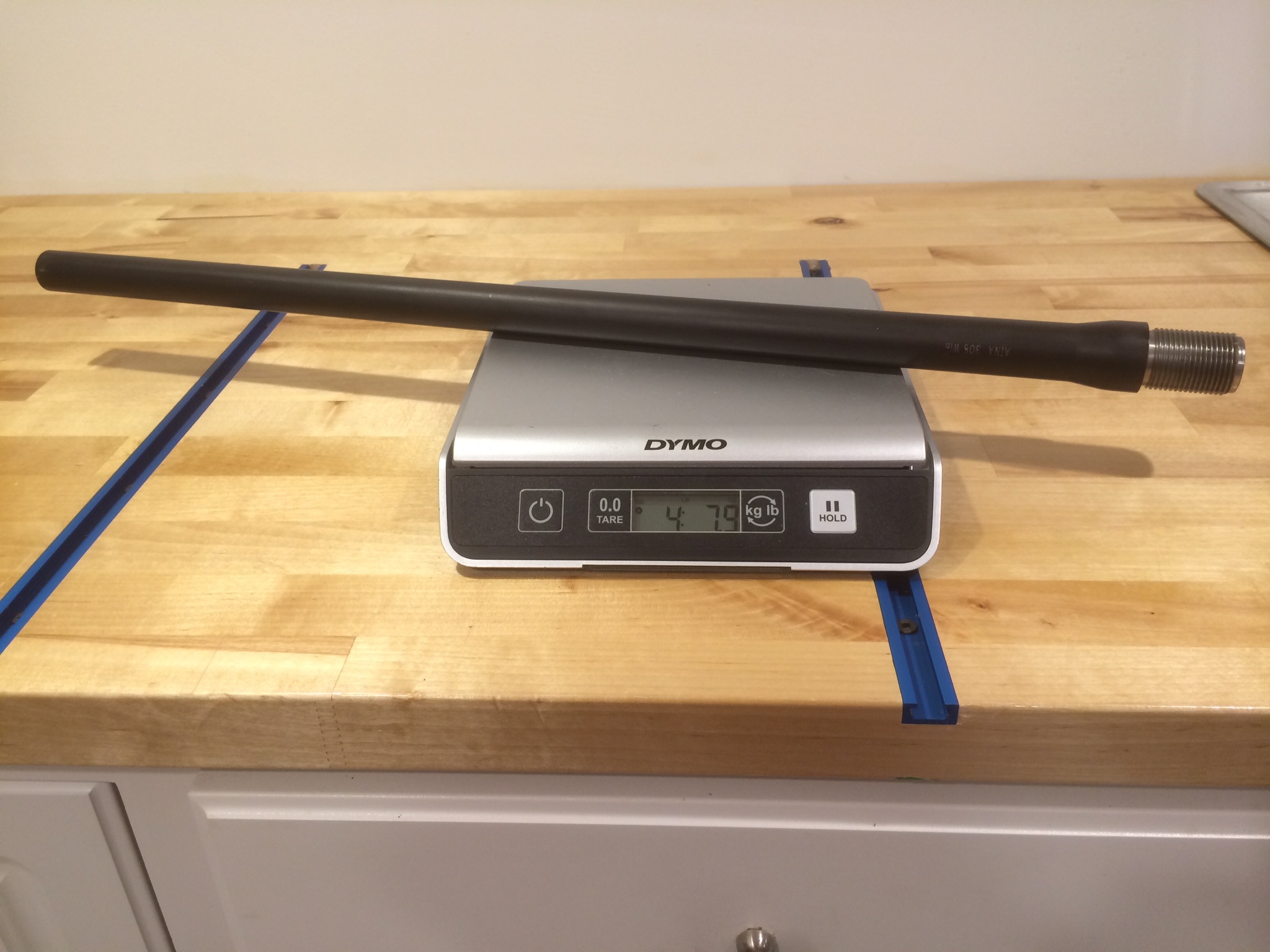

I'm not pulling my handguard off, cause thats a huge pain in the ass, but barrels are easy and I've been wanting to do this for my own purposes anyhow.
Factory 24" AINA .308 Barrel: 4lb 7.9oz
AI AX .308 Chassis with bolt and a small picatinny with flush cup section but no top rail and no magazine: 8lb 3.3oz
AI AX .338 Chassis with bolt and a small picatinny with flush cup section but no top rail and no magazine: 8lb 14.2oz

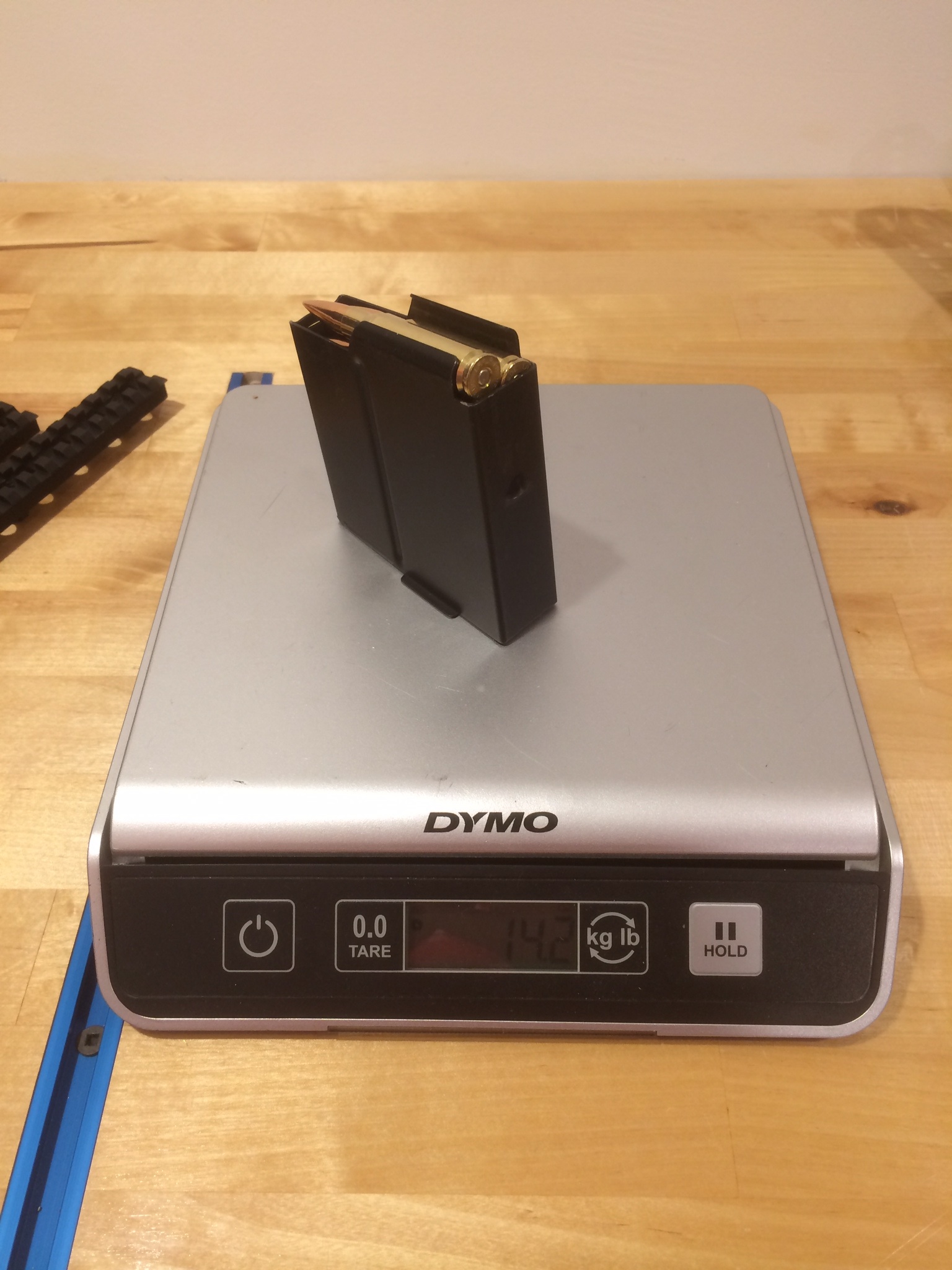

AX .308 magazine loaded: 14.2oz
AX .338 magazine loaded with 338 norma rounds: 1lb 8.6oz

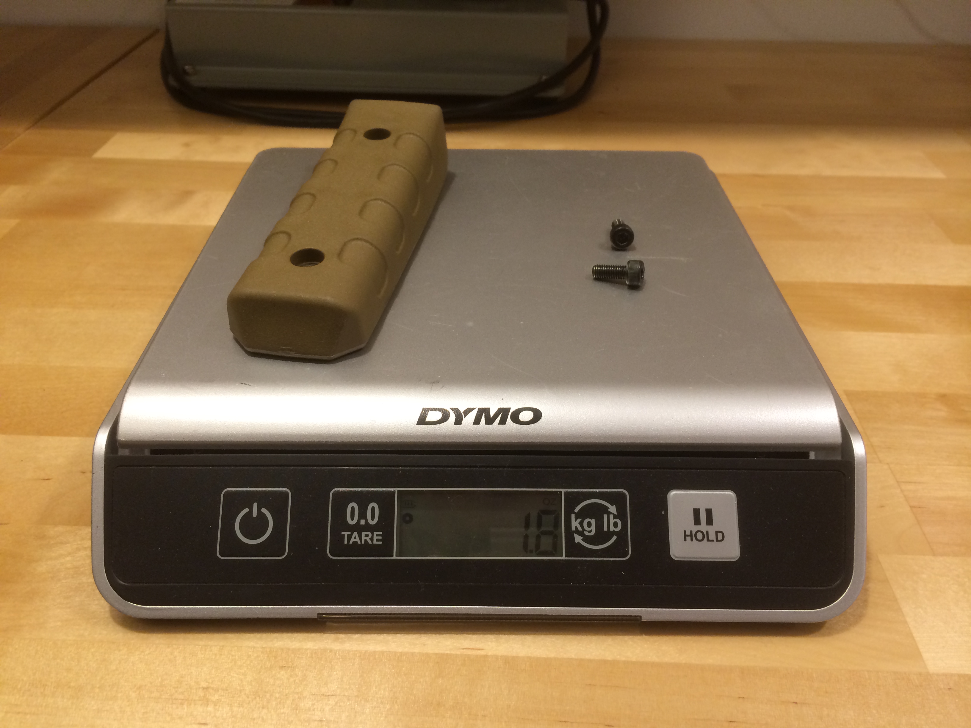

As for weight of plastic handguard deal… see photos.

That plastic carry handle part is way lighter than I expected but I only assumed heavy because "AI". Thanks for pulling that off to weigh!
