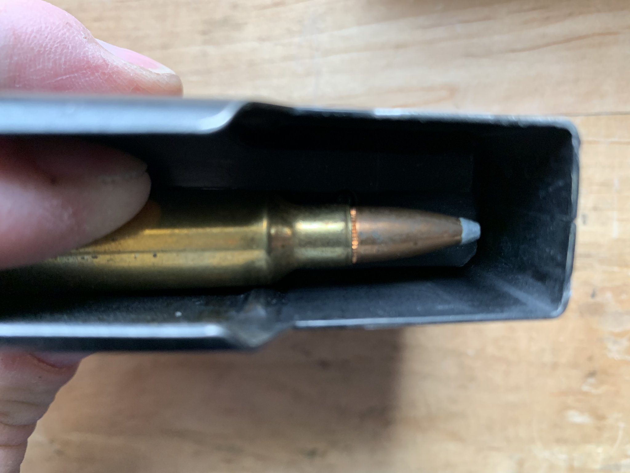

I am thinking about ordering a .284 Win barrel for my AX. I love the 7mm and would really like to use one in my AI. 7mm-08 seems a little slow in the 162-168 gr zone. .284W can push a 168 to 2700 conservatively. The OAL of the AX mags is about 2.950”. The would allow a slightly longer “seat”.
Anyone have an experience doing something like this? Feeding issues? Results?
Just test fit some. The shoulder of the case rides atop the magazine rib.
Reactions: Geno C.
It does hold them in the magazine amazingly, and they strip ok. Fit 7 rounds total. I’d be hesitant to go forward with one though. How bout a 7 SAW, or maybe Sherman makes something that would work?
