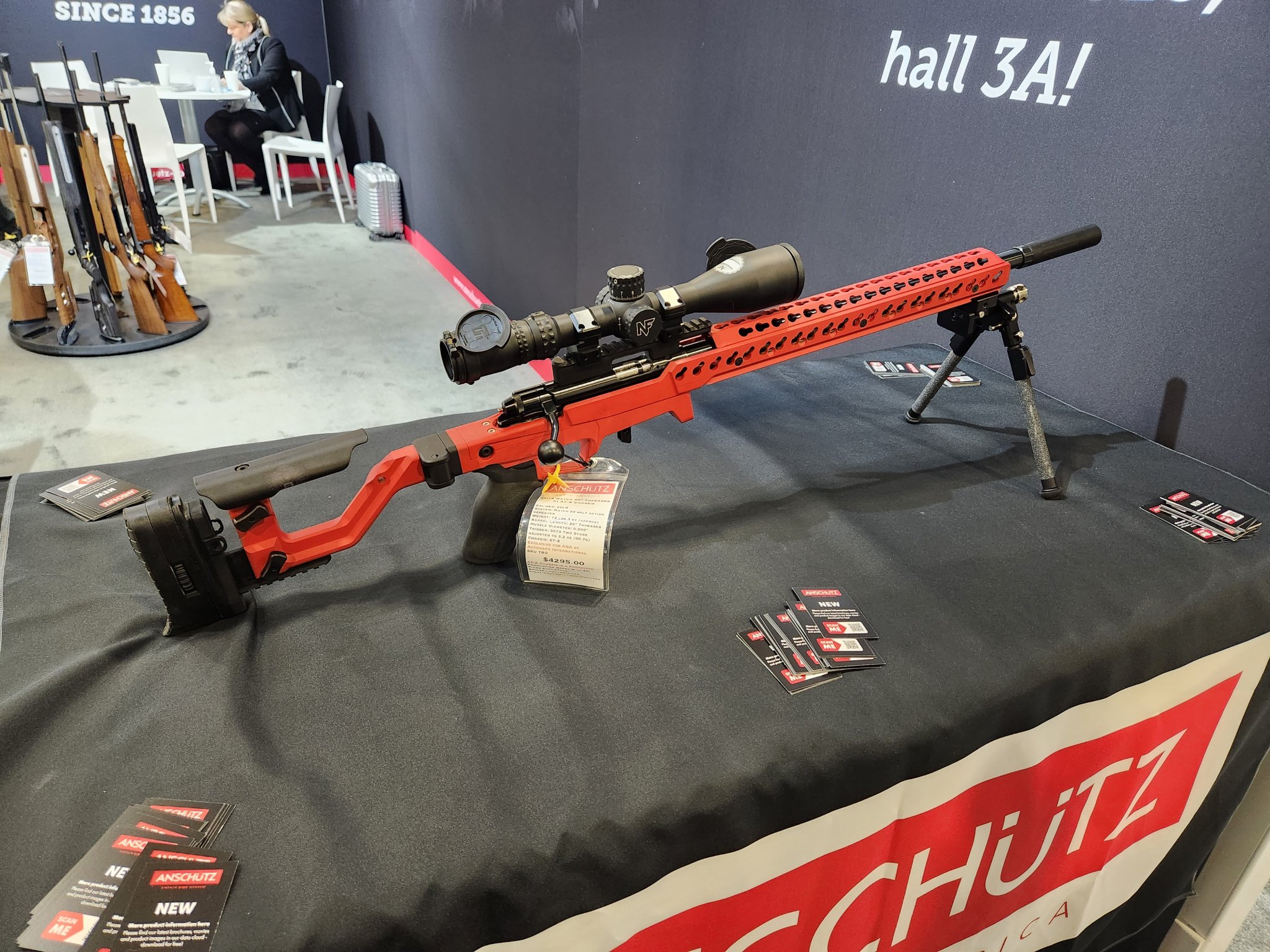

I saw that prototype in the wild a couple weeks ago at a 22PRS match...it made me inquire about what I was looking at. I'm a Rim-X shooter and know nothing about Anschutz but it made me kinda want one. Sorry I didn't get any photos.

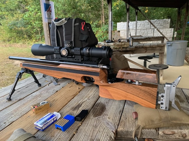

Since ANA posted a pic of the 1727F in the AT-X AICS prototype, I will add some details.
As far as how does the Fortner shoot, I would say it holds up the reputation of Anschutz target rifles. In the fall of 2020 (height of the Rona Pandemic) ANA sent us a 1727F in a wood CISM stock for evaluation on suitability for a chassis. The 1727F has an 18" barrel that tapers from .990" at the receiver to .830" at the muzzle and weighs approximately 3.1 lbs. It's a fairly light barrel for competition shooting but with careful support it does shoot very well. In general, I have found the very short barreled rimfires sensitive to support and prone to vertical dispersion when not carefully controlled. One of the test barreled actions is my personal Model 54.18 MSR. The MSR has a 22" barrel of approximately .900" taper. I have done a fair amount of testing with the MSR and I shot several rimfire matches with the barreled action fitted in a modified Anschutz Super Match stock for Olympic style positional shooting. The combination of the MSR and Super Match stock is highly accurate. Below are some groups from both the 1727F and the MSR.

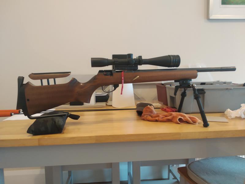

1727F in the CISM stock. This is not a great stock for PRS/NRL shooting. It's too sensitive to support.

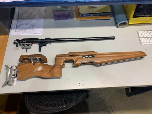

1727 Barreled action. This is a very stiff action with the best trigger ever devised.

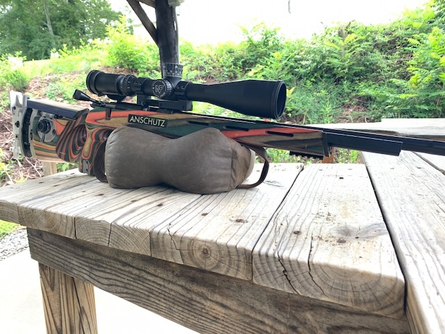

The target below is the MSR in the Super Match stock at 104 yards. The middle bull is a zero check group. I like testing one shot per bull to get exact measurements on each individual shot. I don't expect anyone to turn up at match with rifle and ammo that will out shoot this one. Anschutz does know a thing or two about accurate rimfires.
This is the 54.18 MSR in the positional stock that shot the above target.
These groups were shot at 104 yards with the 1727F and the CISM stock.
  1. The left group is with the bipod vertical and a rear support bag.
  2. The middle group is with the bipod at 45 degrees. Tighter center, but still vertical.
  3. Right group is with the gun fully supported on a Game Changer bag pinching the front of the stock into the bag. I'll take that all day long!

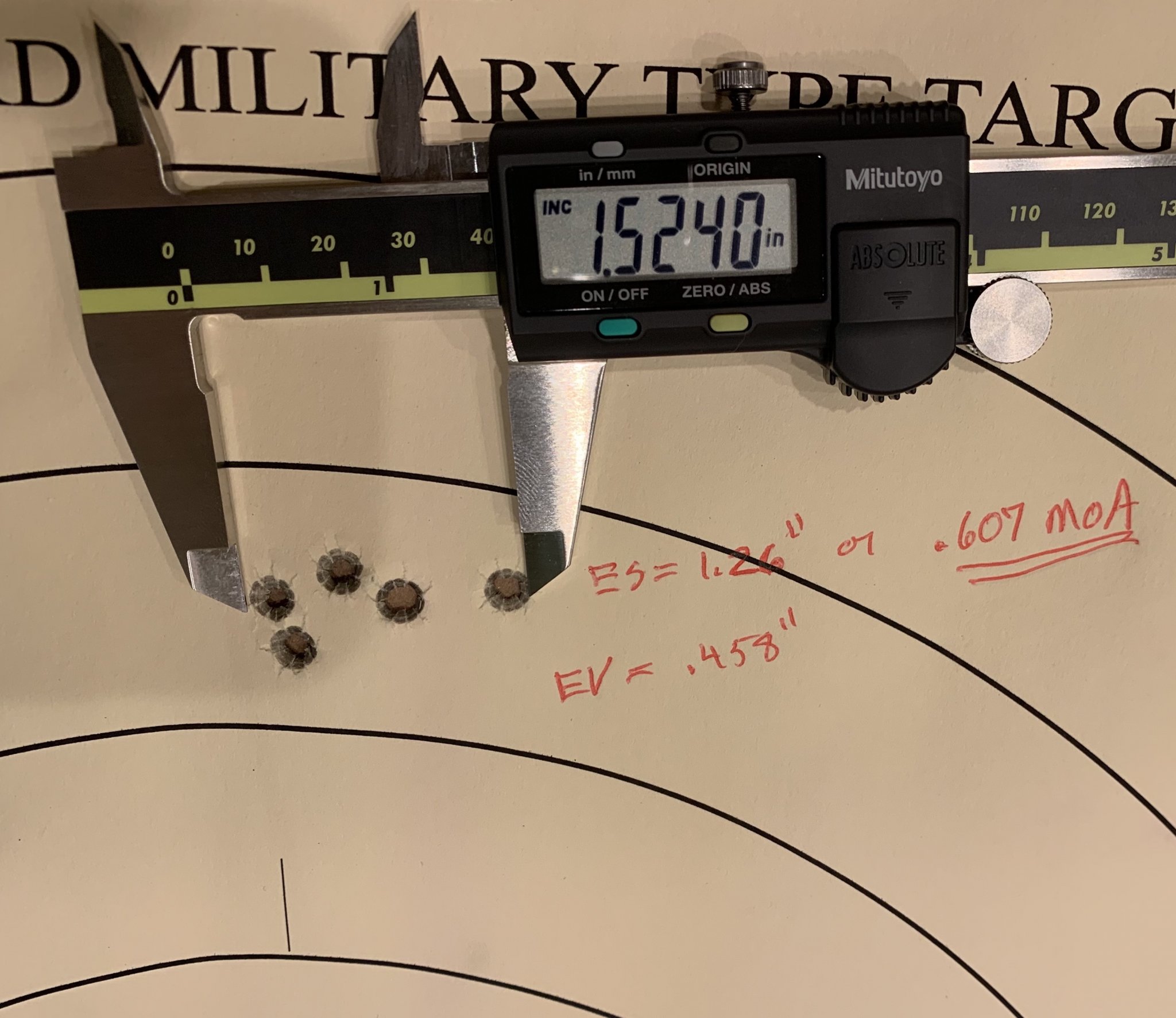

The pair of targets below are my 104 yard zero check a few hours before the Quantico Shooting Club PRS match a couple of weeks ago.

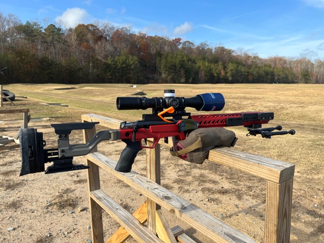

This is the 1727F in the AT-X chassis shot kneeling from a Shemdium Game Changer bag from about the height of the low step on a PRS barricade. I'm very happy with the zero and the groups. Not many guns are going to beat that.
A 10-shot test group at 104 yards with the 1727F and the AT-X chassis. There was some wind blowing while firing this group, but it is still sub MOA.
1727F in the AT-X chassis at 200 yards. Again with some wind to contend with.
1727F at 325 yards. A decent pair of 10 shot groups with significant wind to contend with. These are still sub MOA groups!
This ammo by the way is over 25 years old. I'm burning up old lots of ammo from my Conventional Smallbore days.

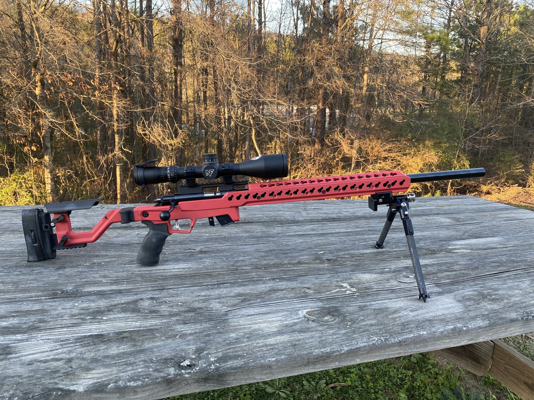

Here's a pic of the 1727F in the AT-X chassis with a TB suppressor attached. The 24 inch barrel that will come on guns next year will look very much like this.
We are shipping the chassis to ANA next week for evaluation and feedback. It is very close to being released for production which will follow any comments and feedback from ANA.

Thanks for the great info. You mentioned that the 1727F and maybe due to the short barrel is prone to issues when shooting off a bipod or pressure on the stock, does that also occur on the AT-X with the 1727F or do you think it was mainly the way the 1727F and its interaction with the stock?
The vertical sensitivity is due to the light wood CISM stock. In the AT-X chassis with weights to perfectly balance the gun it shot really well.
Keep in mind that 18" barrel is NOT what will be supplied in the AT-X chassis. The 1727F for the chassis will have a 24" barrel with a threaded muzzle. The 18" barreled action is what we had available for R&D and it worked out well for that activity. I have shot short barreled Vudoo's and Bergara's that will string vertical as well. I think the good shooters are figuring out that short barrels are not the way to win.
The CISM configuration is designed primarily for offhand shooting.
-Scott

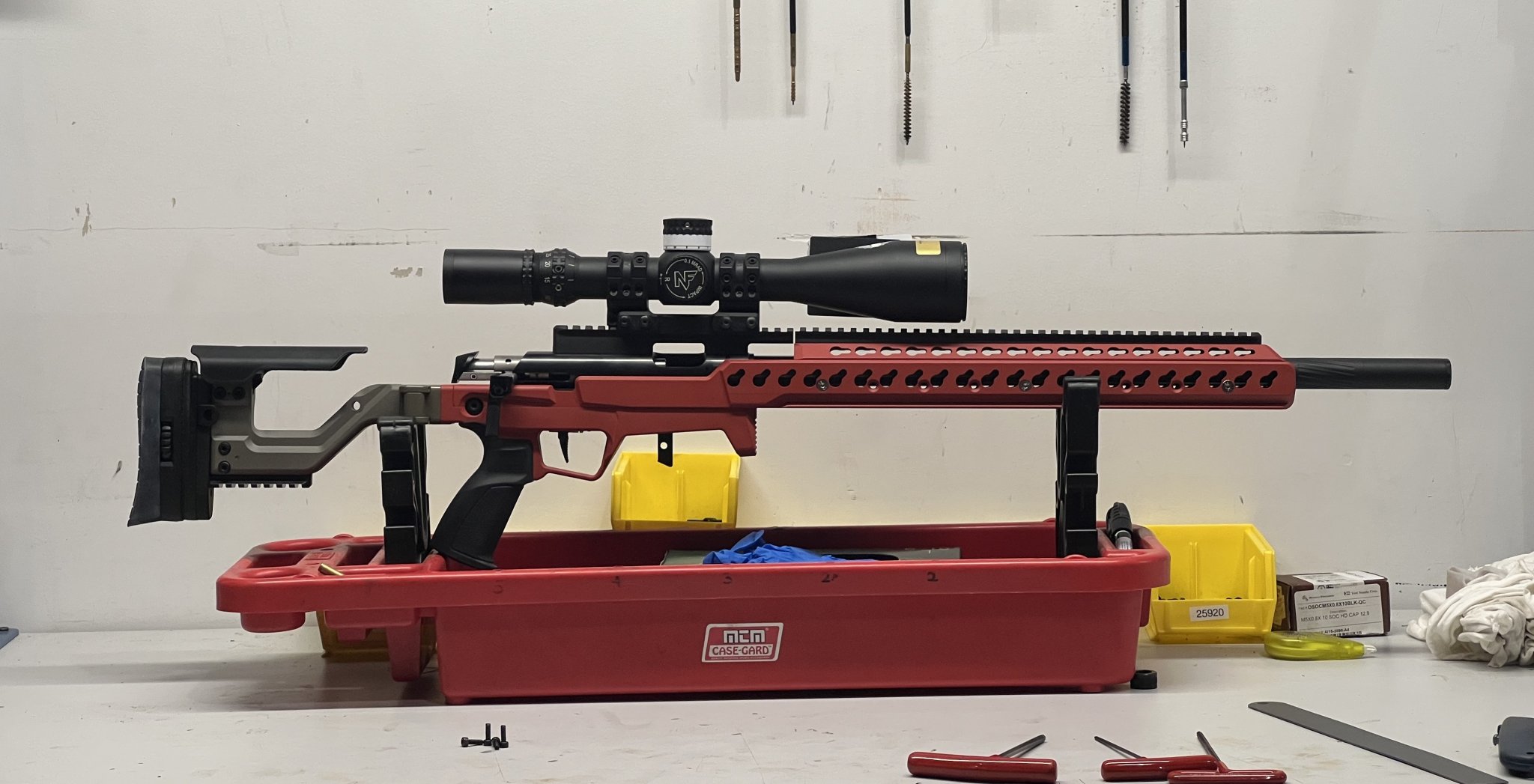

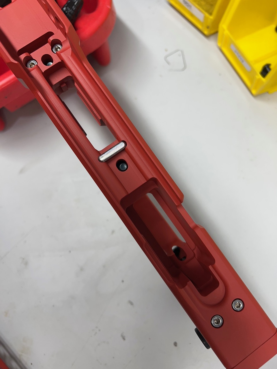

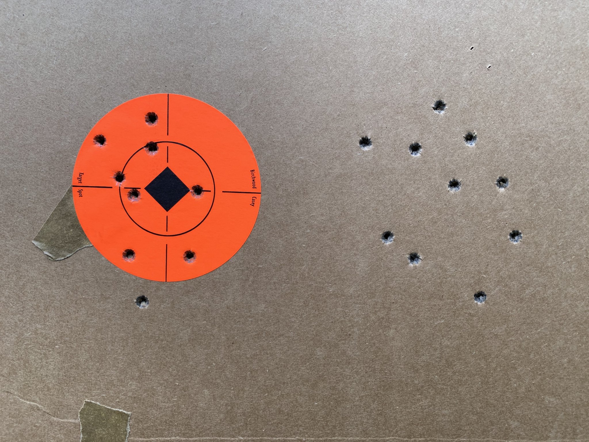

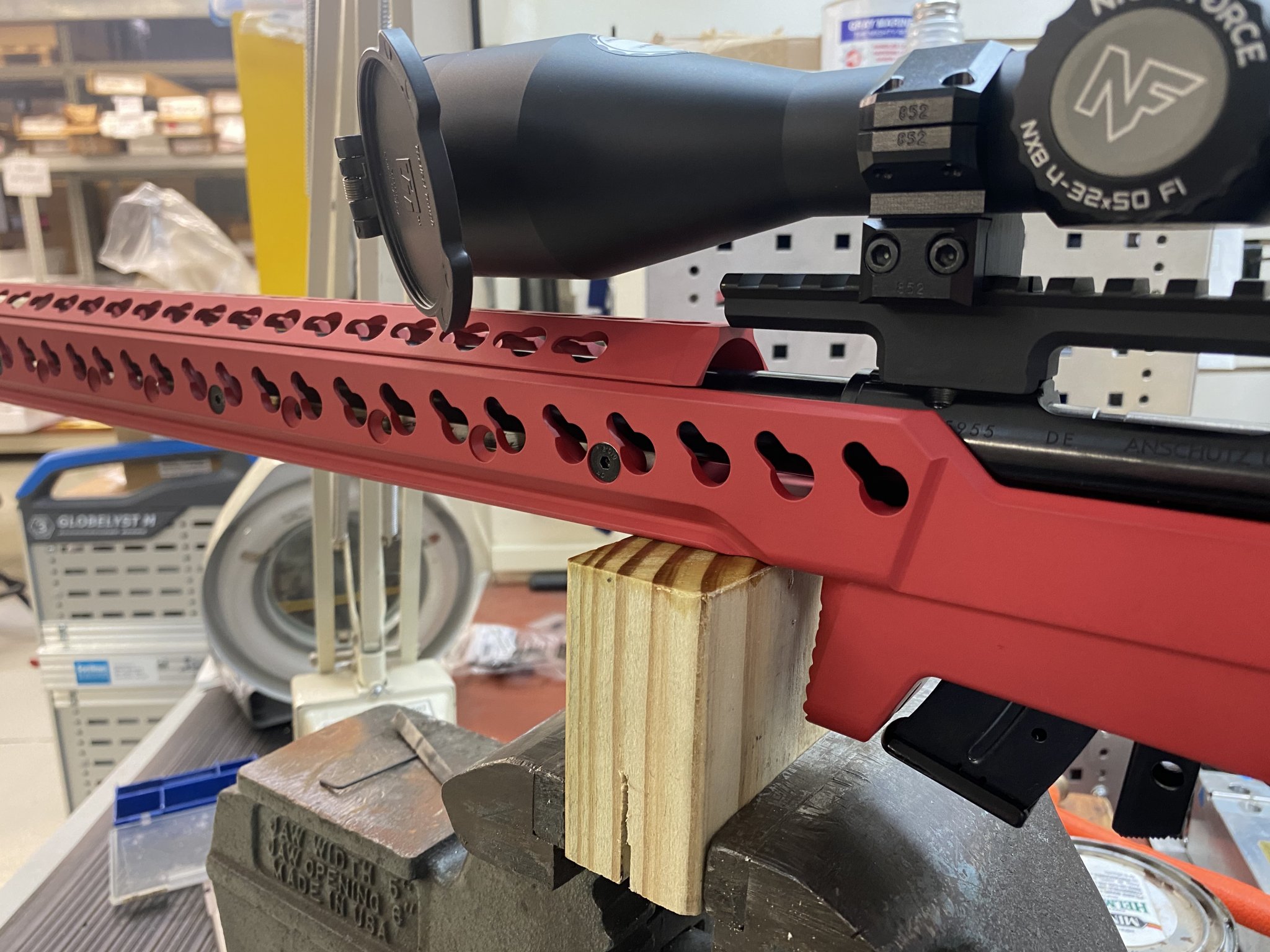

Started testing it at ANA Thursday afternoon. It’s a winner with the 54.18. The target is 10 shot groups with 13 different lots out of the 25.9” barrel.
Weights as pictured-
20” rifle w/ scope and internal brass weights- 14lbs 3.2oz
25.9” same setup- 14lbs 11.2 oz
