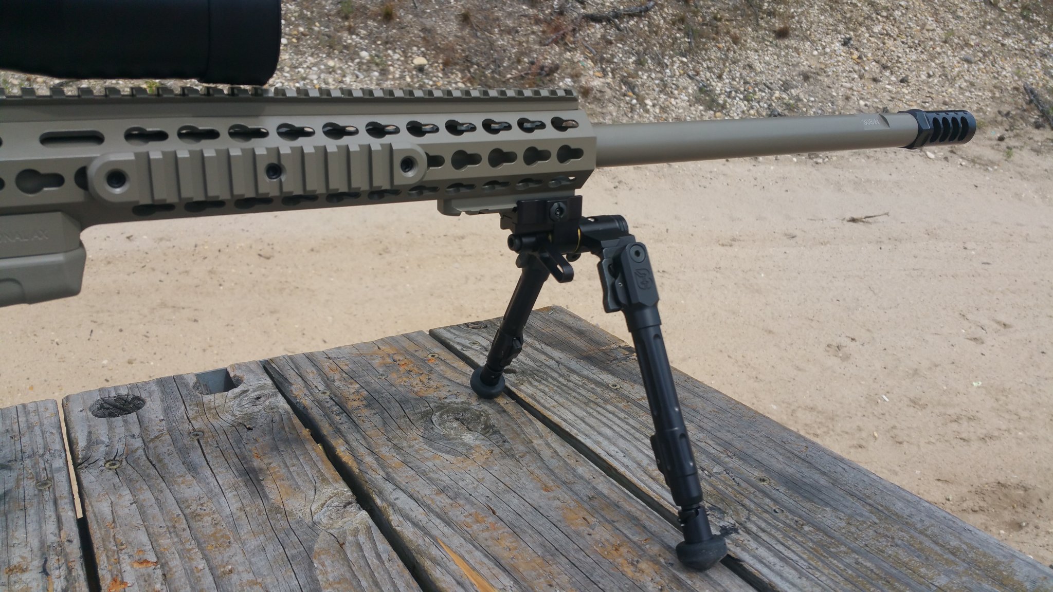

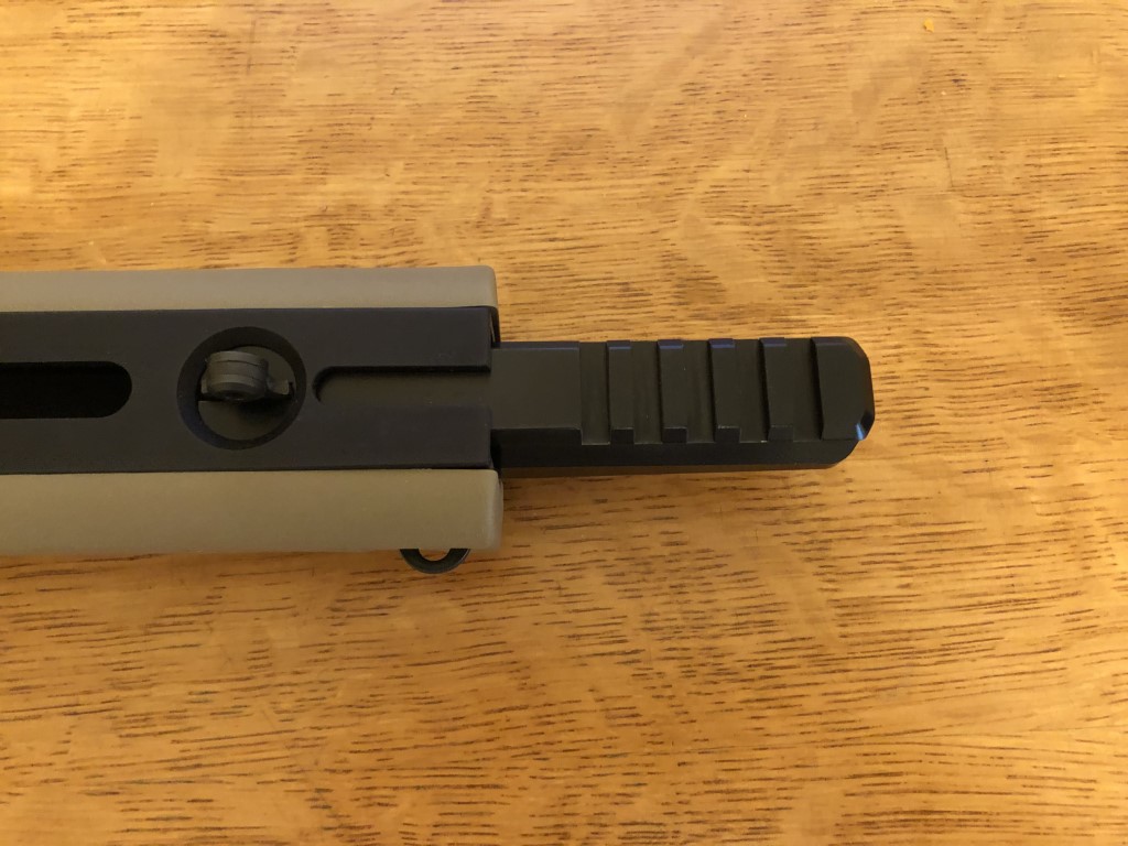

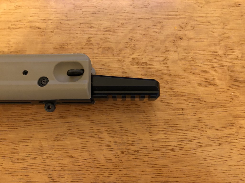

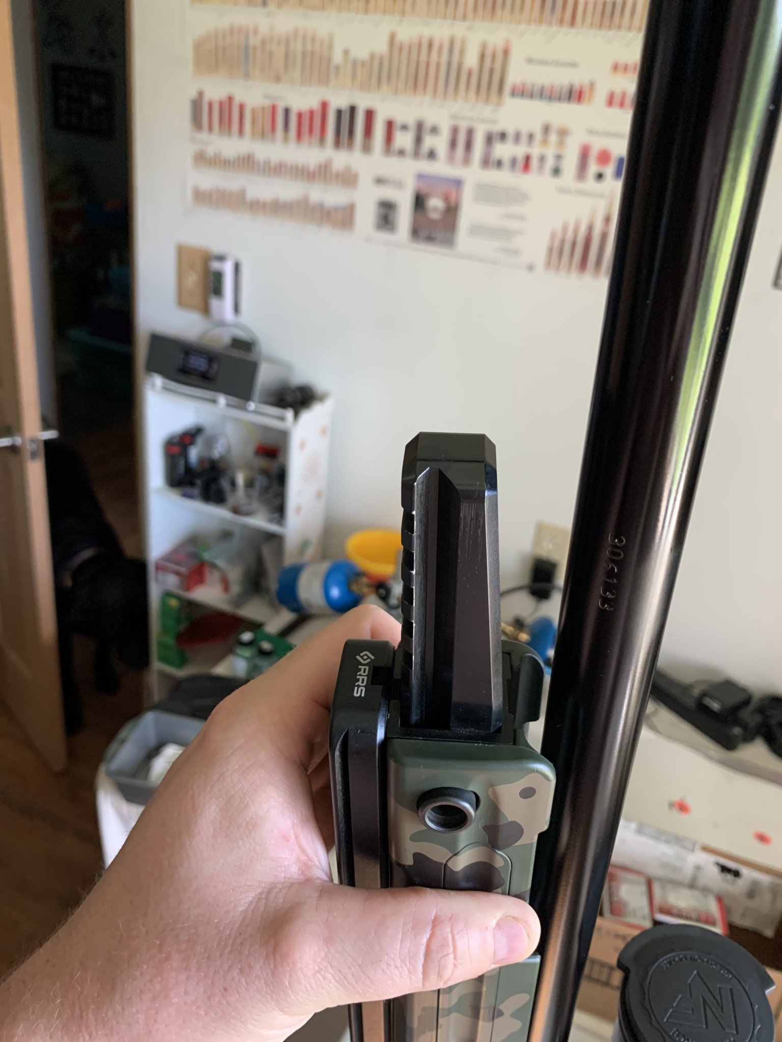

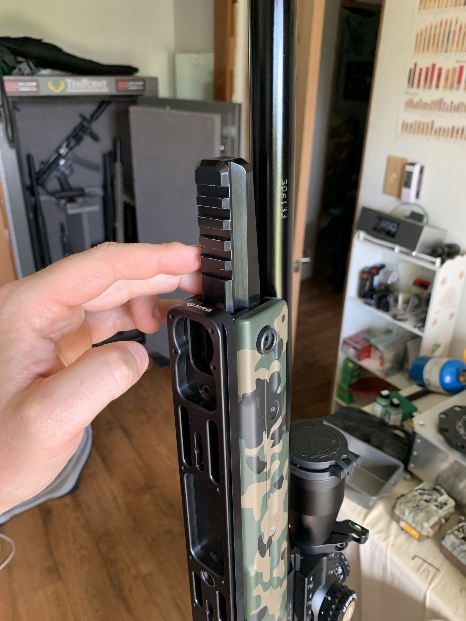

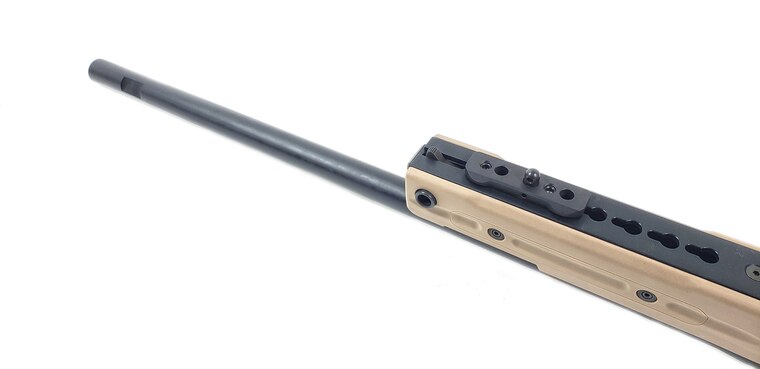

    Check these out, it’s a spigot that replaces the factory “block” inside the square forend tube. I designed it a few years ago and there are quite a few in use across the country.
    Anarchy Outdoors sells them HERE. Available in both picatinny in RRS dovetail (Arca Swiss).

    That looks very familiar!
    Absolutely love mine
    For the AT, it does. Has key slots on the front end so you can add an AI pic rail.

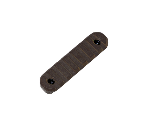

    That ^^^^ from @hic28 pic, is for the legacy AICS. Which has MLOK slots to add a MLOK pic rail if so desired
    This is the best option. It is super solid compared to using the existing spigot which can never be tightened to provide a solid interface.
    Doesn't look like that one would fit a pic rail........
    The link is for the AT with 7 key slot bottom.
    the picture is showing the 3 recesses where the MLOk pic rail can be added
    Now that looks good. Is it in there solid? Never cared for the AI bipod, always too much wobble for me.
    Solid as a rock. No wobble

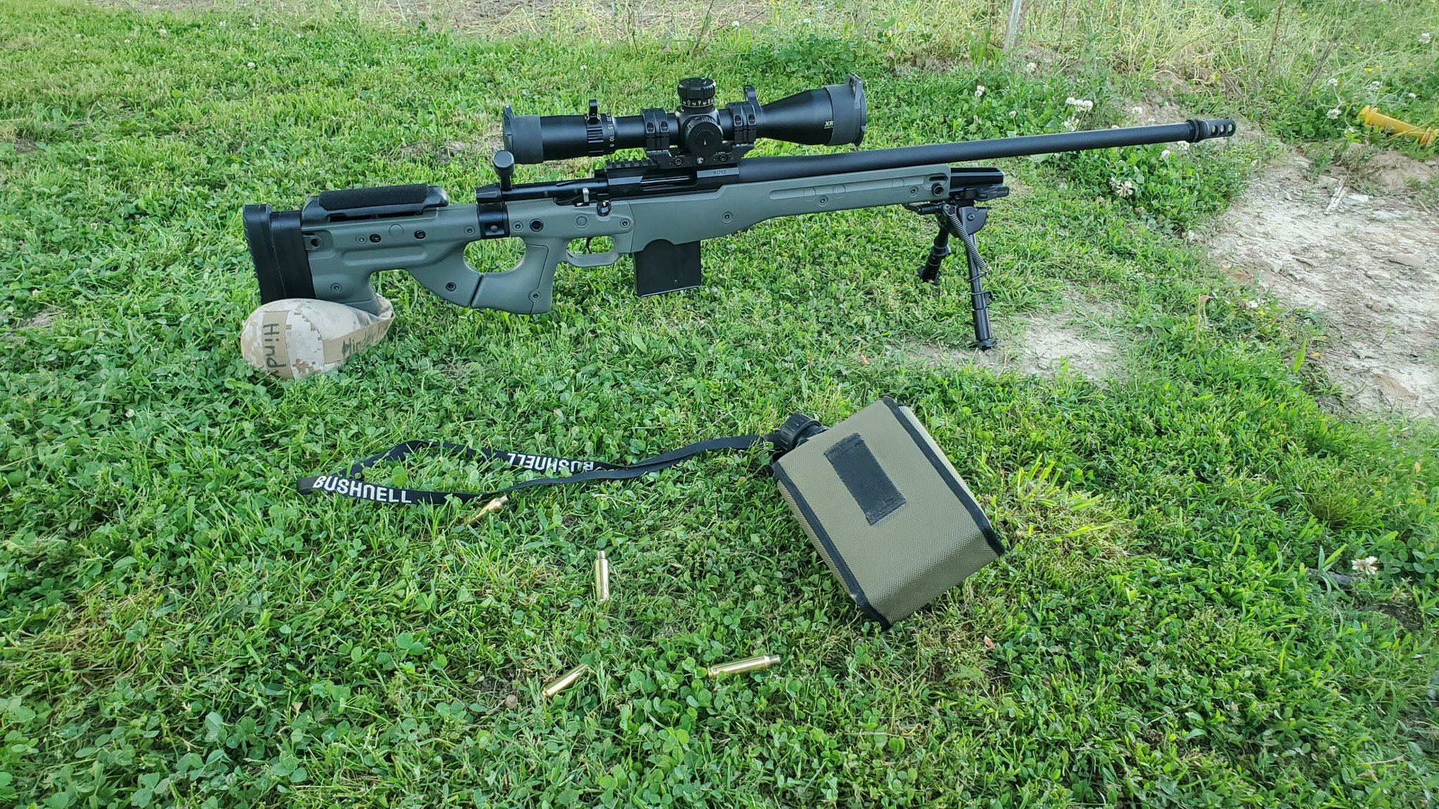

    I believe this is the exact rifle @samb300 posted above. The rifle has made its way to its final owner...me 😎

    Yes. It installs by removing the factory “block” and replacing it with the spigot mount. It uses the two 8mm roll pins and two flat head screws. There’s even an AE/AW/AICS variant that works on rifles up to the AW50. It’s solid.

    I like the fact that it gets the bipod further out towards the muzzle. Also the original is useless for bipod use :)

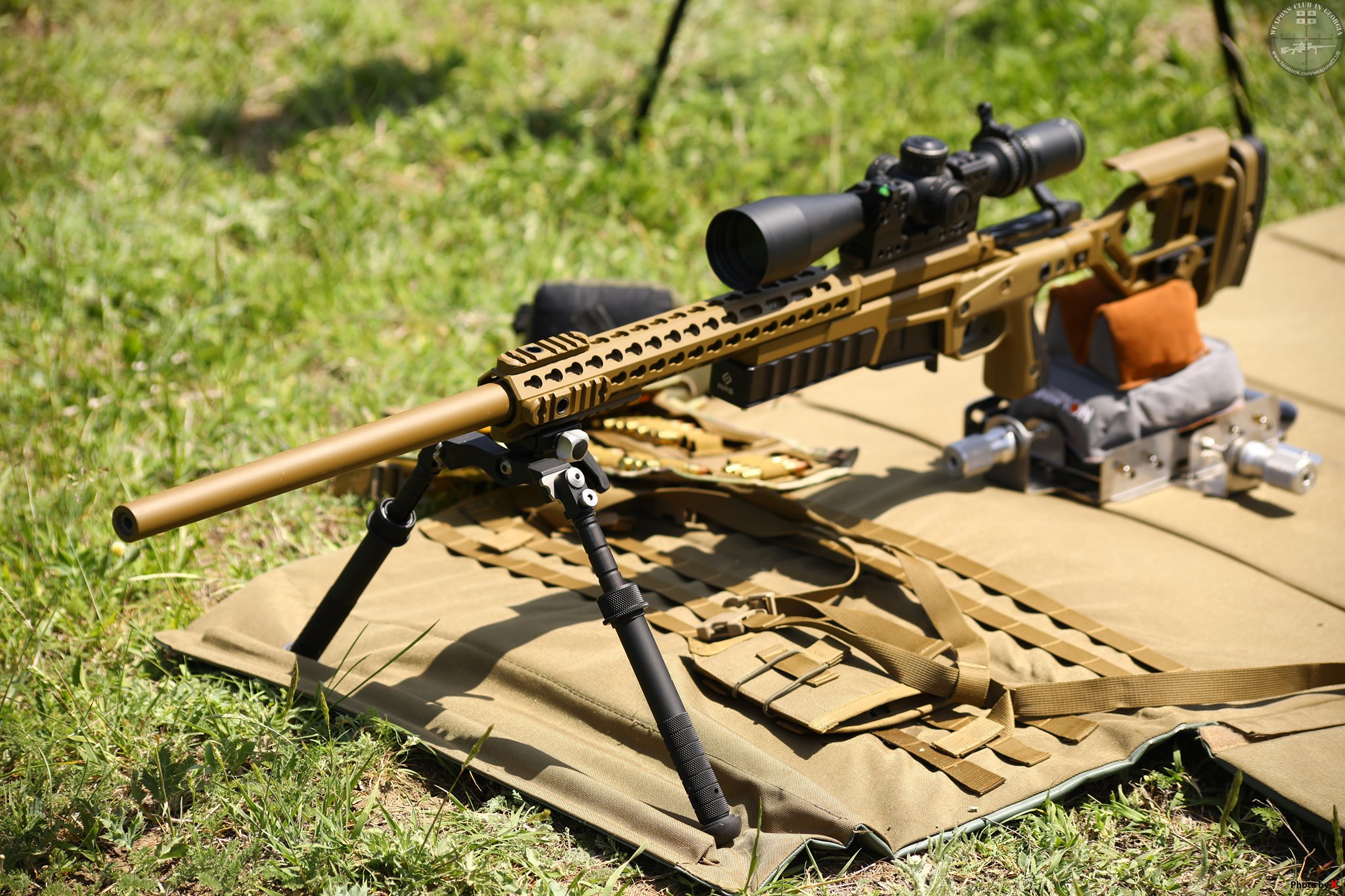

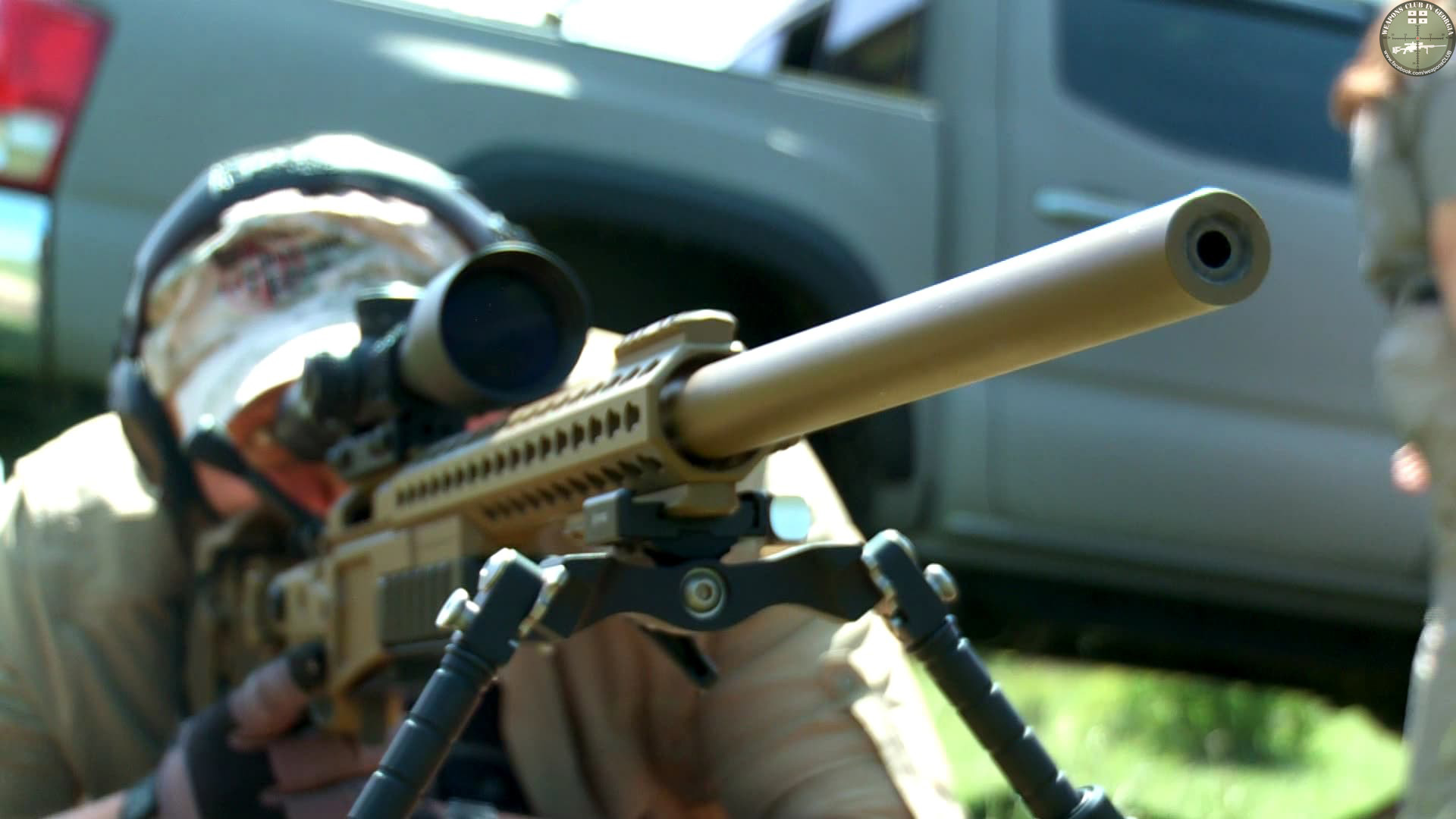

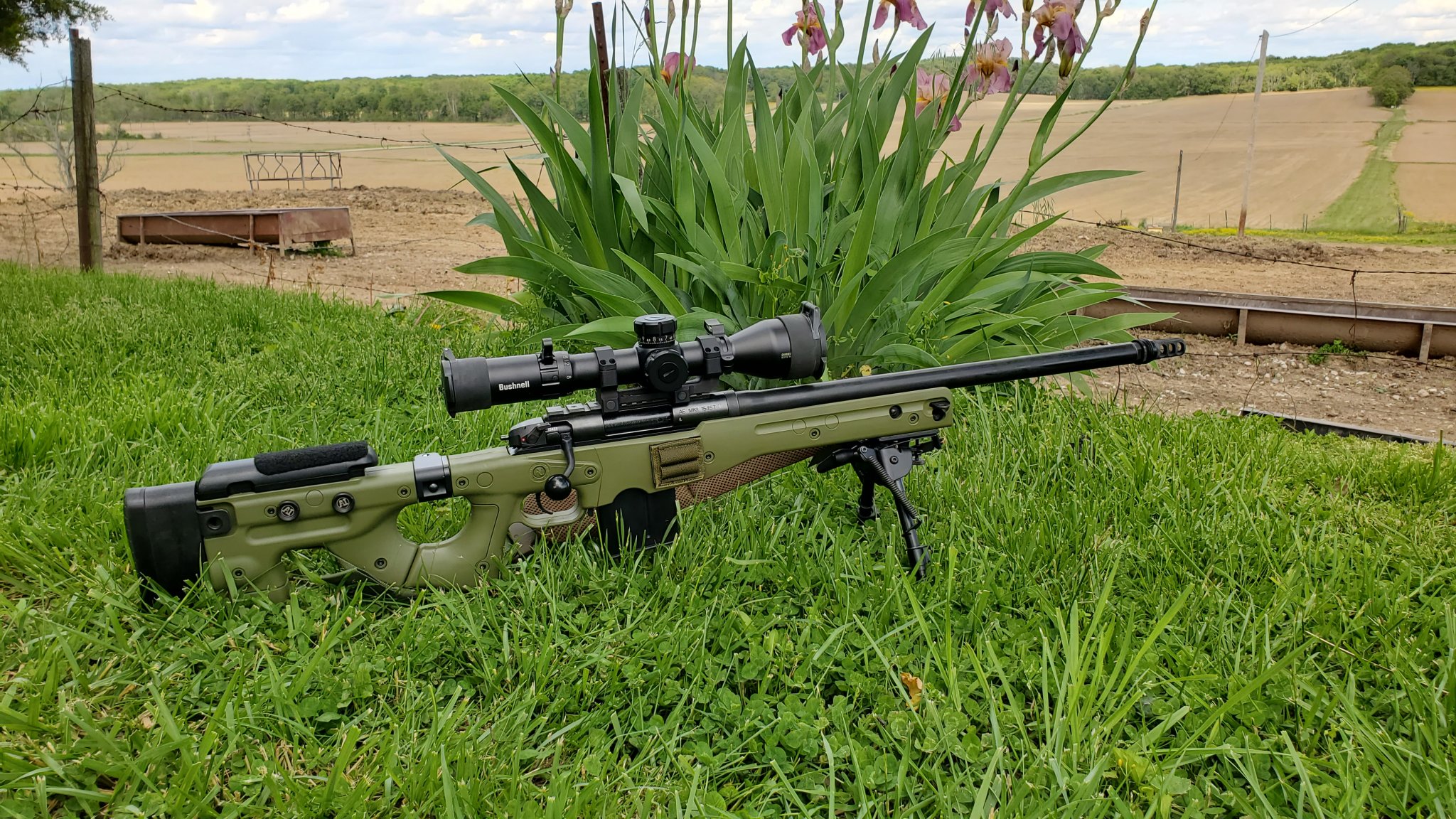

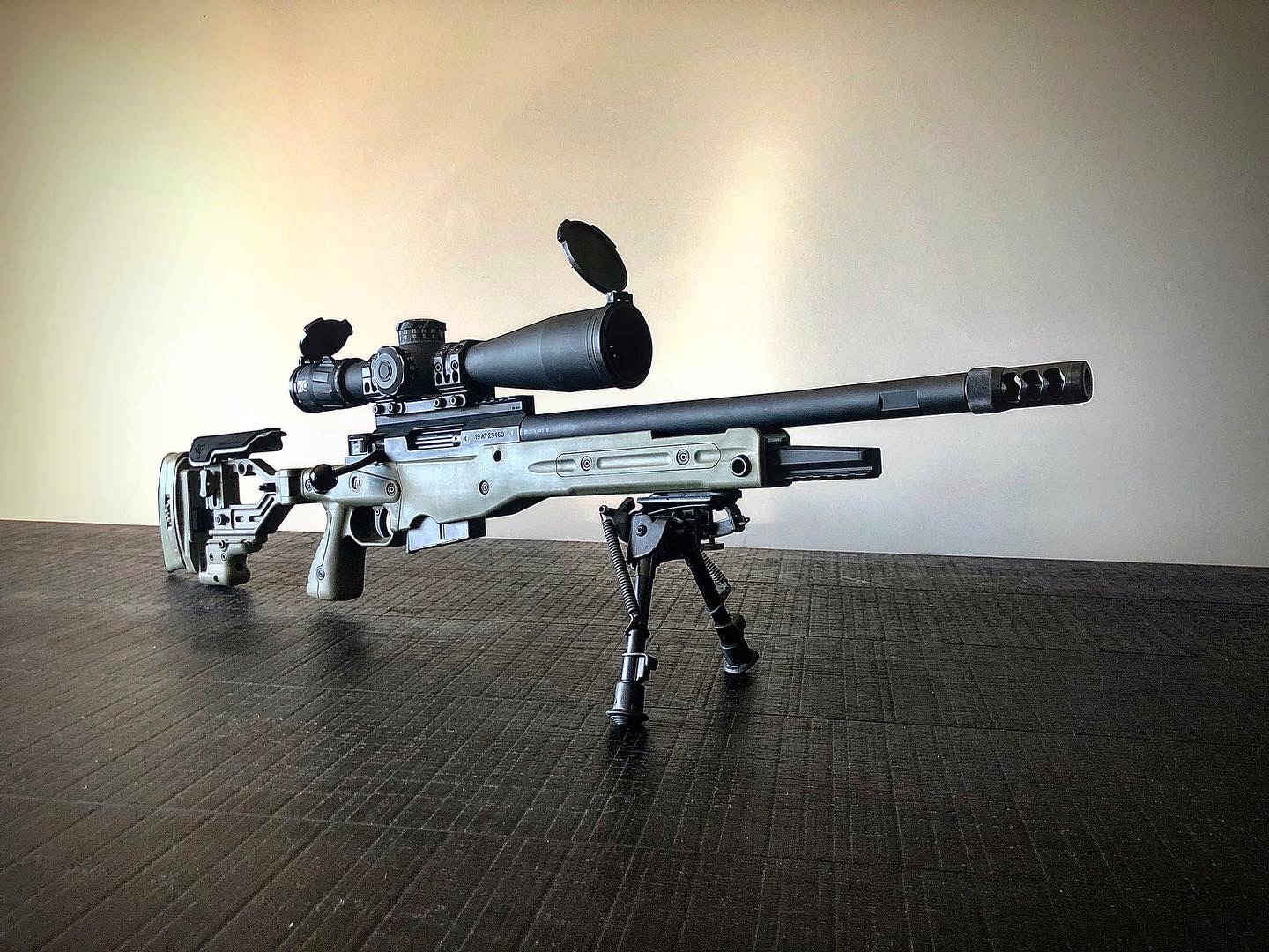

    Here is a pic of mine but with my Harris on the swivel mount that comes with the AT. I don’t have a good pic of the mount with my atlas on it.

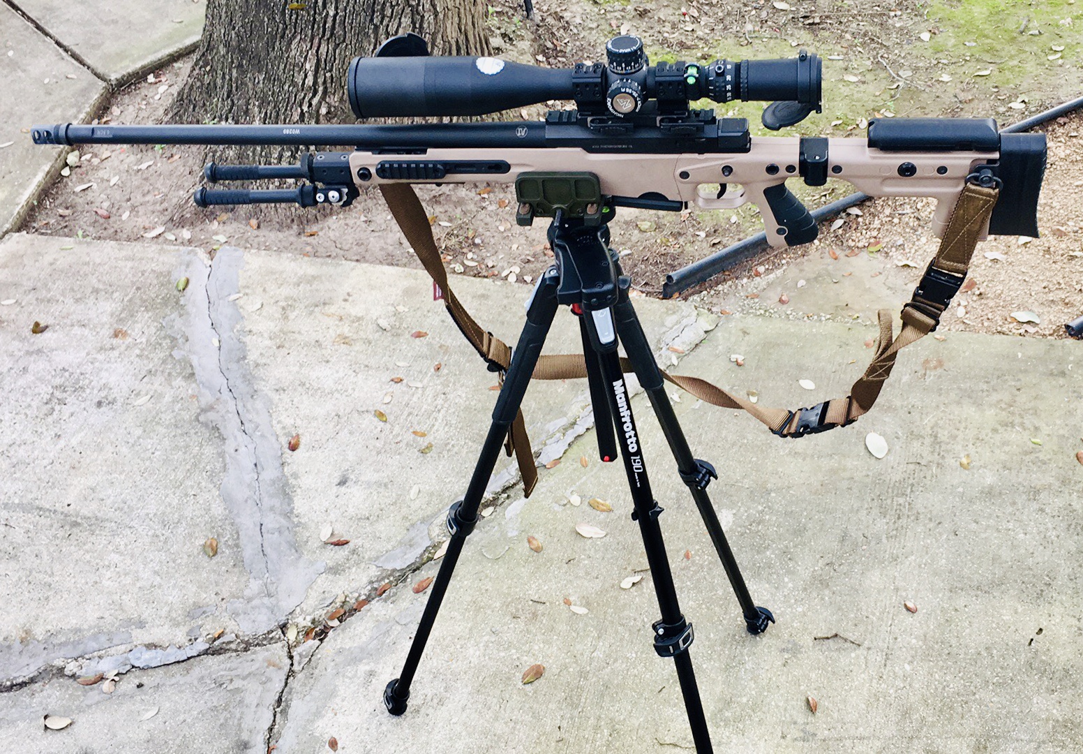

    Wha
    what type of tripod is that?

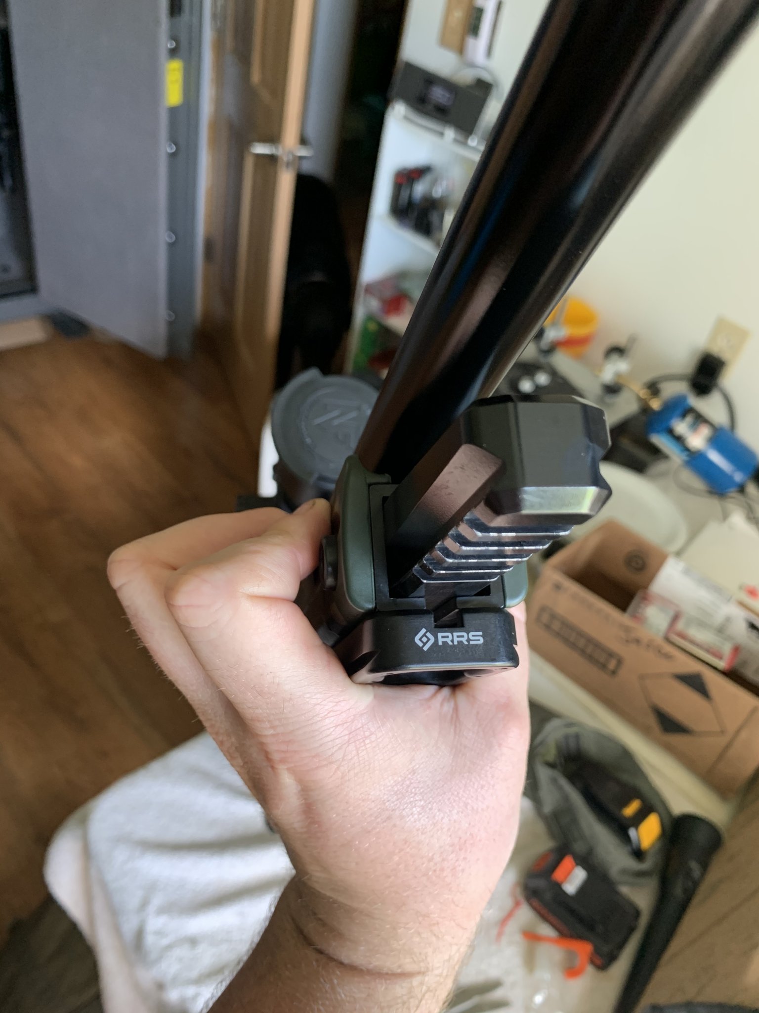

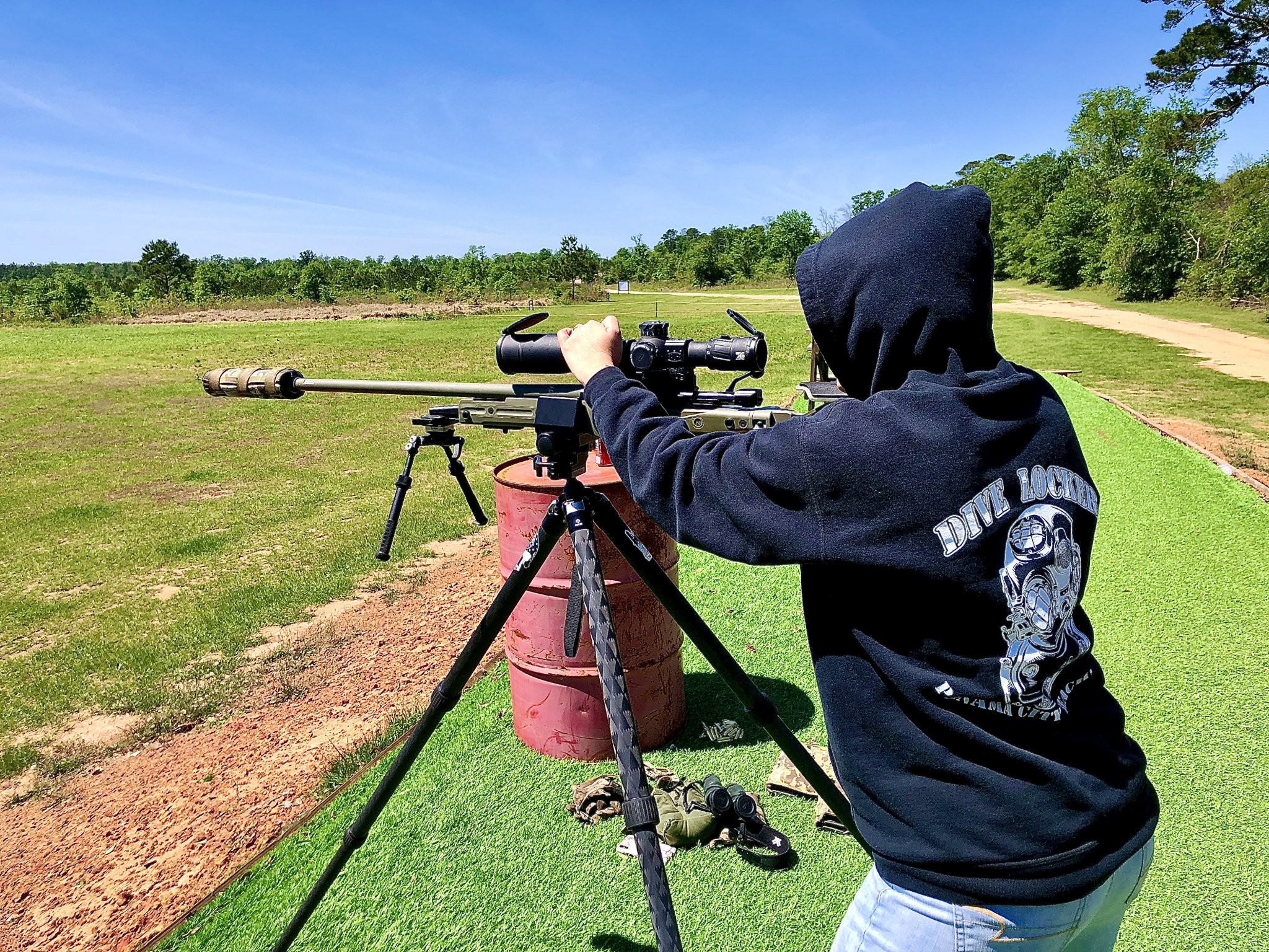

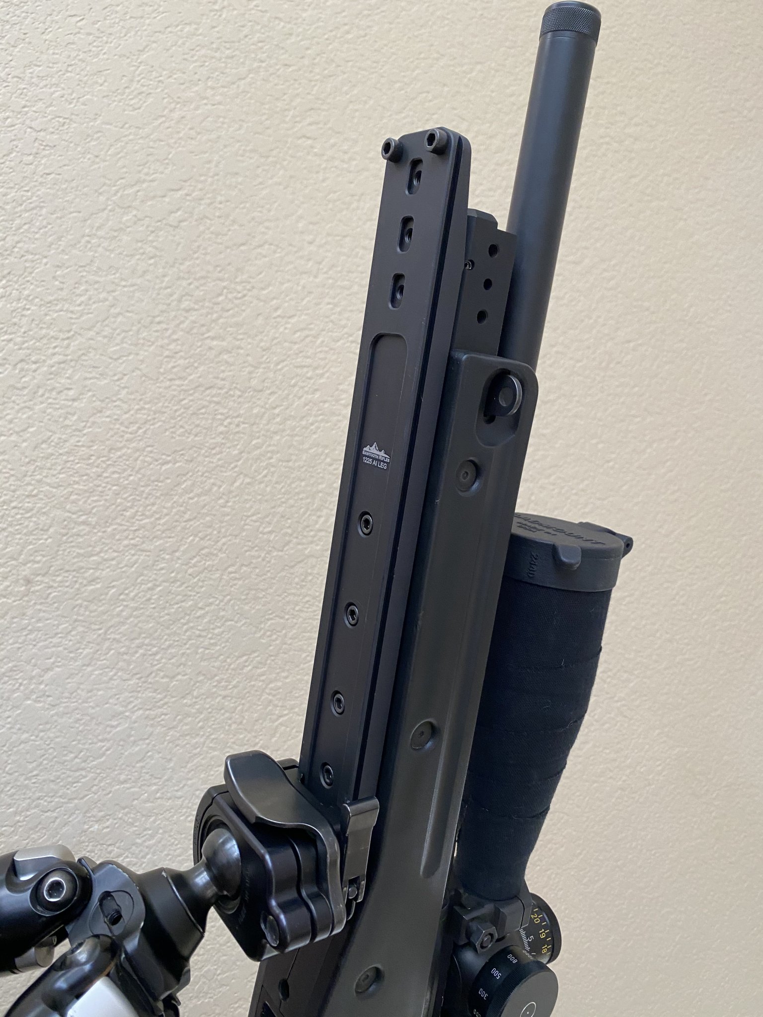

    These are the items below in the links from hog saddle. Works awesome. Very sturdy. I run the arca on most guns including the AI. Didn’t have on during this pic which is why it’s sitting in the pig saddle. The saddle works alright but it’s nicer just direct arca mounting. This setup isn’t as light as some of the carbon fiber models out there but I’m not moving much with it either. Have dropped several deer out to 500 yds from the sitting position with this setup. Really like it

    Outstanding setup! Mine is different but I want to get one for my dad so I’ll probably give him mine and look at your set up! Looks great!

    A tripod and ball head that I can actually justify...thanks!!!

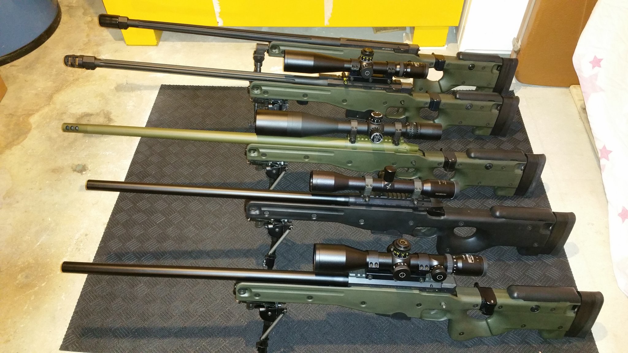

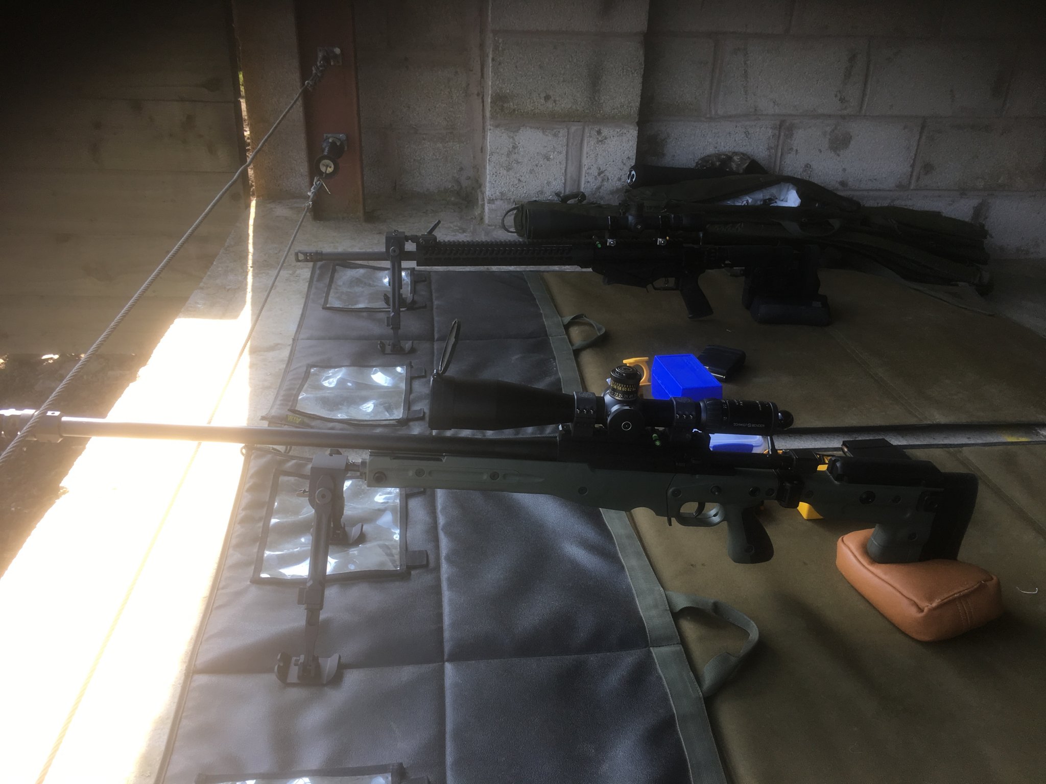

    You ask an importnat question. There are a great many AI shooters out there, some will be better shots than others. Some because they are better trained and are simply better shots. Some because they have balanced the harmonics of their rifle, ammunition and muzzle brake/moderator. I shot better, had more consistent groups and generally have myself a point and shoot rifle to 1000yds because I changed the Atlas bipod setup so many shooters use. It did not feel sturdy enough, the balled feet rolled on ranges, felt loose against the spigot and stock and I knew it was the one aspect of the setup that was not 'rock solid'. I shoot .30 and .260 through this rifle.
    I looked at 50CAL MG skid mounts and similar as they seemed 'very sturdy', but clearly overkill and too heavy. The original mounts on the L96A1 (Green Meanie) I was trained on had skid mounts; my mind drifted off Harris too, but there are many others. In the end I settled on this solid mount from Fortmeier. I have the Type B, I cannot fault it it is solidly built, no slack just clean tight german engineering. On ranges these mounts simply glide under recoil. My shooting is tighter, am more confident and get higher scores; I have only changed the bipod. As an experienced field, range and former operational shooter I would not recommend anything else. If cost is an issue, there is of course the obvious 'pay once, cry once' philosophy, but and more straightforward than even that. You've just spent $5-7k on an AI and scope....
    Hope that helps.

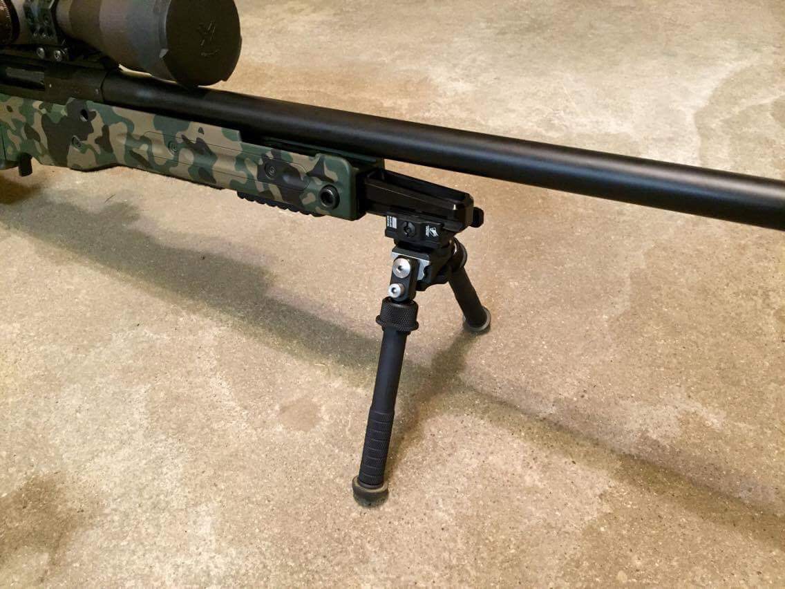

    BT72-NC super CAL Atlas Bipod
