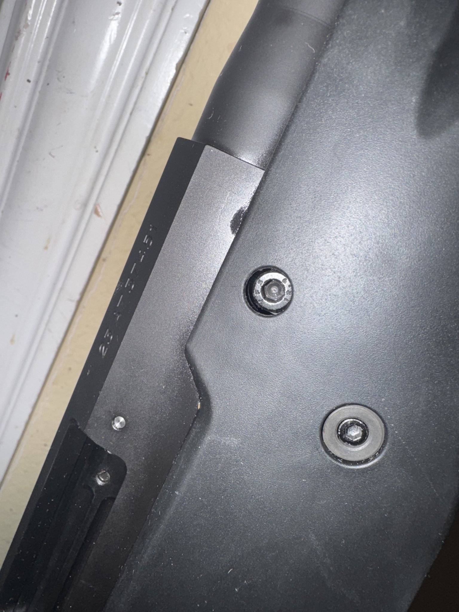

I have a used AIAT. I was attempting to change the barrel and it won’t come loose. The AT has the quick change barrel. I loosened the bolt a couple turns. No go. I put in my barrel vise. No go. Any advise?

It was probably just put on with some torque. If it has wrench flats near the muzzle,use those.
I agree with someone torqued the crap out of it. The barrel has wrench flats. No go. I put it in my barrel vise using my AW action wrench. No go. I’ll probably have to send it to Mile High. I just have a hard time understanding the major malfunction. Thank you.

I have never heard of this happening! Is this the first time you have tried to remove the barrel since you acquired the rifle?
Yes sir. I’ve only had the rifle about a week. I loosened the screw to change the barrel to a 6GT. No luck.
That is whacked. No disrespect meant, but you are loosening the correct screw, right?
Hopefully, the guy you bought it from didn't use any type of thread lock or cross-thread it.
Let us know how you make out

Use a barrel vise and your AW action wrench and give it a good "oomph." I wouldn't worry about hurting anything unless you exceed 150 ft-lb or so, or if it feels like threads are galled if/when the barrel pops free. Hopefully the thing didn't gall or drag a burr when the barrel was installed from lack of lubrication or poorly machined tenon threads.
The barrel torque spec on the AW/AE was 100 ft-lb. Sure the AT/AX actions have the H cut in the bottom of the action for the quicklock feature, but you can still reef a barrel on there pretty good.
I experimented with torquing the barrel on my AT to 50 and 75 ft-lb before tightening the quicklock screw to see if it made any difference in cold bore POI or group size if I smacked the barrel between shots, so I would not be worried about putting the barrel in a barrel vise and using your AW action wrench on it to try and pop it free.
Absolute worst case they may have to debond the action from the chassis so they can stick it in a lathe and cut a relief groove at the shoulder of the barrel... hopefully it doesn't come to that.

Great question. Mile High looked it over and couldn’t find any damage. I haven’t received the rifle back yet. I have a 6GT barrel waiting when she gets back.
It is crazy that the barrel was torqued on that tight. Mile High guessed 180ft lbs on a quick change barrel system. Buy a rifle, torque the shit out of the barrel, and then sale the rifle. I don’t know. 🤷🏼
