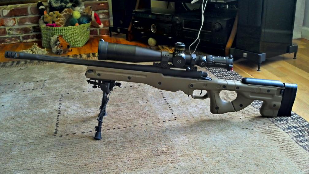

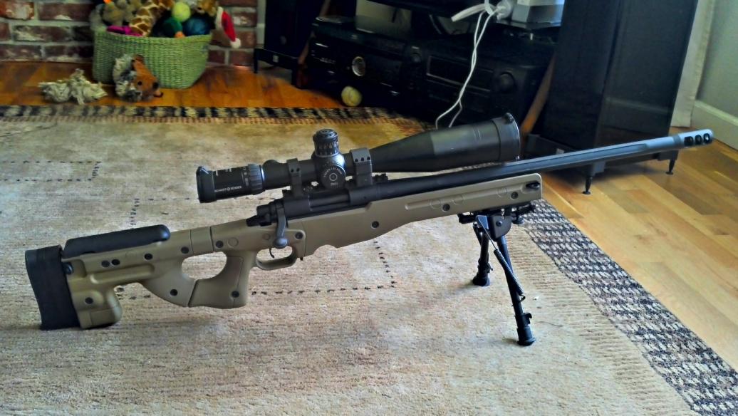

Got the stock in today. All mounted up and torqued properly. Now I've gotta wait till Monday for the Viperskins.
~Brett

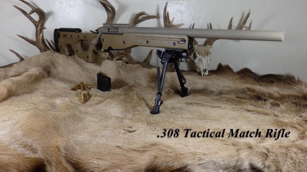

Nice looking gun you have there. Just got mine back from Phoenix Custom Rifles today as well. I don't want to hijack your thread so I'll do a write up on it in its own thread. I am looking forward to hearing how the AE skins work for you seeing how we have the same chassis.
Ok so we're both running 20" tubes. Very nice. I think I'd prefer a few extra inches (like maybe 4) but it makes it nice to have it short when I take off the brake and install the suppressor.

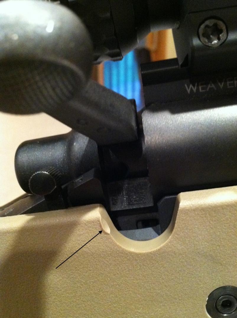

Ok Viper Skins are fully installed and I did about 200 dry fire routines on it to give it the same fair shake that I did the thumbhole AICS skins and the viper skins are going to stay.
So first off. I got the AE Viper Skins installed and found that they did allow me to close the bolt with a bit of damage to the plastic and I was able to pull the trigger and get the pin to fire. Just pressing the bolt hard into the skins gave about as much dent as was sent to me in the picture posted above. Even with this much dent in place the bolt still wasn't FULLY closing. I wanted it to have a very consistent closure point for accuracy and to have the lugs fully engaged for safety. So we took the Dremel to it. I let my wife do this one since she's a mechanical engineer and has spent many an hour sculpting plastic with a Dremel.
So first off we masked off the area to prevent dust from getting into the rifle. If you look close you can see the dent that the bolt made:
In order to get the bolt FULLY closed we had to take off quite a lot of material. Took us a good long time cause we kept taking off a little bit at a time. But in the end this is where we ended up:
This is right before she did her final clean up:
Then finally over view shots of the finished product with the TAB gear biathalon sling and the Accushot mono pod installed:
Hopefully some of this helps someone else. All in all the AI AE Viperskins are a really great feel! The pistol grip allows me to get back into position more quickly than the thumbhole. Perhaps they could approach the same amount of time with more practice but the Viperskins got faster quicker so I believe it just fits my ergonomics better. I found that I was able to get zero movement upon trigger break during dry fire with both platforms but its easier to get a perfect squeeze with the Viperskins. I also like that if you're really trying to get quick follow up shots on target that the thumb indentation works quite well. Rather than reaching your thumb around you can just bring it down into the dent and it gives you a good solid consistent grip for getting off quick follow up shots. Any little aids to help one maintain consistency is always appreciated.

Thanks for posting the pictures. That's quiet a lot of skins material that had to be removed, almost the same size as the old style skins with the square cut out. Not sure i like having to remove that much material to make it work.your skins are black as is the metal underneath so it's not as apparent but I think with another color skin it might be more apparent.Im going to have to think on this now.
I just talked to Michael Victor and he mentioned that the picture was just to show the bolt impact. It was my misunderstanding that that was the entire modification involved. However at the moment its on there and isn't looking too bad at all. I vastly prefer the ergonomics and feel of the new skins.
~Brett
I think what I'll end up doing is using the AI skins as a template to determine how much and where to trim back the viperskins so as not to remove too much material.
Yea you can do it by removing less material but I wanted to have the shape of the cut out look decent that was the only reason that we kept the shape consistent. I figured that some day these skins might go onto an AE and this way these skins will look fine either way. Plus you're right black on black makes it less of a sin.
