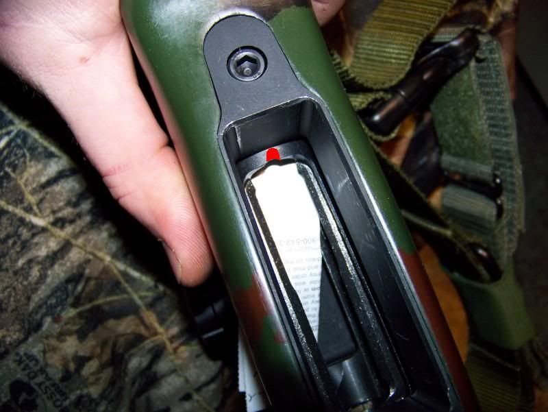

Here is my action's notch.

that is one very small notch! needs to look more like this
have your smith make the notck all the way to the wall of the bottom metal like in the pic above. Ans while you are at it, have him remove the spacer plate in front of the mag all together so you can sear those 162gr pills longer. The follower moving forward will not have any ill effects once the ramp is properly notched.

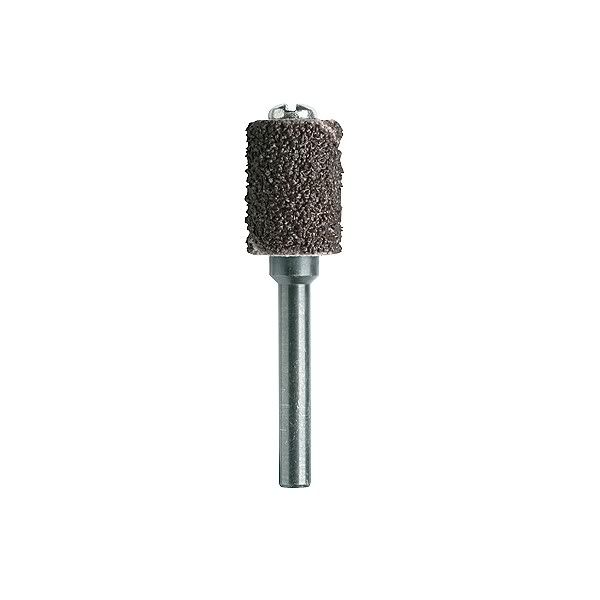

thats because the bottom of your action is round, so when it hits the pressure is making it move to the side. Notch it deeper, all the way to the front wall of the bottom metal and you will be good to go. You can do it with a Dremel and small sanding drum. Ive dont a few friends and mine that way and it worked out very well.
