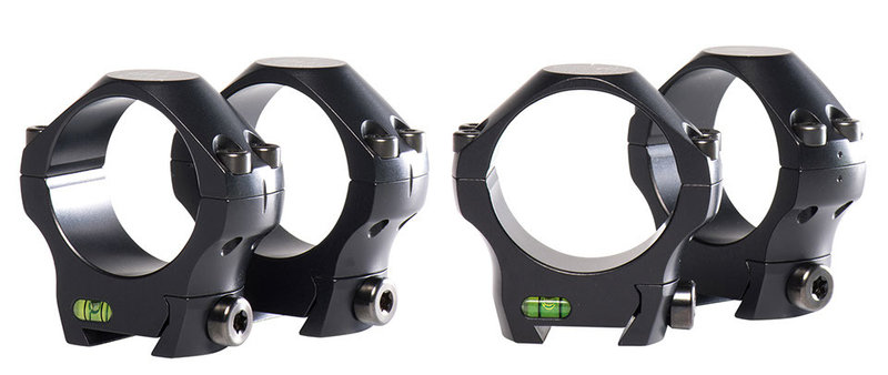

    Anyone know where to find good 1" rings for an air gun? Specifically a RWS 34. They should just put a picatinny rail or weaver rail on them instead of that goofy tiny rail.
    The RWS 34 has an 11mm dovetail. I purchased a set of these for my Weihrauch HW90 gas ram http://www.tier-one.eu/dovetail-rings.html Tier_One-Dovetail-1.jpg
    Not sure if you're willing to spend that much but, if so, the Tier One rings are very nicely made, I'd put the machining and finish on-par with the nicer US made pic rings (Seekins, et. al.) They aren't made with a recoil lug, no doubt for compatibility with rimfire dovetails, so I drilled and tapped the bottom of the rear ring for a 6-32 scope base screw which serves the purpose quite nicely on the HW90. 30mm and 34mm are the only options so you'd have to use a set of inserts if you have to have 1".
    The Tier One rings were the only high-quality ring option I could find for an 11mm dovetail mounting.
