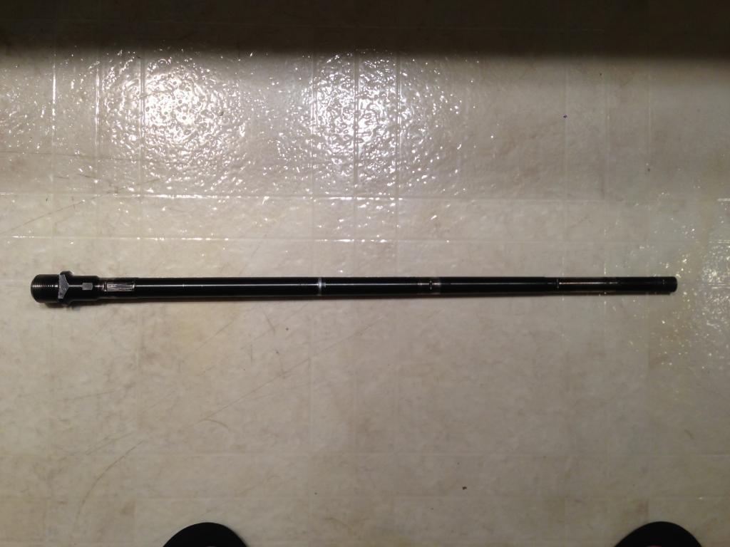

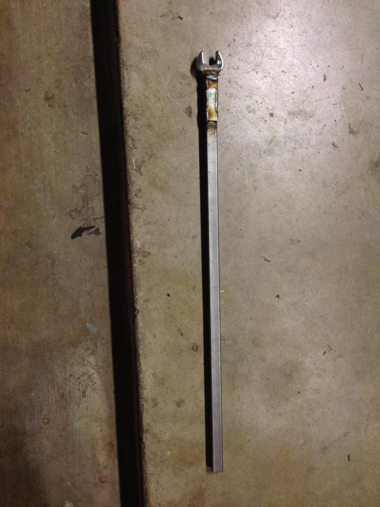

I disassembled my Yugo SKS myself using only hand tools (though I did weld a long handle onto a crowfoot wrench to remove the barrel from the receiver because it was the only wrench I could find in the right size at a reasonable price). I won't say it was easy or fast, but it's not really that difficult. I drifted the pins for all the barrel blocks (grenade launcher, front sight/bayo lug, gas, stock ferrule) and then one at a time, set the barrel in the vise with the jaws just loose enough to support the block but not grab the barrel. Then, using a small sledgehammer and a square copper rod to protect the muzzle, I whacked the crap out of the barrel until the block broke loose. After I removed all the blocks, I then clamped the square receiver in my vise and used my homemade barrel wrench to spin off the barrel. It would have been helpful had I scribed witness marks on the barrel and action so I could reinstall the barrel by simply lining up the marks, but I think I managed to get everything straight.
The Romanian AKs I've stripped had blocks that were a lot easier to remove than those of the Yugo SKS. Rear sight blocks on Hungarian AKs can be a bear.
Here's my stripped Yugo barrel:
And my barrel wrench. Should be 22mm for the Yugo:
