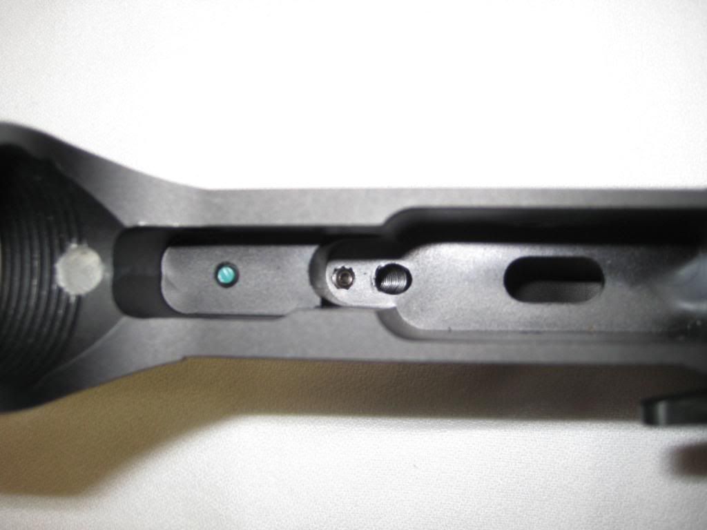

Also I noticed that my Seekins lower has some allen screws at the grip area that are for adjusting the "trigger reset"? I'm no gun smith but what benefit would I gain by
adjusting this? Any words of wisdom or advise on adjusting this safely?

Can you take a picture of the allen screw you speak of? I have not noticed anything like it in my Seekins lower.
Its under the grip, where the take down detent and spring go. There is a threaded hole with 2 small allen screws. you can see it from inside your lower behind the trigger. It will be at an angle. Its as if it applies pressure at the trigger unit and angles it slightly? Did that make any sense? I don't have mine with me right now for a photo but i'll see if i can't dig one up on the net right quick.

The Seekins lowers have a trigger reset adjustment screw (that won't likely be needed with your ALG trigger as they are FAR better than your average GI trigger in terms of how short the reset is). You can use it if you find that you need to shorten or otherwise adjust your trigger reset/overtravel or if you don't need it, you can remove the screws altogether. I don't have a good pic of my own from my Seekins builds, but here is a link that will show you some good pics:

Thanks for the link. I hadn't noticed the screws. Had a Geissele in there and putting an AR Gold in so don't think they will be needed but for a GI package I can see where they might be of help. That Glen thinks of everything LOL ;)
I finally got a Seekins lower to go with my upper and rail and up until I installed my lower parts I didn't realize he had built that option into his lowers either. I knew about the captured spring screws and not needing roll pins because he threaded holes and includes set screw pins etc. I have a Timney in mine, I still set the trigger screws per the included instructions. Just got it together and I have t shot it yet. Like Rob said, with a factory mil spec trigger it would make a big difference and has been a trick to improve those for a while. Just didn't know he included that into his lowers until recently.

I didn't have my Geissele in hand yet for my last lower build so I threw an extra parts-kit trigger I had laying around in the lower just to test it out (DPMS or RRA...can't recall which). The trigger reset adjustment screw is a DEFINITE plus for any basic, parts-kit type trigger. While the weight of pull still sucked royally and the overall pull was rough as hell...the trigger was noticeably improved for follow-through purposes. I have yet to need the adjustment screw with any Geissele trigger I've run in my lowers though (and with ALG being a part of Geissele, I can't imagine it'll be needed there either...same for the AR Gold triggers).
