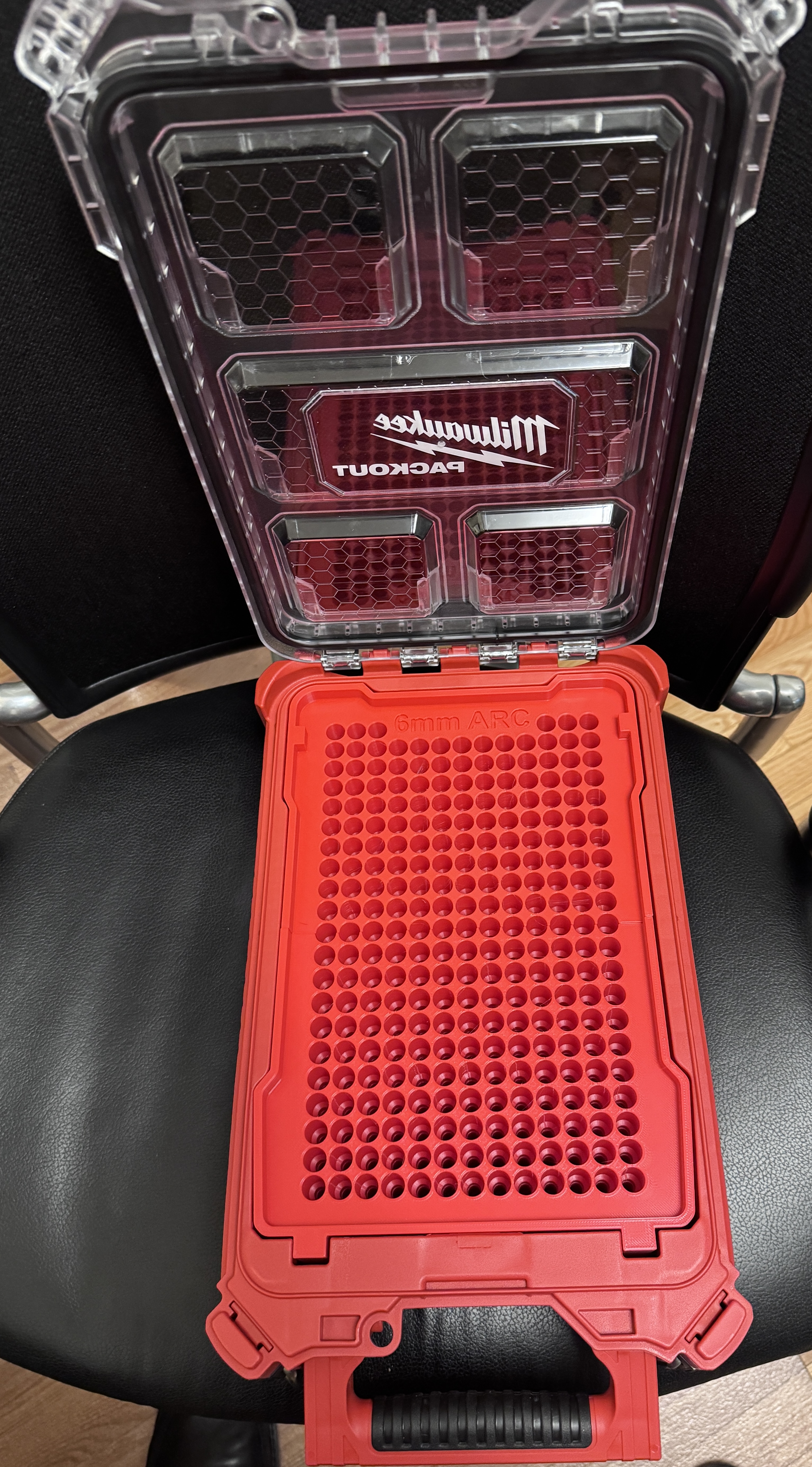

    Decided to find a way to transport my ammo in one container and we opted to screw around with a 3-D printer… got one of the other hide members to help me with the cad aspect of it…
    I’ve seen a few people playing around with Milwaukee packs… and then this thought occurred to me.

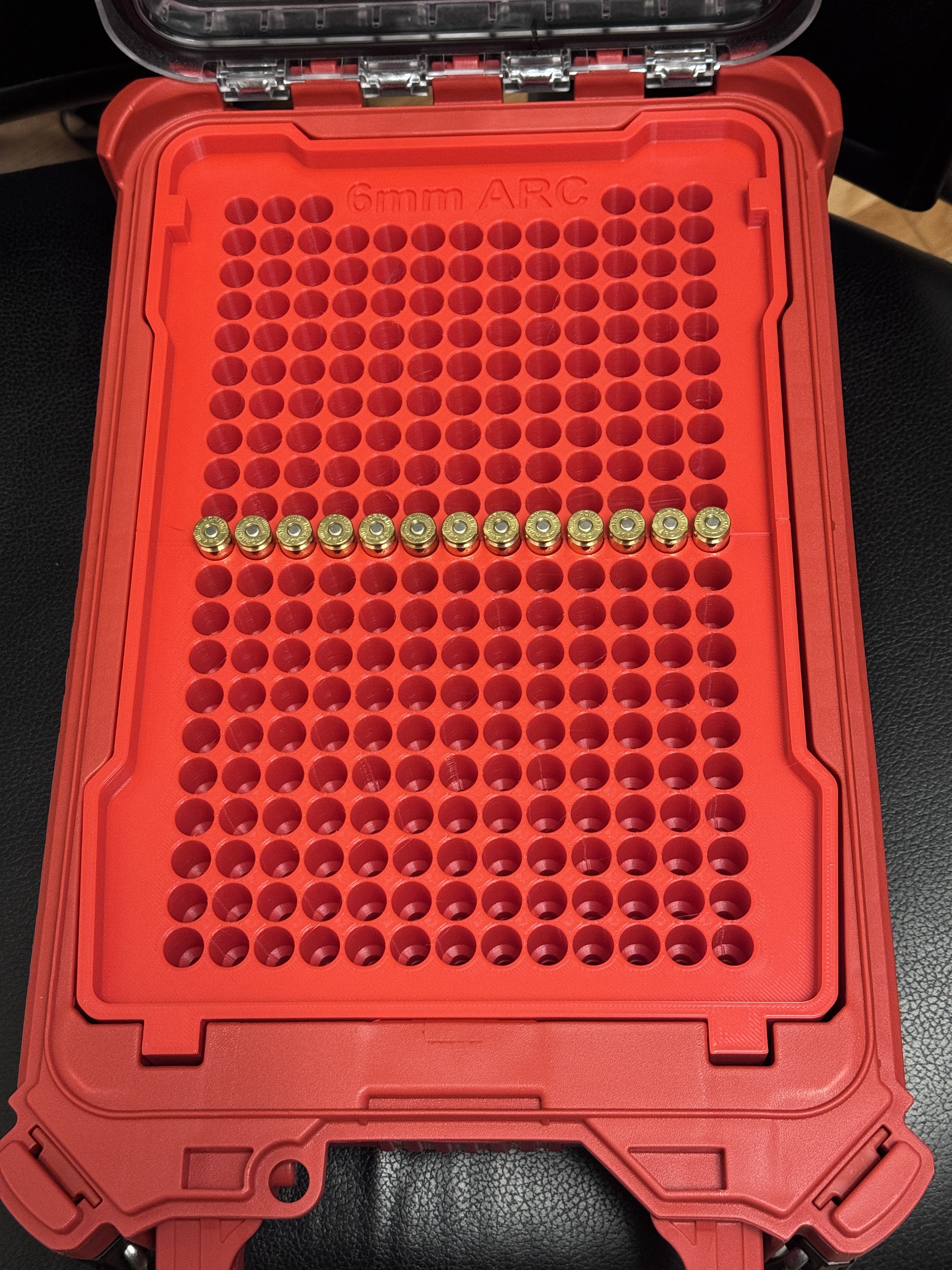

    I’m printing up the 6 Creedmoor now; surprisingly, it works flawlessly…
    View attachment 8692839View attachment 8692841
    Brilliant.
    That got to take a pile of filament. What kind of printer setup are you using & how long does it take to print something like this?
    If you feel like making a few extra I'd love a 6ARC, 223, 6.5C, 308. Any one or combination. Just let me know how much.

    I am happy to print them for whoever wants one…
    It requires two rolls of filament, and if you want to pay me for it, buy three rolls and send them to me. (Two of them are absolutely gonna be used to print your insert!)
    Right now, I have 308, 6GT, 6ARC, 6CM, and we’re working on 65 CM.

    So, not for everybody but....kind of cool that you can get over a case of ammo in them. Great for clinics and other high volume shooting and its easy to carry.
    I did find the Milwaukee case surprisingly sturdy and of good quality. Nice box.
