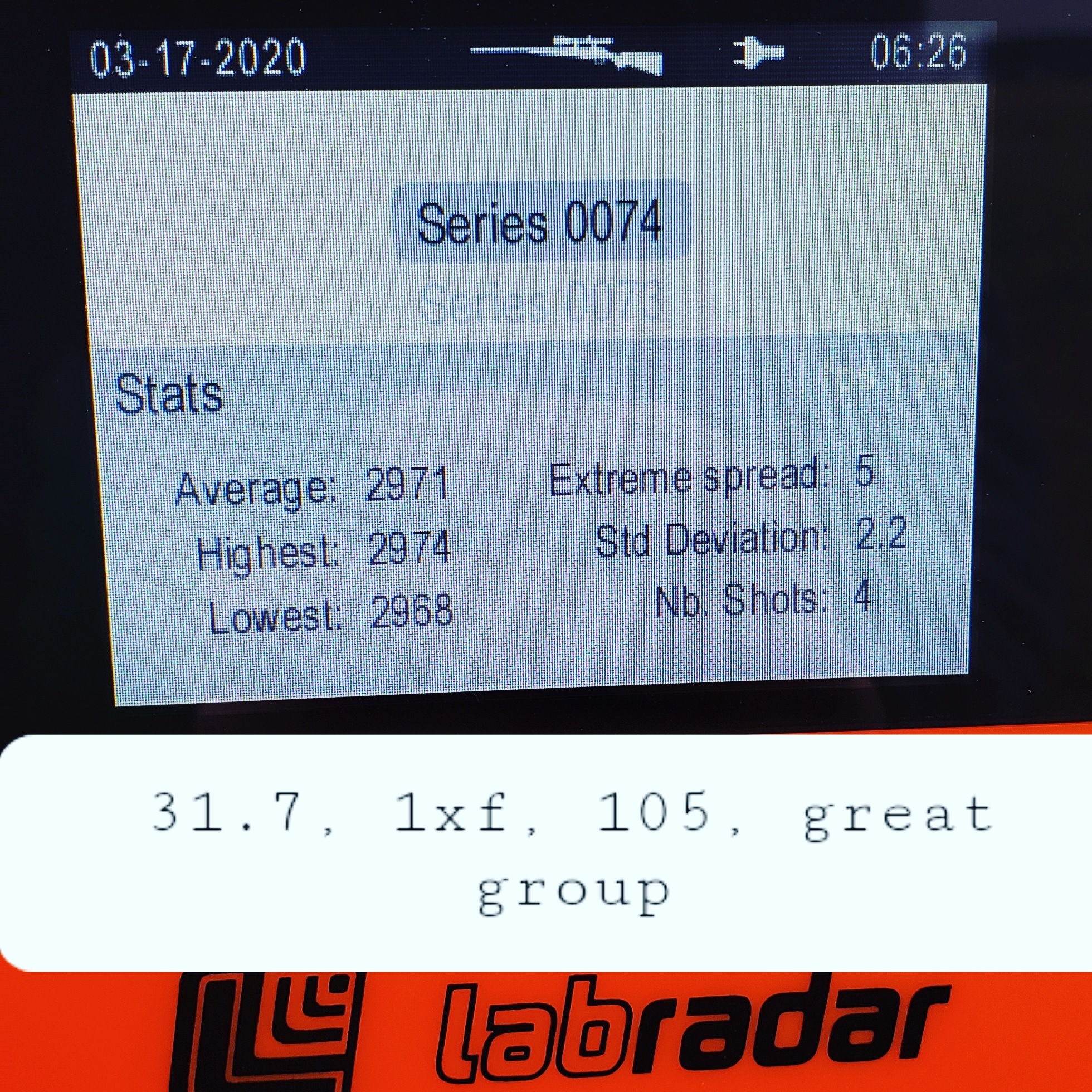

Ran some once fired today to figure out a load for a couple matches this weekend. Ended up with
105 hybrid jumped .015
32.5gr varget
450 primer
2971avg SD:2 ES: 5
Under .2moa for 5 shots. Other charges were in the .4moa or so.
Worth noting: on virgin brass I was getting about 2957 with 32.6 and 2949 with 32.5gr.
Not seeing any pressure signs and still using a .266 bushing. Gonna try a .267 after these next couple matches.
What did accy look like?
Gonna load more 32.5 the next couple days and confirm. I’m typically more in the .3-4 most days with good loads. This is probably a bit better than I can normally shoot.

This is 1xf brass, 27" barrel, 218 round down the pipe.
31.7g varget
105 hybrids
Cci450s
Shoulders bumped .003
.020 jump
2971 fps
Es 5
Sd 2.2
Where’d the 5th shot go?
It was the first shot of the session and the fucking LR didnt pick it up. Adjusted the distance away from it and it started picking it up. So, it only read 4 shots. Only had 5 loaded up at that charge weight. FML..
Reactions: Skunkworx
