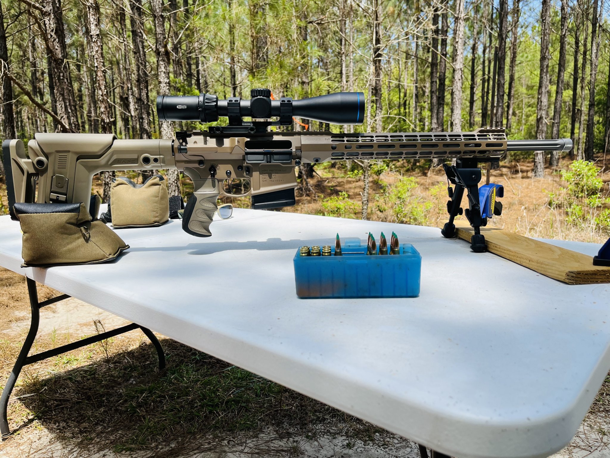

I went to build (armorer built it) my first AR in a 308 win for range and hunting with expectations of 1 MOA at 100 yds. But I’m only getting maybe 1.25-1.5 moa mostly, might will avg 1.25 moa.
I spec’d it out with the guy and had it built. In the beginning it was a nightmare hitting 2-3 MOA with a certain manufacturer’s barrel but they warrantied it and after trying two more we went another route and I had a Rainer UltraMatch Mod2 20” installed. Gun shoots better but still is not consistent. I know they are harder to shoot according to what folks say so I installed a Ultradyne Apollo S brake on it to see if it would help tame it down (not that recoil is bad at all), still the same. No worse, no better. This is with various Factory Match loads, it favors FGMM 168’s.
Hand loads I have used 125 NBT with TAC & XBR 8208, 168 & 178 eldm’s with varget & TAC.
With all of them after finding what it liked I would get .5-.7” 5 shot groups then load up some more to verify and it would shoot 1-1.5” sometimes 1.75” at 100 yards. Next group might go back sub MOA. Even with the FGMM.
Gun is
Aero upper and lower
Lapped receiver
Bedded barrel extension
Aero Atlas S one handguard
Rainer Ultramatch mod 2 20” barrel
Seekins Adjustable gas block
Elf Match Pro lock trigger
FAB Raps butt stock
BA nitride BCG
Midwest 20 moa mount
Optika 6 scope
I did try another proven scope as well to make sure I didn’t get a bad scope. Same thing. Gun wants to shoot but then goes a little wild and just has me about to pull my hair out.
So my question, are they able to shoot an honest consistent sub MOA or are folks just cherry picking there groups they share with there AR 308’s like I could do with this one and I am probably getting about all I can without having craddock or someone spin me a barrel?

Is your rest/bench setup always the same? I just noticed that folding table in your one pic and if that’s what you’re shooting off of, that’s far from ideal.
No, that was just the only picture I had of my rifle. And yes, those tables are not stable at all. Usually out of my truck window when testing loads. Sounds worse from the truck window but I’m a southpaw, so I can rest my rifles wedged in the mirror, solid as a rock.

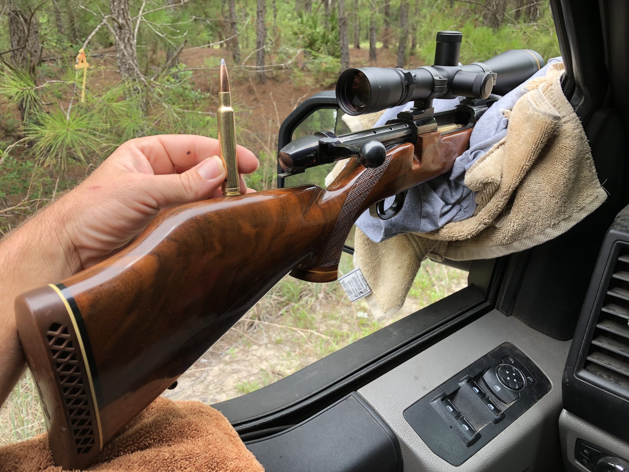

To add the pictures that didn’t post, the ammo I used was originally on it. I just didn’t point that out being polite. Haha.
I don’t shoot as much as I use to, but I can shoot as good or better from my truck as I ever could prone. I won several LR matches prone (10-12 years ago when I played in it) but that was bolt guns. So I’ll give it a shot. The table, yes that’s a crap shooting prop.
Try using some front end control, you can shoot a bolt gun with it resting on a pod or rest with your non trigger hand under the rear but I've found gas guns shoot better with the other hand out on the forearm pulling back and down to minimize muzzle rise.
Second thing is the locktime is much slower than a Rem 700 so you must use good trigger follow through.
I'll second not shooting off a truck, wind blows truck moves.
Gun is
Lapped receiver
FAB Raps butt stock
BA nitride BCG
Optika 6 scope
Pictures for reference of what it has done.View attachment 7892997View attachment 7892999View attachment 7893001View attachment 7893002View attachment 7893003
