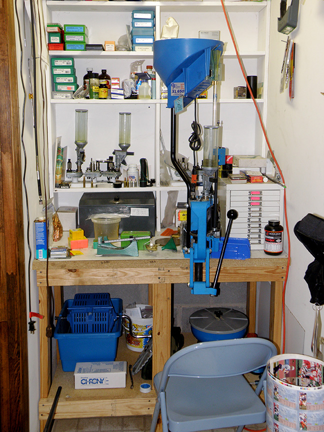

    In 1970 after I was discharged from the Navy a friend taught me and talked me into getting A RCBS turret press like his and used it until 1993 when I bought a Dillon XL-650 with all the goodies which I still use. I reload my .223s with CCI BR4 primers with 69 gr Sierra MKs and Varget. I will probably be using the Varget for many years to come because back about 2 years ago I could only find 8 pound jugs of it. So I have plenty.

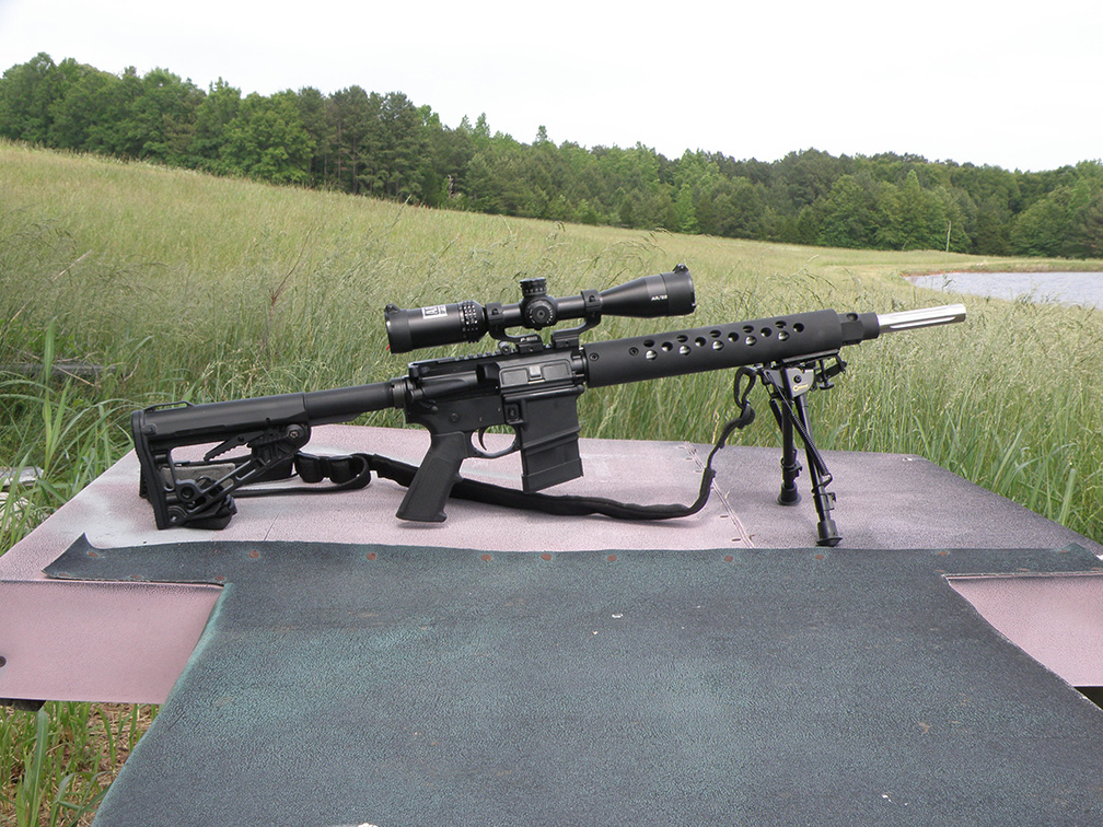

    This was with my new 18" WOA varmint upper with 1 in 7" twist that is full length fluted to save some weight. It is on top of a Colt LE 6920 M4 lower which I installed a Geissele SSA-E trigger.
    I think I got a shooter. If you want tight groups reloading is the way to go.
    PS: The scope is a Bushnell AR/223 with 4.5-18x40mm zoom with Nikon P-SERIES split rings that are a little low for my liking. I may change them for Vortex 1" that measure 1.5" from top of rail to center of the scope tube. This will give me a perfect cheek weld.
