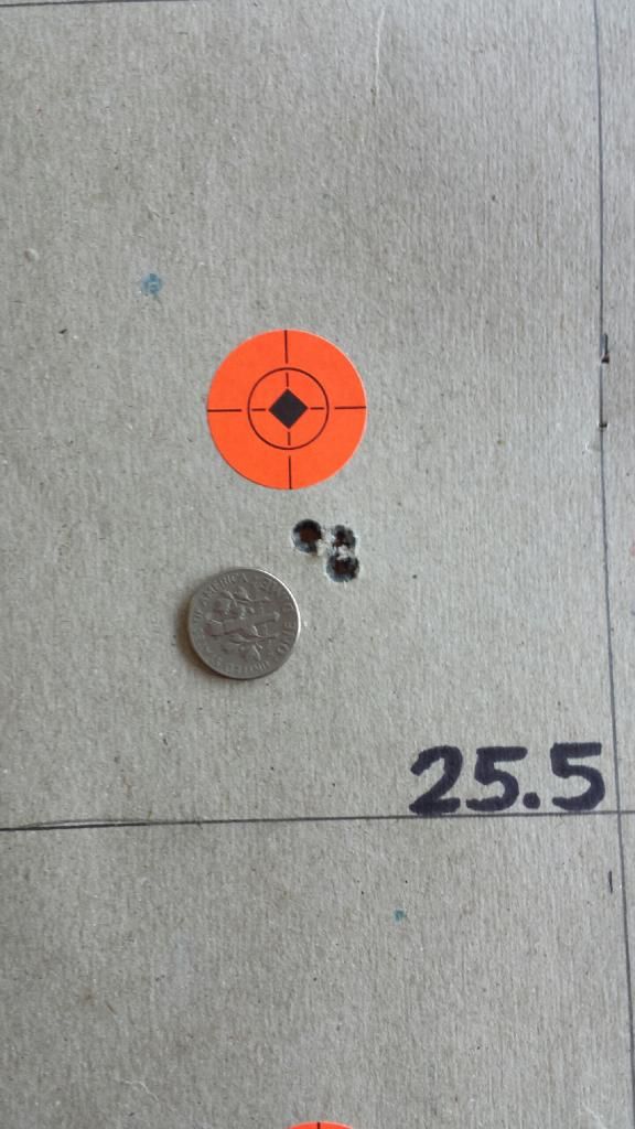

    Spent some time this weekend coming up with a load for my HCS m12 mod1 upper. Wasn't too hopeful when I was getting 3" groups with most factory match loads (black hills not tried) until I shot a few groups about the same as this.
    Average group was 0.440" (pictured) at 100yrds with the below load.
    LC brass
    25.5g 2000MR
    CCI primers
    77smk
    2.25" COAL
    One of my favorite rifles to shoot now. Just need a chrono to see what she comes in at.
    Sorry if this isn't surprising....I was impressed though.

    I did a round Robin ladder at 200yrds in .5 grain increments. Took the upper node rounds and branched a few loads out by .1 grain at a time and did 3 round Robin groups at 100yrds with the above as the result.
    Gained a bit more confidence in my findings the round Robin methods.
