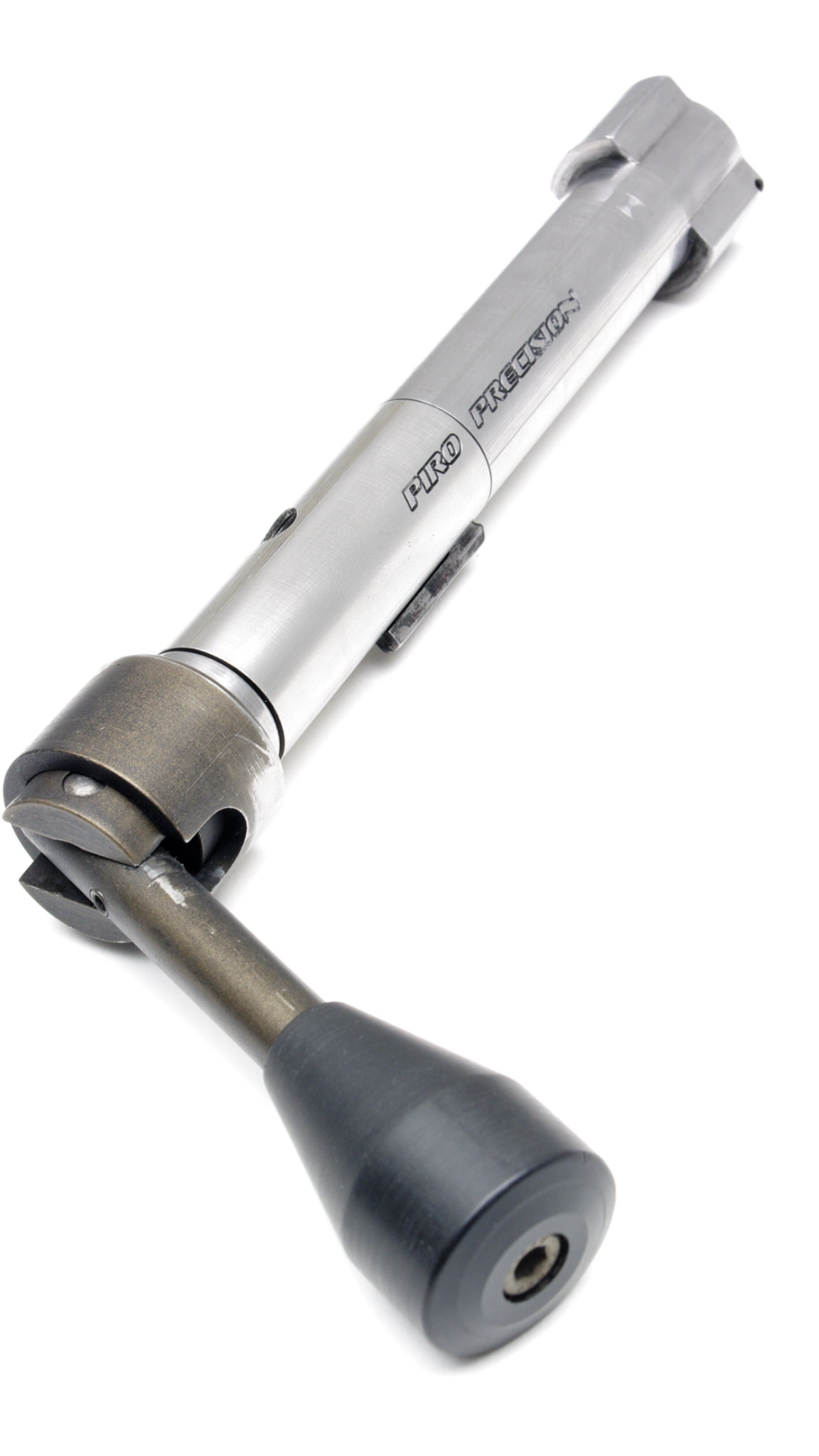

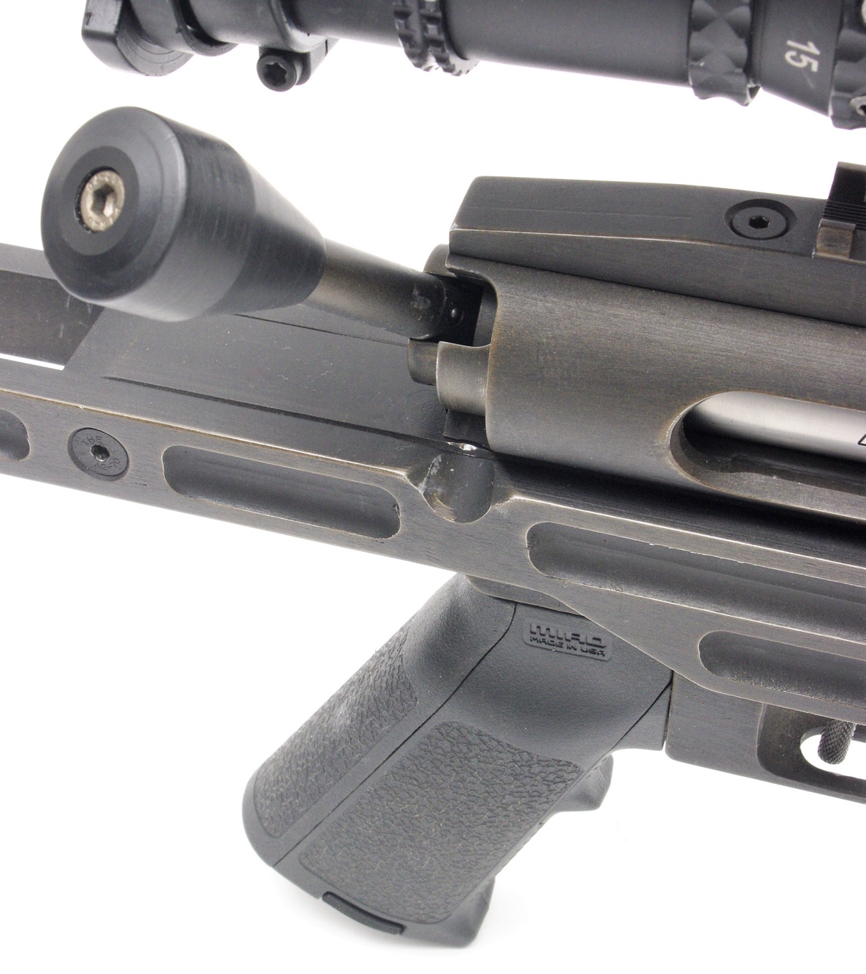

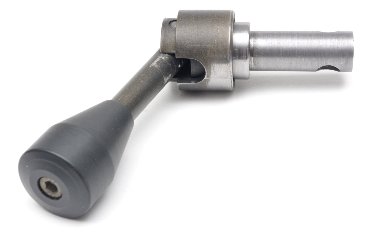

Good job on this design Ted! I hope that there is no infringement issues with Teds design and the design from the Ascalon Rifle. It supposedly has a patent pending. It uses a very similar method:
http://soldiersystems.net/2018/11/2...tion-system-from-dutch-gunsmith-pim-de-waard/
https://www.dutchlongarms.com/the-ascalon/the-details
View attachment 7008763View attachment 7008765View attachment 7008764View attachment 7008766
and that's where i remember seeing this concept before
Reactions: BlueVFRank
