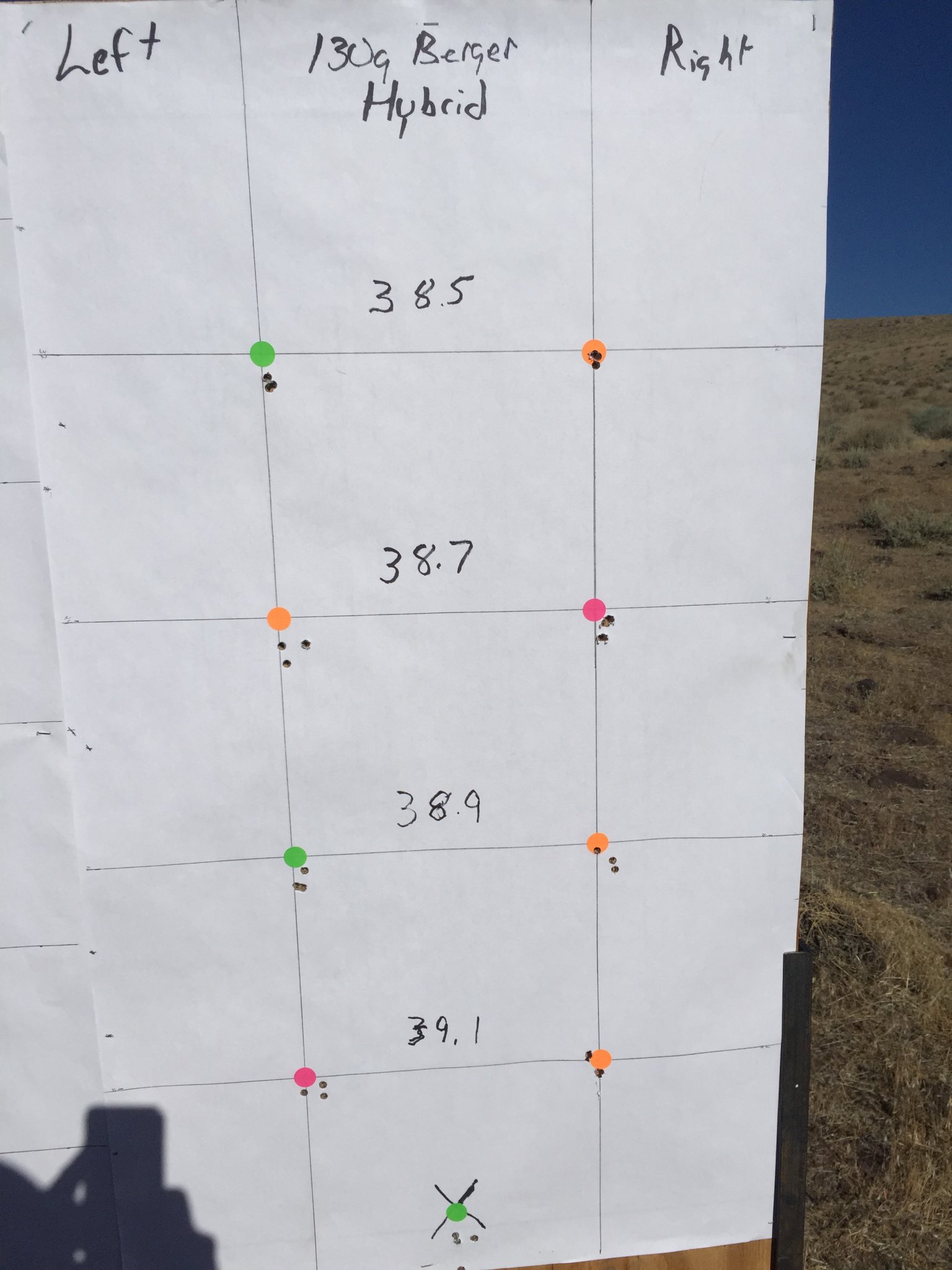

    i have only had this happen a few of times...ive learned over the years that if a load shoots good one day but not the next the problem is usually me not the load or like when i first started reloading i would assume a load was good if it shot good at 100yds.
    the other thing for me is i am not a group shooter so personally i do not shoot 5 or 10 or 20 shot groups anymore....i load 26 rounds for load development 6 rounds of each charge weight i plan to shoot ,start with a clean barrel,shoot 2 rounds to foul then start,i shoot 3 rounds at 4 separate dots on the left for a total of 12 rounds starting with the lowest charge up to the highest...wait 5 minutes then repeat on the right side but start with the highest charge and work to the lowest.
    when done i pick the 2 best groups with the lowest SDs load up 6 each and shoot them at 500yds best 6 shot group wins...and the best part is i live about 10mins from where i shoot/practice so i can get all this done in a mater of a few hours....i feel for the guys that have to make long drives to the range....this is not my load development idea i just added my ideas to it and ive been using it for years...simple and it works...
    http://www.texasprc.club/preidloaddev/
