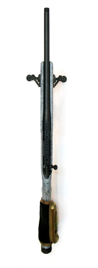

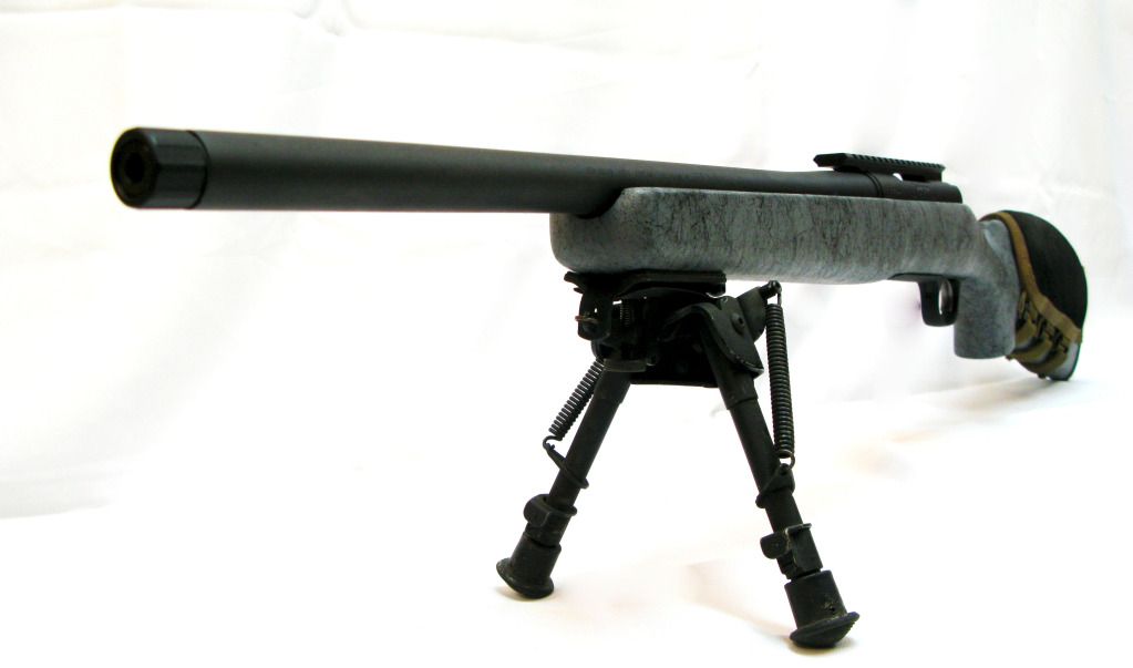

    Phase 1 complete!
    The B&C M40 stock came in so I dropped the barreled action in and torqued it down.
    This is the last time the rifle will look like this though, it's going to GAP today to get inletted for a DBM and a bolt knob. Till next time!

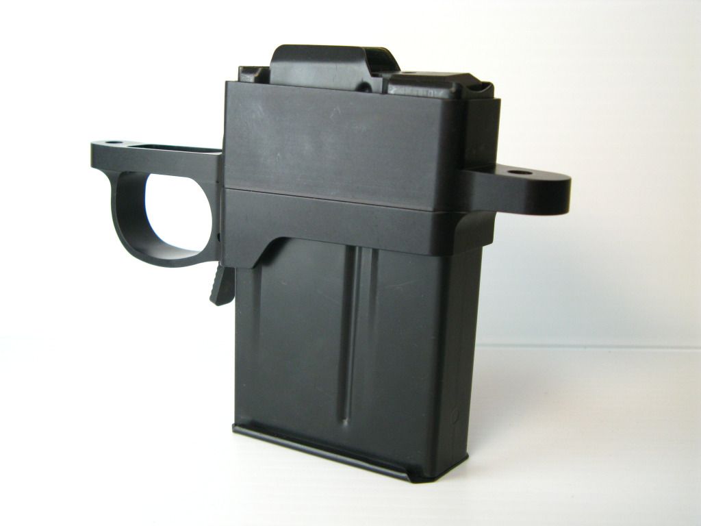

    I thought I'd post some updates to my "budget" assembliage of parts into a precision rifle that I didn't build.
    The new PTG DBM assembly came in and so far I'm pretty impressed with it in both quality and the price...a great value IMO.
    The new trigger also arrived today, not that I can do much with it since the bolt is still at GAP but I do love the old style triggers.

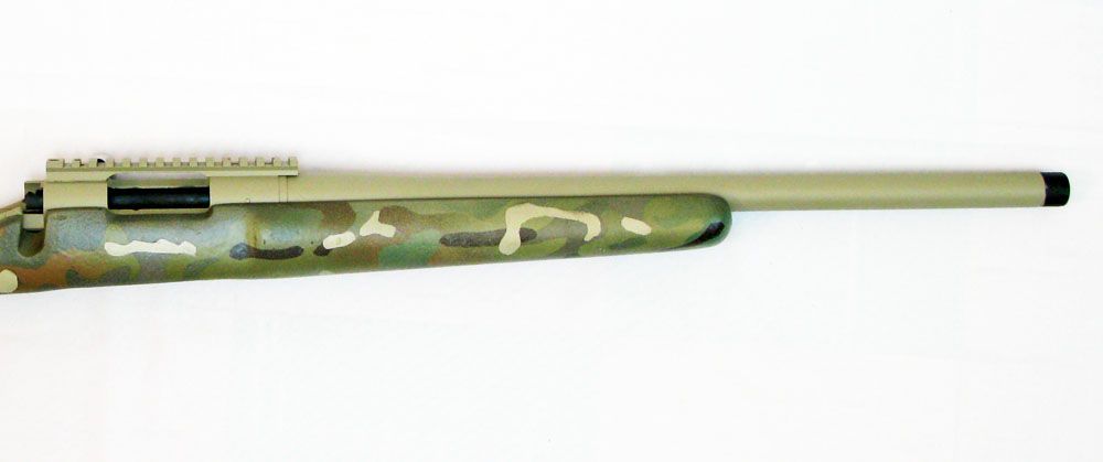

    Since I really wasn't a fan of the gray stock I've been practicing doing a multicam-like pattern on my bitch stock so that I don't totally screw up the B&C. After a few practice sessions I think I've got it down which colors to do in what order, I just have to make some adjustments with the stencils.
    In the end it will look something like this...
    I plan on painting the optic to match the barreled action so it should all look pretty good. I'm not using anything special or extravagant, just krylon and rustoleum from the hardware store. Pretty much everything is here that will complete Phase 2 except for the stock and bolt.

    Ok, I got the stock and bolt back from GAP this week and it was just too tempting to leave it all in pieces while I got ready to paint everything. The barreled action and DBM were going to be khaki but I changed my mind to go with OD so I stripped everything back down..ahh the joy of rattle can finishes. I still have to cut the template out for the multicam and tape everything up but hopefully by this weekend I'll be wrapping this project up.
    As near as I can tell the inletting was perfect for the DBM, feeding has been excellent with snap caps from both AICS and Alpha Mags. The bolt handle was equally as well done and I consider any money spent at GA Precision to be money well spent.

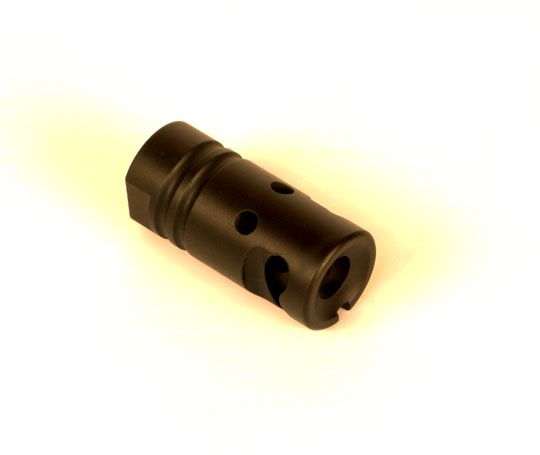

    I'm using shims from PWS to pad out the thread protector a bit so it's not flush with the muzzle. The shims will also help me time the Daniel Defense muzzle brake that will be going on the gun eventually. I'd looked at a couple of sub-$100 brakes but I liked the looks of it so it'll be interesting to see how effective it is as a compact, single chamber design. The dimensions on this little guy are about .860" in diameter and just under two inches in length.
