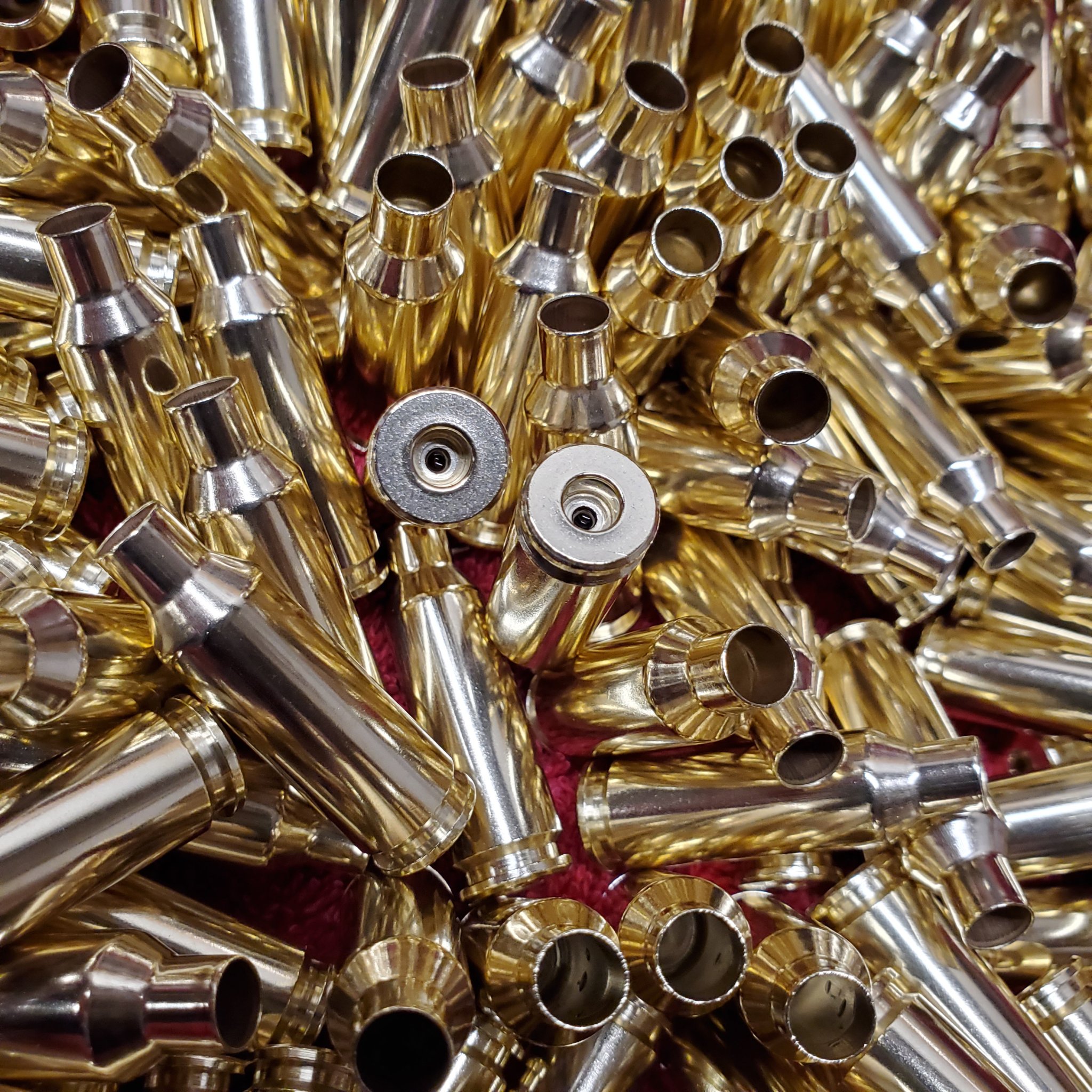

Brass cases being a bit different, I use a heat sink, caliber specific, in a lathe turning at low speed, apply map gas, a few seconds, to the neck shoulder, a slight dull color of red /pink starts on neck, pull with leather glove insert new case with non gloved hand and repeat.
Form lots of cases this way, works for me, and you can definitely tell when heavy case forming takes place. Made 250 6 ARC cases from Starline grendel basic straight wall cases.
Tumble them and ya have no head stamp super bright 250 pcs of 6mm ARC cases, when none are available.
Or 900 .510 Whisper cases when none are available. Or hybrid cases in 308, 6.5 CM,
8.6 Blackout, 358 Win. Etc. Plus 338 RCM made from 6.5 PRC, 35 Rem from 308, to 401 and 351 WSL, and 350 Rem mag. Plus a bunch of others most all required annealing....but no special equipment needed... I already have the lathe, but one could use a drill motor to turn the case.
But you can buy whatever ya want to anneal... or not... they're your cases, but it ain't rocket science.

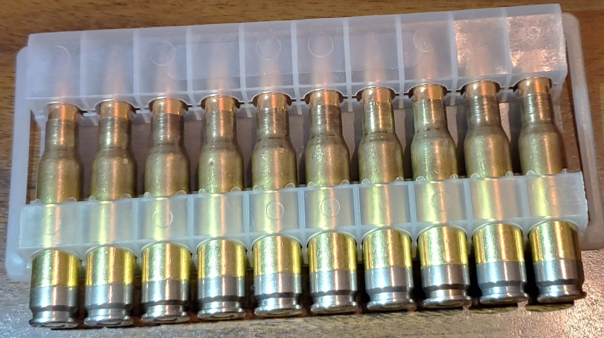

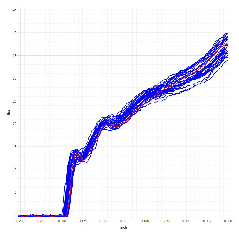

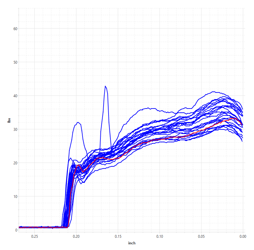

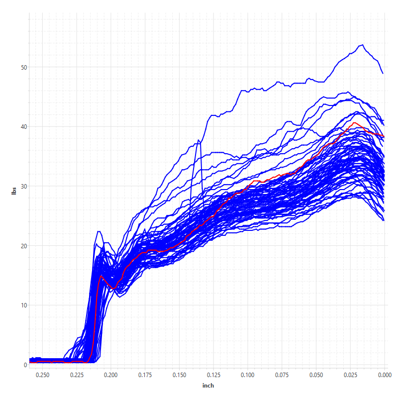

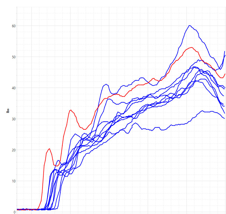

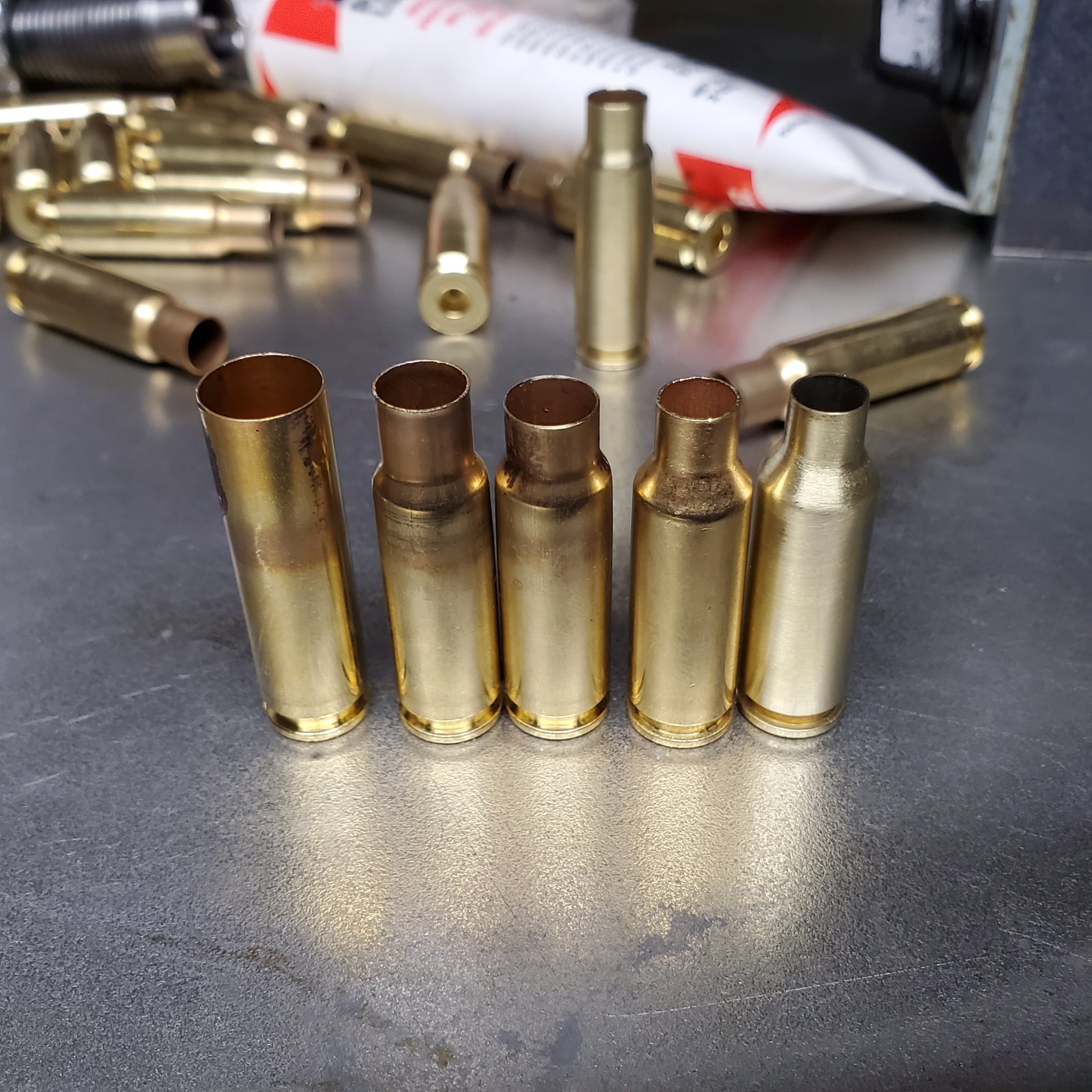

Just tried my first batch of brass with my induction heater and looking for opinions. First off the brass hasn’t been cleaned so that’s why the neck is black but do you guys see anything that looks like I over annealed them? I attempted to stop the instant I saw glowing. I sacrificed a few pieces doing the plier test but can’t tell any difference. Just looking for opinions for safety sake because I really like the gun im shooting them through View attachment 8560134View attachment 8560136
First principles:
YOU CANNOT GUAGE ANNEALING BY BRASS COLOR
Choose a different metric

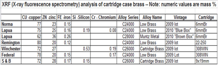

Not all (raw material) cartridge brass is from the same sources, and various specifications can be made that might include various allowable amounts of trace contaminates.
Those various raw material sources are not common to all brands, and can result in big differences in those color layers and their thicknesses.
By and large, those colors are not harmful but the main point I am trying to convey is that they are also not standardized between brands of brass due to the differences in composition, allowable contaminates, and process methods. Try to avoid getting to wrapped up on the colors between different brands.

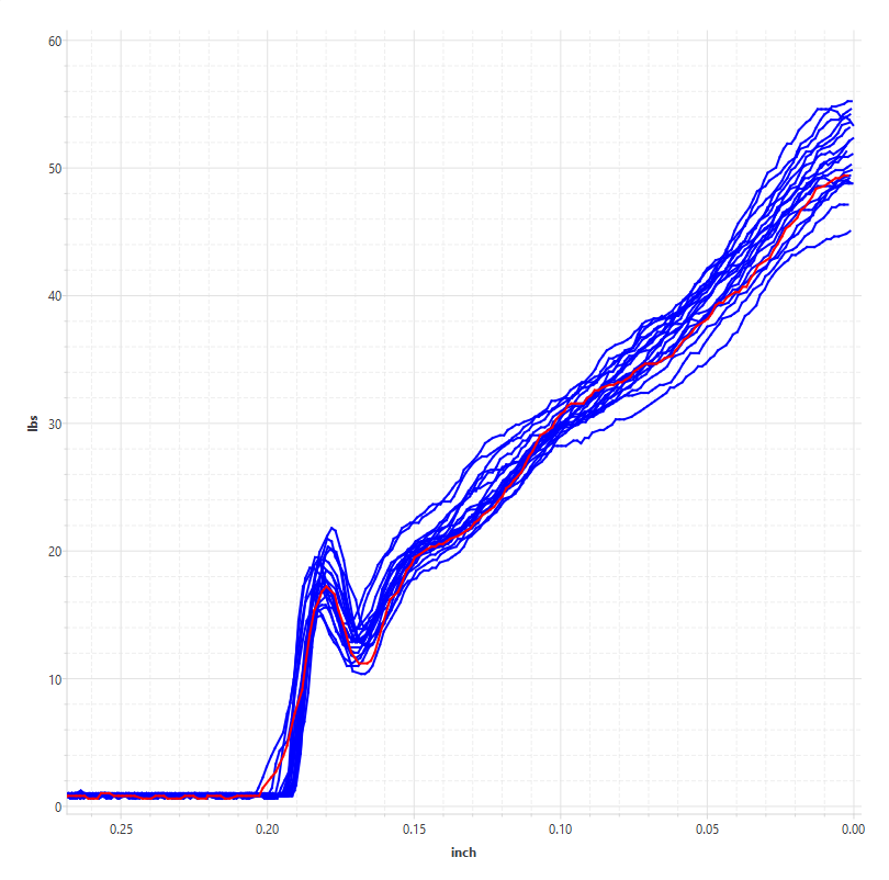

We only use the micro hardness as a proxy. The properties we are really interested in achieving with the heat treat are correlated to that hardness range, so we use the neck hardness instead because the direct measurements of those much more important values are not practical to measure on thin wall cartridge necks. Carry on.

I've heard nonsense stating every company uses a different % of zinc or copper . Bullshit ,cartridge brass is almost 100% universally accepted as C26000 Cartridge Brass .
IF one is a large enough consumer ,additional alloys can be requested as some of those vary but again mainly due to regional copper and zinc mining facility's or the smelting facility itself . That equates to possible impurities .
Normal ratios appear below ,other trace elements can also be present such a silicon aka Si and aluminum Al .

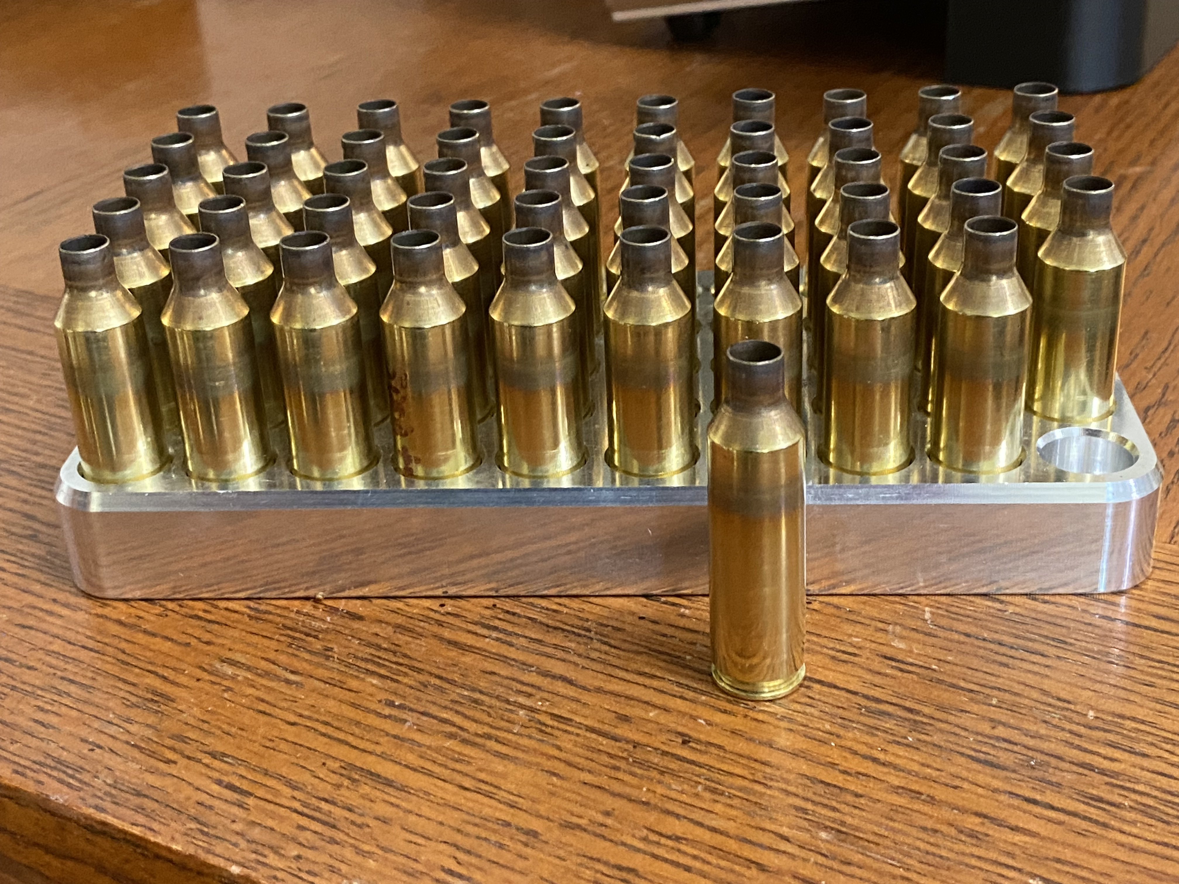

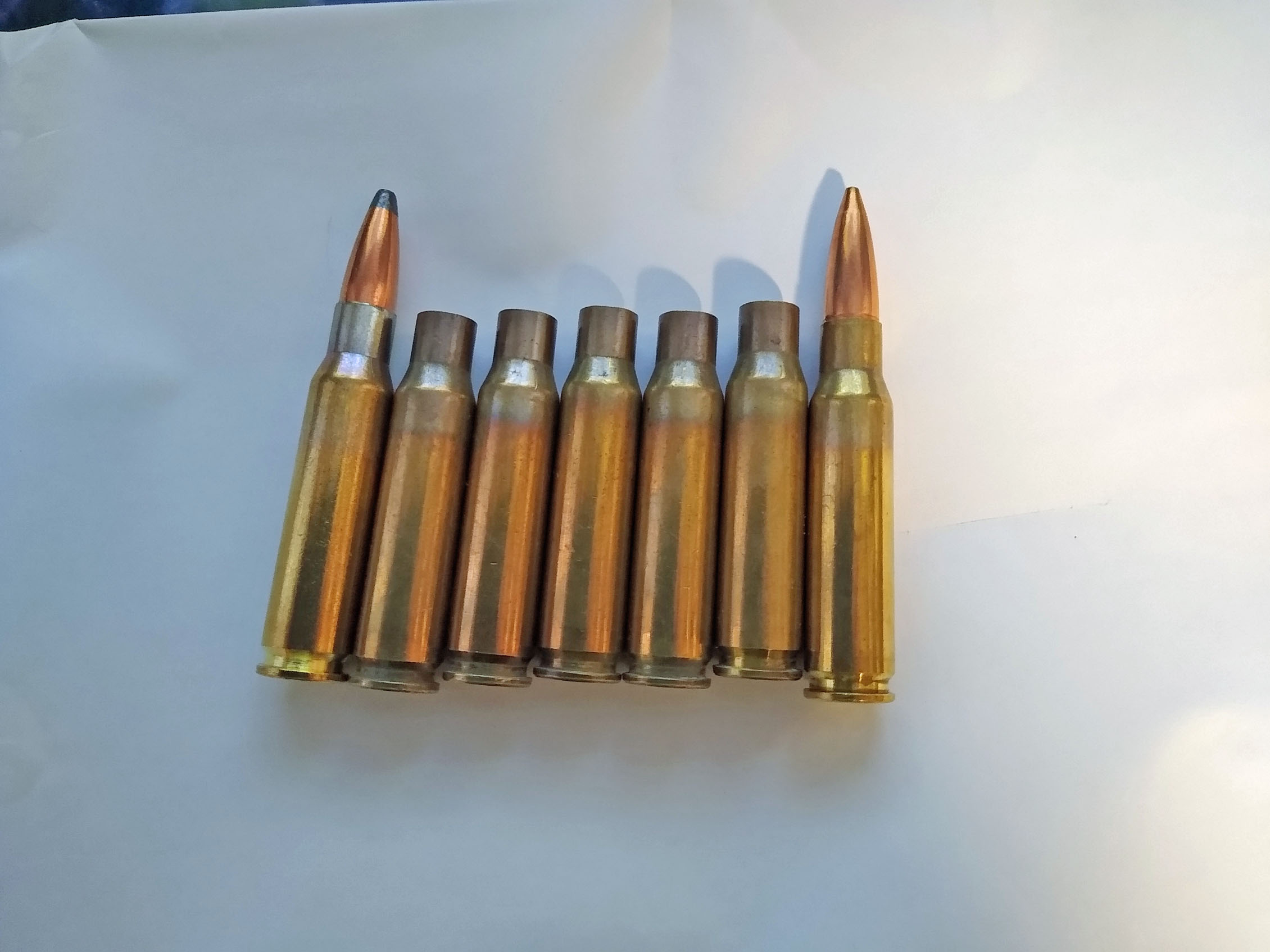

Rather than dealing with all the molten salt crap I just went for simple... 8 seconds chucked in a drill (with an adapter for the brass) in a propane torch flame, the color comes out looking just like LC brass.

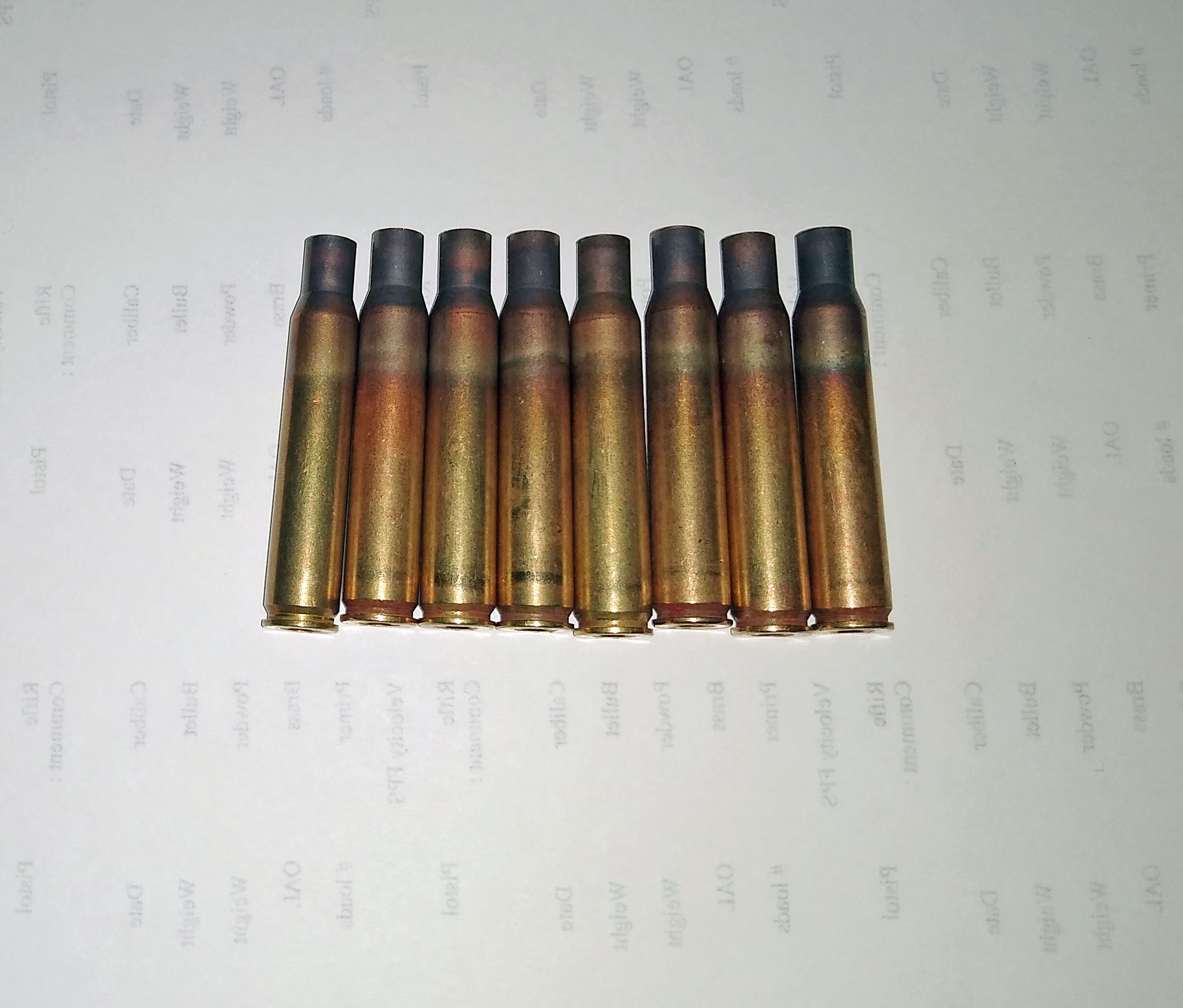

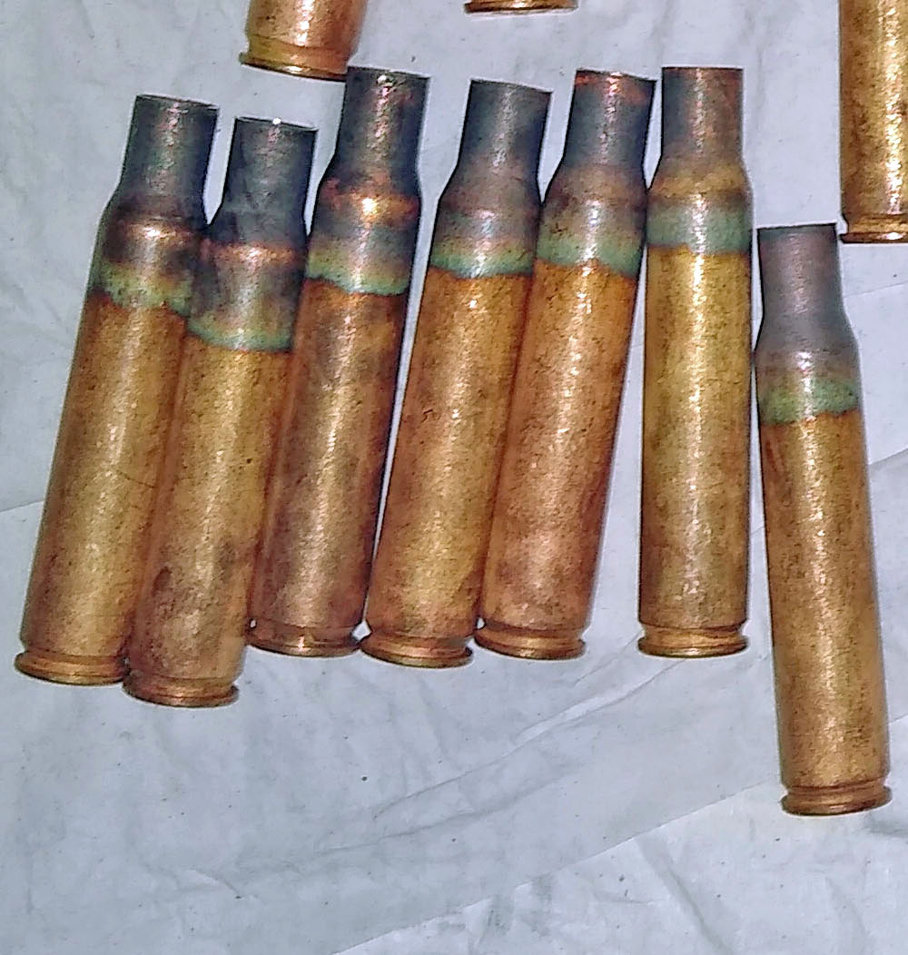

ALL CASES Partial annealed 1275-1350 Deg. F. color under flame just going red and they drop out . Neck and top of shoulders are Fully ductile ,bases of case Never exceeds 220 Deg. F. .
Cases left partial annealed and unpolished . Second set of cases polished near Identical to one Factory Lapua round as were witness mark . Third set of cases partial polish after partial anneal . Fourth set of cases Raw cleaned and partial annealed . I later polished those vary cases along with #47 more . All those are 1942-43 M2 .30 Cal. cases ,which have withstood #50 firings each and ALL reloads were within 1.0 gr. Maximum loading for M1 Garand . Partial annealed after every 4 Th. firing . Never lost a single case or had a torn rim and that's saying plenty out of an 83 year old Battle horse . I did cut two of the original cases ,so as to accurately measure brass case wall for stretch and any evidence of case head separation . ALL GOOD ,I predict another #10 firings minimum and to be on the safe side will fire individually ,so as to prevent Opt Rod fuk up and save MY face just in case :)
Final word ; IF none of you are seeing any discoloration when partial annealing your brass , YOU'RE DOING IT WRONG . FACT Brass discolors when heated to ductility stage and that's what it's about !.

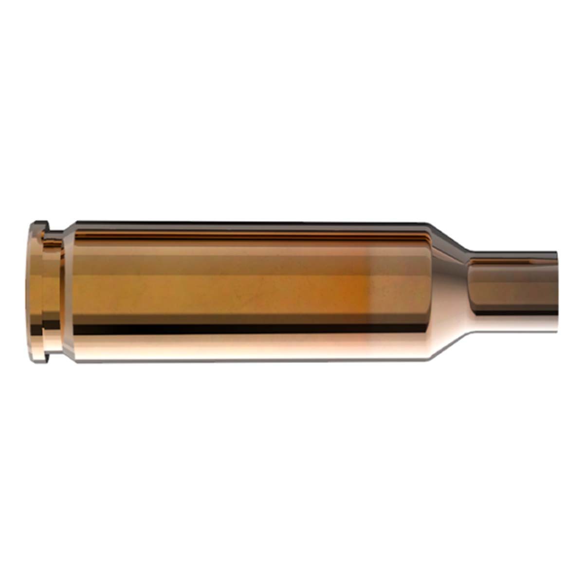

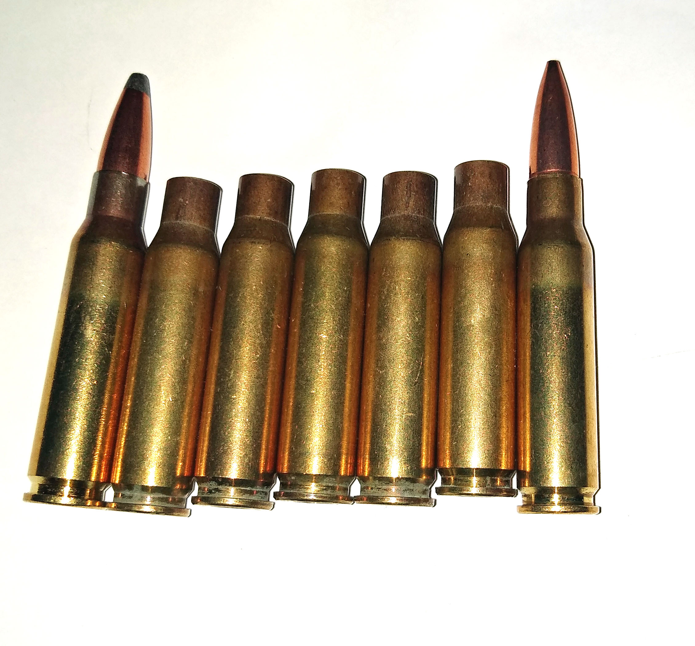

You're right about what manufacturers do to the cases, either the polish away the evidence of annealing or purposefully leaving some color as evidence the the annealing (like Lapua does).
It's not hard to get rid of the "color change" after annealing. Like when I annealed some 277 Fury cases in prep for necking them up to .308's. Here's a pic of 10 cases that weren't cleaned after annealing that I loaded up to fire form and the other pick of cases that looked the same until after annealing that I wet tumbled for 25 minutes :giggle::

Whether or not the color change 'shows' - and how much - has a fair bit to do with the surface condition of the brass at the time of annealing. I - and many others - have taken cases from the same batch, ran them through the same annealing process, some showed a color change, some didn't. One could argue that the color change was still there, just faint. Maybe. Don't care.
I'll take my AMP code over some visual 'looks good' setting every day of the week. Way less variability.
While you're right that any color change just has "to do with the surface condition of the brass" (like, residual cleaning solutions), the patina (color change) can be useful in getting some good idea where the heat is acting on the brass. Like, if the patina goes halfway down the case, too much heat is going too far ;). But it just doesn't really tell you the state of brass ductility.
Running case necks at the same temperature for the same amount of time gets them pretty consistent, even with flame annealing. The AMP's coding and electronics makes that all much more precise and very good deal for those who don't care to understand the physics of the annealing process and want the easy button. :giggle:
Not just Lapua, but the US military want's requires witness marks for annealing...

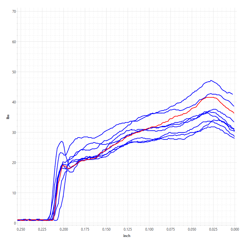

Can you remind us what you did and what the original problem was
No problem, just ironing out my process among the vast maze of opinions on the subject matter. I had not seen a color change until this run, which in hindsight I am not sure is anything more than a mark from the hot edge of the roller on the ugly annealer.
Oh and this was the smoothest push through the Redding FL sizing bushing die. From day one this ADG 6.5 PRC has been the most difficult of any brass I have sized before. I have to use Hornady Unique Case Lube as the Alpha and Imperial wax lubes are much more difficult.

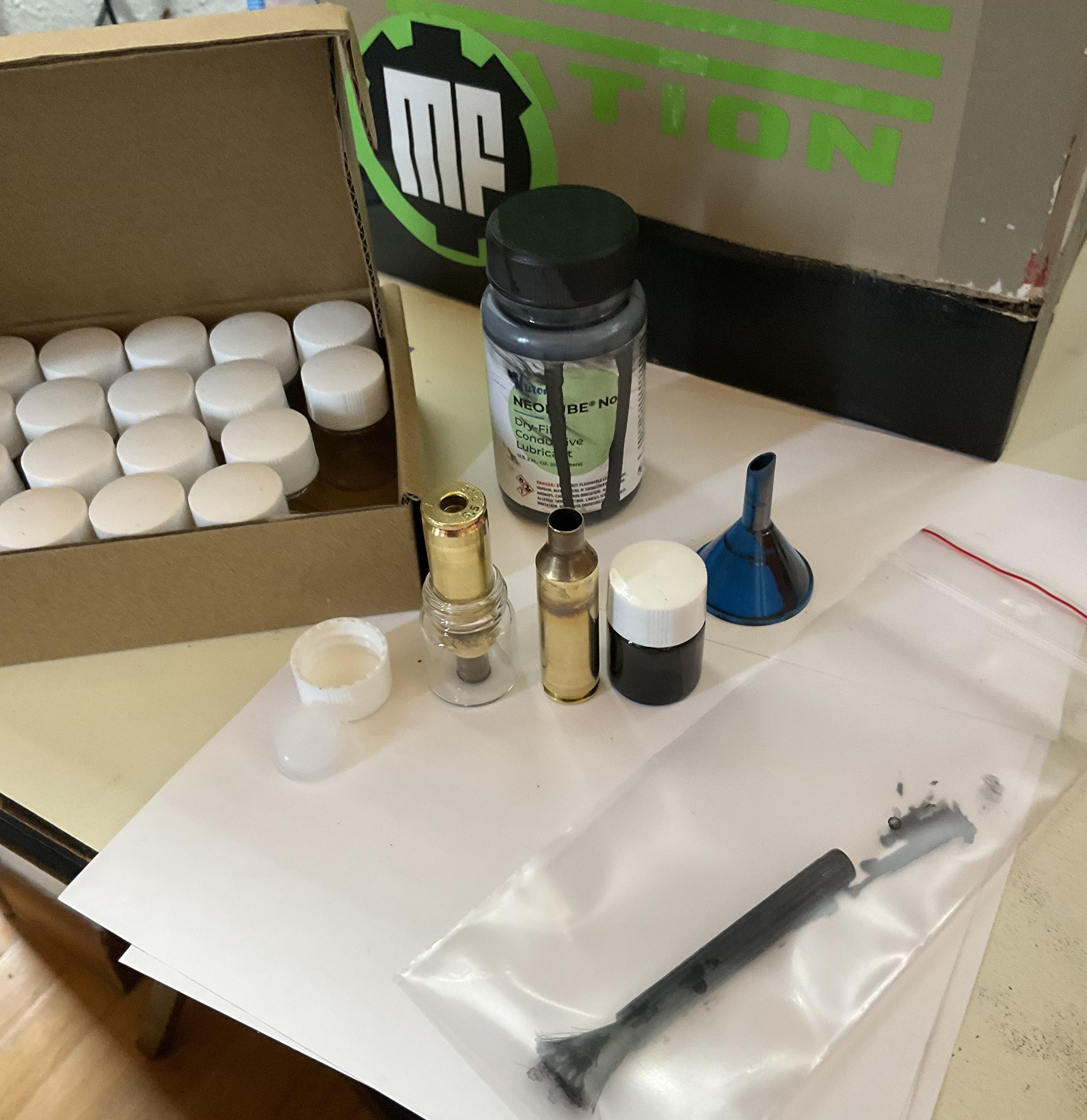

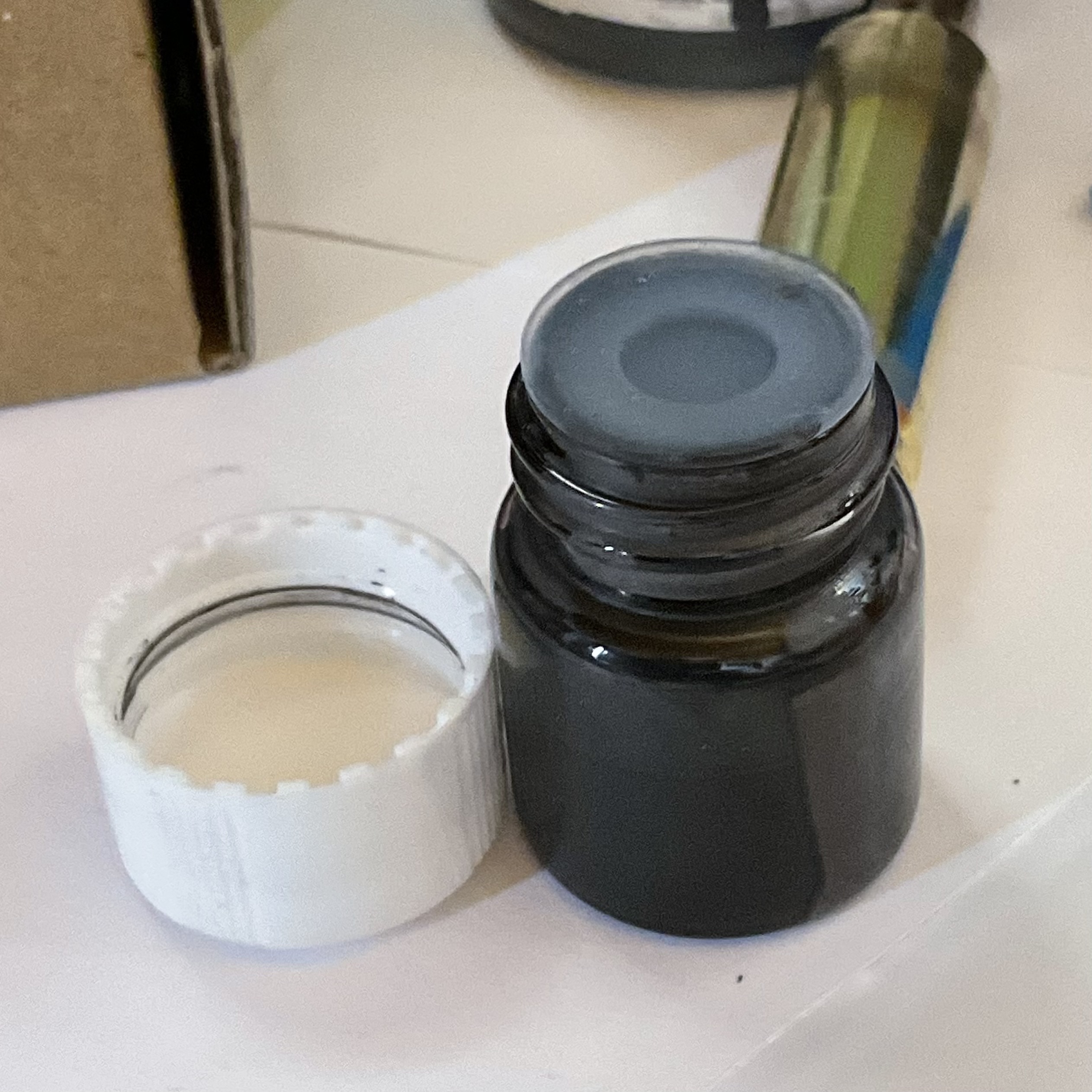

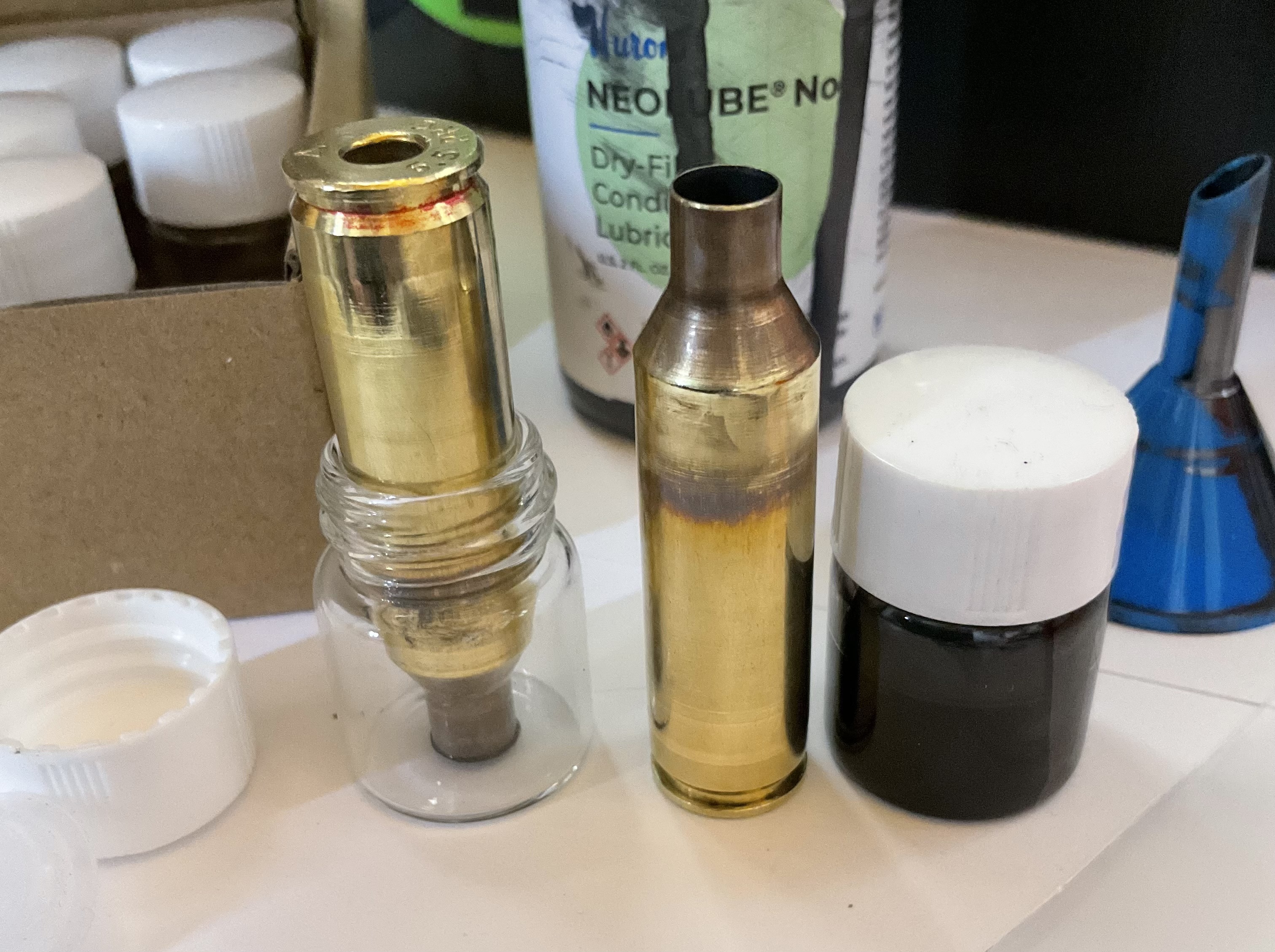

If you don’t mind me asking, where do you order your neo lube #2 from?
Thx 🙏
Yeah, I’m behind the curve on that one. I don’t even use that so maybe I’m missing the joke. I still smear imperial wax on everything over 30 caliber one at a time.
For anyone looking for Neo Lube #2 I finally got some here: https://ebay.us/m/BCiiKE
Same seller sells on Amazon and Walmart marketplace. Was shipped promptly and sealed well will blue tape. I think the factory does that.
Took a whiff and it smells of denatured alcohol….ugh Nasty stuff. I ordered a tiny vial for “dip work”. Hopefully that will keep the smell down. Since I had to buy a few vials with lids I will experiment with drilling a hole the diameter of my brass and perhaps a wipe for the brass exterior.

As an aside, I tested powdered moly, powdered graphite, HBN, and neolube. With the exception of HBN, which I found to yield the most inconsistent seating forces (by a long shot), the rest were pretty close, but neolube won out. What I saw was that the spread in seating force was similar, but that neolube's spread was due to one or two "flyers" with the rest grouped very tightly.
I'll see if I can find some of the old plots. Honestly, though, the difference between any of them (with the exception of HBN) is so small that any would work. I find neolube, being liquid, quicker and cleaner to apply. Some people "paint" the inside of the necks - I dip the cases.
Reactions: Tokay444
These are all from my 6 BRA:
Graphite:
Ultrasonic Cleaned - No Lube:
Tumbled Clean - No Lube:
Moly on once-fired - note that the overall friction is higher - I think due to being only once-fired:
50/50 Moly/Graphite Blend:
Moly for Mandrel then NeoLube:
When you say "Tumbled Clean", what kind of tumbling does that refer to in this particular case? Dry (vibrator) Tumble and with what media??? Wet tumble, with or without SS pins??? I ask because all these variations produce very different results.

I just did “dipped” about 25 cases. I ordered some small glass vials to separate my working supply from the main container which is pretty much my SOP with any such material. I guessed on the size and I gambled perfectly. The 6.5 PRC slides right in with little room to spare. Obviously my 6.5 cm will fit nicely too. I bought some little funnels but I decided to switch to eye droppers for transfer. Less mess and loss. I fill the vial just high enough to do the necks as I dip and to allow for the level to lower as I go.
I was pleasantly surprised that I hardly noticed the smell at all. Having said that, I did notice that my heart rate was up when I was done doing 20 cases. I’ll try for more ventilation in the future.
I also did this job before priming where with other lubes I do it after. This is imperative.
I found out the hard way to wear gloves. It took pumice hand cleaner and scrubbing to get it off.
If you are not using the brush on the cap, it’s a nuisance. A quick twist with pliers and it comes right off. It can be reinstalled should it be needed in the future.
So far I like it! Fingers crossed 🤞 I’ll see some better SDs and maybe better groups.
