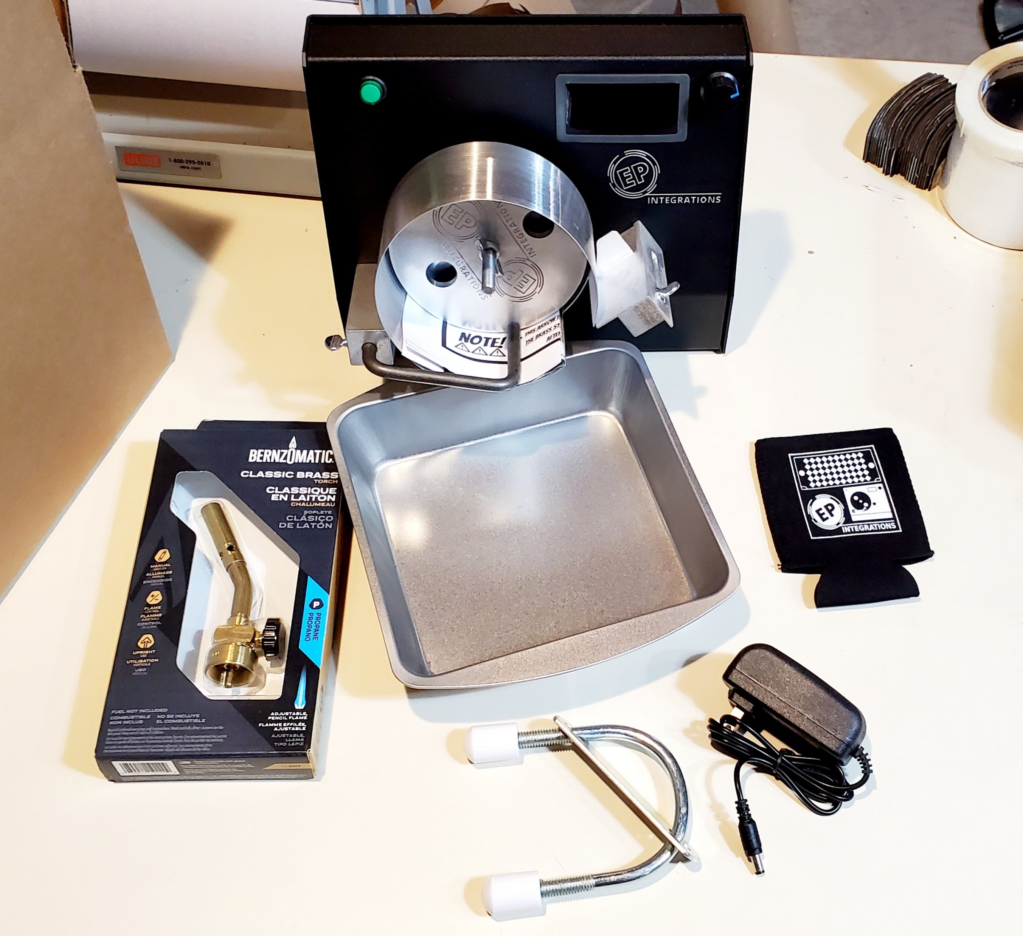

We sell the ep 2.0 annealer that can adjust from 300blk to 50bmg without having to add or remove any parts & adjusts in seconds for $268 full retail shipped lower 48 states.
Might have enough parts too to get a scratch and dent together from $228 to $248 shipped depending in how s&d it is. PM if your interested. We usually have enough parts for an s&d weekly.
