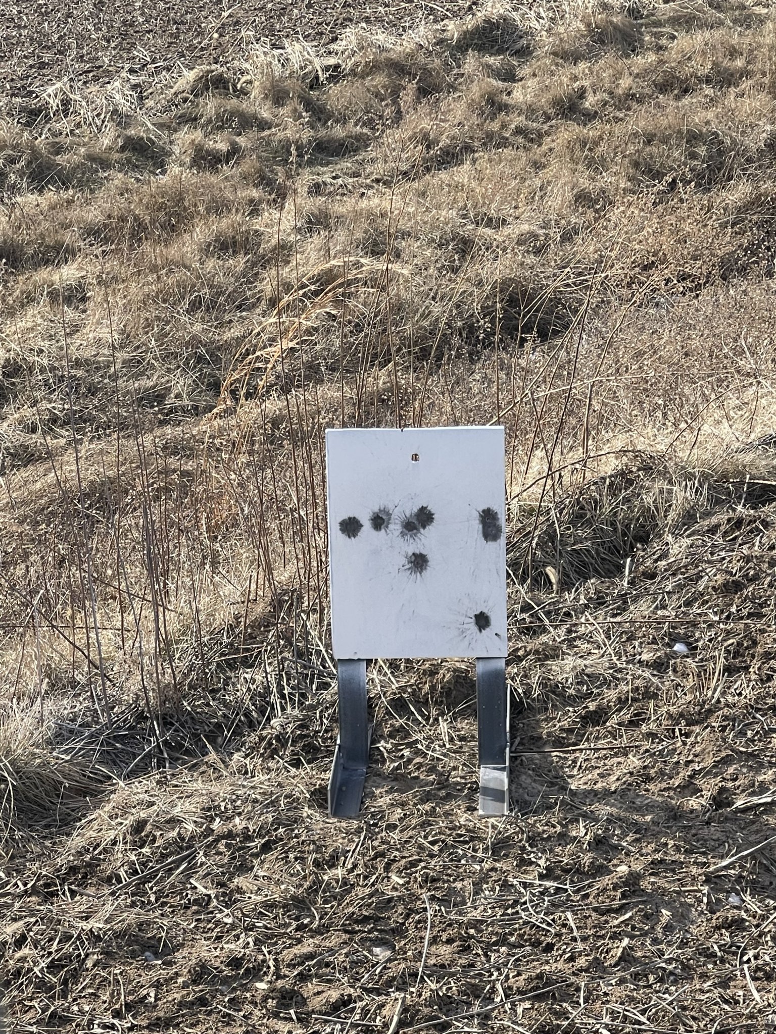

600 wasn’t too bad but I felt like the wind was really giving me more fits than it should of. Past that I wasn’t consistently splashing on either side of the target. I will attach the 600 target to show how the vertical spread (after the first bottom right impact) was good but horizontal was very erratic. And once I went past 600, it felt like things went to hell in a hand basket.
