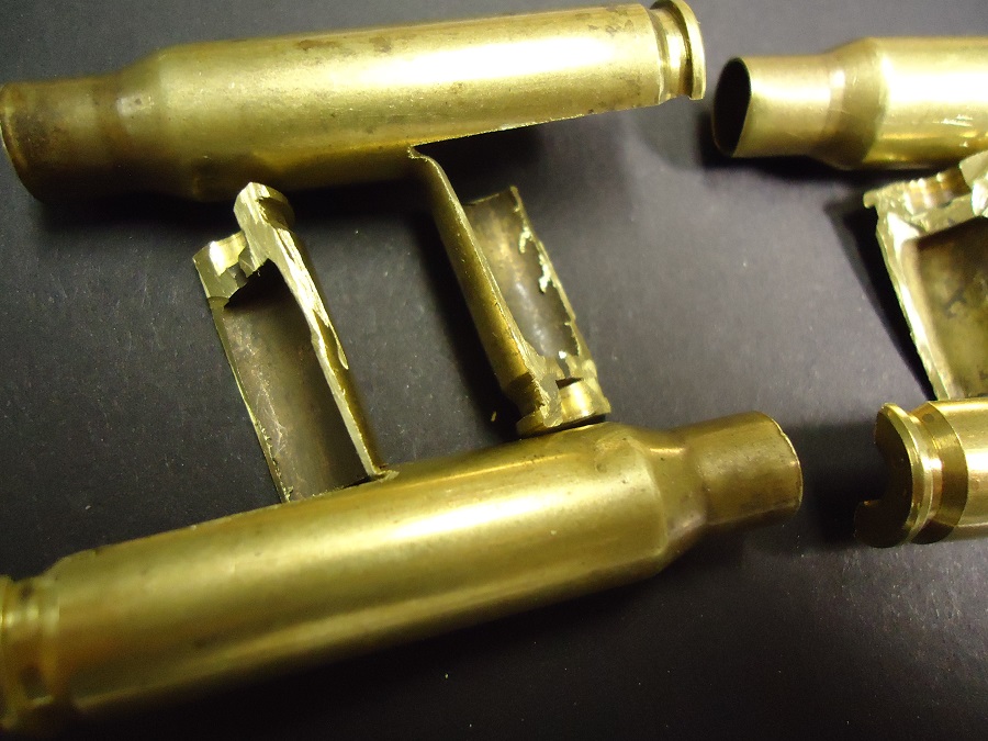

On my first load of the LC-10 (approx. 50 rds.) I had two partial head separations (faint bright ring about 1/2" up from the case head and a definite crack about half way around the case). The rest of the cases looked OK (no bright ring showing beginning of incipient separation) so I've loaded them 2 more times (ie. they have been fired now a total of 4 times). Still no outward appearance of any separation but I took a stiff wire with a hook bent at one end to prob the inside of the cases and can definitely feel a ring of thinning above the base. I sectioned some of them with a cut off wheel and the case thinning is very apparent.
Wondering if the beginnings of case separations were already present in the once fire brass I received, with a wire probe, I checked a number of cases that I had only de-primed and cleaned. I could feel the beginning of a ring of thinning in probably 20% of the LC-13, 10% in the LC-10 and none in the Win. I sectioned some of the cases and confirmed what the wire probe found.
I realize this brass was probably fired in a MG so I'm guessing this case stretching is pretty normal when you get once fired.

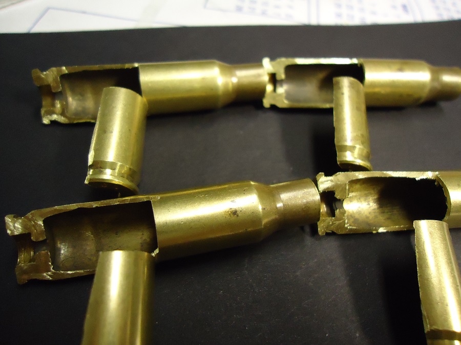

The majority of 7.62 brass will be fired in machine guns with larger diameter chambers and much longer headspace settings than commercial firearms. Meaning its a gamble on if and how much the brass stretched on the first firing as you can see from sectioning your cases.
ZombieMonkey posted a link where he buys his brass above and they sell LC Long Range 7.62 M118 once fired brass, and this brass would not have been fired in machine guns.
.308/7.62 - LC Long Range - Cleaned - 100 Pieces
Below is from the link and these cases were fired in tighter headspaced bolt action rifles and have less chance of stretching and thinning on the first firing.
"These are once fired Lake City Long Range .308/7.62 NATO Military brass casings. These casings have been cleaned only. No other processing or loading has been done. These casings are bolt fired and have Lake City Long Range headstamps."
I collected milsurp rifles and had the opposite problem you have, I fired commercial brass in long fat military chambers and had to find ways to keep the brass from stretching on the first firing. I used the RCBS case master gauge to check and measure the thinning in the base web area in thousandths of an inch. This was far more accurate than using a bent paper clip and prevented any case head separations.
The .303 British case below was a factory loaded once fired Winchester cartridge and never reloaded. It stretched .009 on the first firing in a Enfield rifle with the headspace set within SAAMI specifications.
As you can see the once Fired .308/7.62 LC Long Range M118 brass is sold out above for a reason, and that because it wasn't fired in a machine gun. Bottom line, look for companies that sell brass not fired in machine guns or buy the cheaper brass and inspect it with the RCBS gauge.

The pictures I show are brass as I received it from Hi-Tech. It has only been de-capped, primer pocket swaged and tumbled for about 5 or 6 hours in walnut media. The cases have not been sized and any stretching would have been a result of their first firing (assuming they are once fired - and I believe they are based on the primers being still crimped in). I've seen BrassBombers website and will definitely consider them for my next purchase.

The RCBS case concentricity gauge seems like a great tool although it can't be in my budget right now. I sectioned about another dozen LC-13 once fired cases (I've got to stop doing this as it is quite a waste of brass) and didn't find anymore with the pronounced thinning shown in my first two pics. What I did find can be divided in to two groups: about 2/3's of the cases were completely smooth in the area just above the web as unfired brass would appear (except dirty of course); The 2nd group (about 1/3) showed a ring of rough texture about were you would normally find the thinning/stretching to occur. I am guessing this ring of rough texture running the circumference of the case above the web are the early stage of stretching and can actually be felt with the tip of the bent wire I was using.
I never really explored the condition of case interiors until now. I always relied on the appearance of the bright ring above the case head as an indication of potential separation. None of the cases I sectioned even the ones with very definite thinning outwardly showed such a bright ring on the outside.
I guess the differences in degree of stretch on the once fired cases is a refection of the different chambers it may have originally been fired in.
