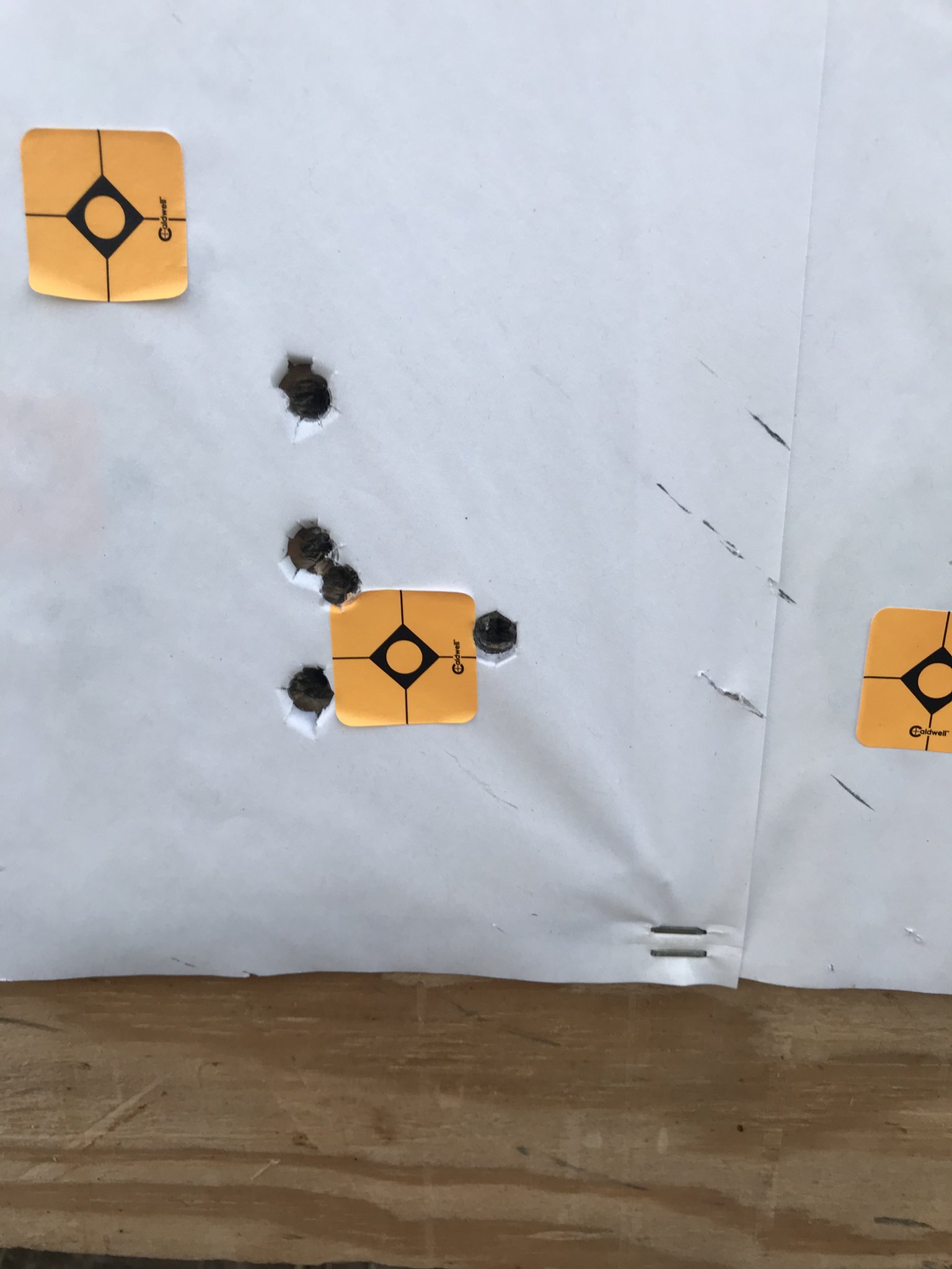

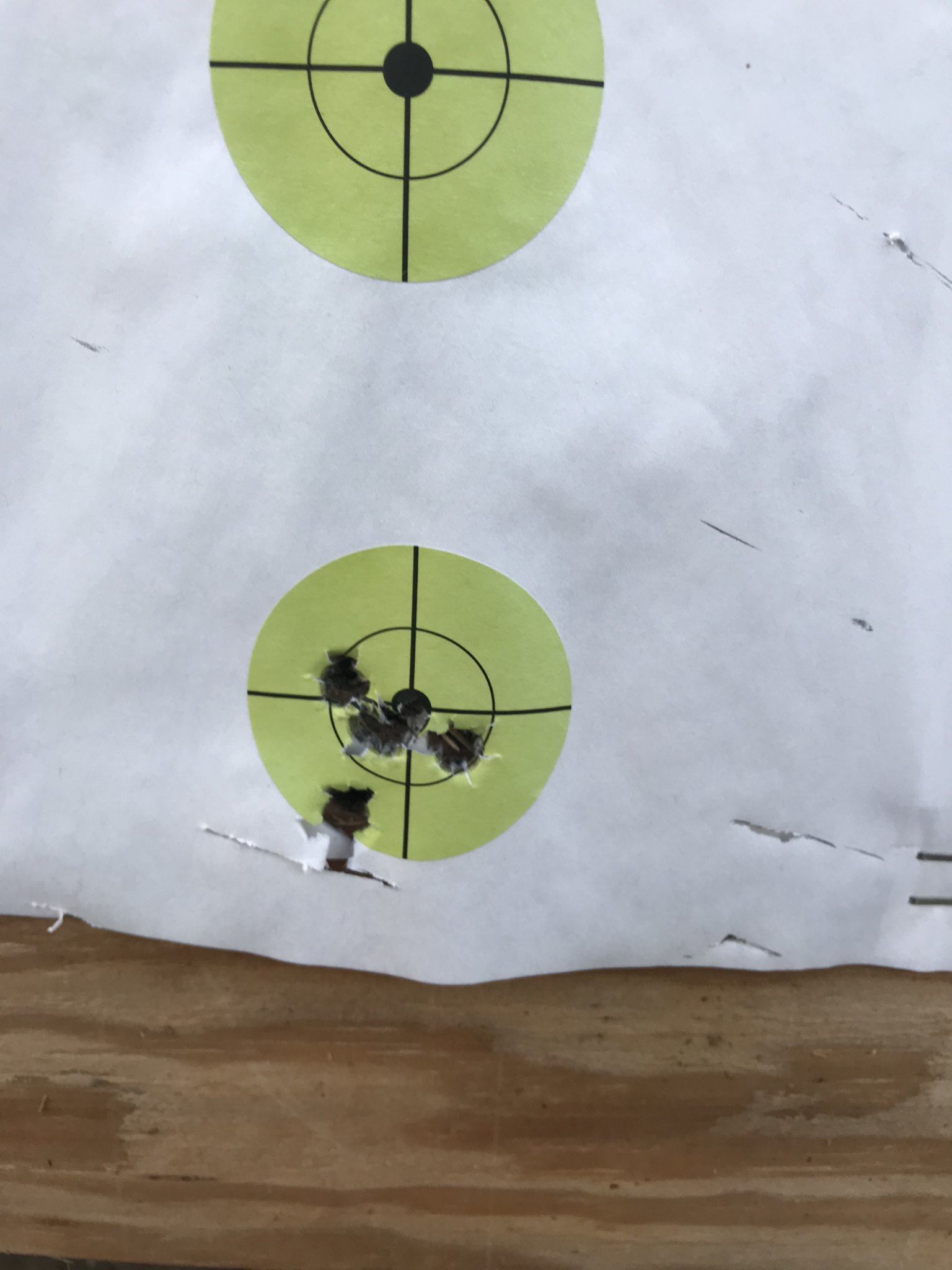

    Now I decide to do some hand loads with H4350 and 208 Amax. I did OCW at the lands and found pretty consistent POI around 64.5-65.0gr and no pressure signs, so I loaded up 65.0gr at .01” jump, lands, and .005” jam.
    Jump was absolute crap. Lands was hardly better, and jam finally tightened it up; but nowhere near satisfacation for a custom rifle.

    Pics below are the .01” jump and.005” jam results from tonight.
