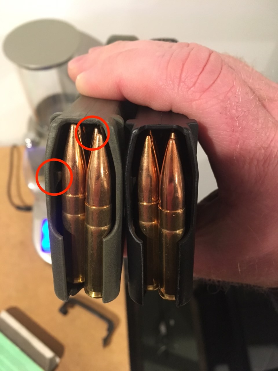

My 5.56 mags did similar and it pissed me off beyond belief the few times I took my rifle to matches and it sucked.
Load the mags most of the way and feel with your finger if they are dragging on the ribs. Upon comparing the 300 BO mags and 5.56 ones, you could also see the nose of the bullet being out of alignment as they went down the magazine.
Edit: Found older pic. Left = 5.56, Right = 300 BO. Compare the areas of red circles. Rounds are S&B 200.
My 20 round USGI magazines load 300BO centered like the 5.56 mag pictured. Haven’t tried any plastic mags.
