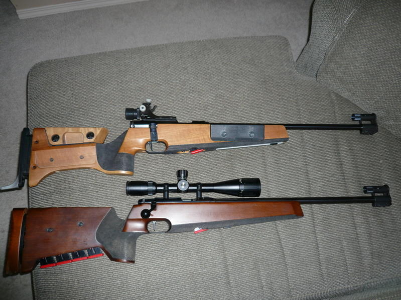

Some of you might have seen my posting about the recent purchase of my Steyr LGB1 biathlon PCP air rifle in Top Predators air gun thread here in the rimfire forum. Some info about it and a video is on page 8. I really like this rifle! In fact I like "everything" about it. Because I like it so much I'm thinking about buying a Anschutz 1827 rimfire.
J.G. ANSCHÜTZ GmbH & Co. KG - Biathlon
Although I'm 99% sure I'd like the 1827 biathlon just as much as the air gun I wanted others opinions on it before I took the plunge and bought one. Seems like the Fortner action would have to be extremely dependable and reliable because of the harsh conditions it was designed to work in. I'm also assuming it must be about as accurate as a rimfire gets. If the ergos are anything like the Steyr LGB1 I'd be happy happy.
If I bought this rifle I'd be using it for .22 matches of various kinds. The Snipers Hide is probably the wrong place to ask about a biathlon rifle but I thought I'd give it a try anyways. How do you think it would compare to a custom 10-22 and say a Anschutz MPR or a top of the line bolt action 22?

Is it possible to mount a scope rail (30-40moa) on the Anschutz 1827 Fortner Biathlon action? Any companies specialize in that?
I'd be interested to know myself.
The cheap solution, but still a good one, is to use the Burris Signature rings with the +/- 20 inserts. Additional elevation adjustment can made by moving the rings closer together or farther apart to increase or decrease the angle. I've got a few pairs and I've never had any problems with them.

My only worry is that the action appears to only have the 11mm rail at the rear of the action and nothing at the front. Might need a cantilevered mount to set up a scope for proper eye relief. Would be interesting to see if anyone has done this.

Yes, the 11mm rail is only on the rear portion of the action behind the ejection port. Many companies make rail risers/extensions that will cantilever far enough forward to allow scope mounting in a conventional way. I recently acquired an older 1827F (90's?) that I have only plinked with using the diopter sights. Even with open sights I could shoot SK Standard into approx. .5" groups at 50m (from the bench). If it shoots as well as my 54 actioned 1827 then I will be expecting groups in the .1-.2's with Lapua Center-X.
Sunoptics makes a picatinny / 11mm adaptor rail that I have on mine. SM7015 is the part number I believe.
Solid and easily removed for when I want to switch back to open sights.

That .1-.2's quote is what its all about! The Fortner action seems to be the best choice for a fast action 22. I did find one 1827F in stock that is close to me. Might have a very busy time selling a few 22's to upgrade to this level.
I bought some extended 30mm Sportsmatch rings from Airguns of Arizona for my LGB1 biathlon trainer. I noticed they have a 1" extended angled ring set.
