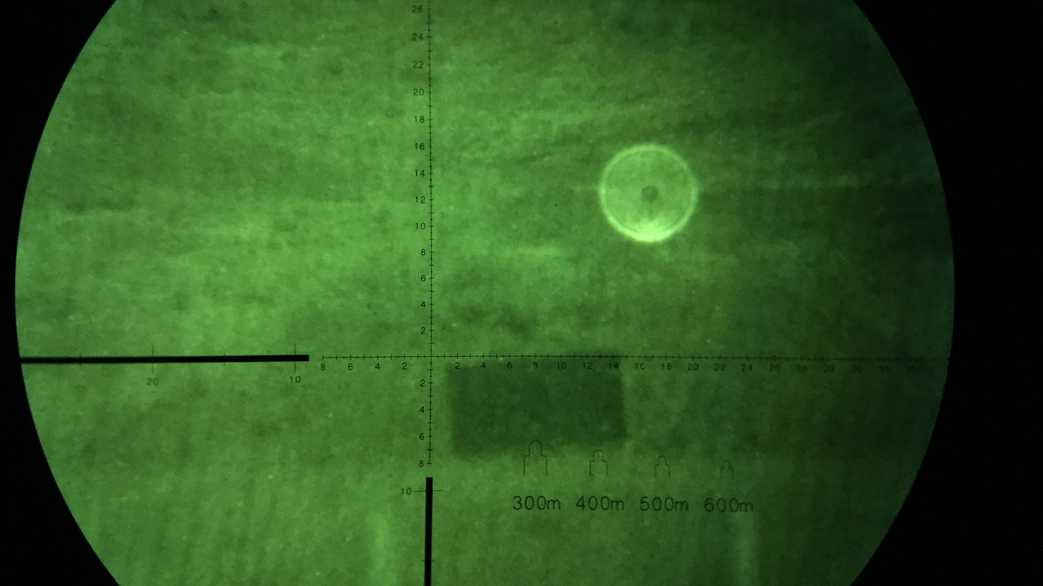

  • Wow
Reactions: brianf
well i’ll say it was only OK.
we had a high lume night and I don’t think it helped.
We had a full moon and no cloud cover. So 100% Lume. and this is high desert so it’s a thing. the SPIR added about 10% light to a full lume situation at 1km.
I would say that more focus on the beam would have been welcomed.
Second pic is buttfucking insanity (my nickname for the unfiltered ELIR-3)
7044974
7044973
I agree, my SPIR focuses down to 2 degrees. That matches up to the field of view of my scope at 8x. The edges of the beam are way more well defined than your pic. Any chance the focusing ring of the SPIR is hitting something on your rig?
It sure ain’t. I used a dbal d2 today with identical results.
I measured the beam divergence on this unit. It is approx 3 degrees. I have a call into steiner.
I wonder if steiner did an in-line upgrade.
so what mag were you on with your spotter set up in your pics? I presume that's the vortex 15x spotter? if so have you tried this with a variable power optic to see how the beam looks with the spir?
