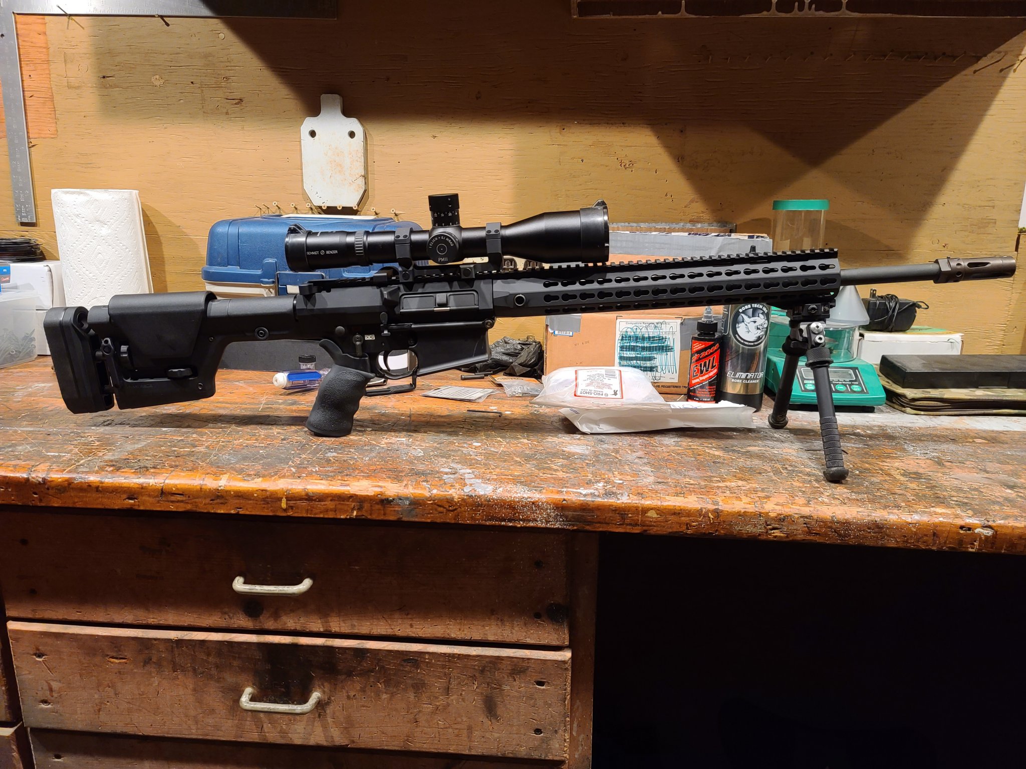

I realize they will fit together, but will it function the exact same as if the lower and upper are both lmt or both kac? Anyone have any issues at all as far as function who put a kac sr25 upper on a lmt mws lower?
I only have a handful of rounds on mine, but the fit and function is spot on so far. Mine is technically MARS-H, but that should be the same pattern as an MWS.

I have a LMT MWS lower mated to a SR25 upper (20” 308). Pulled the LMT spring and buffer, replaced with KAC stuff that came with upper. Fits fine. Have around 450rds with no hiccups or funny wear marks on lower.
A buddy of mine has the same set up but with the KAC 6.5 upper. In his set up, there are wear marks on the lower just in front of the buffer tube/buffer retaining pin. I personally contribute this to the KAC 6.5 BCG as it has a different profile than the 308 model. With that said, he has not experienced any failures or hiccups either.

Thanks. Weird about the 6.5 leaving marks. Is the bcg really all that different? Mine will be for a 308, but I am curious now.

yes, KAC changed the BCG around. First, the bolt has the split ejector layout like the LMT bolt (vs the 308 bolt with 2 ejectors side by side). Also, the bottom profile of the carrier is different. On the 308 carrier, it has the typical narrow slot for the hammer to access the firing pin. The rear bottom of the 6.5 carrier looks closer to a DPMS style carrier (wider slot for a wider hammer profile). Lastly, the bottom bearing surfaces of the carrier appear to be profiled differently on the 6.5 (which is why I made the assumption about the marks on the lower).
