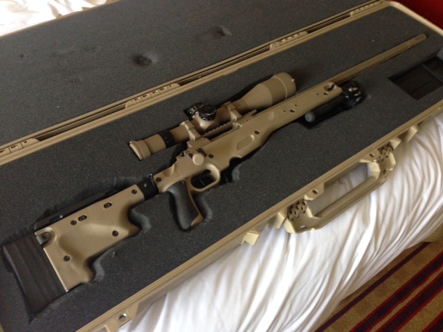

I did something very similar with my build. Found a 700ADL for sale at Cabela's for only $349 and had all the work done to it as part of the group buy. Money well spent! I love it!
