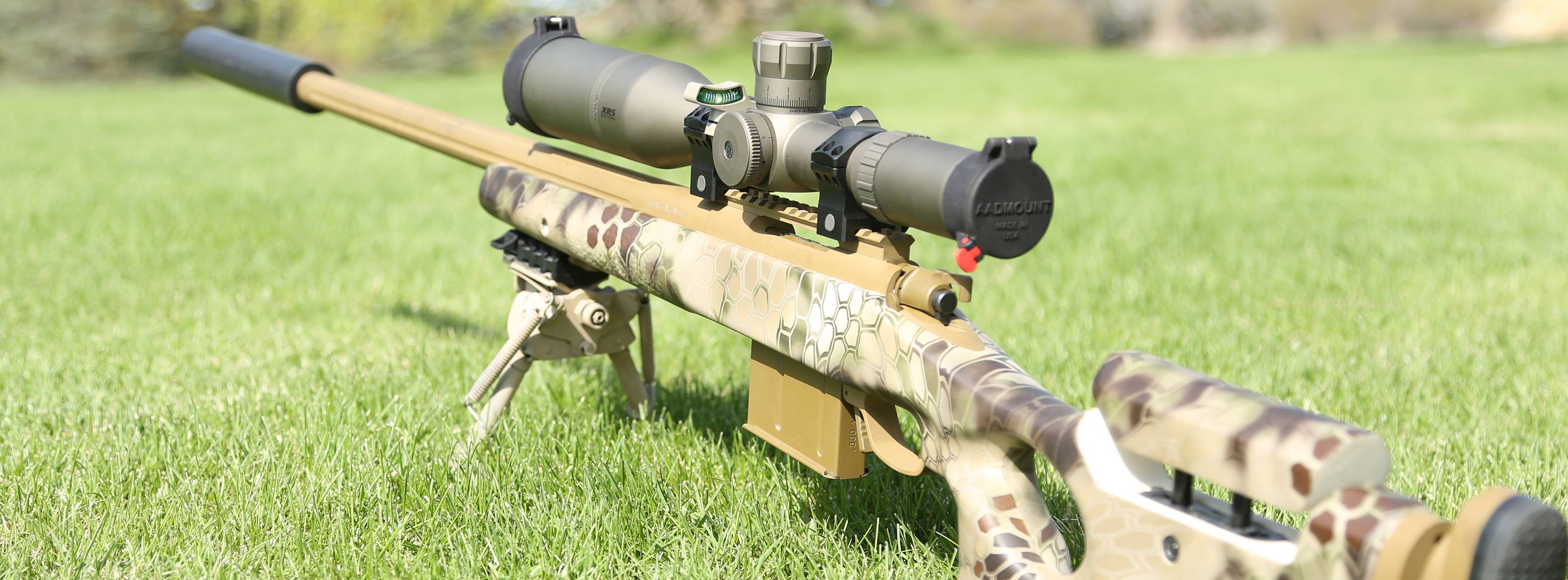

Older Model 70 Classic CRF into a 7mm Rem Mag. Just as you described.
It shoots better than it looks.

That's just too sweet!
