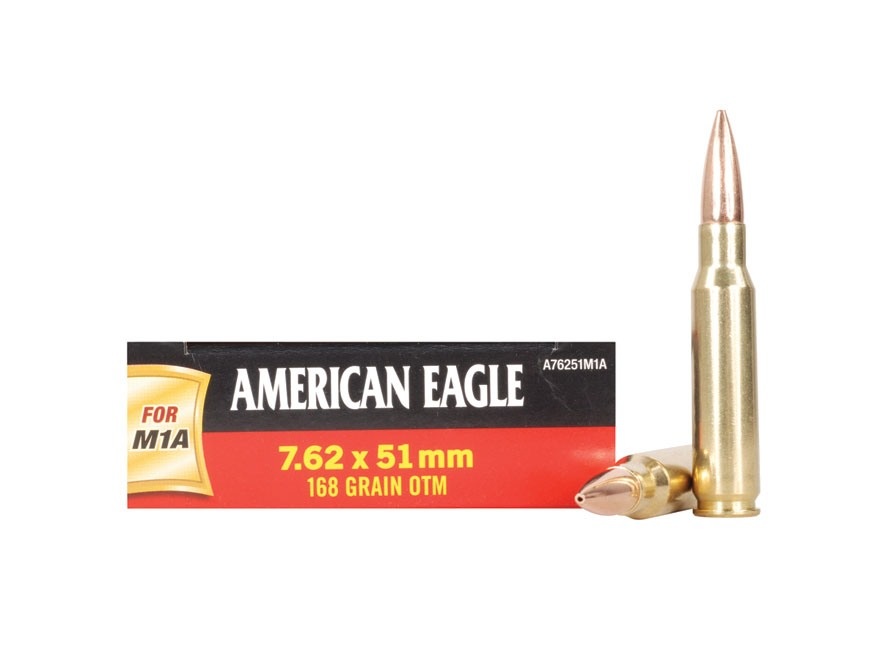

Bullet is made by Speer for American Eagle (Federal) with a .460 BC that I verified shooting in the field. FPS is slightly higher than the marked 2650. This bullet is Speer OTM and not BTHP Sierra MatchKing. If you have a good rifle and good skills you won't see much difference between the AE and the Federal Gold Match, which does use a Sierra BTHP MatchKing bullet. Thus, it makes an excellent practice ammo. Highly recommended.

That's a little strange that Federal would use Speer match bullets instead of the Sierras... Speers cost more in most places, and Federal already has a working relationship with Sierra, of course.
That said, they're probably using a ball powder here, as it's easier to meter and QC cost could probably be reduced a bit. They seem to use AA2520 in some factory loads.
Using AA2520 and adhering to published load data, you might be able to get a handload to work as well for you here.
This is *not* to say that Federal is using AA2520 here... just saying it's probably in the running.

Not so strange when Federal and Speer are owned by the same conglomerate. Along with CCI and Alliant and a few others
