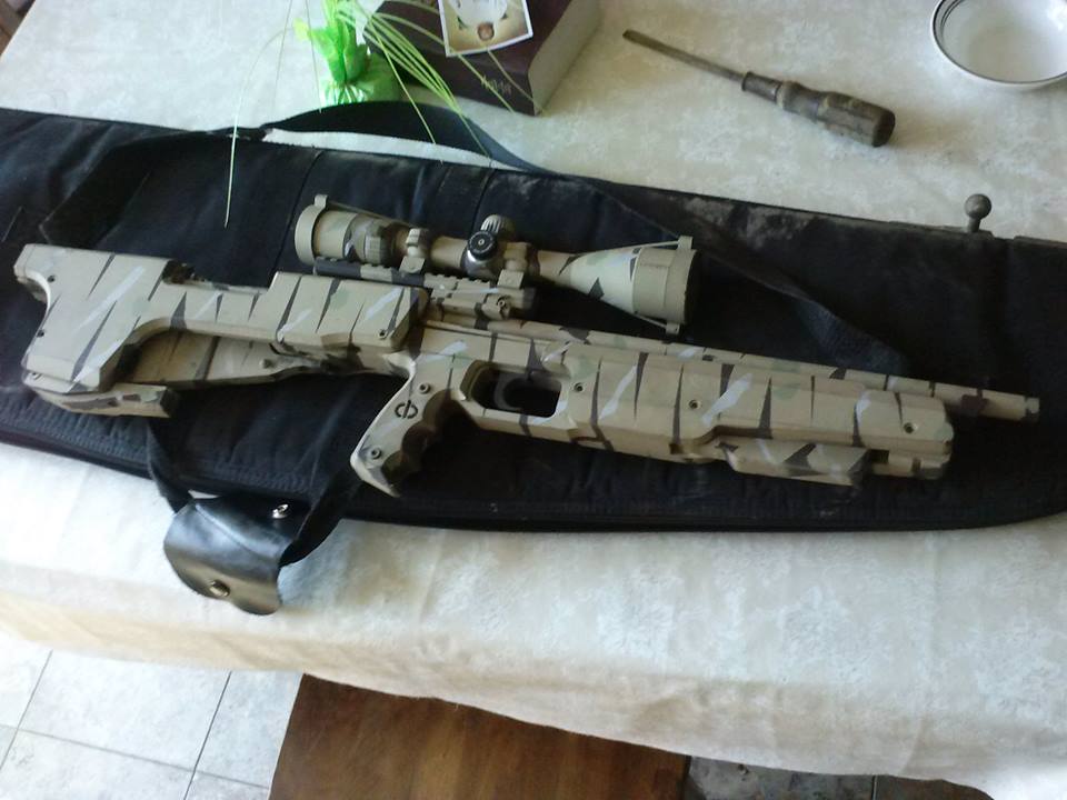

i decided to make my nagant my first project gun. it cost me 125$ for the rifle and couldnt hold a group less then a paper plate at 100 yards. i thought that would be the best place to start learning to gunsmith.
i started with the restocking and put it in the cbrps stock and quickly found a few flaws that i didnt care for after a few quick mods it is almost done.
what other problems have you folks noticed. i couldnt get the scope to zero it was mounted to a plastic carry handle and not only sat way too high off the barrel but had a wondering zero and mounted all kinds of screw it had a set screw the was pushed up against the barrel but it was screwed thru plastic that would easily stress and loosen.
i cut off the upper side rails removed the carry handle and added a scout mount. allowing me to scope it with a normal eye relief scope (the purpose behind the bull pup design.) i dont have tools or money to drill and tap..
after all was said and done it turned out nicely except..... the stock is a two piece stock so there is flex and a hairs worth of play between the front and rear mounting bolts. i plan to fix this by making replicas of the side plates out of sheet steel and welding a cross bar to go up and over the throat of the action and one to go down and around the mag. i also plan to drill and tap 2 more anchors that will bolt securely to the the alum. front half. it only has 1 screw on each side allowing it to fold in half after removing the action. i figure adding 2 more on each side will get rid of any play. does any one else have a way to fix this problem? or am i over looking a much larger problem?

the last 2 1/2 inches of the barrel were so worn that the rifling was gone and the crown was nicked like some one dropped it in gravel off the roof of a house. the guy I bought it from didn't have it in a stock and the one he gave my was a tad warped too. not sure how much the stock effected it cause I changed it before I cut the barrel.

for me the project is simply to learn. if I didn't plan to screw something up along the way I would have used my Rem 700. but I don't foresee me getting it all right on the first try.
I can afford to goof a little with a 100$ gun. if it comes down to it then I learn to rebarrel too.
the barrel is cut to 20 3/4" im pretty sure the barrel measured 28 3/4 to start and I chopped 8". the crown is deep set at a 45 degree angle.
I haven't slugged the bore yet because I don't have access to lead or a smelting tool to make a lead ball. as soon as I do I plan to lap it as well as measure.
I don't reload so I am stuck with factory and am trying different loads to see what works best. wish I could reload but there's too much money involved in getting started. if I ever had it I would invest in it but not yet. I know that a consistent round makes a worlds difference im just not there yet.
the barrel isn't free floated. I have a plastic rise that helps support the barrel about 2 1/2 - 3 inches from the end of the barrel. I also pinned a small leather strap around the barrel to help hold it in the riser and to try and equalize the pressure on the barrel. as soon as I get the time I am going to wrap every three inches or so with rubber banding and see if that helps to deresonate it at all.
I also made an adjustable trigger for it. I drilled a small hole thru the receiver just behind the trigger and tapped it for a 5mm set screw it. the screw is more then out the way and if I wanted to I could adjust it down to a hair trigger. I have it set at about 3 1/2 to 4 lbs. had to use a fishing scale I don't have a scale for testing triggers.

im going to try and get pics of the stock and the inner working this week end. that way you can see what im up against as far as the securing the action.
If this were my project, the first thing I would do would be to secure the action so that it's not going to move when shot. After that was done, I would test it without any pressure points/wraps on the barrel to see how it does (with as many different loads as I had access to). If the action is solidly secured, you may be surprised by how well it will shoot with the barrel cut to it's current length. The purpose of wrapping the barrel on a standard 91/30 is because of it's length and the fact that it's thinner at the muzzle end than at the receiver end. From there, you will have a "control" from which to base the effects of any wraps or tension devices on the barrel. All of this is assuming that you have a solid sighting system, however. That could end up being the catch.
the sights are solid I used a steel scout mount and everything is Loctite down I used the lowest steel weaver style rings I could get for about 35$ I was told you get what you pay for. and I am running a 3-9 nikon prostaff. I don't see there being any issue with the sights. had it zeroed in at a local shop then put out about 40 rounds down range and am killing grape fruit at 175 yards. i plan on ordering an updated back half for the stock that is squared instead of L shaped and it is spring loaded to help with recoil. as soon as that is ordered and put on then i am going to reinforce it with the steel brackets. i just want to get that in before i measure and cut anything. and as far as ammo i will start diversifying and trying many types and not just the 3 or 4 the store carries. also will spend weekend finding that control group before testing anything
Just finished the rebuild. i added internal struts in the stock to firm it up. i made an adjustable trigger that goes down to about 1 1/2-2 pounds. its stet pretty close to the 2 lbs mark now. also made a muzzle break and threaded the barrel. It kicks a like a .223 now. it is verry comfortable to shoot.
all that needs done is to re sight it in and kill a deer with it

Ive read about removing the sighgt block but ive noticed with the desing of the stock the scope needs to be raised to allow a good cheek weld. because your cheek is resting just ontop of the bolt. i prefer to be as close to the bore as possible but the bullpup dedign doesnt allow that very well. i intend to do the same trigger mods to a second nagant that way i can swap out for a lil extar barrel length without a barrel change. they are easy to find for about 100 so im not hurting the wallet. my only concern now is the brace i use suport the barrel. with the muzzle break on there is 0 muzzle climb. i think i can safely remove it and leave it fully free floated. im hoping to sight it in and get pics of the nr mods this weekend.
the current muzzle break is very poorly made it is my rough draft.
its had 10 rounds through it and the welds seem to be holding tho.
my vice broke in the middle of drilling the vent holes and i only had parts for one try... cause i goofed the other two :D
i cant migweld for beans lol.
next break i make will have 3 baffles instead of just one. as for the flash...... we are still at the drawing board but i have some good ideas i just need to get a buddy to do the welding next time
